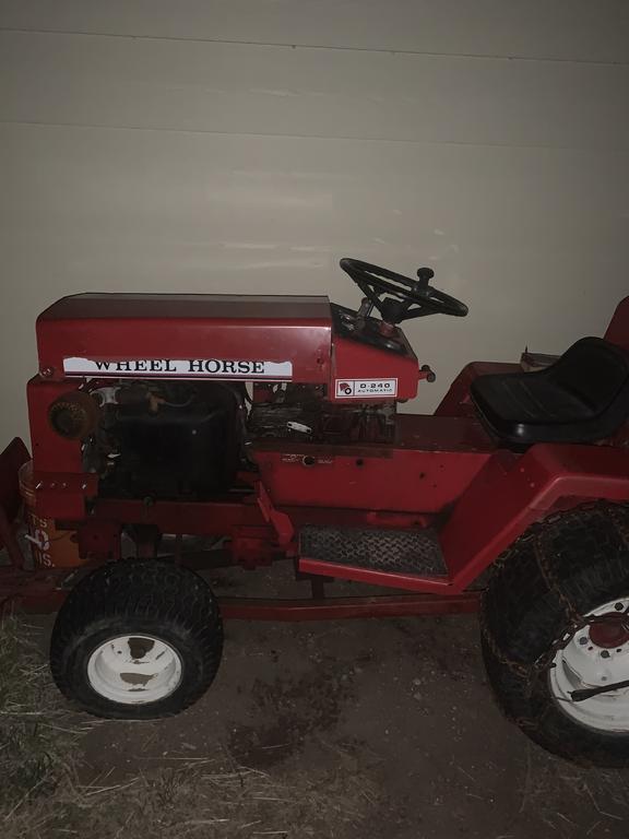

Hi all,

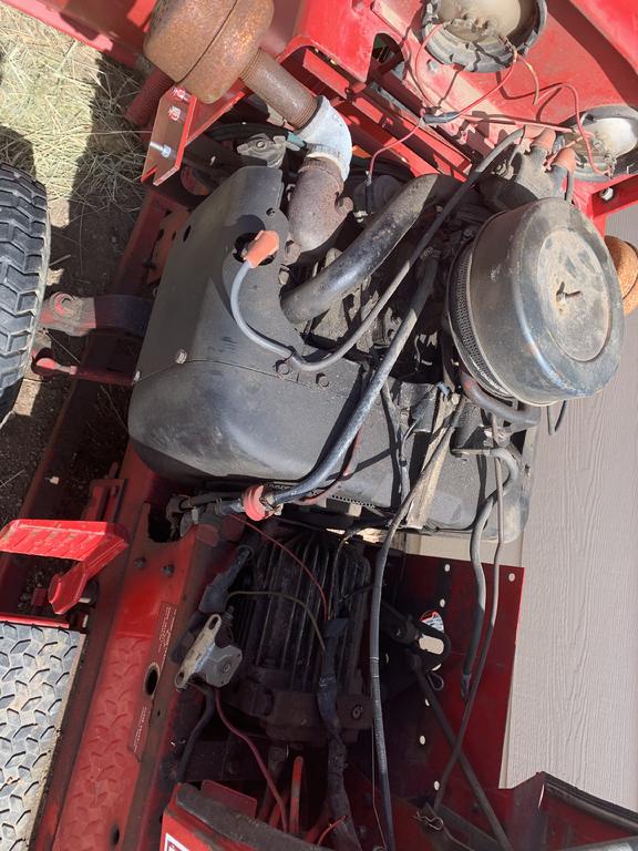

I am new here and am new to the wheel horse tractors. I bought a property and a D-240 came with it. Can anyone give me an idea of the year range it could be ? It does have a Koehler motor. It runs really good, I was doing a little plowing with it and it blew a shaft seal off the hydro transmission pump ?
Any links to literature for removing the pump or suggestions from anyone here that knows more about these, who can point me in the right direction?
much appreciated
thanks
I have taken it partially apartBD0C2757-492C-4F45-8FD8-004C9858A563.jpeg.e58d2fe14238815545419581d78b8453.jpeg

I assume that someone has made a custom decal that indicates "D-240" Automatic, as this may have started out as a D-200 made from 1974-1981.  Parts are getting hard to find but not impossible.  May want to place a "Wanted" ad in the classified section or check out the -bay. The difference between removal of the pump and the impossible, is that, the impossible is just a bit harder.  One other note worth a mention is some owners use motor oil while others use tranny fluid.  It should be refilled with the same as opposed to mixing them.  The seal on the 1976 model is part #7877 not certain if this the same for other years.

Hah! D man - unfortunately, is correct on maintenance of these "Big D's" . Hate to throw that at you this early with your new tractor, but, you would have found it out anyway when you start wrenching on it.  And I think he is right on the '240' designation, its probably a '200' . The 200 had a larger gas tank than the other D's and it looks like yours has the large one.

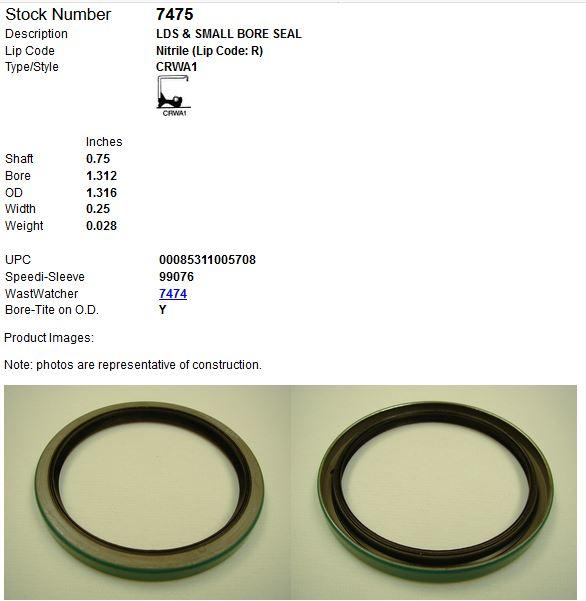

pfrederi
  The Sunstrand manual linked details how to remove the engine to access the pump. You can dig out the seal with out removing the pump.  I drill a small hole and use a sheet metal screw sometimes.    I use SKF 7475 as it is a double lip seal.  One to keep dirt out the other oil in.  note if your input shaft is grooved you can use a speedi sleeve and install it with out removing the pump from the tractor. A truly unpleasant task.

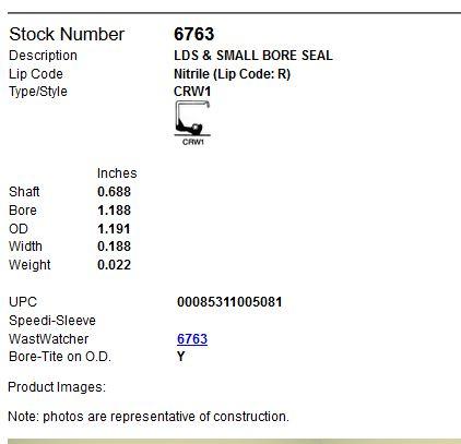

the seal that blew is the side shaft (drivers side) the one that the linkage connects to on the passenger side. I imagine I can use your same process for any of the shaft seals?
O.K. that is a different seal than the part # I quoted.  The side shaft seals are part# 103461 for the 1976 model.  I'll check if I have any.
pfrederi
SKF 6763
