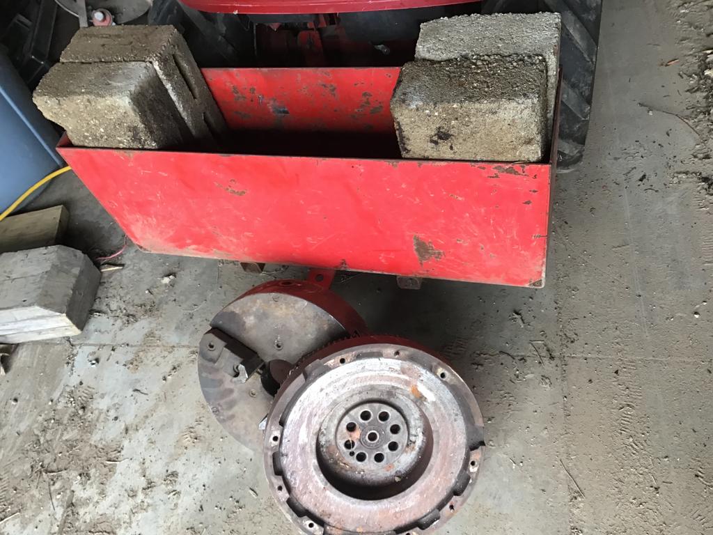

Pullstart 71,098 #76 Posted March 25, 2020 These bricks were laying in the bottom of the weight box, topped with flat rocks. I stood them up and will add an old lathe vice and a Duramax flywheel in the center. 1 1 Share this post Link to post Share on other sites

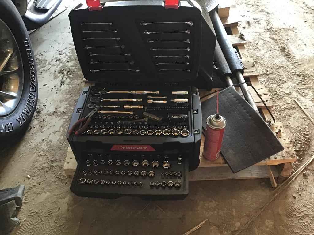

Pullstart 71,098 #83 Posted March 25, 2020 I’m putting the new Husky tool set to use. I normally carry tools back and forth between barns, forgetting where I put them. Since these little sets have a place for everything and everything in it’s place, it helps an OOOO SHINEY! distractable guy like me to stay a bit more organized! 1 Share this post Link to post Share on other sites

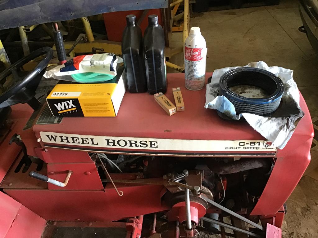

Pullstart 71,098 #91 Posted March 25, 2020 10 minutes ago, Tractorhead said: Is this the original dipstick or a replace ? I wonder about the marks in the lower side, so on my known engines this are the min/max values. is there another min max mak on it, except the both crossed marks on the end? 😳 I have no idea if this is the factory dipstick or not. I spoke with @Bill D on the phone and he pointed out things on this engine that makes him believe things have been replaced before. Either way, I know now where full should be according to the manual. I put this back together with fresh spark plugs and fresh oil. I replaced 2 oz oil with 2 oz Seafoam. This video shows this guy adding it to his Ford Ranger farm truck and the difference it made... so I’m giving it s shot. It’s also in the fuel system. At initial startup with the air breather off, there is just a bit of smoke from the vent tubes and none from the exhaust. After a minute or two it begins smoking more and even out of the exhaust. Bill also mentioned pulling one plug wire at a time while it’s running and listen for any difference in tune between the front and rear cylinders. It still runs on either cylinder, but a much different tone comes from each one. I’ll run it for a while with that seafoam inside and see if anything changes. Next will be a compression check. 1 Share this post Link to post Share on other sites
