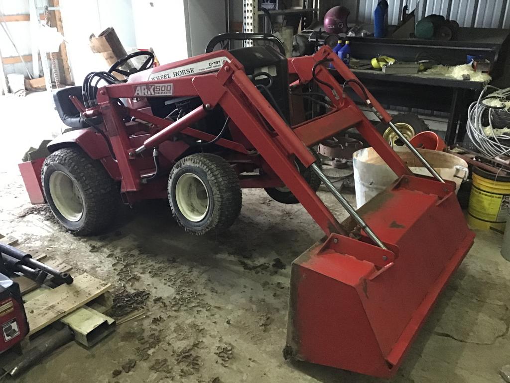

Pullstart 71,366 #1 Posted March 23, 2020 Well, I’m in the new fandangled brotherhood of Blackhoods, I suppose! This already has a steel fender pan and the FEL makes the hood look most proportionate. I’m doing a base line on this. The front axle is very tight, spindles are well greased and one tie rod is a bit loose but nothing to worry about. There is one outer wheel bearing that is sloppy, so I’ll add that to a needed list. I am going to remove the hood for safe keeping for a bit. There’s a bit of a miss that I plan to diagnose and other than fluids, this is a good solid tractor. @jay bee told @zekepiks that I was looking for a FEL and Skip responded to me via Redsquare. I appreciate them both! I have yet to meet Jay Bee, but Skip is a very nice man and was as up front and honest as he possibly could be with everything. I’m tickled Pink! 8 22 6 Share this post Link to post Share on other sites

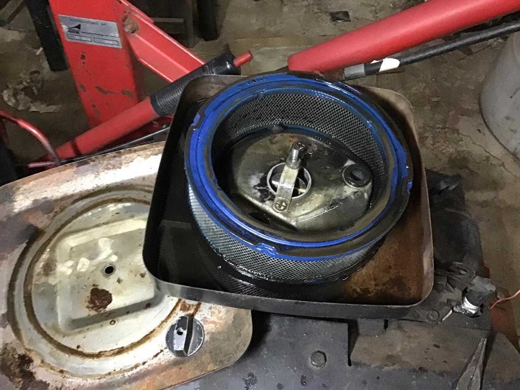

Pullstart 71,366 #9 Posted March 23, 2020 I have removed the hood and weight box. Note the amount of oil in the air cleaner... I feel like this machine simply does not enjoy enjoy being run at a steep angle. 1 Share this post Link to post Share on other sites

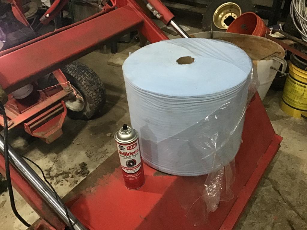

Pullstart 71,366 #13 Posted March 23, 2020 When times of butt wipe are scarce, my wife found this amazing roll of shop rags on Amazon on one of their flash sales! 7 1 Share this post Link to post Share on other sites
The Tuul Crib 7,354 #14 Posted March 24, 2020 Nice!! But somehow l dont think you will be able to reach the top of the rack with it. You'll have to send us a video of it in action! 4 Share this post Link to post Share on other sites
JAinVA 4,638 #15 Posted March 24, 2020 (edited) Know the feeling so I'm building one from PF engineering plans.Since member Rexemouse showed us his I got the bug.Those shop towels might help in a TP shortage but Roids will be in great supply if you use them for that. Edited March 24, 2020 by JAinVA 1 3 Share this post Link to post Share on other sites

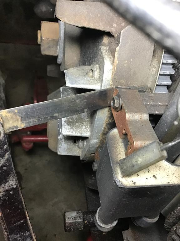

Pullstart 71,366 #18 Posted March 24, 2020 The tractor came with an engine service manual. I have cleaned and adjusted the gaps to .030”. One was a bit big and one was spot on. Share this post Link to post Share on other sites
Pullstart 71,366 #19 Posted March 24, 2020 The Magnetron coil gap is about twice what it should be. I’ll tighten that up. It was running like the choke was partially on, like there’s a miss. The carb is freshly rebuilt as of last week by a local shop. 2 1 Share this post Link to post Share on other sites
SylvanLakeWH 32,701 #20 Posted March 24, 2020 (edited) 42 minutes ago, pullstart said: When times of butt wipe are scarce, my wife found this amazing roll of shop rags on Amazon on one of their flash sales! Once again, please, no video or pictures... Edited March 24, 2020 by SylvanLakeWH 1 4 Share this post Link to post Share on other sites

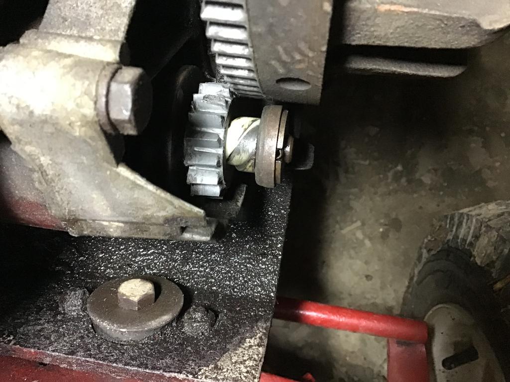

Pullstart 71,366 #23 Posted March 24, 2020 I have figured out the starter has no spring between the roll pin retainer and the starter gear. It just bounces around. If anyone has an idea of size spring I need, I’d like to get that fixed up. 1 Share this post Link to post Share on other sites
