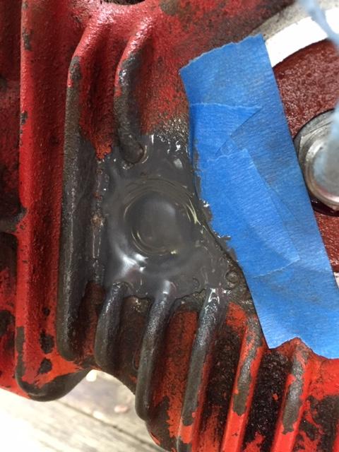

Sailman 1,307 #29 Posted March 26, 2020 Well I just saw the last several posts and appreciate the info. However, I had already gone at the tractor today with the JB weld idea...I cleaned it real good with a dremel and satinless steel wheel, acetone. Took everything including the cap and surrounding cast down to metal. Did not see anything unusual like a crack in the cap or distortions, just paint chips. Put the JB weld over the surface and overlapped onto the casting but did not try to force any into the cracks. The fluid had been leaking from the left side and lower part of the cap. Just looked like it was leaking around the cap. We shall see!! Life is an adventure right??? 1 2 Share this post Link to post Share on other sites
Sailman 1,307 #30 Posted March 29, 2020 Considered the suggestions to put a rubber cap over the leak but the bearing cap is flush with the engine casting so nothing to attach it to. Also not too worried about JB weld getting into the transmission as the leak around the bearing cap was small and did not try to force any into the crack. Even with the transmission drained and the filter off it continued to weep out of the filter port so cant imagine the JB Weld sticking to anything inside with all that ATF fuid coating bearings, etc. This is first coat of JB weld. Had drained and filtered ATF fluid with NO METAL so keeping my fingers crossed. 1 Share this post Link to post Share on other sites
Sailman 1,307 #31 Posted March 29, 2020 Here is second coat of JB Weld. Refilled ATF and no weeping, but have not run engine yet. Will have rim welded and new tire on this week and will give it the driving test to see how it works. 1 Share this post Link to post Share on other sites
ZXT 2,402 #32 Posted March 29, 2020 3 minutes ago, Sailman said: Here is second coat of JB Weld. Refilled ATF and no weeping, but have not run engine yet. Will have rim welded and new tire on this week and will give it the driving test to see how it works. Excellent! Assuming you got the area you JB welded good and clean (though the area round it looks rather oily), I can't imagine it leaking from there any more. Glad to hear that there was no glitter in the trans oil. Looks like you'll be back in business soon! 1 Share this post Link to post Share on other sites
Sailman 1,307 #33 Posted March 29, 2020 Area with the JB Weld was thoroughly scuffed, all paint removed and acetone wiped. Clean as a babys....... you get the point. Double coat for strength. Thanks! 2 1 Share this post Link to post Share on other sites
stevasaurus 23,857 #34 Posted March 29, 2020 Excellent job there...I just keep thinking of the guy that has to change out that bearing sooner or later. I wonder if just, after you cleaned the area like you did, if a little spar varnish might have done the same thing. Just thinking. 1 Share this post Link to post Share on other sites
