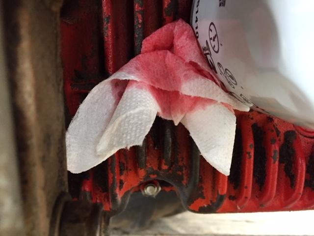

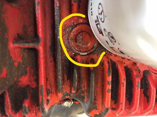

Sailman 1,307 #1 Posted March 22, 2020 Just introduced myself as a newbie and had a question about a transmission leak. Engine ran great and transmission worked but leaking back tire kept me from test drive other than onto the trailer. Did notice the liquid stain under the rear when I bought it. Turns out after draining and refilling the transmission with fluid the leak is coming from a round spot (seal?) just below and to the left of the filter. Drained almost a quart out and seems to have slowed the leak down some. Please advise what that is...I am prepared for the bad news...:( 1 1 Share this post Link to post Share on other sites
pfrederi 21,190 #2 Posted March 22, 2020 The circled disc is really a closed end needle bearing. Replacement will mean splitting the rear end and pressing it out and replacing. A fairly big job. Are you absolutely sure that is the source of the leak. I have never seen one leak. I would clean things up really well run it a bit and see if the leak is higher up and it is running down. leak from the filter would be more common. Is the bottom front edge of the transaxle wet?? That would suggest the motion control a fairly common leak. Welcome 4 1 Share this post Link to post Share on other sites

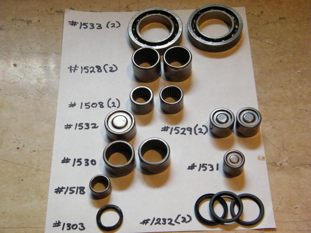

stevasaurus 23,857 #3 Posted March 22, 2020 Right, those cap bearings do not usually leak. Here is what one looks like. There is a few there...just a needle bearing with a cap on it. 2 1 Share this post Link to post Share on other sites

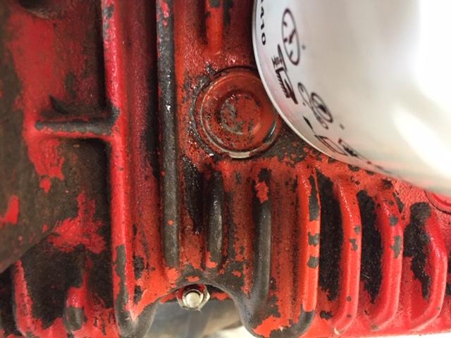

Sailman 1,307 #4 Posted March 22, 2020 Thanks for the reply. Figured someone here would have an answer! There is no question that it is leaking from that spot. Have wiped it dry as a bone and can actually see it seeping around the "cap". Could it be an o ring inside the cap? Possible to replace that without splitting cases, etc? 2 Share this post Link to post Share on other sites
squonk 48,167 #5 Posted March 22, 2020 (edited) I would clean the area with non-chlorinated brake cleaner, scuff it with sand paper and try to seal it with JB Weld or something similar. What do you have to lose. Edited March 22, 2020 by squonk 4 1 Share this post Link to post Share on other sites
pfrederi 21,190 #6 Posted March 22, 2020 I would try that first. Replacement is a BIG project. i would however listen for nay rattles noises if the bearing is failing may cause the leak and then replacement is needed. self destructing bearing release metal pieces into the hydro system ..and that is a bad thing. 2 Share this post Link to post Share on other sites

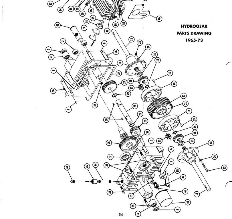

Sailman 1,307 #9 Posted March 22, 2020 Thanks Pfrederi. Are there any diagrams or manuals available with the schematics of this sundstrand tranny? Share this post Link to post Share on other sites
pfrederi 21,190 #10 Posted March 22, 2020 (edited) Yes The bearing in question support teh mushroom gear (44 and 11 teeth. Item number #25 Manual is here Edited March 22, 2020 by pfrederi 1 2 Share this post Link to post Share on other sites

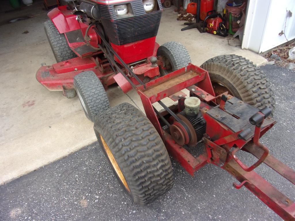

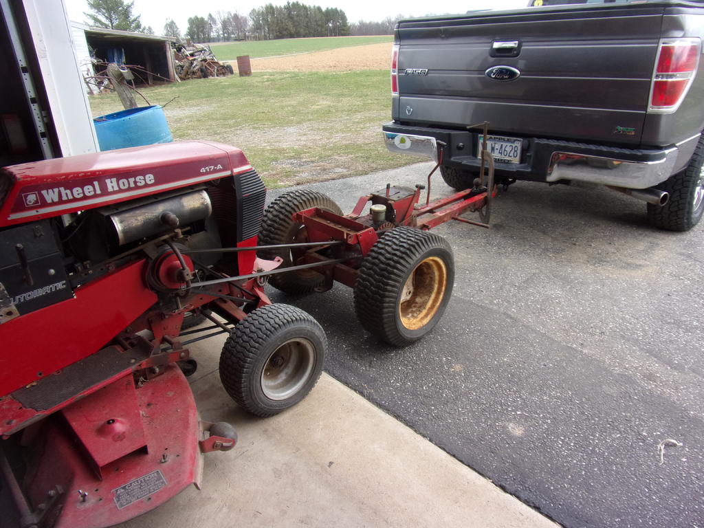

Ed Kennell 47,412 #18 Posted March 22, 2020 Looks like the hydro gurus (Paul, Steve, Richard, and Mike) have you covered. When I buy a questionable hydro, I always chain it to a tree or in this a Ford and make sure it will spin the tires with me in the seat.. If it operates through the full range of F/R motion with no noise or jerking I consider it a good hydro. For the tractors with non running engines, I power the hydro from the rear with another tractor's PTO. 2 1 Share this post Link to post Share on other sites
Sailman 1,307 #19 Posted March 22, 2020 Wow! Thats a set up... So help me understand. If the hydro is good and strong, no noises then the hydro is good. That would warrant repairing the needle bearing issue which is a separate unit in the gear box, correct? 1 1 Share this post Link to post Share on other sites
Ed Kennell 47,412 #20 Posted March 23, 2020 Yes, IMO, if a hydro passes this "dyno" load test, it is probably OK and I would continue with the necessary repairs. Sealing the leak on the outside could last a long time. I would consider cleaning and prepping a larger area and using fiberglas cloth to reinforce the patch. Share this post Link to post Share on other sites
953 nut 69,581 #21 Posted March 23, 2020 18 minutes ago, Sailman said: Wow! Thats a set up... So help me understand. If the hydro is good and strong, no noises then the hydro is good. That would warrant repairing the needle bearing issue which is a separate unit in the gear box, correct? YES The axle assembly is driven by the power unit and the Hydrogear. There are about eight bolts that attach the Hydrogear to the transaxle and that entire unit can stay on the tractor once we know it is good. There is a lot of sheet metal and other stuff to remove which will consume the better part of a day.. There are several good threads on the subject on this site, when the time comes we will hook you up with a few. For now you should get it running and driving to know what you have that is god and what may need attention. Share this post Link to post Share on other sites
