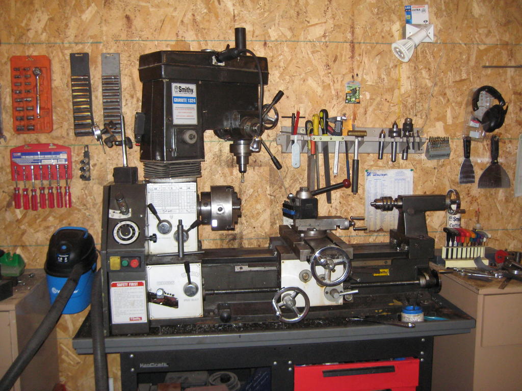

bc.gold 3,406 #26 Posted March 18, 2020 I don't imagine this being a daily driver and maybe laid up for extended periods, might be a good idea to install stainless steel liners in those slave cylinders to prevent pitting. Brake fluid also has an affinity for moisture, and the water vapor in the air can combine with the brake fluid, lowering its boiling point and, in cold weather, forming ice crystals that make braking difficult. We wanna see pictures of your lathe 1 Share this post Link to post Share on other sites

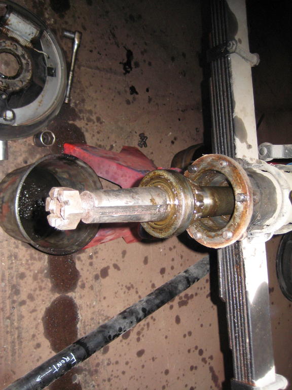

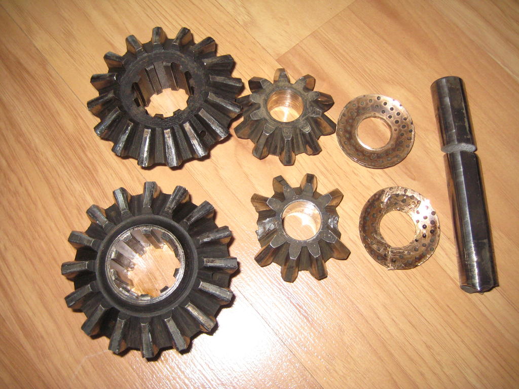

Cvans 1,009 #27 Posted March 18, 2020 This is were I stand until I can find parts. As suspected the spider gears had fallen to the bottom of the housing. It appears that at least one of the spiders had started to freeze to the shaft and the shaft broke into 3 pieces. Two cogs are missing on one spider and the other 3 gears are damaged. Both of the conical spacers are shot. The carrier, ring and pinion are good. Please check your pockets as I could really use these parts. 5 Share this post Link to post Share on other sites

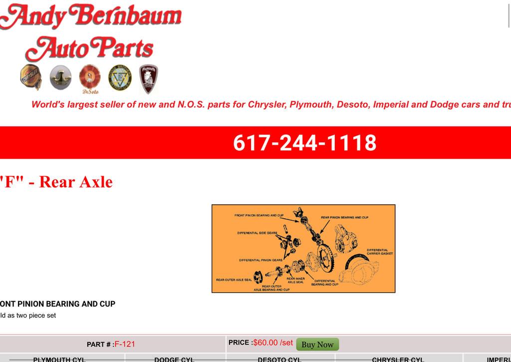

Pullstart 71,020 #28 Posted March 19, 2020 That’s unfortunate for sure! Are there any rear ends that could be donors? I found this site just now... https://m.oldmoparts.com/parts-rear-axle.aspx 1 1 Share this post Link to post Share on other sites

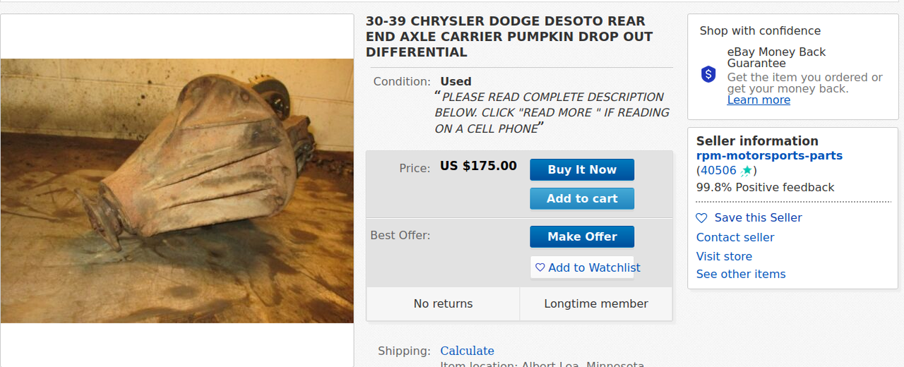

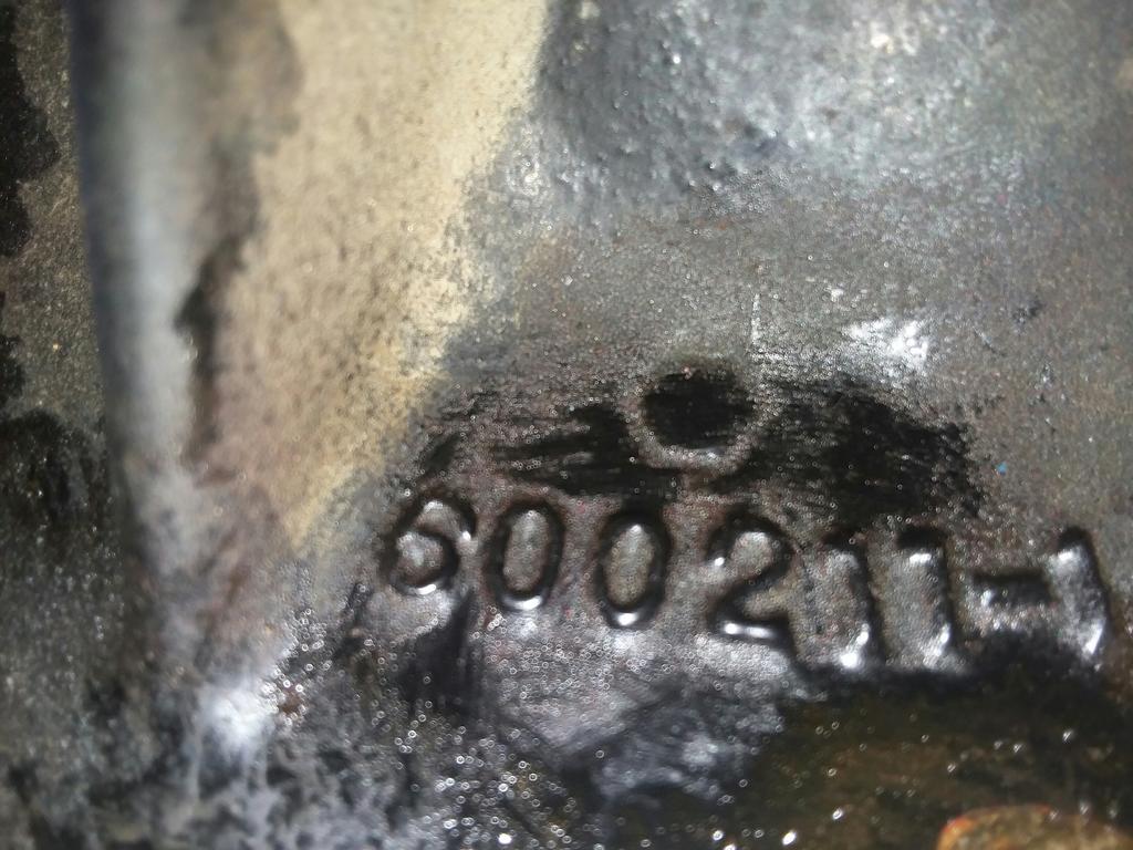

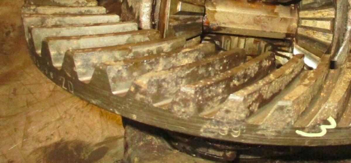

bc.gold 3,406 #30 Posted March 19, 2020 (edited) Your rear diff was more than likely manufactured by the Dana Corp, who made differentials for many car and truck companies. Can you give us a photo showing the numbers and any mfg logo from the crown, sometimes the numbers will be stamped into the end on the pinion.. Parts book shows it will fit: 1930 through 1937 Chrysler CD, CP, CT, CQ, 8, Airflow CU, CV, C1, C2, C3, C9, C10, C11, C17 1931 Chrysler CM6 with serial # 6540542 and up 1931-1932 Chrysler CI6 1933 Chrysler CO 6 and 7 passenger 1930 through 1932 Desoto CF, 8 1930 through 1932 Dodge DH6 built after April 1930, DD, DE, DF, DI, DL6 1930 through 1933 Dodge 8cyl cars 1937 Dodge trucks MD15, 16, 20, 21, TD20, 21, 3/4 and 1 ton 1938-1939 Dodge RD15, 16, 20, 21, TD20, 21 3/4 AND 1 ton Case is in good condition Spins smooth. Gears are clean Has 43/10 gears ( 4.30 ratio ) Edited March 19, 2020 by bcgold Share this post Link to post Share on other sites
Cvans 1,009 #31 Posted March 19, 2020 This is the only thing I've seen so far. Its on the carrier housing. I have to ask, where are you finding your information? Thank you for the effort your putting into this! Share this post Link to post Share on other sites
bc.gold 3,406 #32 Posted March 19, 2020 The pumpkin I've posted the image of is currently on fleabay, did not include a link to the auction but the sellers ID is visible. Maybe a Mopar enthusiast can tell us when Chrysler started using the corporate differential, those used before hand would have been manufactures by Dana / Spicer. Looks like the rear cover gasket has 11 holes 1 Share this post Link to post Share on other sites

Cvans 1,009 #39 Posted March 19, 2020 14 hours ago, bcgold said: 1930 through 1932 Desoto CF, 8 Unfortunately this information may not be correct. My ring gear is 35 teeth and the pinion is 8. My housing has tenth bolts not the 12 shown in the photo. Dang it anyhow. Thanks for posting it and I'm going to contact them anyway as they might know of something. Share this post Link to post Share on other sites
Cvans 1,009 #40 Posted March 19, 2020 (edited) 21 hours ago, bcgold said: We wanna see pictures of your lathe It's a Smithy Granite 13x24". Would have preferred separate lathe and milling machine but space was limited and I fell into a deal I couldn't walk away from. I would not use this machine for production work but for what I do it has turned out to be amazingly versatile. I don't know anything about CNC or digital readouts so this has fit my mentality pretty well. Smithy is good about providing support for their equipment and that has been a plus. Edited March 19, 2020 by Cvans 3 2 Share this post Link to post Share on other sites

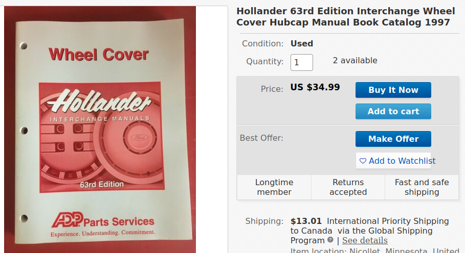

bc.gold 3,406 #44 Posted March 20, 2020 2 hours ago, JERSEYHAWG / Glenn said: That is so cool. I had a 1928 Franklin Airman for about ten years. I miss that car. Air cooled motor, no radiator. Way ahead of its time. Really enjoying the story on your car. Thank you for sharing it with us. Glenn The Blacksmith in Cloverdale BC had a Franklin, if I remember correctly each cylinder had a glass valve cover. 2 Share this post Link to post Share on other sites

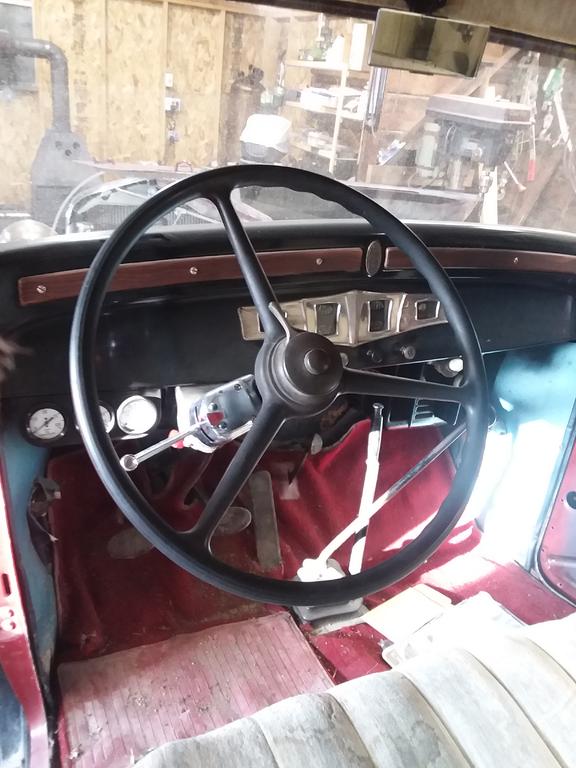

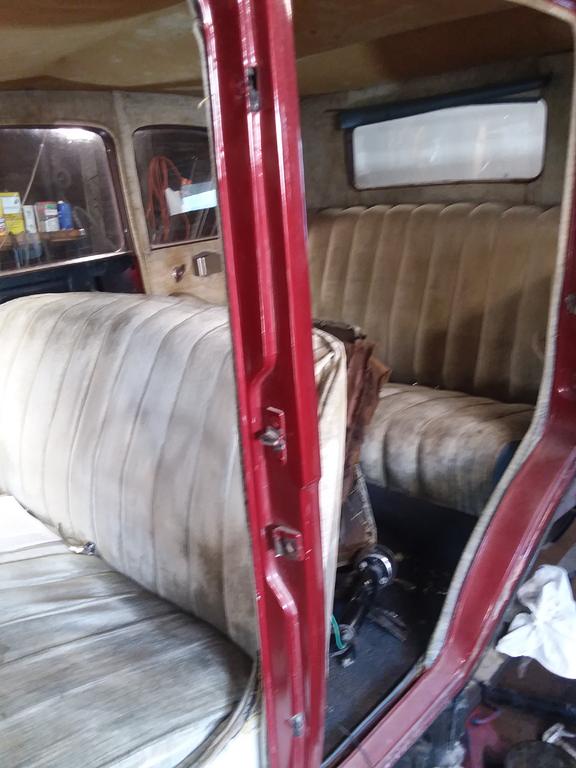

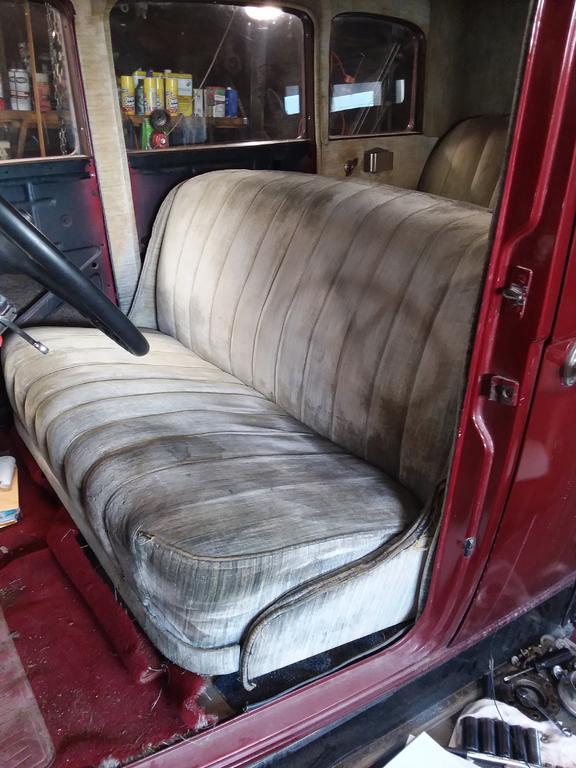

Cvans 1,009 #46 Posted March 21, 2020 I think a fender has been found for the car. I'll know for sure tomorrow. Got my fingers crossed. For those interested in the interior here is a couple of photos. The interior door panels had been removed to be replaced and are on the back floor. 5 2 Share this post Link to post Share on other sites

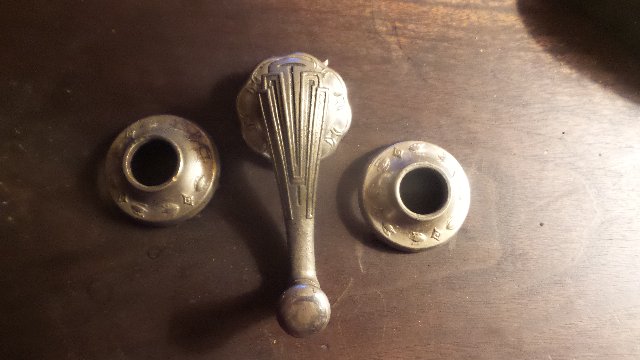

bc.gold 3,406 #47 Posted March 21, 2020 A few years ago started collecting window cranks and door handles, this is the extent of my collection. What do your cranks and handles look like. 1 Share this post Link to post Share on other sites
Cvans 1,009 #48 Posted March 21, 2020 (edited) I'll have to look tomorrow. What are those out of??? Edited March 21, 2020 by Cvans 1 Share this post Link to post Share on other sites
Stormin 9,988 #49 Posted March 21, 2020 7 hours ago, Cvans said: That's a complicated dashboard. Where are all the idiot lights, multitude of switches, radio/cd, sat nav etc. etc.?? All those things that are so essential these days. 5 Share this post Link to post Share on other sites
ebinmaine 80,130 #50 Posted March 21, 2020 41 minutes ago, Stormin said: sat nav Prolly one o those cars where ya have to LOOK where you're going to get there. 1 1 1 2 Share this post Link to post Share on other sites
