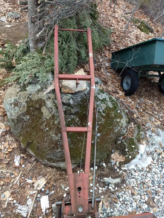

Here's a pic of Trina's plow frame that was originally on a 1974 C 160.
Notice how about 40% of the distance of the frame rails are Parallel to each other, then the triangulation begins. That tells you it's a Long Frame plow. A short frame plow would be triangular from one end to the other.
Long frame plows begin production somewhere around 1967 or 68 so you "only"  have about 50 years worth of range to choose from.

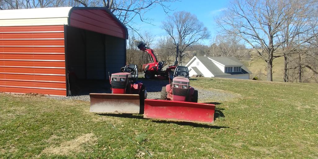

The width of the plow is somewhat to personal preference and somewhat to the capabilities of the machine being used.. This particular tractor has a 42 inch wide plow and that works quite well for most of us.
On my Cinnamon Horse I have wider front tires and wheels so I prefer a 48" wide plow.
The BIGGEST issue when using a plow is going to be TRACTION. You NEED a lot of weight and you probably should use chains.
WVHillbilly520H
Why not a 56" (on the right) ... Chains really (it's rather steep at my place) 😆 ... On a more serious note the design of the :wh: snow plow mount actually transfers the force against the plow to the rear axle aiding in tractive forces at least IMO vs other brands.

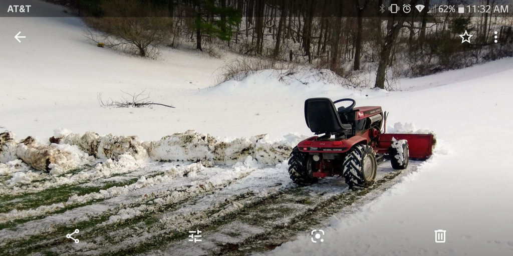

Found a plow and hooked it up. Just in time for a nor'easter to hit. Works good. Definitely gotta fabricate a down preassure bar for moving dirt this spring though.
Thanks for the help everyone.
