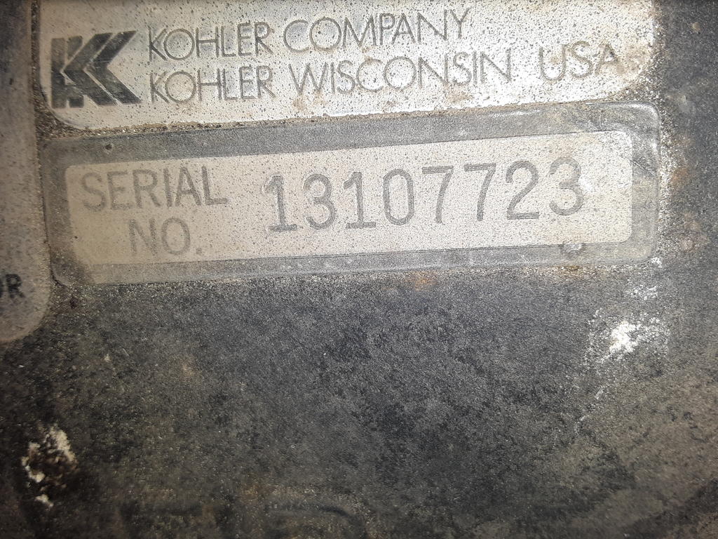

Oldskool 6,678 #85 Posted March 12, 2020 The guy sent these pics of the tag today. I hope these help 1 Share this post Link to post Share on other sites

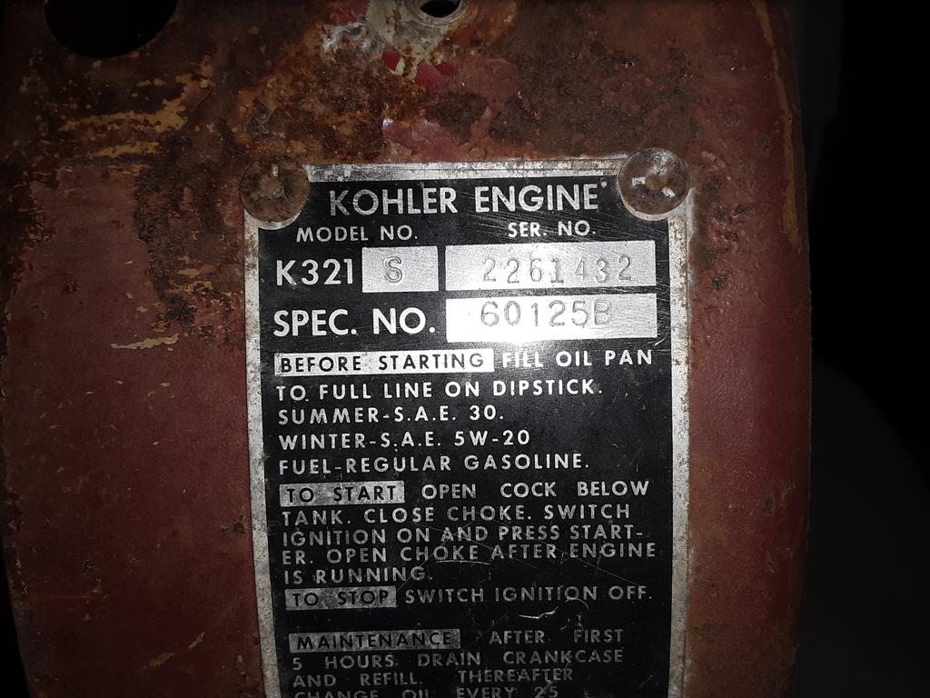

Oldskool 6,678 #86 Posted March 12, 2020 Here is the tag off the GT's engine. I hope there is good news Share this post Link to post Share on other sites
gwest_ca-(File Mod) 12,361 #87 Posted March 12, 2020 Kohler made the K321AS-60410 for Ingersoll Equipment in 1983 Kohler made the K321S-60125B for Wheel Horse in 1970 The serial numbers are used to determine the year of Kohler manufacture. Garry 1 Share this post Link to post Share on other sites
Oldskool 6,678 #88 Posted March 12, 2020 1 minute ago, gwest_ca said: Kohler made the K321AS-60410 for Ingersoll Equipment in 1983 Kohler made the K321S-60125B for Wheel Horse in 1970 Garry Will the 60410 fit in place of the 60125B? Share this post Link to post Share on other sites

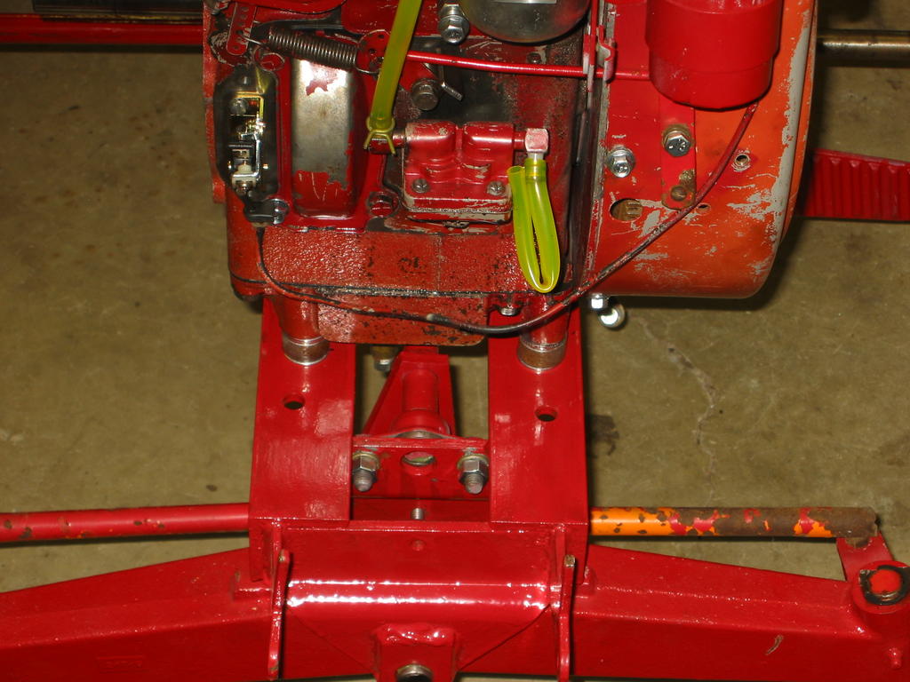

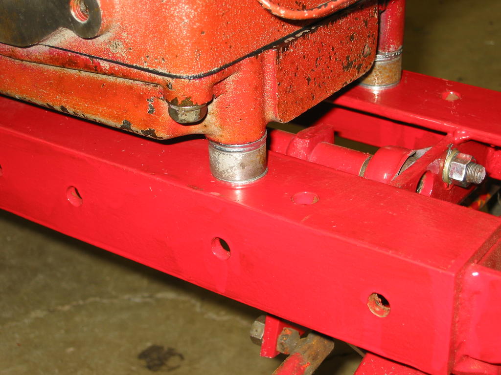

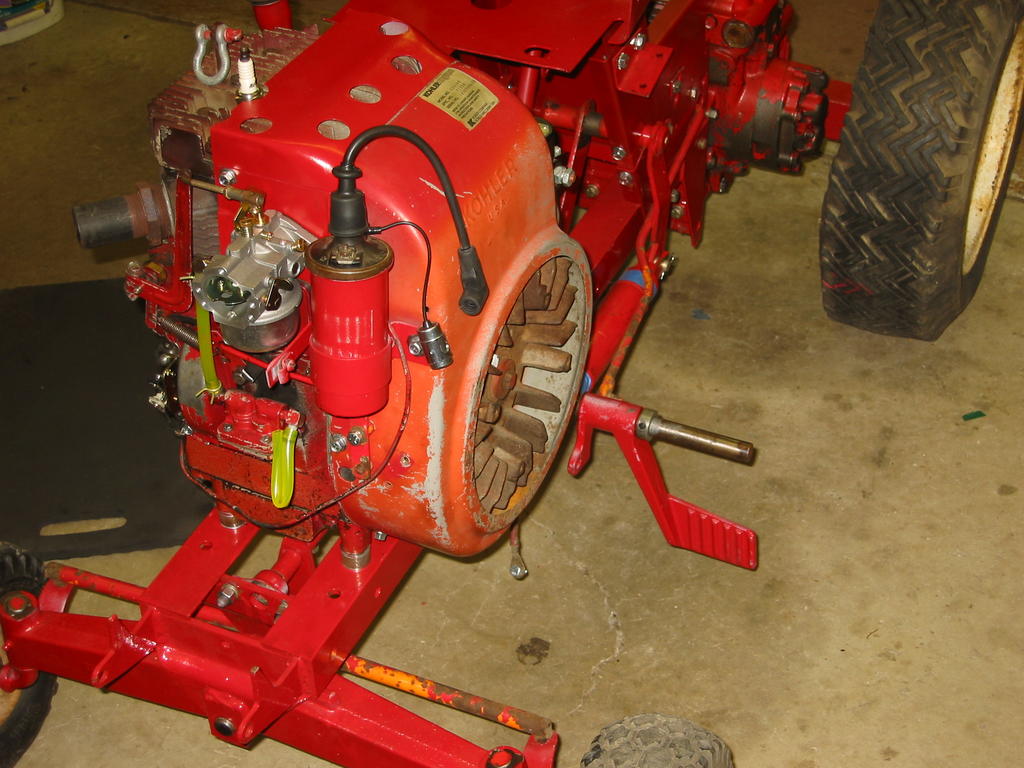

pfrederi 20,871 #89 Posted March 13, 2020 Not directly if it is the small oil pan, and you can't just swap pans, the base of the block is different . Look at the pinned post in the engine forum Identifying big block Kohler blocks. I will take a couple pics later of how i put the AS style engine on an Electro. 1 Share this post Link to post Share on other sites
Oldskool 6,678 #90 Posted March 13, 2020 57 minutes ago, pfrederi said: Not directly if it is the small oil pan, and you can't just swap pans, the base of the block is different . Look at the pinned post in the engine forum Identifying big block Kohler blocks. I will take a couple pics later of how i put the AS style engine on an Electro. I just put eyes on the engine. Now I see the difference. It looks like I might be able to modify the mounting plate to make it work. Any body know if it's going to be troublesome getting the hydraulic pump off the shaft? Share this post Link to post Share on other sites
pfrederi 20,871 #91 Posted March 13, 2020 There is no engine plate on a GT14. The frame rails are further apart which will make getting the drop down part of oil pan in place easier than on the Electro but may cause a slight alignment issue with your drive pulley. For spacers I used the ones that came with K181 engines on shaker mounts. plus 3 washers. What hydro pump are you talking about? 1 1 Share this post Link to post Share on other sites

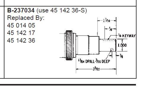

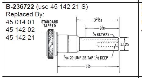

pfrederi 20,871 #93 Posted March 13, 2020 Can't help with pump removal but you may have a bigger issue. The crankshaft is kind of short... Share this post Link to post Share on other sites
pfrederi 20,871 #94 Posted March 13, 2020 Also doesn't look like it is drilled for the electric PTO \This is the WH spec Crank 1 Share this post Link to post Share on other sites
Oldskool 6,678 #95 Posted March 13, 2020 35 minutes ago, pfrederi said: Also doesn't look like it is drilled for the electric PTO \This is the WH spec Crank Dang. Way more than I wanted to mess with. To top it all off I haven't heard it fire yet. I think I will keep looking for a differant engine. Thanks for your time and the info. 1 Share this post Link to post Share on other sites
pfrederi 20,871 #96 Posted March 13, 2020 2 minutes ago, Oldskool said: Dang. Way more than I wanted to mess with. To top it all off I haven't heard it fire yet. I think I will keep looking for a differant engine. Thanks for your time and the info. Here is what you need to do before you commit to any other replacement engine. Go to Kohler engine site for parts. https://www.kohlerenginesparts.com/ Look up the spec number in question. get the crankshaft part number then go to eh manuals section here download the crankshaft reference look up the crank number and you can see the various measurements. 1 1 Share this post Link to post Share on other sites
