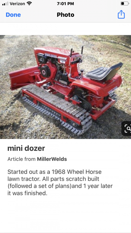

The Tuul Crib 7,354 #1 Posted March 4, 2020 A friend of mine just sent me the picture of this beauty I'm still waiting to find out where it exactly is located but wow! 5 8 1 2 Share this post Link to post Share on other sites

The Tuul Crib 7,354 #4 Posted March 4, 2020 What I want to know is how it operates you got an eight speed or you got to lever steers! Share this post Link to post Share on other sites
Achto 32,892 #5 Posted March 4, 2020 Good to see you on RS Crib. Was wondering if you were any where near the storm there. Hope all is well with you, friends, & family. Back to the crawler. I think that the two levers are to apply brakes on each side in order to steer. 1 Share this post Link to post Share on other sites

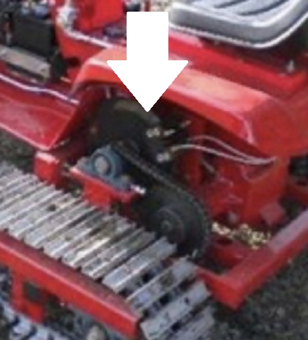

wallfish 20,724 #7 Posted March 4, 2020 9 minutes ago, Achto said: I think that the two levers are to apply brakes on each side in order to steer. Correct, you can see the disk and caliper. 3 Share this post Link to post Share on other sites
Pullstart 71,482 #8 Posted March 4, 2020 Looks like a diesel... @Achto did you build it? Could be a Radpferd cousin? 1 Share this post Link to post Share on other sites
diesel cowboy 263 #9 Posted March 4, 2020 Member @massey built it, but it looks likes he hasn't been on here in a year. Build thread is here: Too bad photobucket ruined the pics. The pics were impressive to see. 54 minutes ago, Achto said: I think that the two levers are to apply brakes on each side in order to steer. Yes the 2 levers are for steering. They go to the calipers @wallfish pointed out and run a pair of chains to the Uni-Drive axle shaft. There used to be a website to buy the plans from but its since gone away. I got a set myself and as he was only in the next town over from me I went and picked them up and talked to the guy. He said that it needed the steering setup that way to overcome the gearing in the transmission so it would turn 3 Share this post Link to post Share on other sites
