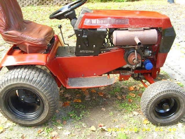

So guys was gonna splurge on this wh 520h this weekend got permission to borrow a buddies trailor and everything. So I decided to show it to the wife and talk to her about it. She sends the link to her father to look at it comes with a garden furrow snow plow and working deck. He wants 1650 for it but ive been talking to him and I'm pretty sure hed go to 1300. Now I'm getting it to plow snow and do garden work with. Father In law says it wont plow my driveway cuz its gravel and would move it around when I'm plowing. Now I had a snow blower that would do exactly the same thing.  except throw the gravel all the way into the middle of my yard. My drive is only 40 ft long and it is gravel does anyone really think this would be a problem? He saying its not what I need and I should go to the local tractor dealer and get a newer one and have a payment on it because he said in going to have a terrible time finding parts for it but I see these 520s often in my travel of the internet. I really dont want a 12000 dollar John deere. HELP ME!!!

@WHEELHORSEFAN*16 Do you think its worth the 1300 with the deck, rear garden plow, and snow plow? I hademt asked the hoirs on it but it does have a newer kohler engine
 Some one must have done an engine transplant. It should have an Onan engine in it. I would not let this fact stop me from buying the tractor but I would use it for leverage to try to get the price down.:ph34r: Like stated above, if you have a gravel drive way you will want to put some shoes on the blade so that it will not move your gravel out of the drive.

I don't think I would pay 1200 for that.  It does come with some goodies but it's been rattle canned and has a different engine in it.  Do you know the hours and hp? What else was done or not done to it.
I feel for the price you could get a better unit of you hang out here.

tom2p
engine swap - and condition (including  appearance)
price would need go much lower for me
and would need to dig deeper into mechanical condition
just my opinion
tom2p
agree

I don’t know what engine is on it and it appears that it had a rough life.  I wouldn’t pay more than half of the price asked.  There are unmolested tractors out there that are worth the money.

These older Wheel Horses will out work, and with proper care and if not abused, will outlast any of the newer stuff.
   That being said....I personally don't see a $1300 machine there.  Amateur rattle can at best paint job on the tractor and even less care was taken painting the rims, looks like the painter didn’t mask off the tires. Is that a trash bag over the seat??

It is a 25 hp kohler. Ive been looking for a freeking uear now for something. I've looked at 4 rjs but I know those won't do it for me. i inquired about @garymus c-160 package and was willing to drive all the way to p.a. for it. Inquired today about a 314 with a loader that was sold. I dont know what it is every time I go for one its sold. And I dont want a project I want it to work on my small farm and plow and maintain my driveway.
25hp is nice but still I would still stay away.  The hood doesn't look like it closes fully and is resting on the muffler.

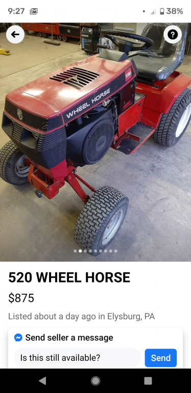

Here.  Much better deals.
  • Excellent 1

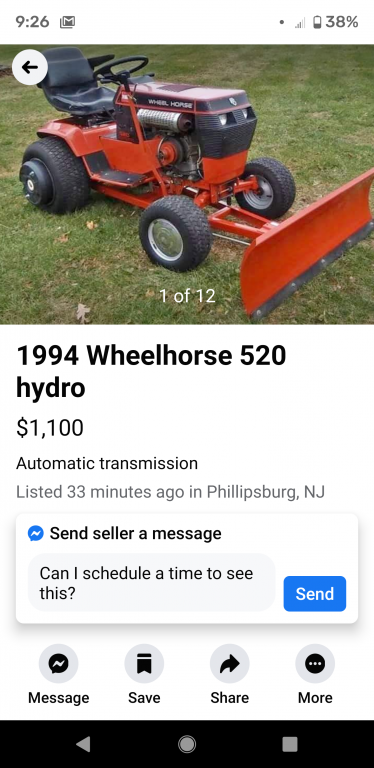

Ah man @WildmanC120 could you pm me that second ad possibly?
A trash bag with orange overspray, no less!
It might be a good working machine, but for that money, you can get one that hasn't been molested like that one has. Rattle can jobs ruin it IMO. I'd rather have one with the paint falling off.. That way you at least know what you have.
I'm not sure what brand the 25HP engine is, but I'm willing to bet that it doesnt have a thrust bearing that's necessary to run that PTO. Will cause engine damage in the long run!

Hi @Willlawre
firstly :text-welcomeconfetti: to :rs:
 about that pict you give us, it looks to me as a blender.
i don‘t know if the owner is here in the forum, but anyhow.
it is just my opinion about that pict i seen.
The paintjob seems to me horrible ( ok it‘s not everybody‘s thing to do that clean)
but i just have your picture as reference.
as next i see the plastic bag „cover“ on the seat, hum.... why?
additional the swaped Engine , aiaiai, as before mentioned
it looks also for me a bit loveless fuddled.
The rest of equippment mus‘nt beeing seen.
 My first thought was , hey that can be a nice project, but only if you ain‘t need it immediately.
as far as it runs it could be a nice future resto project.
with a bit of love and a a bit of care, it can be later on a great Buddy in the Property.
I woudn‘t bet on that 25HP engine,
in my humble opinion this swap firstly have to be proven if it last‘s.
if so fine, but i would calculate with an Engineswap within a year.
the missing picts of the other parts i would give a max. Of 200 for the tractor,
because you cannot see, what surprises you next.
how about the tranny, how about the steering, did you do a test drive on it?
are you feel comfortable?
All switches do what they shall do? Any added switches without known function?
will the battery charged by Engine genny?
On that price he asking, everything must work in good condition and no doubts shall be up.
it‘s up to you.
  • Excellent 1

@Willlawre
The tractor in the pic looks like someone found a rolling parts tractor and tossed a spare engine in to make a buck.
It really does look beat up.
If you're interested in buying a machine and doing all the maintenance yourself be sure to equate the complexity of the machine to your personal level of mechanical ability.
