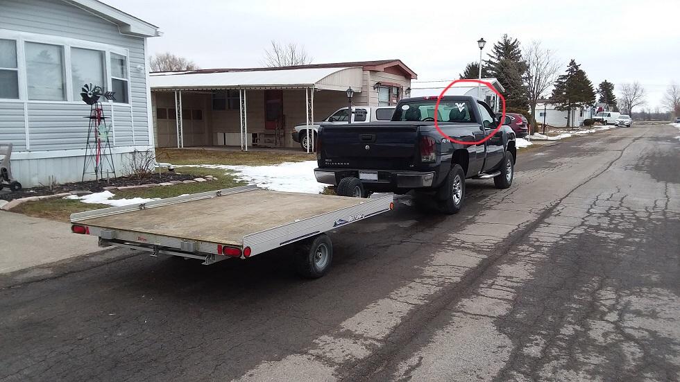

Digger 66 3,530 #1 Posted February 23, 2020 (edited) Hey fellas . I just scored this little gem yesterday and I will be going all over it shortly . The thing's in immaculate shape : -Dexter torsion type axle -(Lockable) Stow-able on-board ramp for rear or side-loading (Lockable) spare tire and carrier -Bearing Buddies -Tongue jack -Rigid tie-downs at front & rear and adjustable anchor points along the side rails All welds are in great shape and trailer measured out perfectly square The question I have is when I am replacing the decking , what screws can be used to eliminate the reaction of dissimilar metals ( galvanic corrosion ) ? Everything I'm reading says Aluminum screws into an Aluminum frame are best but , I'm worrying that the heads may be too soft and strip when it comes time to remove them again . Stainless seems to be the best other option but will still encourage galvanic corrosion to some degree . The Aluminum screws are as expensive as heck ( though I'm not really worried about the $ factor ) and I can't seem to find them with a wide enough head . Calling all would-be metallurgists ! What would you do ? Thanks all ! Here's a pic a snapped while at the sellers house . Edited February 23, 2020 by Digger 66 2 1 Share this post Link to post Share on other sites
