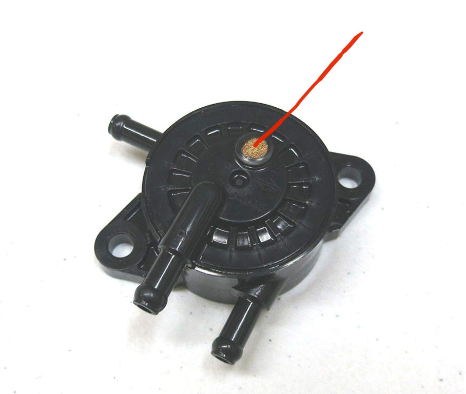

19richie66 17,937 #105 Posted March 6, 2020 Make sure the “atmospheric vent” on the pulse pump isn’t plugged with dirt. They get jam packed with crud and then the valves inside the pump can’t “breathe” 1 1 Share this post Link to post Share on other sites

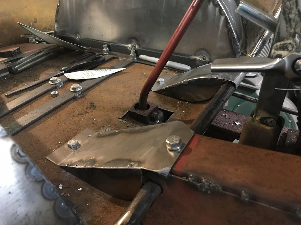

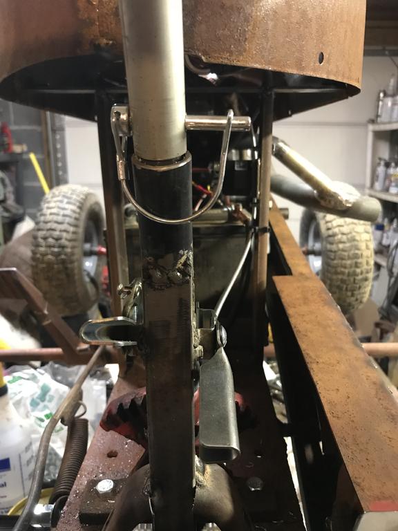

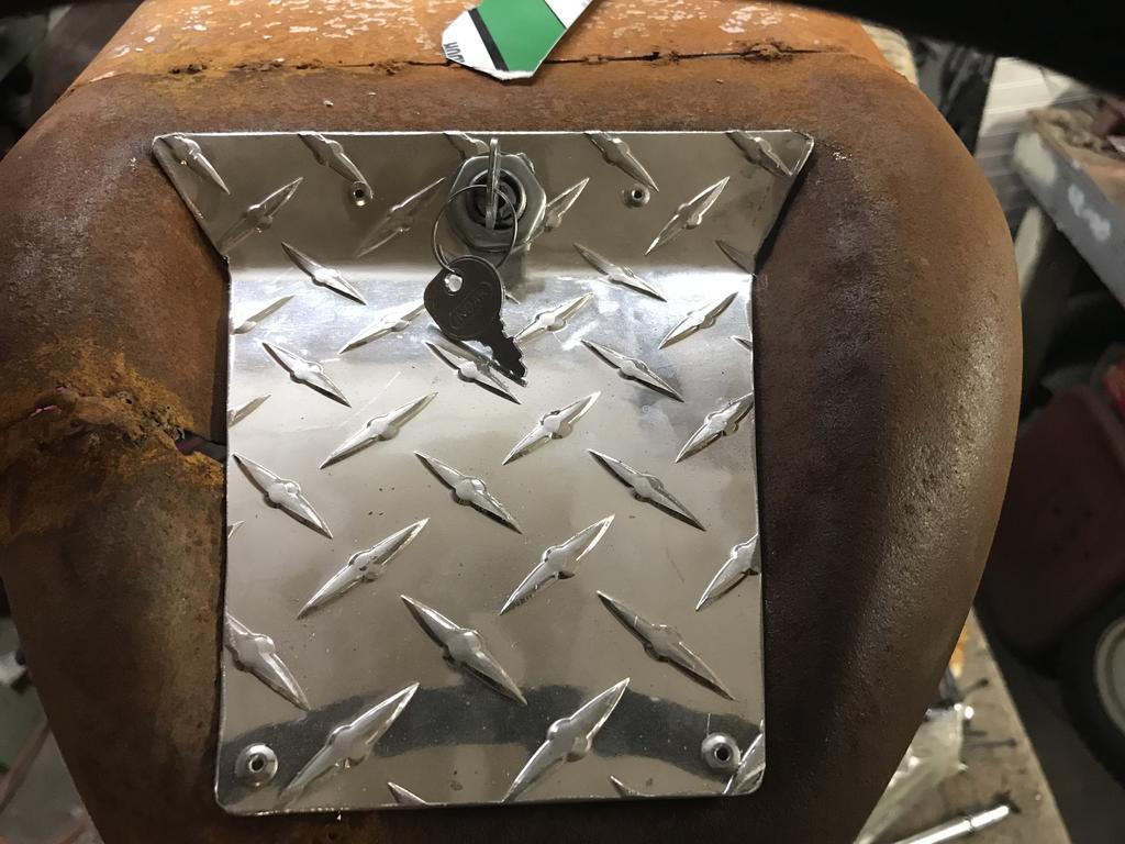

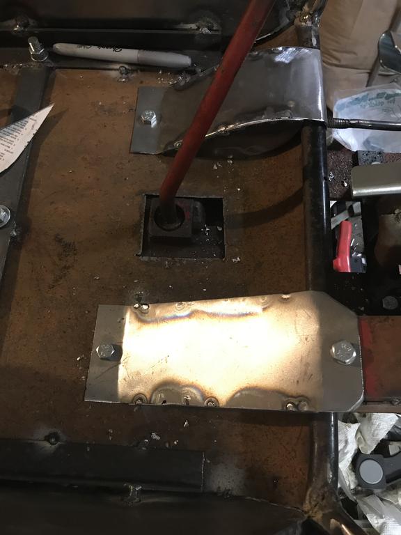

dells68 7,499 #108 Posted March 8, 2020 Just a little more tinkering tonight. I made covers for the belt and brake setup where they protrude into the tub. I also made an aluminum panel to cover some of the backed dash and drilled a place to mount the ignition switch. Here’s also a pic of the choke, throttle, and steering pin. 4 1 1 1 Share this post Link to post Share on other sites

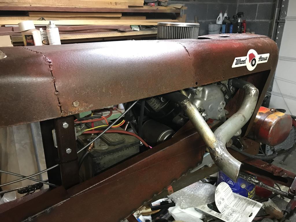

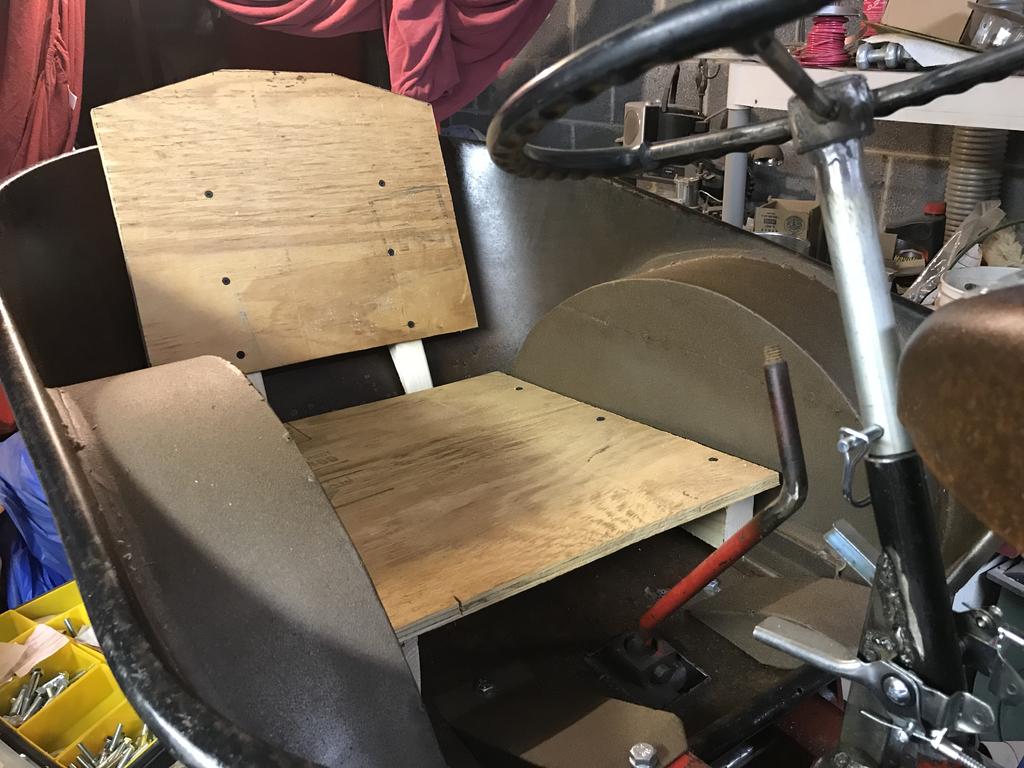

dells68 7,499 #110 Posted March 12, 2020 Had a chance a couple of nights ago to rub down the sheet metal with boiled linseed oil. I really like the colors that popped on the gas tank when I oiled it. I also used a rusty brown paint on the fender wells to age them without having to worry about rust getting all over me. I also made up my seat supports/plywood to get ready to foam and cover them. Getting there slowly! 5 6 Share this post Link to post Share on other sites

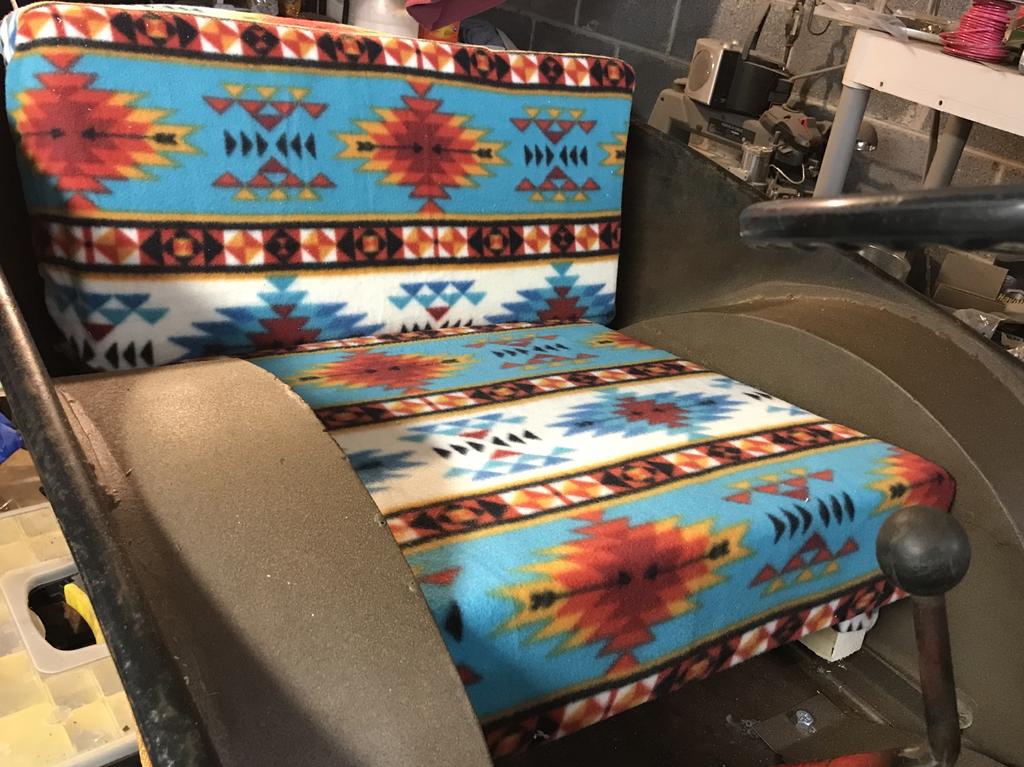

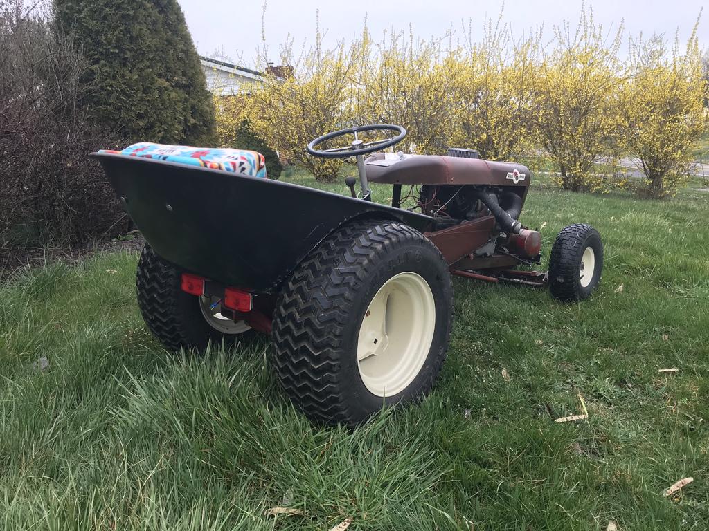

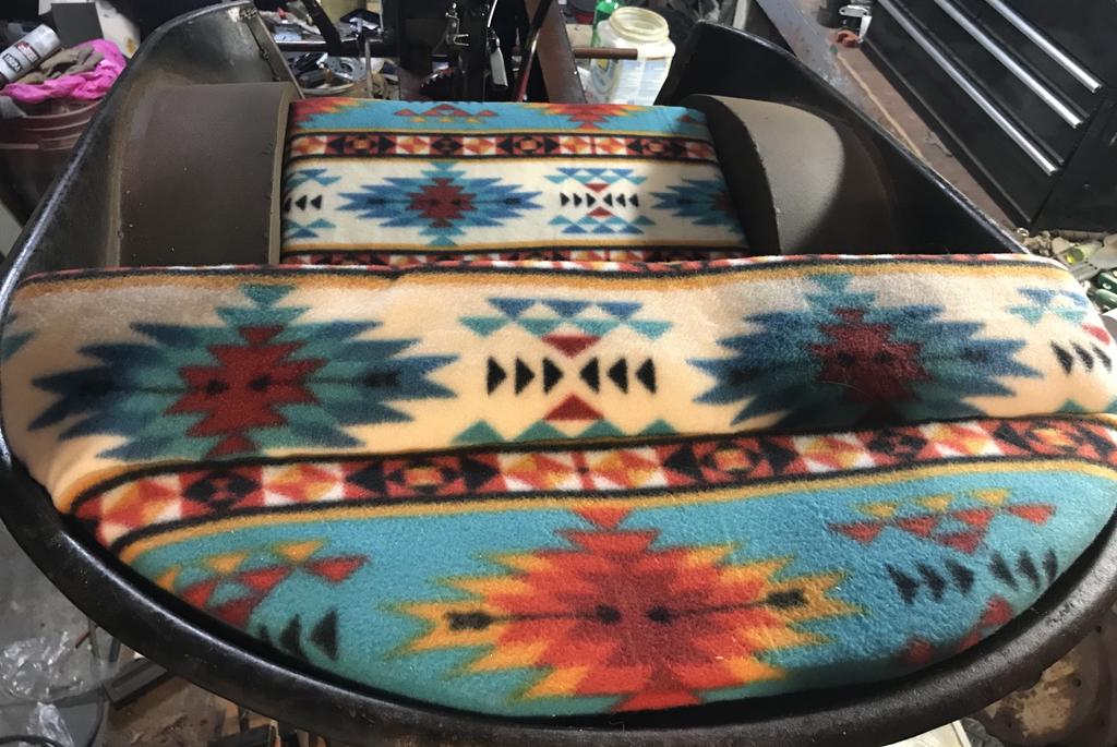

dells68 7,499 #112 Posted March 14, 2020 Another quick update. Since corona is here and we can’t really get out, I’ve worked on the horse a little. I pressure washed the tires I’m going to use on it and plan to tube the back ones later tonight. I had bought some foam and a Indian looking blanket to cover the seat with. Really wanted a Mexican blanket, it couldn’t find any locally, so this will have to do. I decided to shorten and widen the back a little. Here’s how it looked installed. I think it turned out ok. 2 6 1 Share this post Link to post Share on other sites

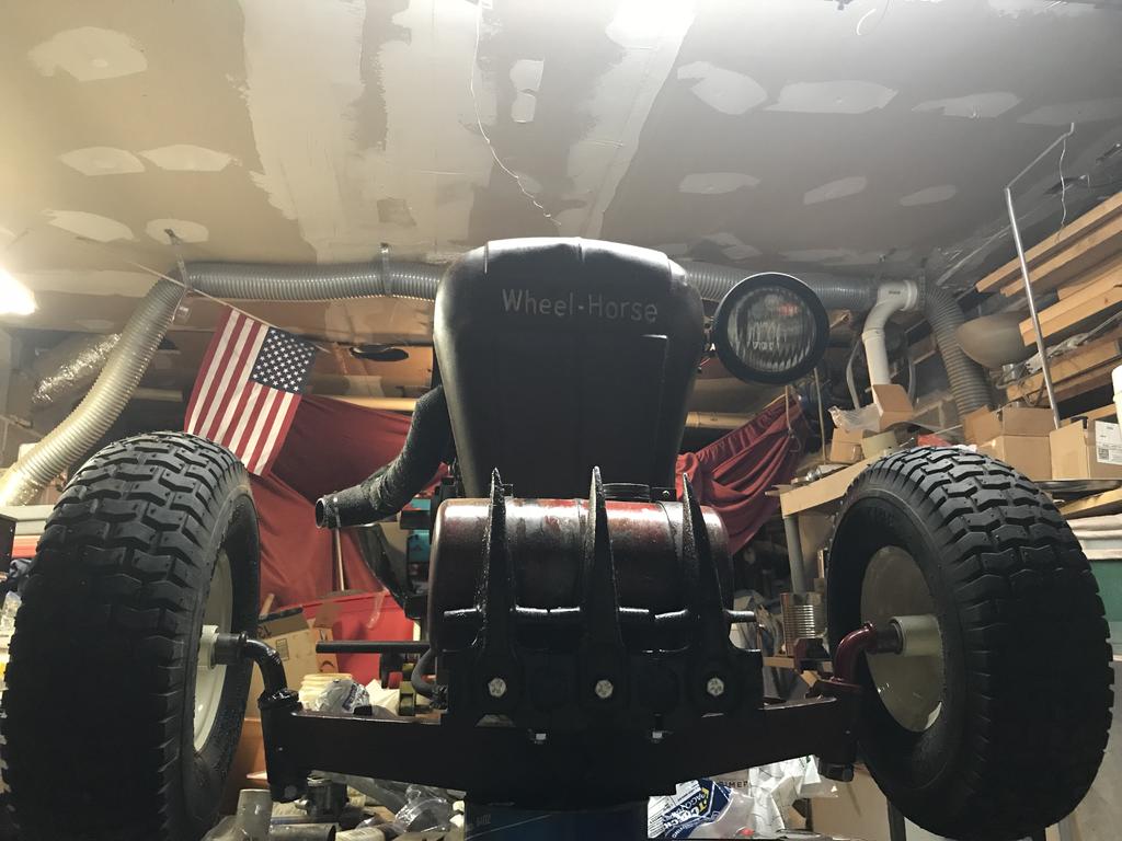

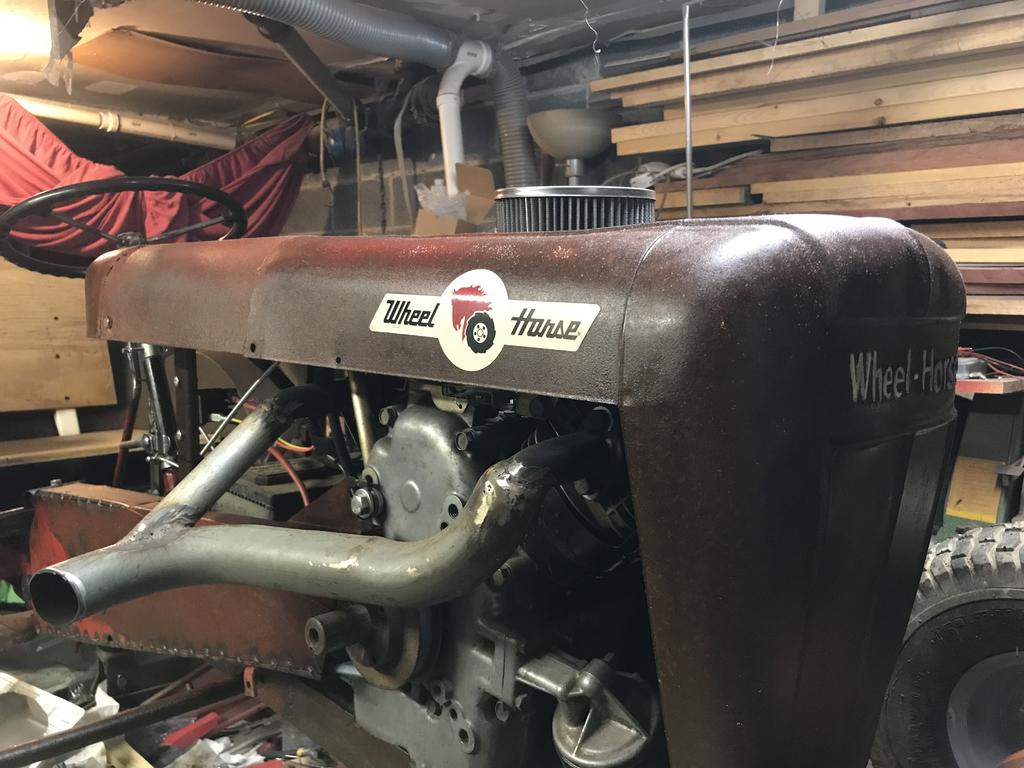

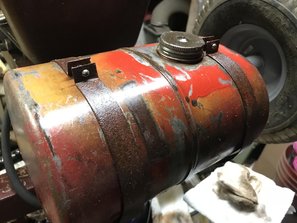

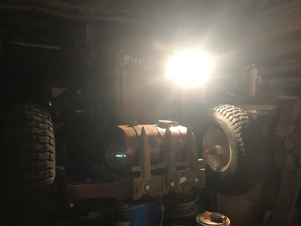

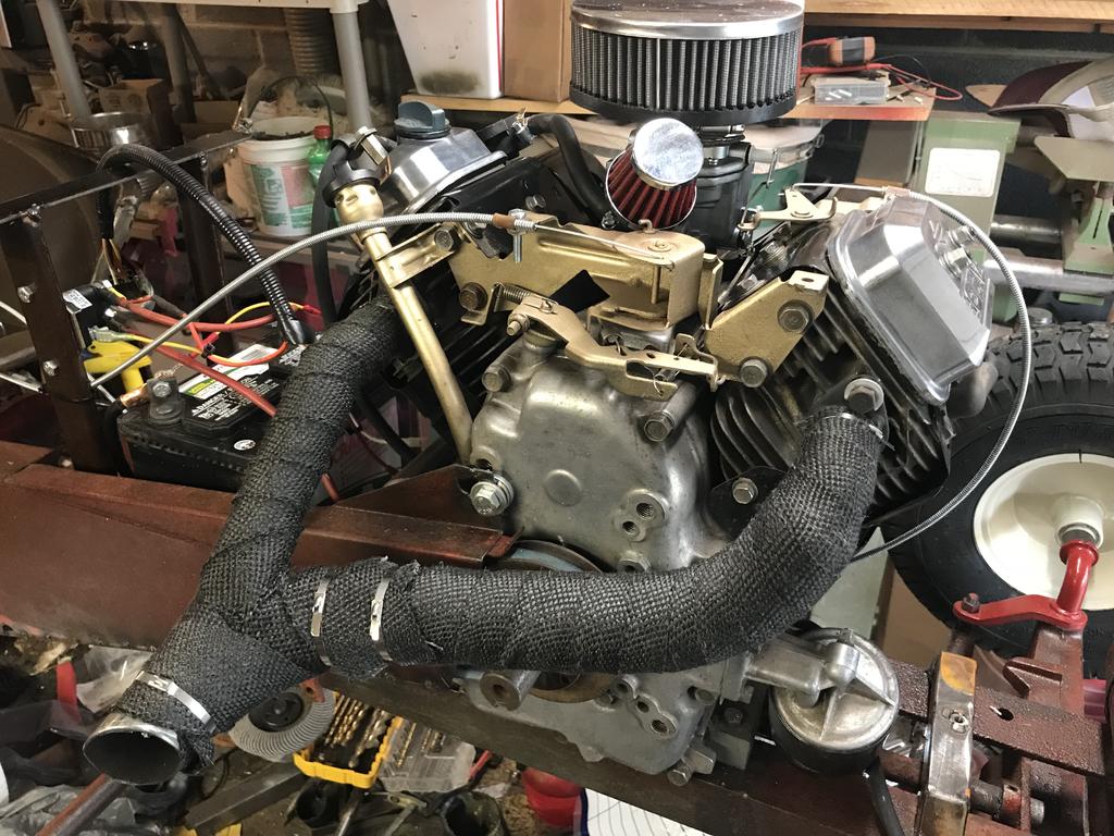

dells68 7,499 #113 Posted March 17, 2020 Looks like I’m going to have a little more time to mess around thanks to ole corona. I did manage to wrap the exhaust with heat wrap and fabbed up a guard for the fuel tank from old Ford 501 mower sections. And @pullstart I had to pay a little honor to you with only one headlight. Got that one off of the Cyclops 857 when I bought it. 4 4 Share this post Link to post Share on other sites

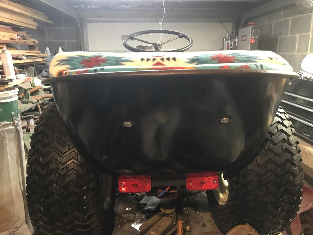

dells68 7,499 #115 Posted March 17, 2020 Just put the rear wheels and lights on. Here’s a rear view. Nice fat meats! 6 Share this post Link to post Share on other sites
Pullstart 71,482 #116 Posted March 17, 2020 I feel like we need a few shots from a couple feet back Dell! You’re starting to make these pics into Uncle Jim Special teasers! 1 4 Share this post Link to post Share on other sites

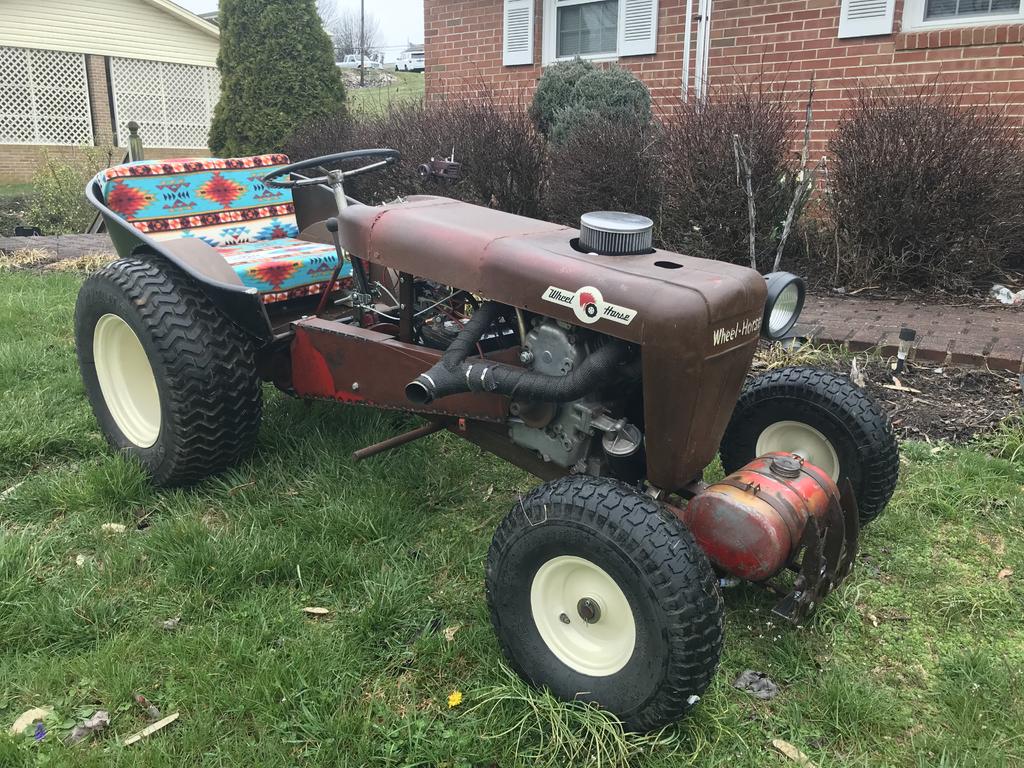

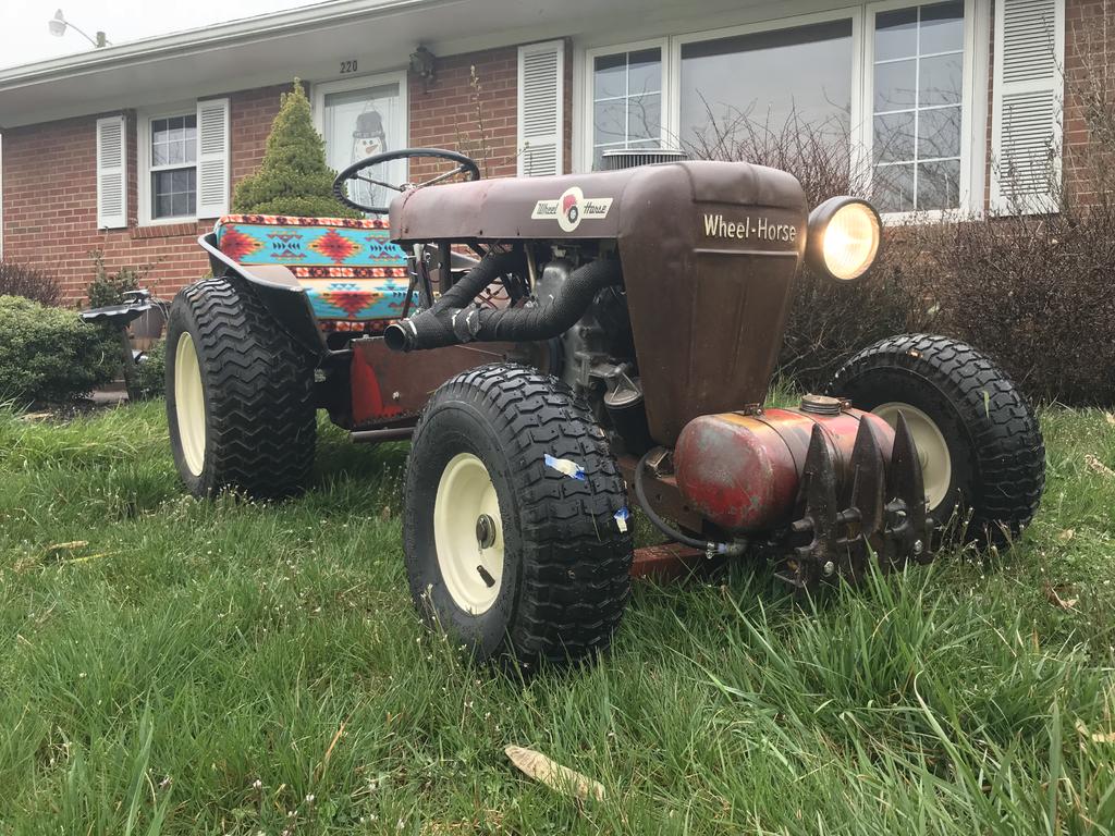

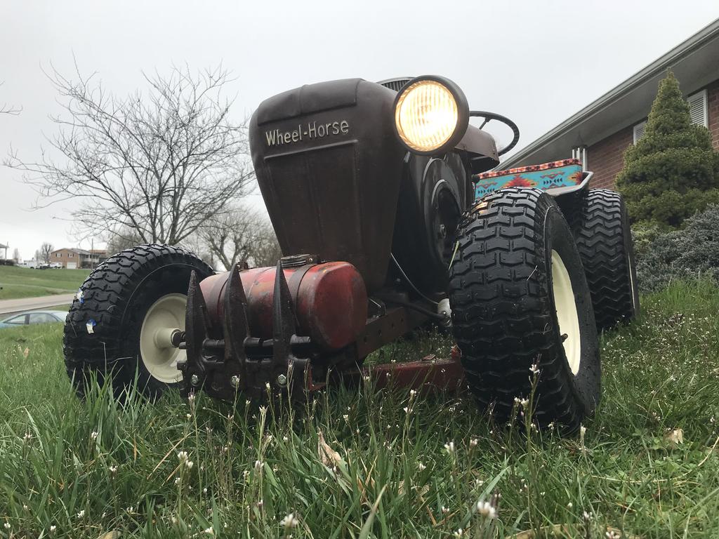

dells68 7,499 #118 Posted March 17, 2020 Just took her out for the cerimonial run and found that I’m going to have to move or adjust my belt stop. Runs good, looks odd, and drives just as odd! Those front wheels lean with the flipped axle and spindles when you turn and boy are they a long way out! I’m going to adjust the belt stops now and I’ll post my results later. 2 7 3 Share this post Link to post Share on other sites
dells68 7,499 #119 Posted March 17, 2020 Just got done adjusting the belt stop and now she stops, shifts, and drives great! Here’s a video I took on my first drive out. I’ve toured with the idea of making a roadster windshield and cycle fenders for the front. After getting her out, I noticed that the spindles allow the wheels to tilt in a little when sitting straight. One of the spindles has been welded on before, so I don’t mind to cut and straighten them. What do you guys think? 3 4 1 Share this post Link to post Share on other sites

dells68 7,499 #123 Posted March 17, 2020 @WHX24, sorry buddy had to change one thing - those tilted spindles. Pictures don’t show it real well, but in person and when driving it, the front wheels cambered in at the top like a swing axle bug when dropped down. One cut on each, a little leverage, rewelding, and voila the front wheels stand straight when looking out over the hood. I swear it made me feel like they were going to bend on up and lay the axle on the ground! Think I’m done — for now! 3 1 Share this post Link to post Share on other sites
