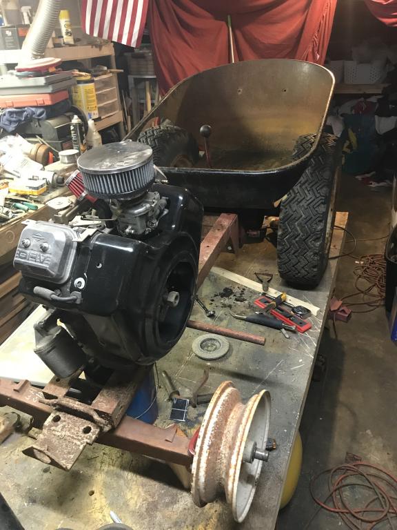

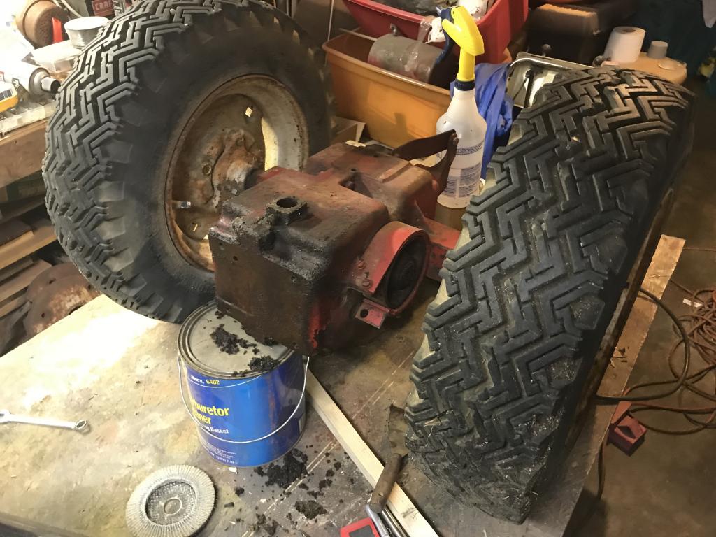

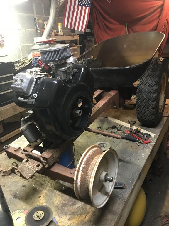

dells68 7,499 #1 Posted February 11, 2020 Ok guys, I’ve been toying with this idea for a few years and I have most of the spare parts laying around. What do you get when you cross one really worn out wheel barrow tub, a manual trans, short frame, 16 up Briggs Vanguard, flipped axle, and hopefully two trashed suburban hoods welded into one? I don’t know, so what do you guys think? Worth it or just save the parts? Stretch the frame another foot or so or keep it short? Have I lost what’s left of my mind? 7 3 3 Share this post Link to post Share on other sites

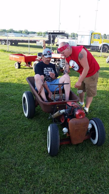

953 nut 70,065 #4 Posted February 11, 2020 Sort of like the "Tub-Rat" that @prondzy built. 3 1 1 Share this post Link to post Share on other sites
WHX?? 58,325 #5 Posted February 11, 2020 Naw Ed thats just extra weight to slow a guy down ...does add some coolness tho .... me thinks you should have a chat with Mike @prondzy ! His is a blast to tool around in! Way to quick for me Richard! 2 2 2 Share this post Link to post Share on other sites

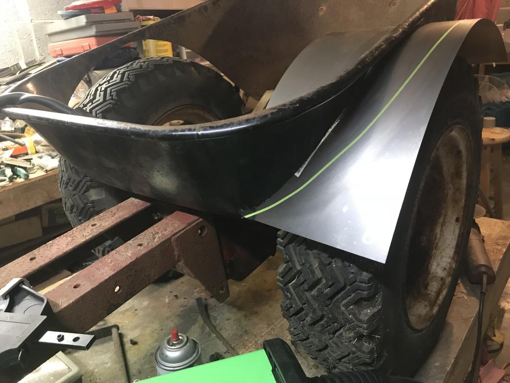

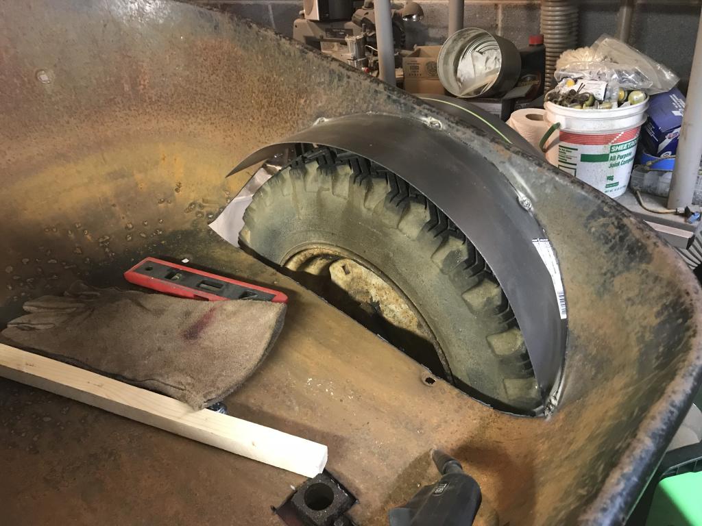

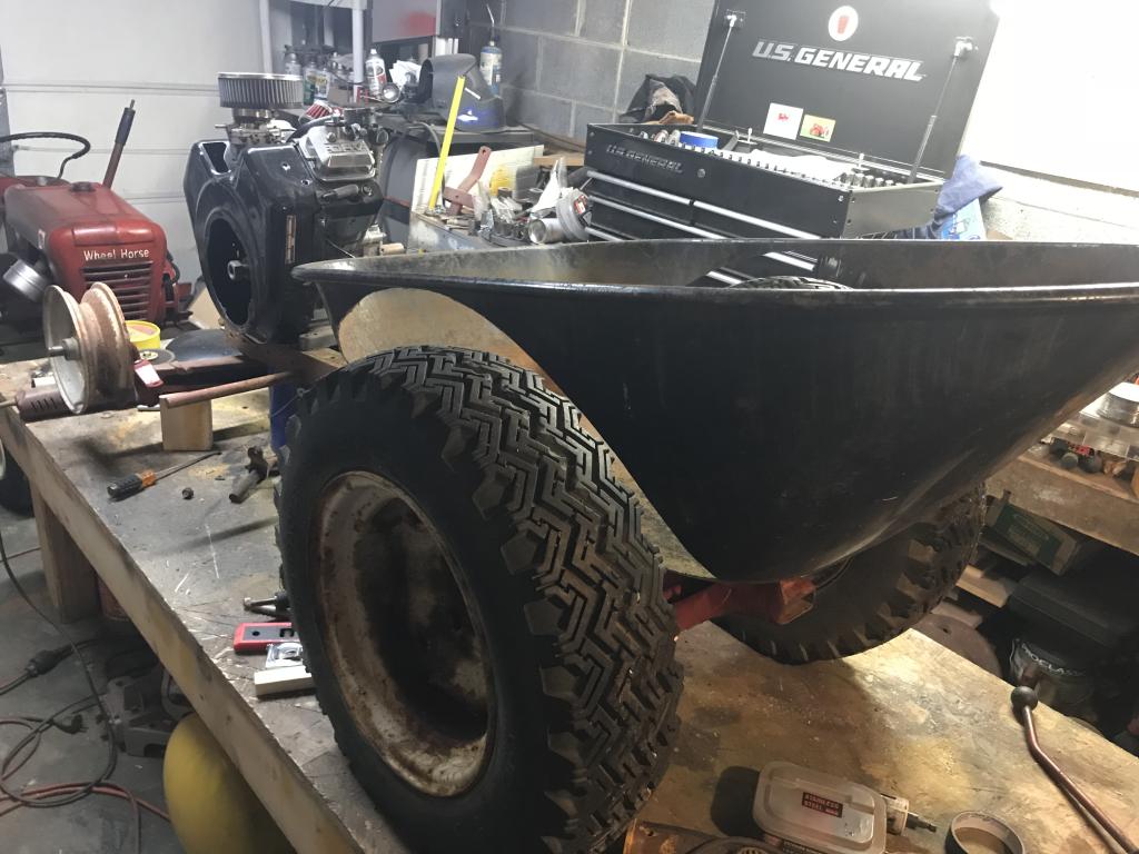

dells68 7,499 #10 Posted February 11, 2020 I decided to tack in a sheet of metal to start a wheel tub. First of all, I’m going to have to suck it in tight for my arse to fit between them there tubs! I haven’t trimmed it off even with the tub yet, just experimenting and I had an idea. I laid out a fender line on the metal sticking out with fine line tape. I initially thought I might carry it out the back with a slight upturn kind of like a model t fender, but I almost think it would look more sinister with the tubs trimmed off even with the tub. What do you think? Not committed yet, just playing to see what I like. 5 2 Share this post Link to post Share on other sites

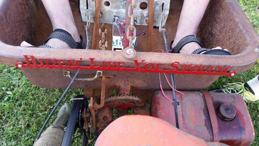

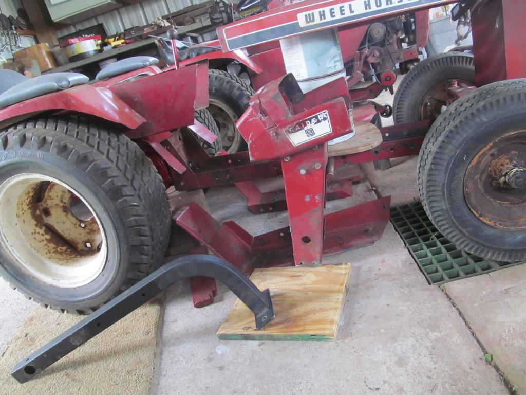

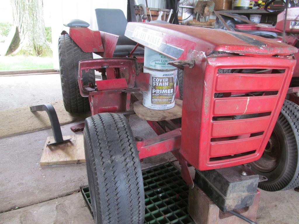

Ed Kennell 47,750 #20 Posted February 11, 2020 9 hours ago, dells68 said: I’m going to have to suck it in tight for my arse to fit between them there tubs! I had the same problem with the Low Rider Dell. I pushed the seat bucket sides out as far as I could and it is still tight and getting tighter. You may want to make some spacers to push the wheels out a couple inches. Your "arse" will thank you some day. After I had the seat bucket to this point, I squeezed in and found I couldn't get my legs apart enough to straddle the console. I had to rework the front end to clear my legs. 1 2 3 1 Share this post Link to post Share on other sites
