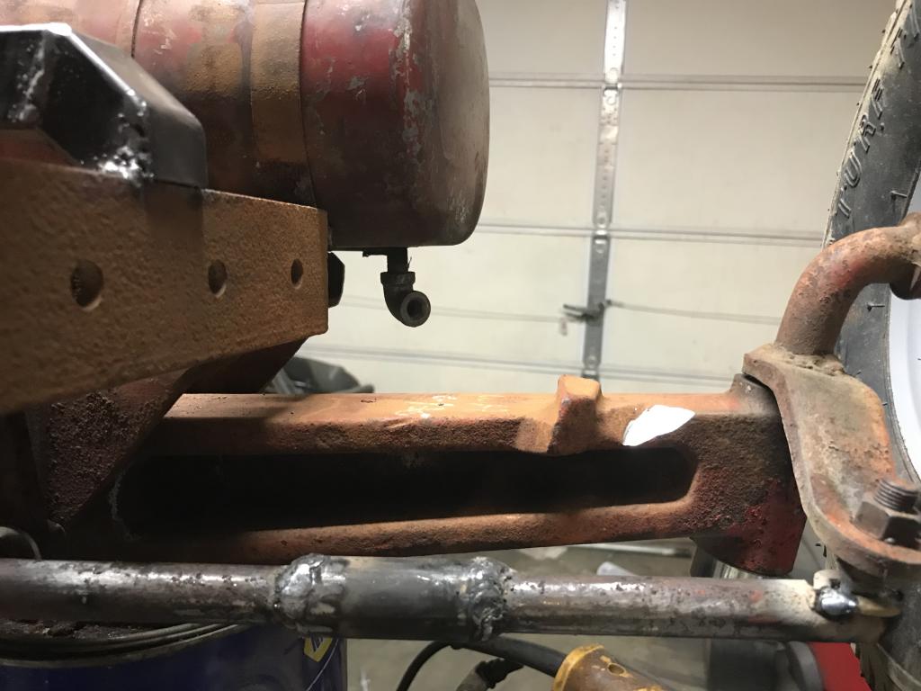

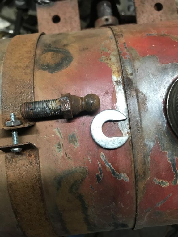

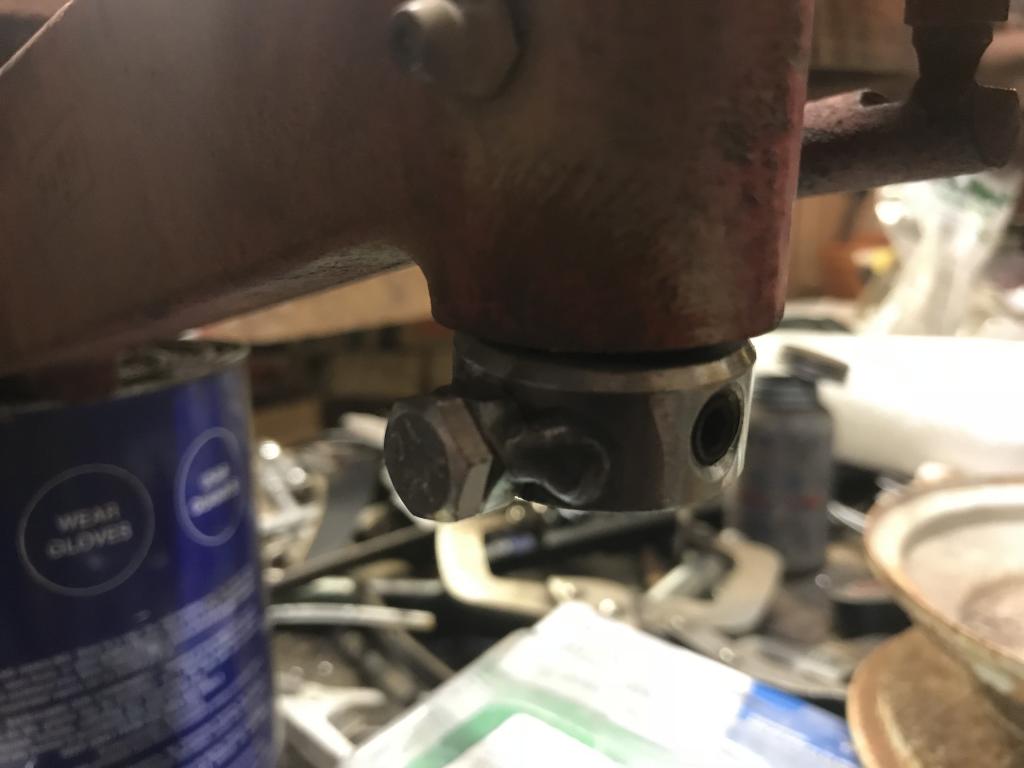

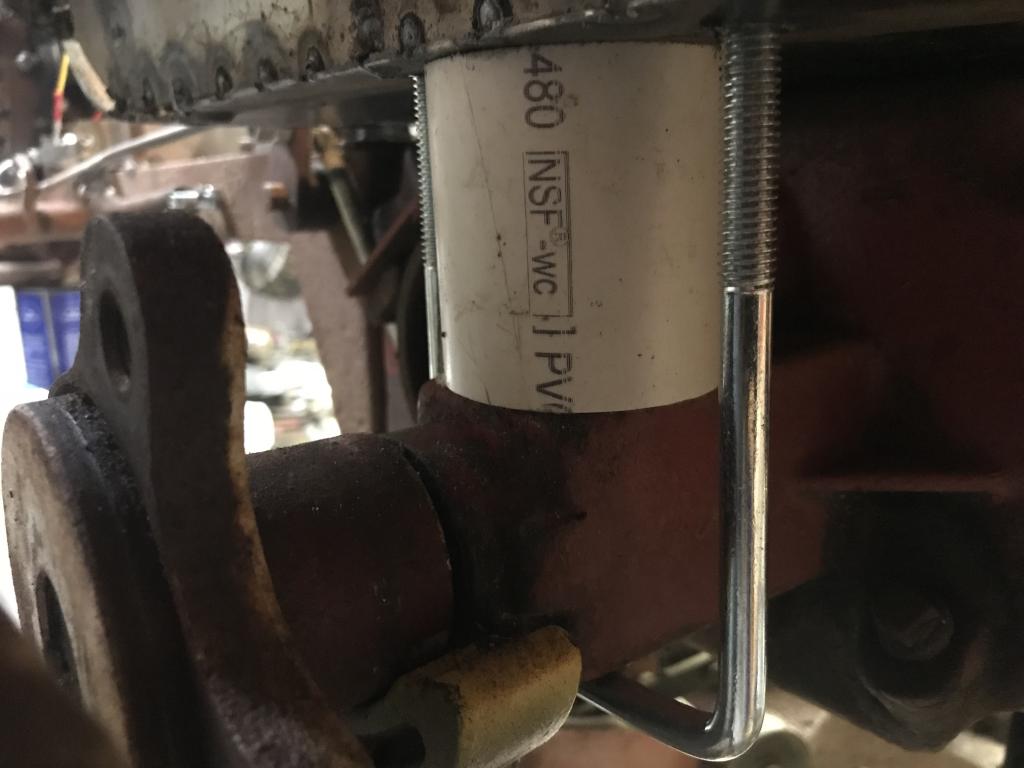

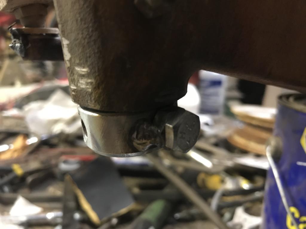

dells68 7,499 #79 Posted March 3, 2020 Spent the better part of the day hauling gravel and leveling part of Dad’s driveway as the next step after putting in rip rap last time. When I got home, I did find a little time to play! I found out that the tie rods were 3/4” too short when the axle was flipped. So, i cut the tie rods and sleeved them with 1/2” black pipe to extend them enough to give just about 1/4” of toe in. Just when I thought I was done with the tie rods, a ball joint pops out of the rod. I got a washer just small enough to slip over the skinny part of the balljoint, slotted it to fit, and welded it to the axle to secure the balljoint. Then, I used collars on the bottoms of each spindle to hold them in place - after removing approx 1/2” off of the axle to allow room for the collars. Instead of relying on the collars, I drilled through the collars into the spindles and tapped the holes. I then inserted a 1/4” bolt into the hole while also welding a nut in each collar as an extra layer of security. Not being a fan of snap rings, I decided to drill a hole through each spindle for a cotter pin. I also had to make 3/4” spacers from 3/4” black pipe to compensate for the shorter hub. As for wheels, I pulled these two cheapo 15” tires mounted on 6” rims. Lastly, I made pvc body mounts to go between the tub and axle housings for extra rigidity. There is a large u bolt that wraps each axle and goes through the angle iron in the tub to tighten up on the pvc. Whew - all in about 2 hours!!! 5 2 Share this post Link to post Share on other sites
Pullstart 71,482 #80 Posted March 3, 2020 That’s a lot of Redneck for just 2 hours! You make that all look too easy... like it’s a natural gift? 1 1 Share this post Link to post Share on other sites
peter lena 10,103 #81 Posted March 3, 2020 good looking mindset, on your welding issue, try to spend more time in heavier /solid welding and tacking , developing a touch for your new welder is the issue, those light fender/tub tacks are a delicate touch. think i would incorporate a bolt flange into that steering column , for a 2 or 4 bolt flange bearing base, to make it very solid and smooth , keep going , pete 1 Share this post Link to post Share on other sites
dells68 7,499 #82 Posted March 3, 2020 Thanks guys. One thing I’ve found out with the new welder on thin metal is that I was trying to use too low of a heat setting with a slow wire feed. I set the heat up one notch and barely moved the wire speed and I had much less blow through. On thicker stuff, you can really turn the heat up along with appropriate wire speed and get great penetration - my welding skills are a little rusty so my beads look a little sloppy. It’s one of those things that if you don’t use it, you loose it - especially coupled with a new welder. My old welder was a flux core or gas machine. This one is flux only and getting used to the heat and speed setting on thinner metal has been a challenge. It will blow through almost immediately if you’re not careful. My old welder would let me turn the heat down and get a pretty tack even on thin metal, but the transformer really got weak - it was about 12 years old with a lot of hours on it! This inverter welder packs a wicked punch even on the lowest settings - not as easy to dial back as the old one, but I’m slowly getting used to it. 3 Share this post Link to post Share on other sites

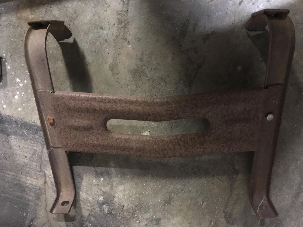

dells68 7,499 #84 Posted March 3, 2020 Very nice Pete! I might try this on some of my other horses in need of a little love - particularly my GT14. On this one, I’m trying to use what I have on hand - sort of the theme of the tractor, er rod, errrr mess. I’m trying to use every bit of the old wheelbarrow that I can. One thing I haven’t figured out how to incorporate yet is the brace between the rear “legs” of the wheelbarrow. I had considered using it for a backrest, but I’m digging on the idea of using a Mexican blanket type theme for the seat pad and the backrest. Any suggestions on how to incorporate it anybody? 1 Share this post Link to post Share on other sites
Pullstart 71,482 #85 Posted March 3, 2020 (edited) Smuck it a few times on the soft ground with a sledge and you got yourself a rat helmet? Edited March 3, 2020 by pullstart 2 Share this post Link to post Share on other sites
Tractorhead 9,218 #86 Posted March 3, 2020 If you have the ability of a small concrete mixer, put few shovels of sand in and let it rotate few minutes in it. 3 Share this post Link to post Share on other sites
