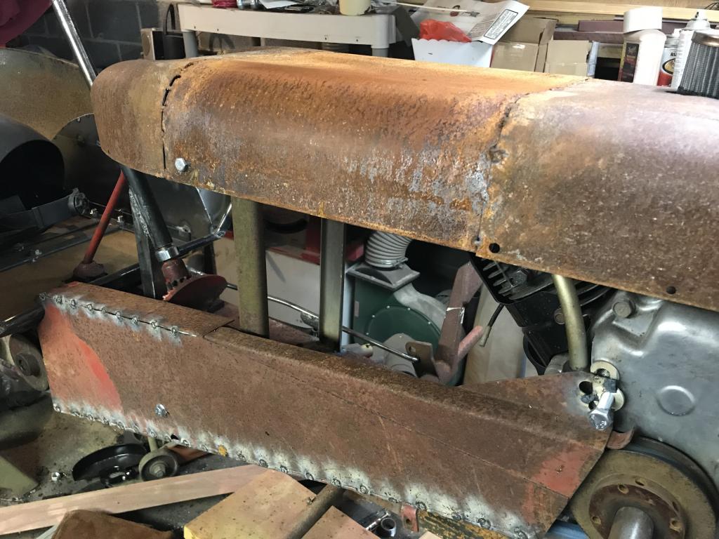

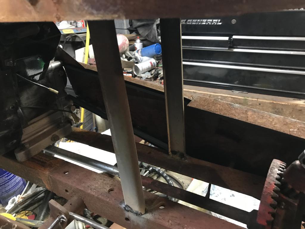

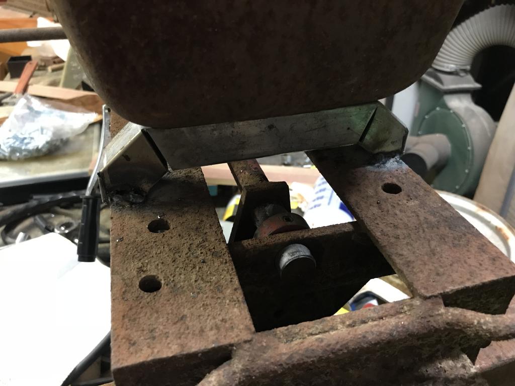

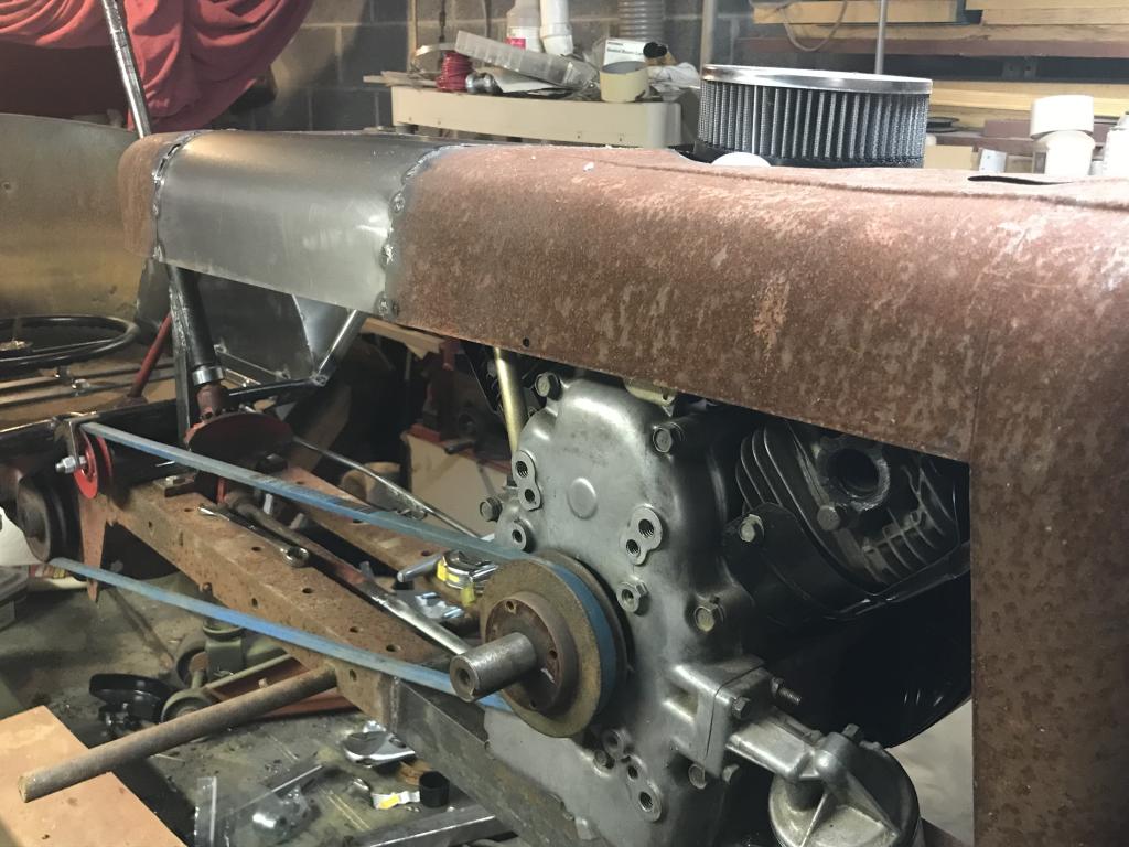

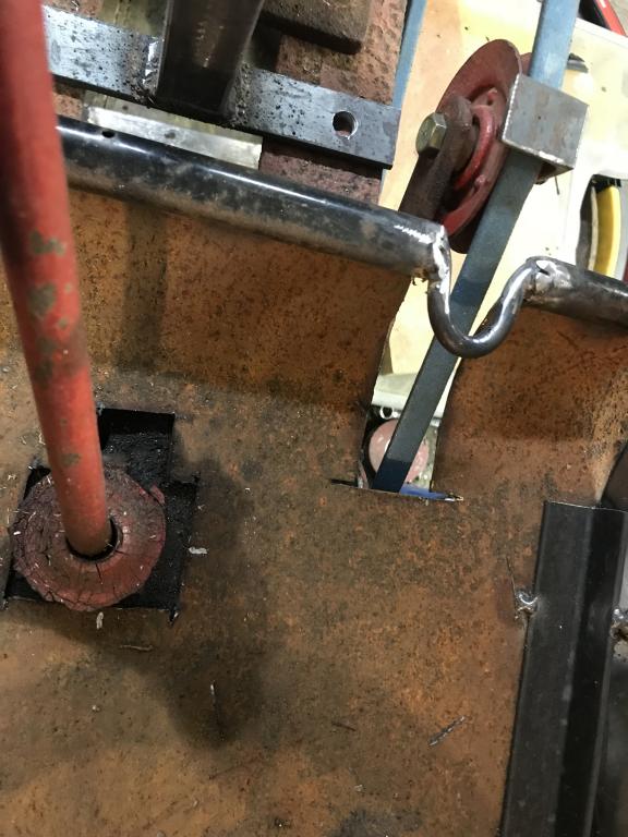

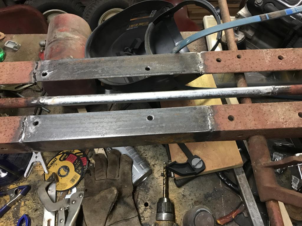

dells68 7,499 #53 Posted February 23, 2020 (edited) Been at it again today. Had to stop a while to take my wife to urgent care. She’s got a bad sinus infection and ear infection. I managed to get the tensioner pulley where I want it, but had to notch the tub for clearance and add a reinforcement bar. I welded an additional 17” into the steering rod. I got the motor bolted down where I hope it will stay. And lastly, I cut a big gaping hole in the old suburban hood I have. It could probably have been saved, but hey it died for the cause. I payed a fuel tank up front to see how it would look there. I’m going to stretch the hood about 8-10” and modify a belt guard next. I think I’m nuts for spending so much time on an old wheel barrow and a bunch of rusty parts, but I’m having fun anyway! Ignore my mess, that’s how my creative juices come out best! Edited February 23, 2020 by dells68 Added pic 6 1 1 Share this post Link to post Share on other sites

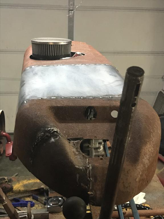

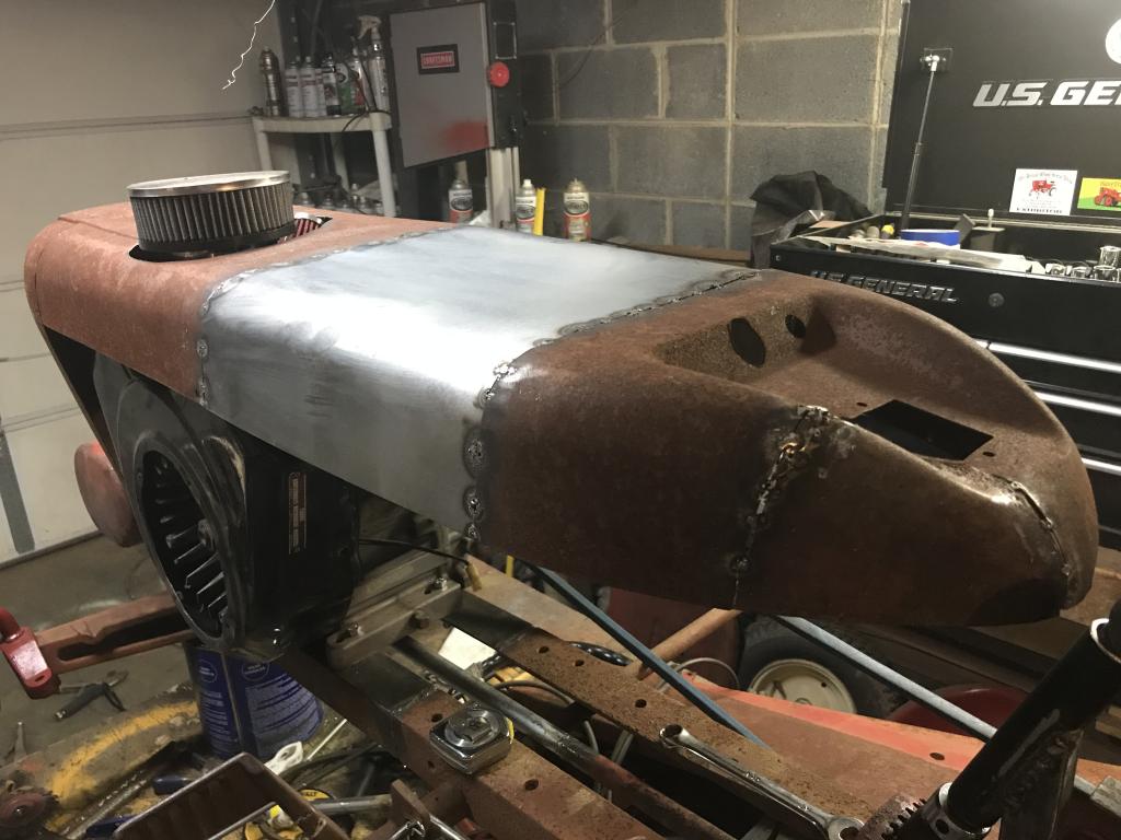

dells68 7,499 #60 Posted February 25, 2020 I worked on stretching the hood some tonight. Added 12” to it. Talk about a hood that goes on forever! My new welder like to blow through sheet metal at its lowest setting. Might just rust up the new stuff, sand down and coat with linseed oil and not worry about finish welding and bodywork. Might be the “Frankenrod”. 1 5 Share this post Link to post Share on other sites

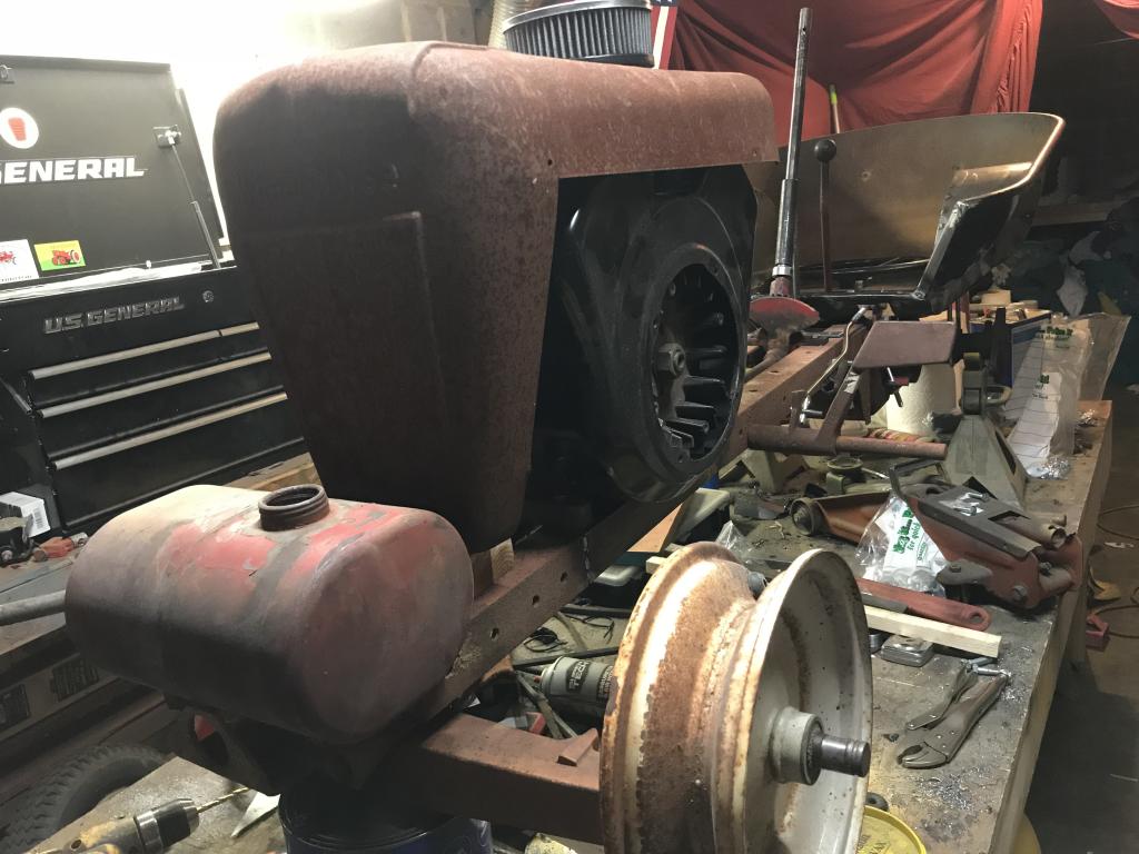

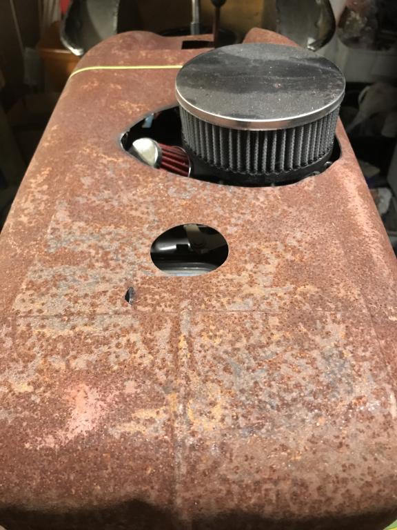

dells68 7,499 #64 Posted February 28, 2020 I messed around a little while in the garage tonight. I made a hood stand from the wheelbarrow stand and raised the front of the hood up 1 1/2”. I also modified an unknown beltguard to work on this machine. I decided to rust up the stretch in the hood to make it match the rest of the tractor. Slow progress, but I’m getting there. 6 2 1 Share this post Link to post Share on other sites

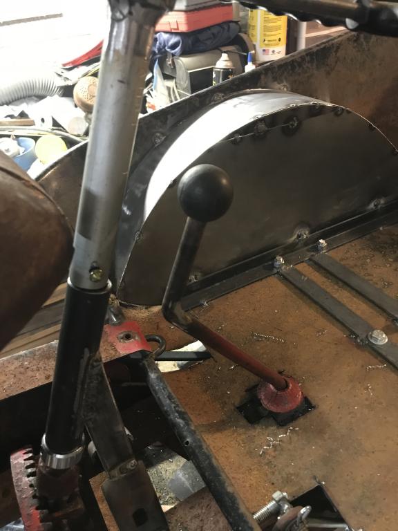

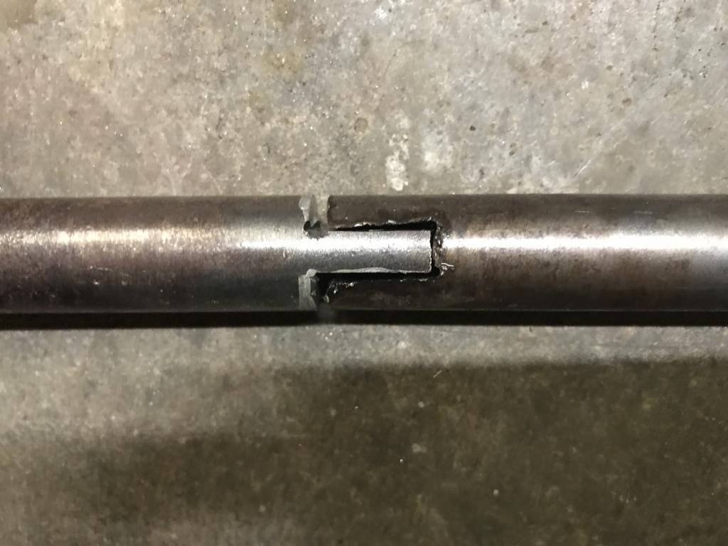

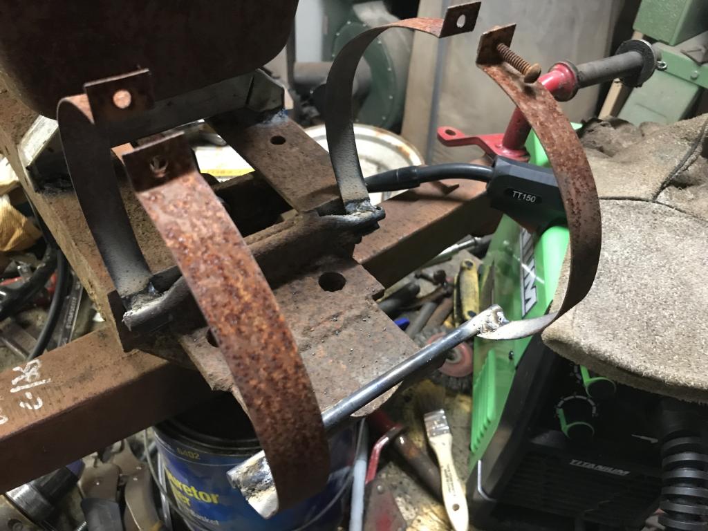

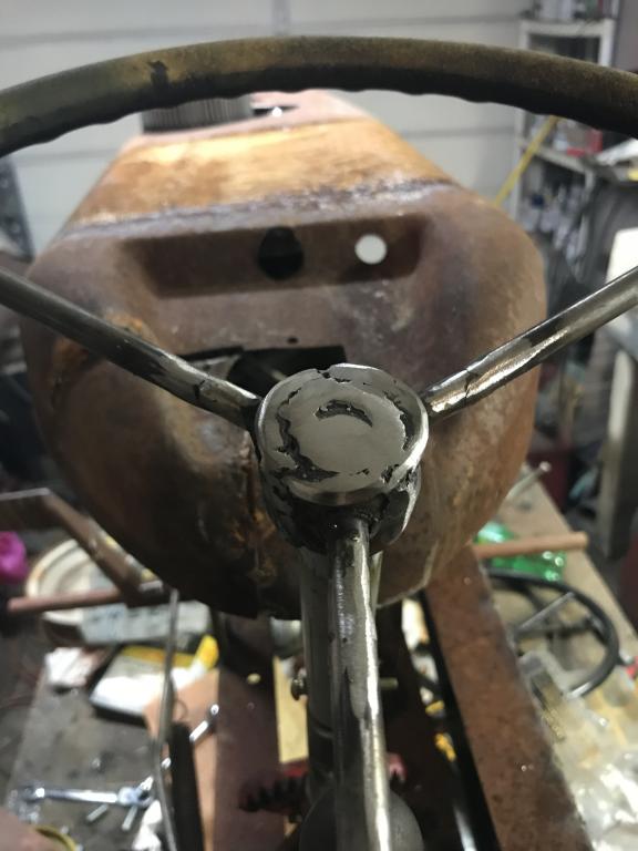

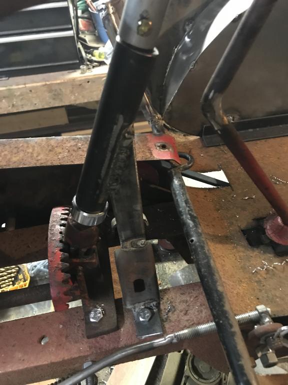

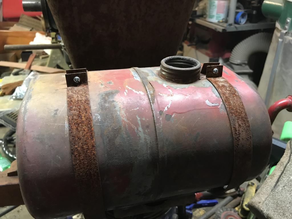

dells68 7,499 #66 Posted February 29, 2020 Ok first of all, I’m a woodworker, not a machinist. @Lee1977 gave me an idea doe making a removable steering wheel coupled. Here is my attempt thus far on making a quick connect for a horse. Now remember I said redneck custom right ( remember who’s building this). I cut my version of a mortise and tenon joint into the steering shaft. I’m going to make a sleeve from conduit welded to the shaft that allows me to slide this down over the lower portion and joint the two parts together with a hair clip type arrangement. What do you think? I also took advantage of some sort of tongue welded to the front of the frame and modified it to mount the gas tank up front using the original gas tank straps I removed from the suburban hood. Getting there slowly! 6 2 Share this post Link to post Share on other sites

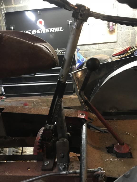

dells68 7,499 #70 Posted February 29, 2020 I finished up the steering column and reshaped the shifter to match. The steering wheel is the reseller remains of a Cub cadet wheel I cut into 4 pieces to remove it from Emory’s 102. I cut the center rubber away to make it resemble an early wheel horse wheel. The hub had been split into 3 pieces when I removed it. I welded the top section of shaft to it along with conduit going down over the lower section. I then drilled a hole through the conduit and shaft in the lower section to hold it together. I was surprised how stable it ended up being for a removable piece. I also used the skids from the wheel barrow as gussets on the steering shaft mount. Quitting for the night!! 6 1 Share this post Link to post Share on other sites

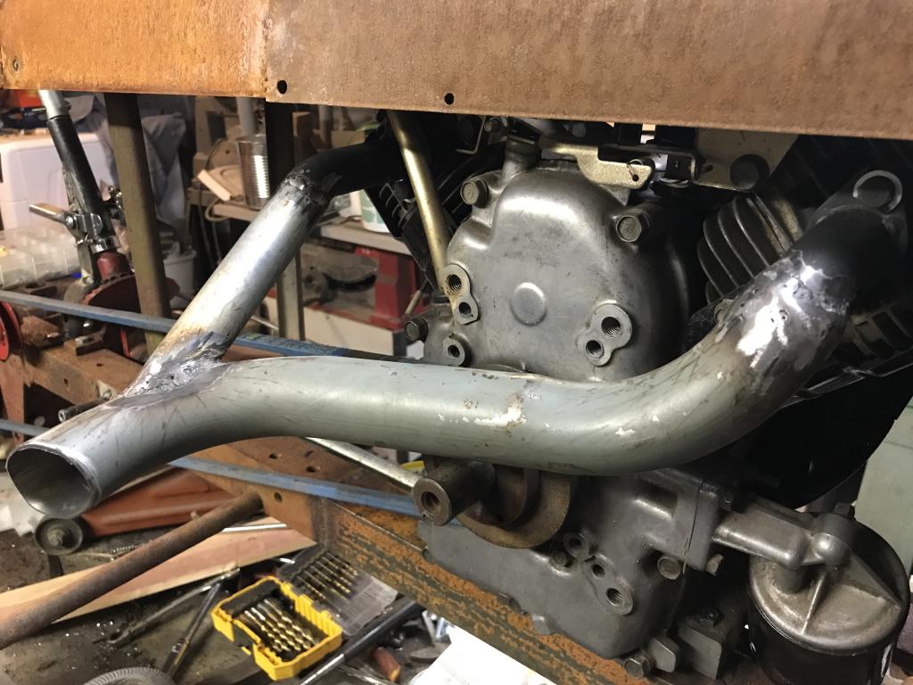

dells68 7,499 #74 Posted March 1, 2020 I’ve worked off and on all day with no noticeable changes. I’ve been welding up places on the chassis and tub. On the tub, I’ve got welds about every 1/4”. Think I’ll stop there before I blow it full of holes. I think it will hold. I did work on the exhaust. Nothing too loud or noticeable . Emory wanted me to put on loud exhaust and I think this will fit the bill. Might wrap it with heat tape for a hot rod look. 4 3 Share this post Link to post Share on other sites
