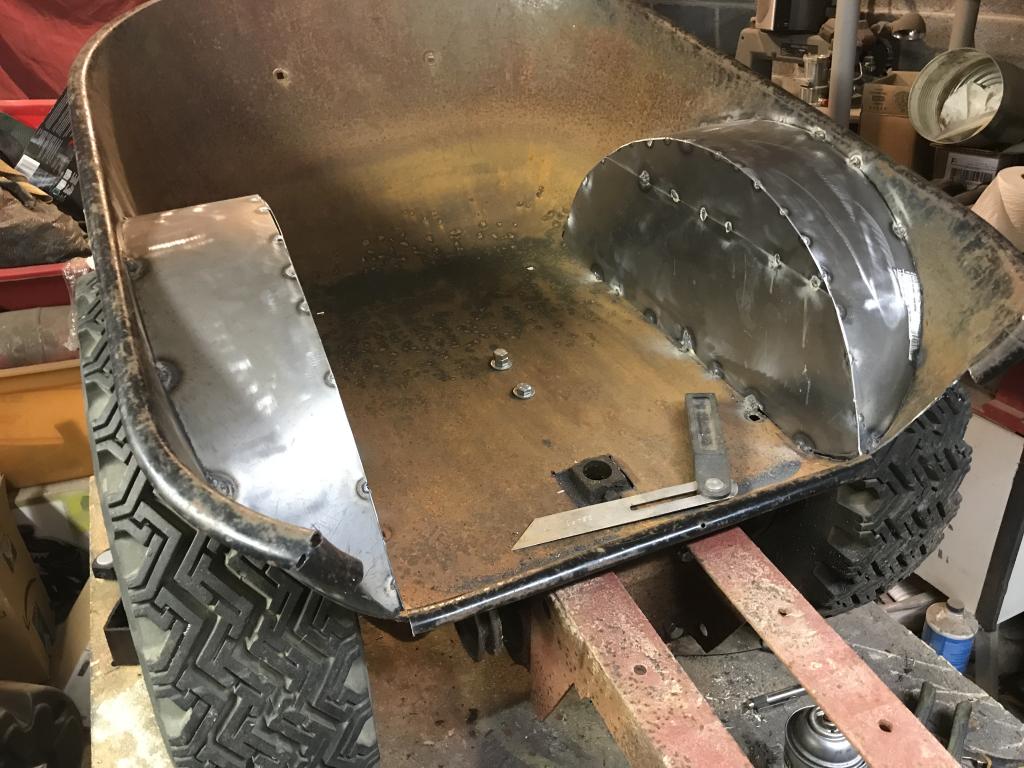

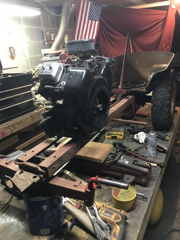

dells68 7,499 #27 Posted February 15, 2020 Well, I finally got back to my creation - it’s been a long week with something to do every night. I just finished tacking the tins together. I’m using my new inverter welder - talk about a learning curve! It burns much hotter and blows through much easier than my old transformer welder! Both are flux core, but this little dude really has the punch! More later. 6 Share this post Link to post Share on other sites

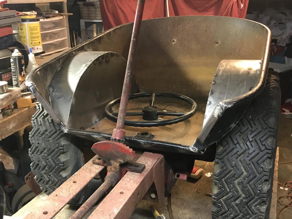

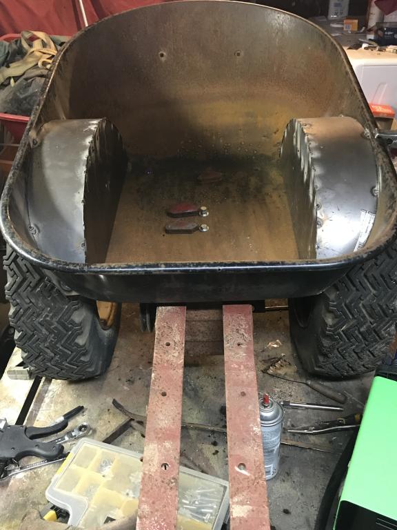

dells68 7,499 #28 Posted February 15, 2020 Well, I got the front cut out for my legs and @Ed Kennell my arse barely fits between those tubs! I’m going to have to stiffen that body up some before I go much farther. Any good ideas? 4 Share this post Link to post Share on other sites

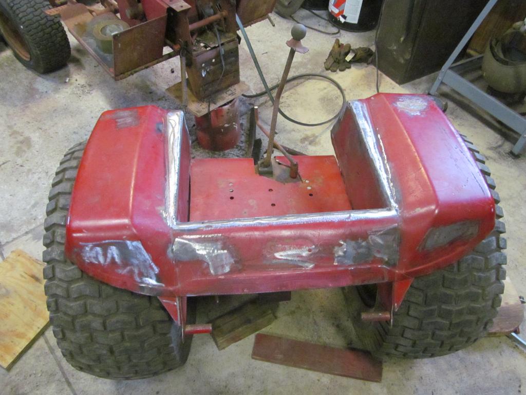

Ed Kennell 47,753 #29 Posted February 15, 2020 Dell, when your back far enough to to clear the shifter, can you still straddle the frame and belt guard? That's where I had a problem and had to trim away the front corners of the wheel well. I didn't have a stiffness problem as I had the floor boards to help support the fenders in the front. 1 Share this post Link to post Share on other sites

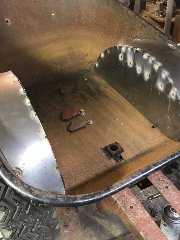

dells68 7,499 #33 Posted February 16, 2020 Thanks guys. I’m not looking for super low, it rather a healthy stretch and hot rod rake. I cut the frame and added 12.5” to the length. I really wanted 16-18” or stretch and I’m too cheap to buy more angle since I had a 25” piece. I think I’m going to have to use a steering wheel disconnect to allow easy entry and exit. A few pics of the night’s progress. 5 Share this post Link to post Share on other sites
Pullstart 71,482 #34 Posted February 16, 2020 Yeah, you’re making the right decision to go arse deep into this build! Do you have any drill rod or rebar that you could stiffen the tub lip and grind in? 1 Share this post Link to post Share on other sites
dells68 7,499 #35 Posted February 16, 2020 43 minutes ago, pullstart said: Yeah, you’re making the right decision to go arse deep into this build! Do you have any drill rod or rebar that you could stiffen the tub lip and grind in? The tub lip itself is pretty stiff. It’s the flex in the bottom of the tub where it bolts to the tranny that’s giving me trouble. I’ve tried to figure out reinforcements, possibly a thick plate bolted or welded in the bottom, or ? I’m open to any ideas!! Share this post Link to post Share on other sites
oliver2-44 11,791 #36 Posted February 16, 2020 To stiffen the pan could you use some contact cement and laminate a piece of 3/4 plywood across the bottom. The plywood might become the bottom part of your seat frame. If you had a piece of Baltic Birch plywood you might even be able to go 1/2" thick. 1 1 Share this post Link to post Share on other sites
Tractorhead 9,218 #37 Posted February 16, 2020 (edited) I would set 2 angle iron outside along the fenders in lower section welded and enforced between them with a 5mm thick steel plate between them, to stiffened the bottom where the mounting points are. But not in the whole depth, just like a H shape. So the complete bottom will be more stiffer, but it lifts at this 5m up. if you do this underneath, the optics internally still can be kept as it is. just the gap between Frame and The pan will be lifted up to 5mm. Maybe that give you also enough gap for a original Pulley and belt combo without any need of idlers. But it‘s hard to see on that picts. Edited February 16, 2020 by Tractorhead 1 Share this post Link to post Share on other sites
Ed Kennell 47,753 #38 Posted February 16, 2020 I added 1X1" angle pieces under my seat pan where there were some open spaces. A left to right between the shifter and the tanny bolting pad and behind the tranny pad. Then tied together with two front to back Vee shaped pieces that were narrow at the front and wide at the back. After I welded it together, I had to trim some of the pieces to get it to sit down on the bolting pad. Some of the points actually are supported by touching the top of the tranny. Very similar to @Tractorhead s description. 2 Share this post Link to post Share on other sites

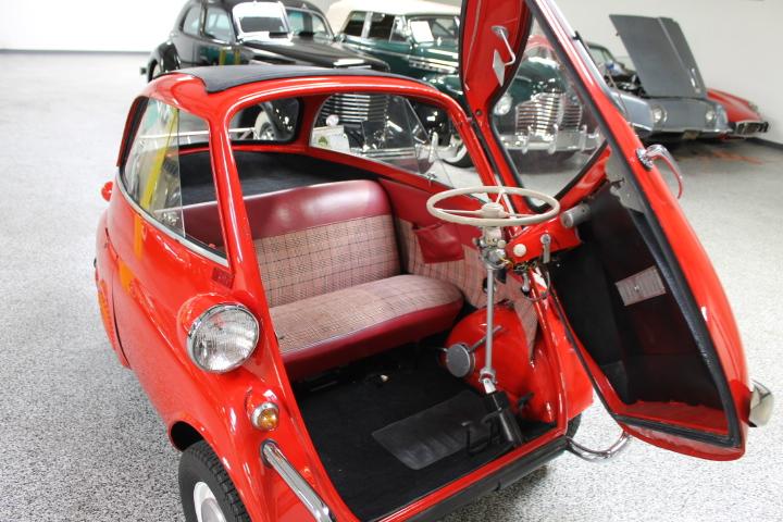

wallfish 20,724 #39 Posted February 16, 2020 Here's another option to the above 2 methods. A combination of them will allow for thinner material to be used. When the wheel wells are solid it will hold everything tight and limit vibration. A U joint in the steering wheel shaft will allow it to be moved out of the way if the top mounting point can swivel up and be pinned to lock it in position when driving it. Kinda like an old school BMW Isetta does. Also allows you to position the steering wheel lower and or angled different if that straight shaft isn't comfortable to reach. 2 2 Share this post Link to post Share on other sites

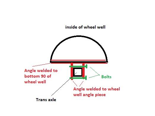

tom2p 2,396 #40 Posted February 16, 2020 On 2/11/2020 at 8:41 AM, Ed Kennell said: I had the same problem with the Low Rider Dell. I pushed the seat bucket sides out as far as I could and it is still tight and getting tighter. You may want to make some spacers to push the wheels out a couple inches. Your "arse" will thank you some day. After I had the seat bucket to this point, I squeezed in and found I couldn't get my legs apart enough to straddle the console. I had to rework the front end to clear my legs. Big Daddy Don Garlits would approve ! 1 1 Share this post Link to post Share on other sites

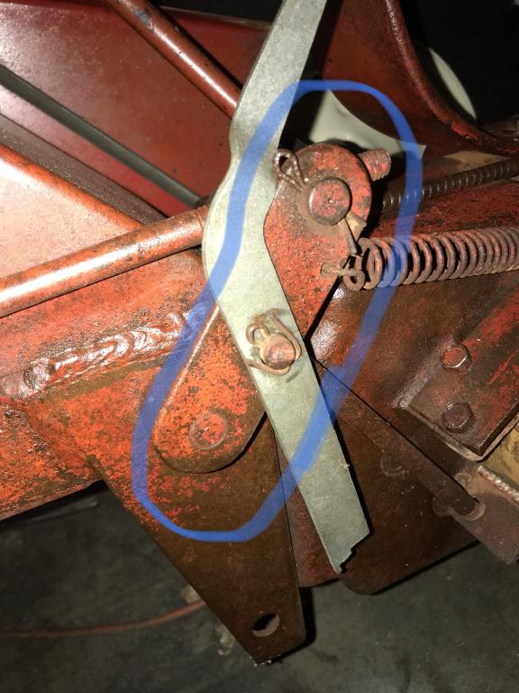

dells68 7,499 #42 Posted February 18, 2020 Ok, needing some help here. Seems I have almost every wheel horse part I need except this one. Does anyone have the cast lever that actuates the brake and clutch - mounts on the brake side with 2 holes - 1 for the brake and one for the rod running to the clutch!brake pedal? Let me know if you have one you’d like to sell. Share this post Link to post Share on other sites
ebinmaine 81,048 #43 Posted February 18, 2020 I'm sure I've got one from the B and C series out there but it's likely buried in snow/ice. (Under the tarp). I can check the workshop to see what's laying around there. 1 Share this post Link to post Share on other sites
rjg854 13,408 #44 Posted February 18, 2020 yes I have one Dell, it's off a '68 Commando 8 1 Share this post Link to post Share on other sites
Pullstart 71,482 #45 Posted February 18, 2020 And I’ve got one from a Commando 800 and maybe more take your pick Buddy! 1 Share this post Link to post Share on other sites
Jennifer 1,878 #46 Posted February 18, 2020 Hubby said he has one he will donate to the cause! He should be getting ahold of you soon. 1 Share this post Link to post Share on other sites

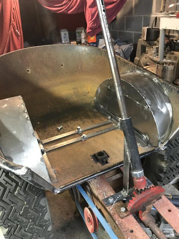

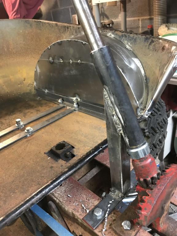

dells68 7,499 #47 Posted February 21, 2020 A little more progress tonight. I made up a stubby steering column and mount. I still want to put a gusset on each side to be sure it will be good and solid. I also welded angle down the inside of each tub and connected with a piece of flat stock. I then mounted u bolts over the axles up through the angle I just welded in. I’ll eventually put a pvc pipe piece between the axle housing and the body to make sure it stays solid. And no, don’t adjust your TV set - there’s a gap between the angle and tubs because the floor of the tub still tilts inward a little at this spot making it impossible to fit the angle iron flush. A little seam sealer and you’ll never know it was there. 3 2 Share this post Link to post Share on other sites

953 nut 70,069 #49 Posted February 21, 2020 On 2/15/2020 at 9:58 PM, dells68 said: I think I’m going to have to use a steering wheel disconnect to allow easy entry and exit. If you cut the shaft a few inches above the new "stubby steering column mount" a piece of 3/4" ID mechanical tubing could be welded to the upper shaft and pinned to the lower shaft when driving. 1 Share this post Link to post Share on other sites
Ed Kennell 47,753 #50 Posted February 21, 2020 lookin good Dell. If it is difficult getting in the tub, you can always move the entire steering assembly forward on the frame by shortening the horizontal shaft. 1 1 Share this post Link to post Share on other sites
