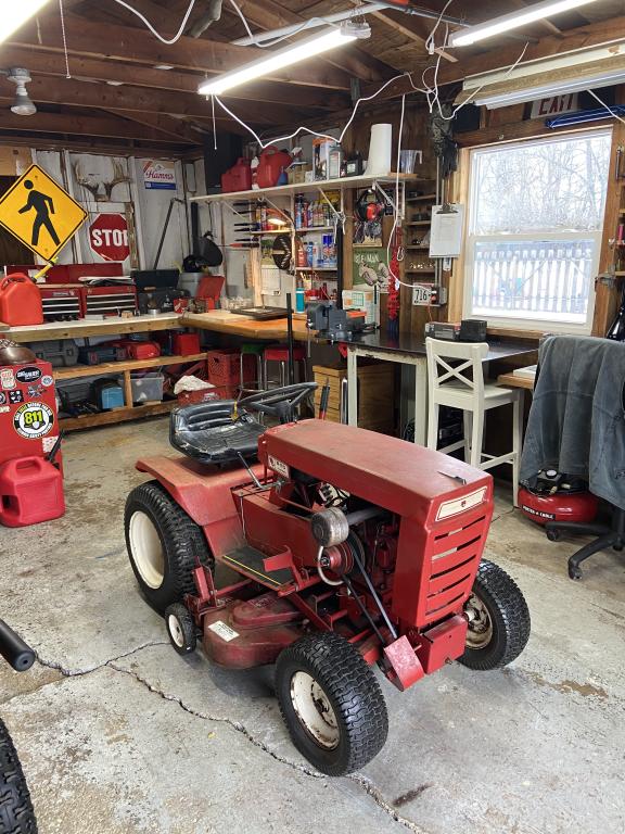

Bonsaiguy247 18 #1 Posted February 3, 2020 Hi Everyone I am new here. I have a Wheel Horse B-80. I really want to put a muffler stack on it with a rain cap, where do people buy that stuff from? Got this baby for $380 with delivery, all original and motor is running great! PTO is always stuck on so that’s what I have to dive into first, seems like Toro still makes parts for these which is awesome! 4 1 Share this post Link to post Share on other sites

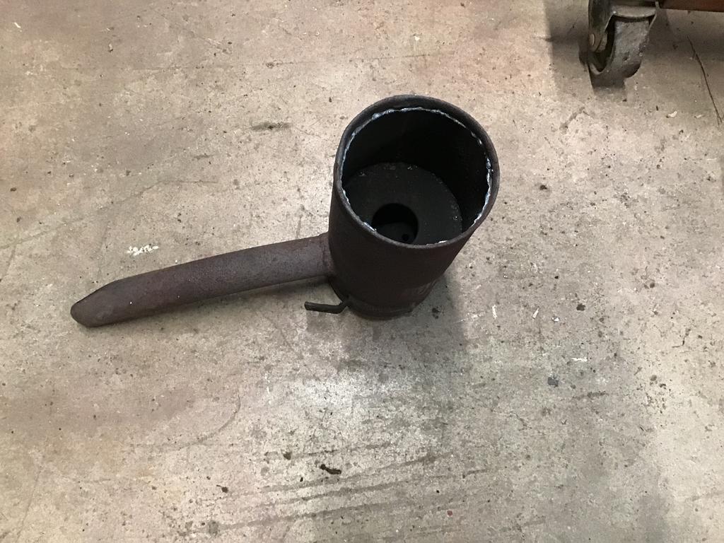

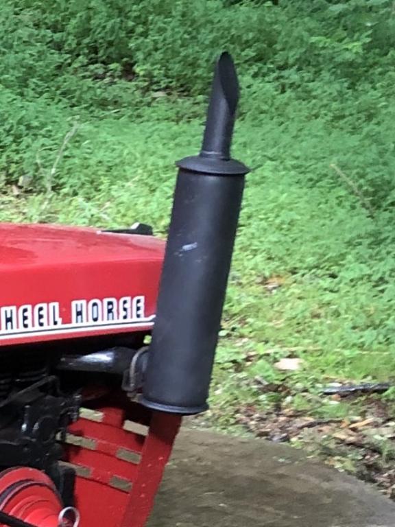

pacer 3,181 #4 Posted February 3, 2020 This is the Cub muffler Eric was talking about -- It looks like it would be about a 10 minute job to mount on your tractor, saw the pepper pot off and clamp the cub on. They are relatively inexpensive - $50ish and have just about the right muffled tone. 4 Share this post Link to post Share on other sites
The Tuul Crib 7,354 #5 Posted February 3, 2020 (edited) to heres the cub one @ebinmaine is talking about . Got it off ebay for around 20 sounds and works great! Edited February 3, 2020 by The Tool Crib 2 Share this post Link to post Share on other sites

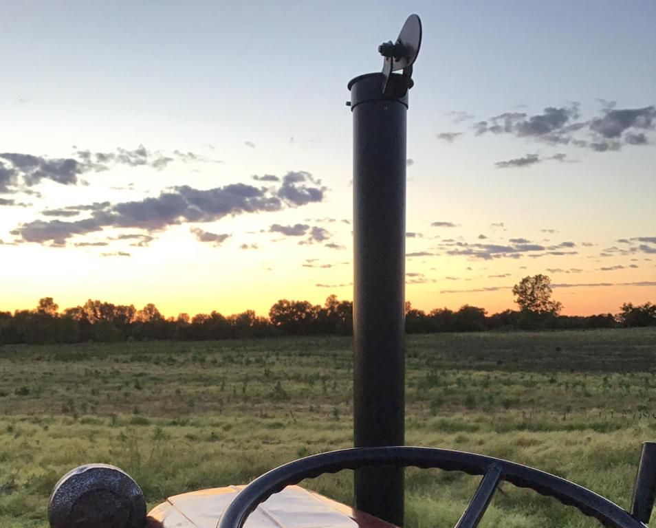

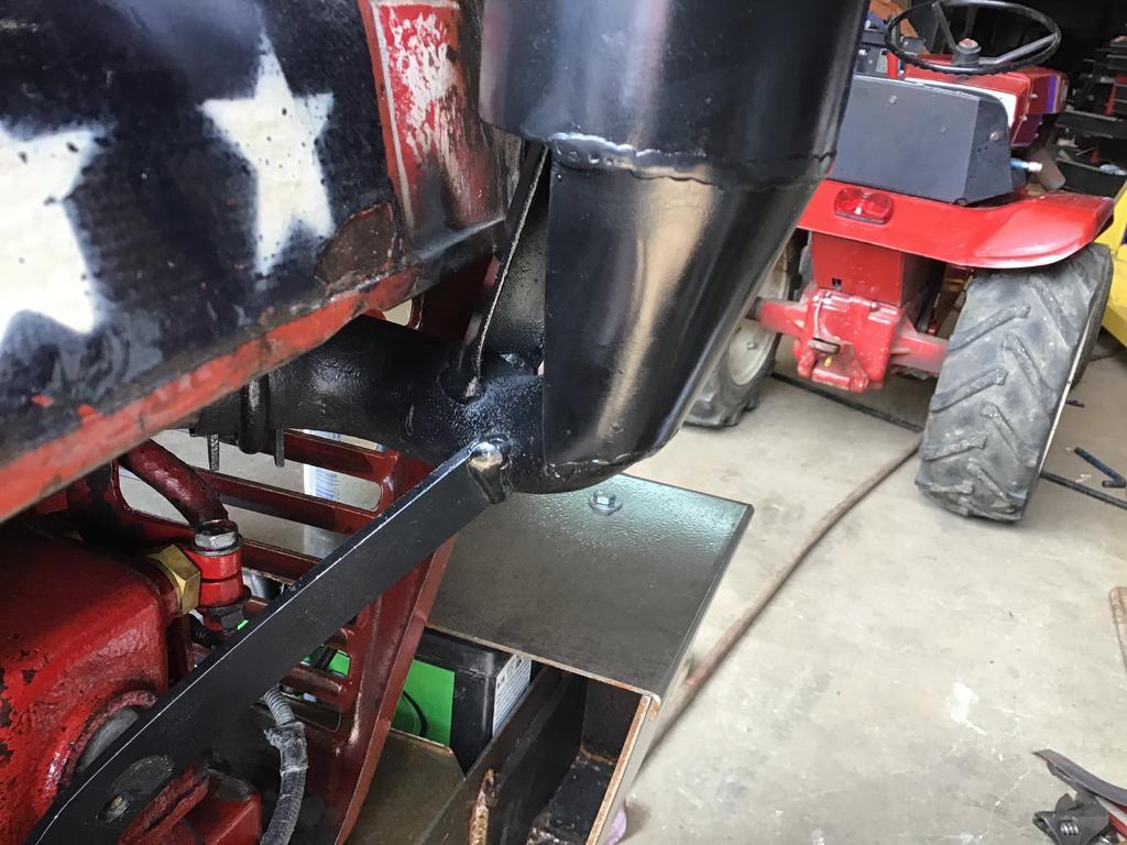

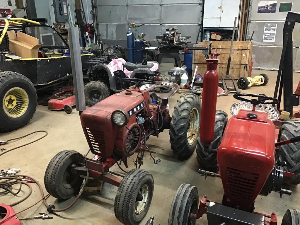

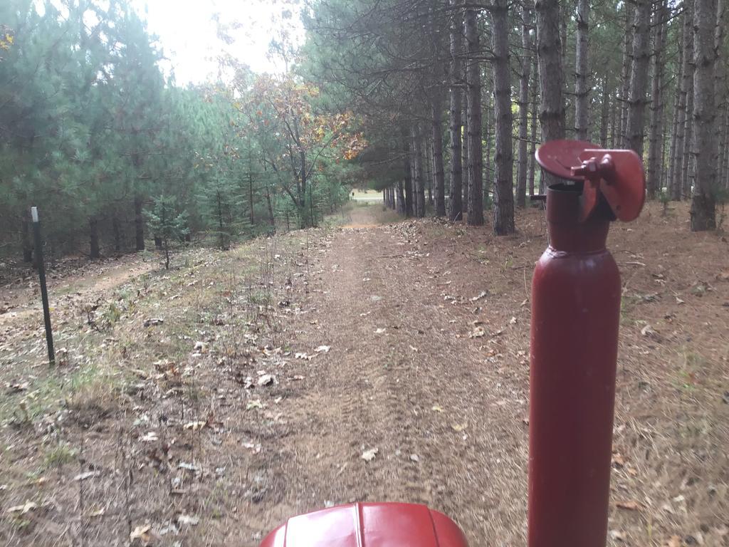

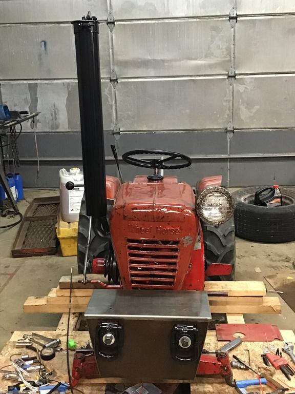

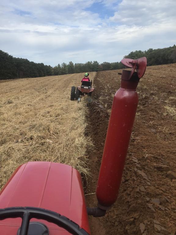

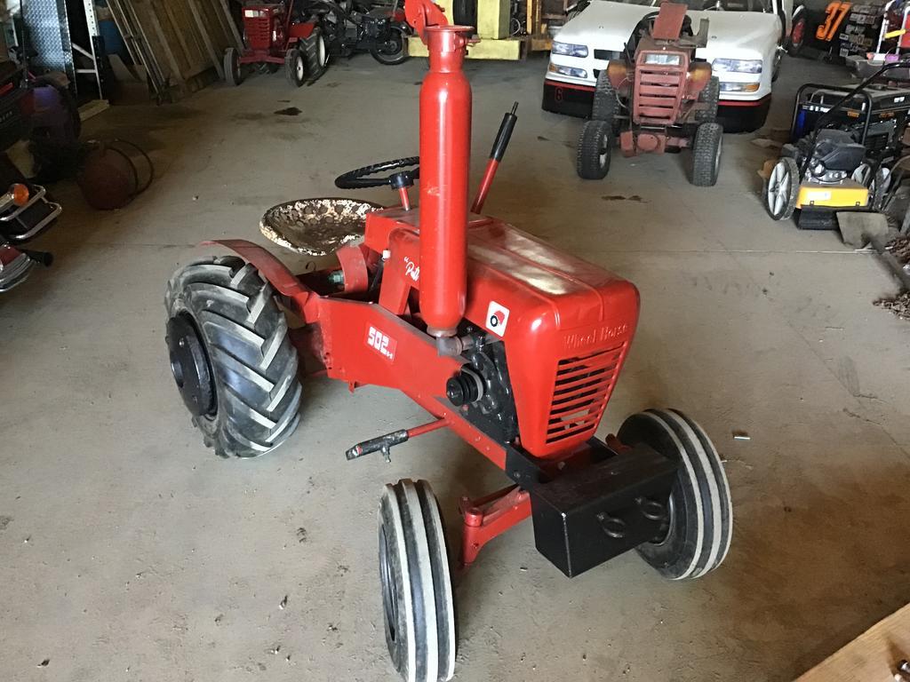

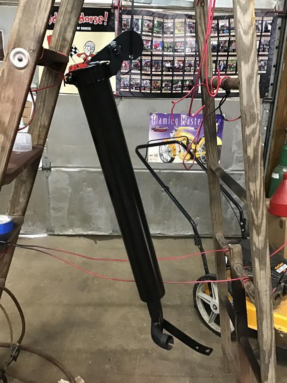

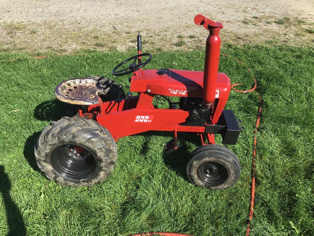

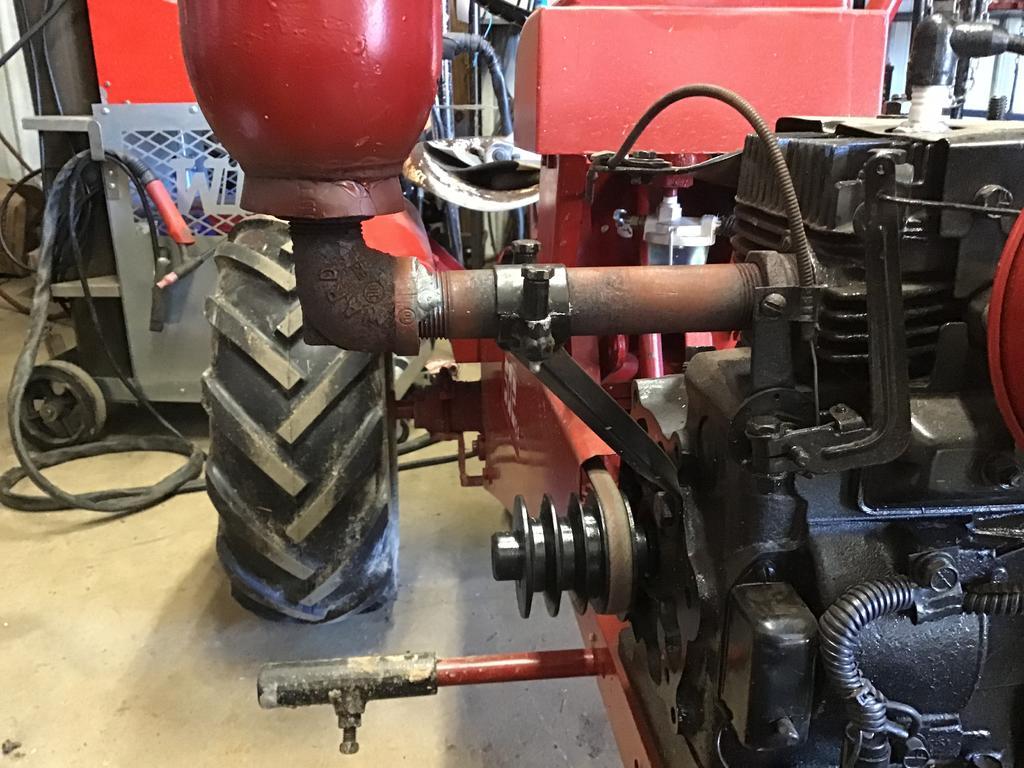

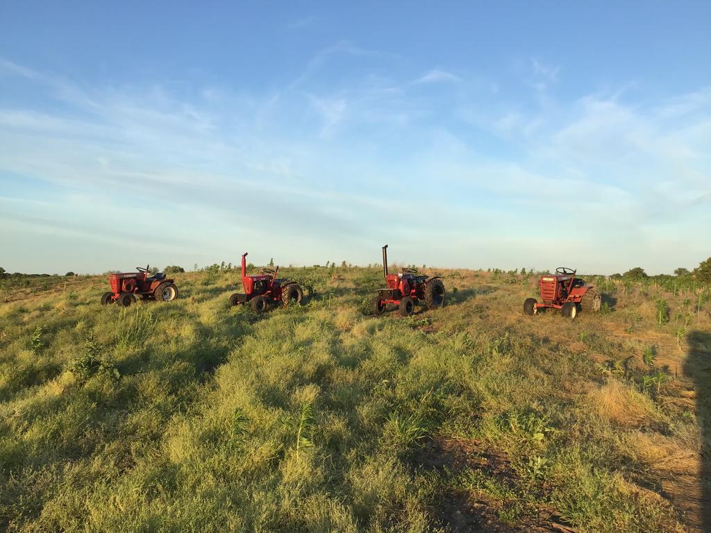

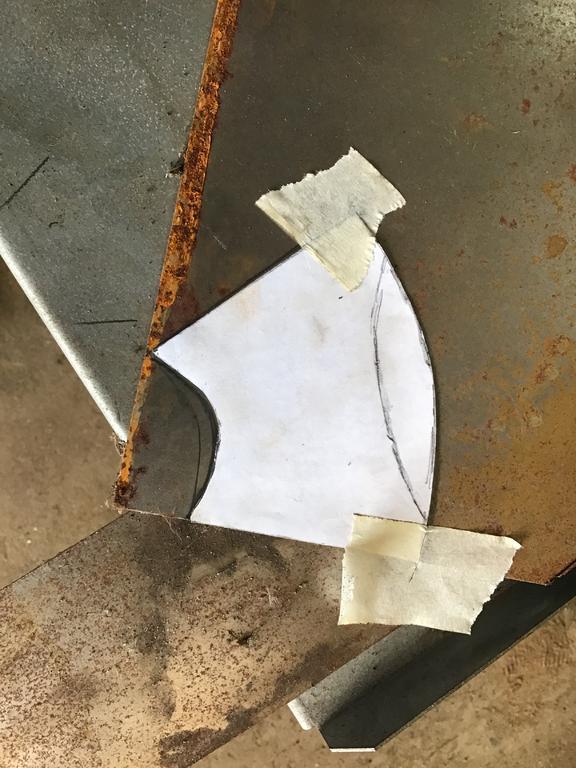

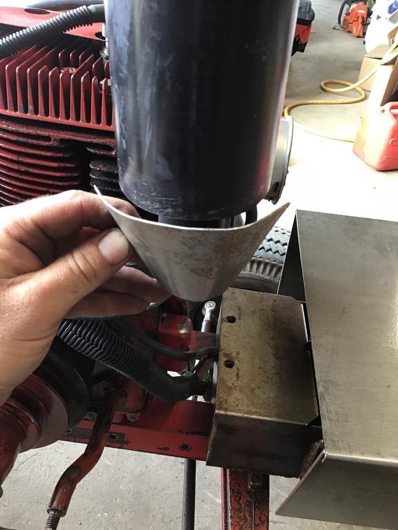

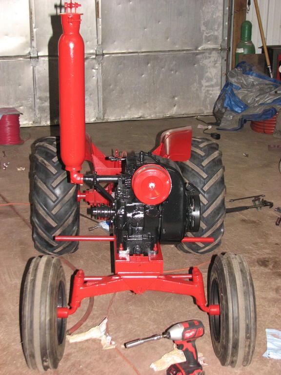

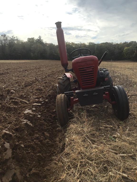

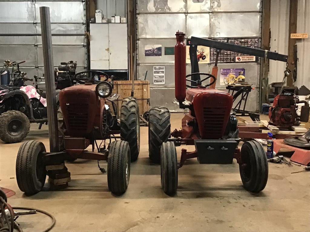

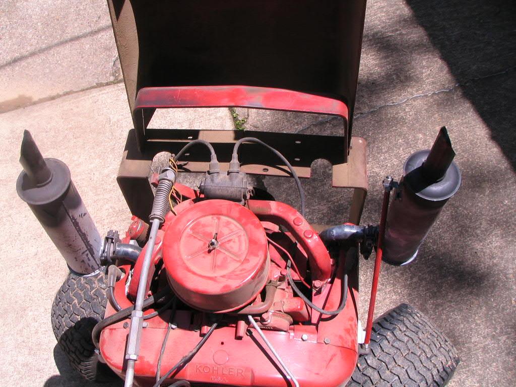

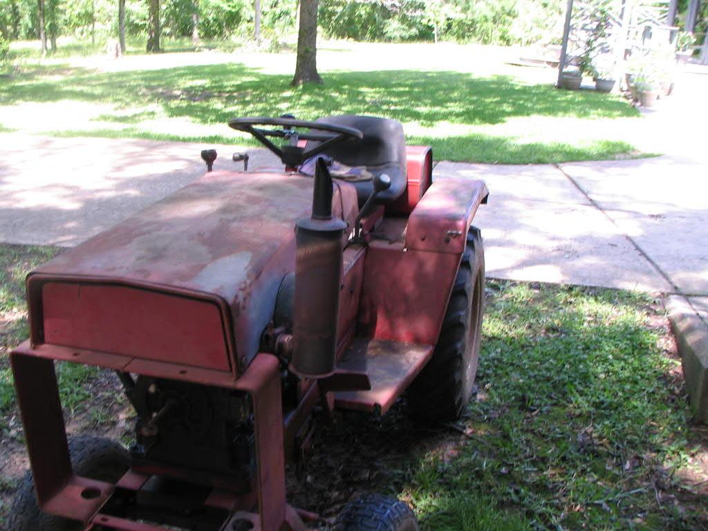

Pullstart 71,482 #6 Posted February 3, 2020 @Bonsaiguy247 ! On my tractor Putt Putt, I used a Cherry Bomb glasspack, with a Honda Shadow 750 baffle on the top. I welded a 3/4” pipe fitting in the bottom and added a flapper. Tink Tink! Maybe some of these pictures will help you in your thought process. I tell ya what, it always makes the view better watching that cap bob... especially when it’s working in the field trying to keep up with my youngest daughter! 2 Share this post Link to post Share on other sites

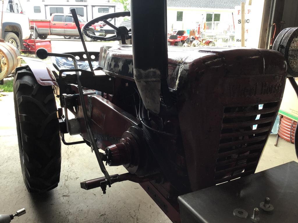

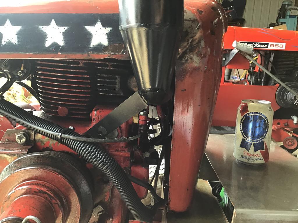

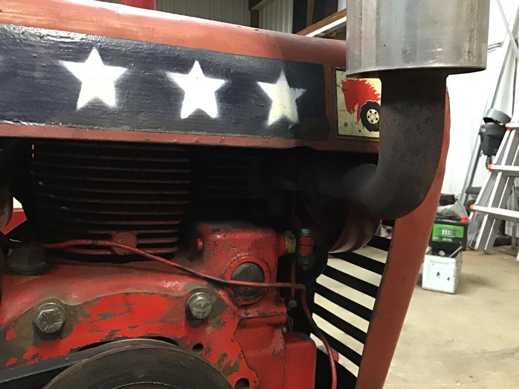

Pullstart 71,482 #8 Posted February 3, 2020 Here are some more pics. I guess what I’m trying to say, is support your stack. The curved brace support was a necessity as to fatigue from miles of road between home and shows. All these pictures are from browsing through my build links 2 Share this post Link to post Share on other sites

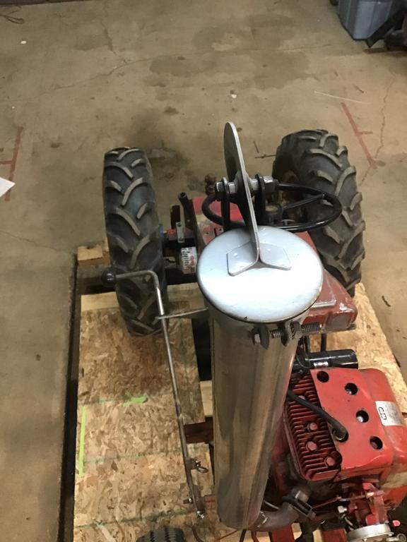

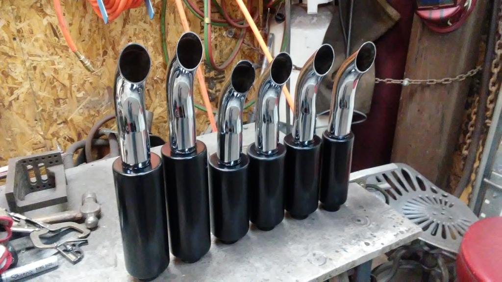

jimkemp 533 #9 Posted February 3, 2020 I still make these , and can make them with a straight stack with a rain cap 2 8 Share this post Link to post Share on other sites

Bonsaiguy247 18 #11 Posted February 4, 2020 How much do you charge? And can you make an all chrome one? Share this post Link to post Share on other sites
ebinmaine 81,048 #12 Posted February 4, 2020 7 hours ago, Bonsaiguy247 said: How much do you charge? And can you make an all chrome one? @jimkemp Share this post Link to post Share on other sites

953 nut 70,064 #14 Posted February 4, 2020 Looks good, seems like it was well cared for. Given a little love it will continue to provide great service. This manual may come in handy along the way. 1 Share this post Link to post Share on other sites

jimkemp 533 #19 Posted February 4, 2020 18 hours ago, Bonsaiguy247 said: How much do you charge? And can you make an all chrome one? They are $60 for what you see , to get one chromed is $135 plus the $60 and it takes about 4 weeks to get one sent out to the chrome and get it back 1 1 Share this post Link to post Share on other sites

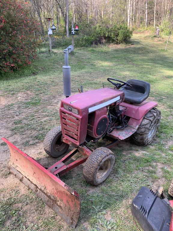

Mike in NC 342 #20 Posted April 26, 2020 Here is the stack I installed on our Bronco 14. It is a TSC Farmall Cub muffler with 1" pipe and fittings. It does sound better than the rusted out old muffler. I am not big on modifications, but the old exhaust blew out right on my foot, so this way it is up and away from me. I did think about installing a Cub Low-Boy exhaust that runs under the tractor. Our Bronco only gets used to haul a cart and push snow or dirt. 2 Share this post Link to post Share on other sites
