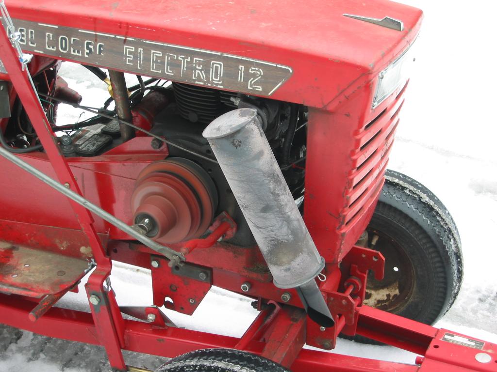

AHS 1,679 #32 Posted February 8, 2020 13 hours ago, balconio said: This might work, for the price ~$35 it might be worth trying (Stens 105-296: these are for 12hp Kohler's fitted to Cub cadet). The exhaust will exit towards the back instead of front. Not sure if clearance to the PTO lever would be an issue with the pipe facing backwards. Or downwards? With the exit facing the frame... I’ll have to get dimensions on it first... that might work. Also @jimkemp made the muffler that I needed in the first picture! I asked him about it.. haven’t heard back yet. Share this post Link to post Share on other sites

ebinmaine 79,077 #34 Posted February 8, 2020 9 minutes ago, AHS said: dimensions I can measure the one I have on Patriot horse later. Makes a great stack or downturn. Just have to get the right length inlet pipe so as to clear the PTO or whatever you have there. Nice quiet deep tone. 1 Share this post Link to post Share on other sites

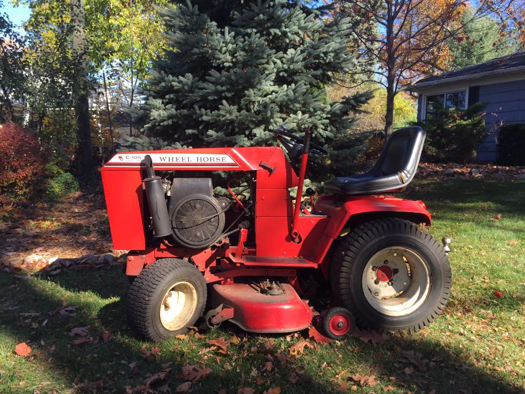

SylvanLakeWH 31,500 #35 Posted February 8, 2020 Just for reference, here is my C-105 with that muffler as a “stack”... 2 Share this post Link to post Share on other sites

ebinmaine 79,077 #37 Posted February 8, 2020 Kinda see it here.... Blue hooded one. Share this post Link to post Share on other sites
