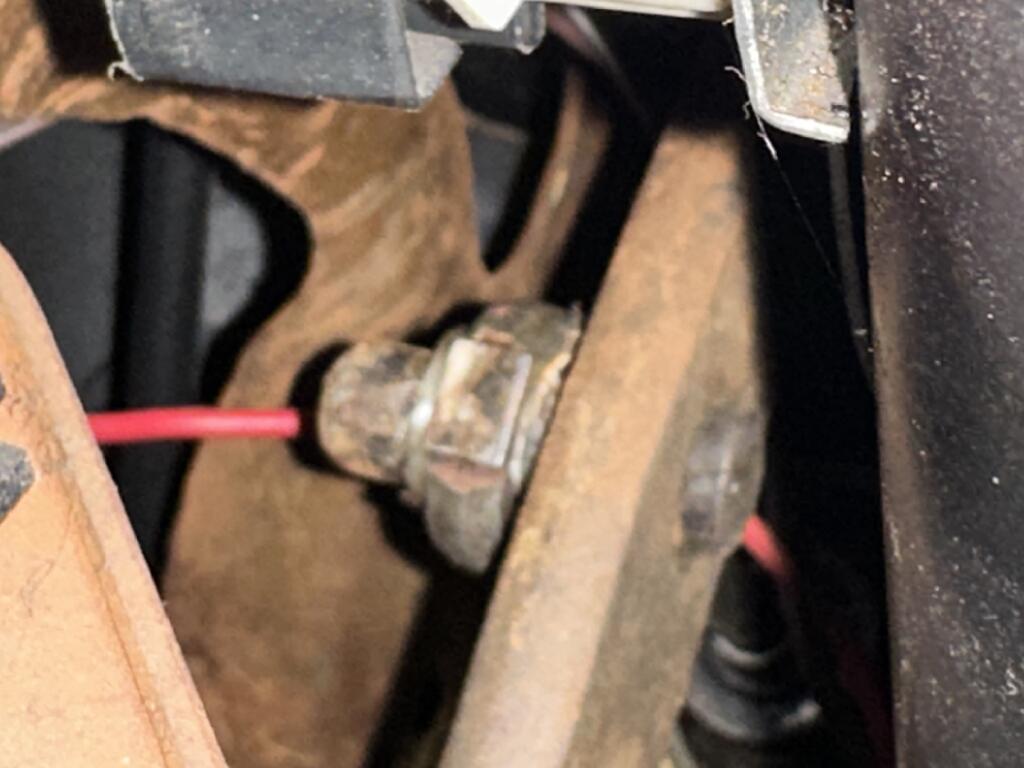

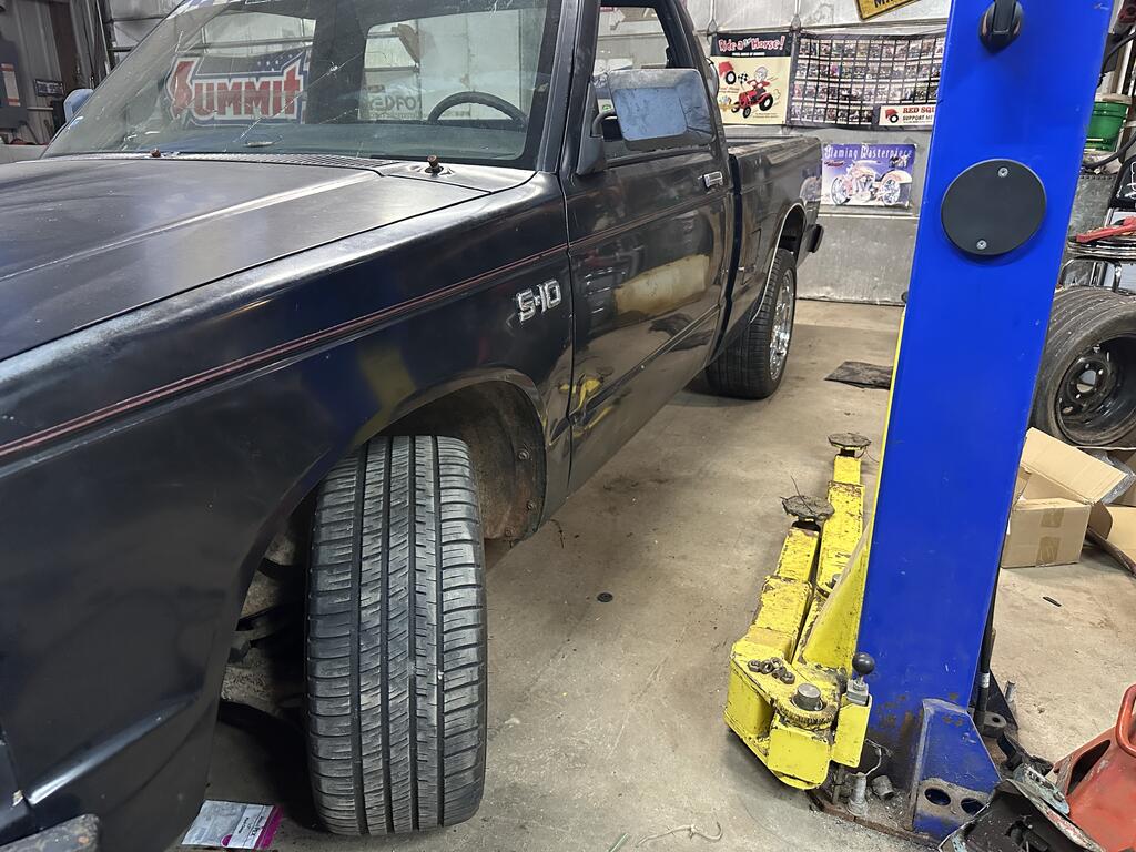

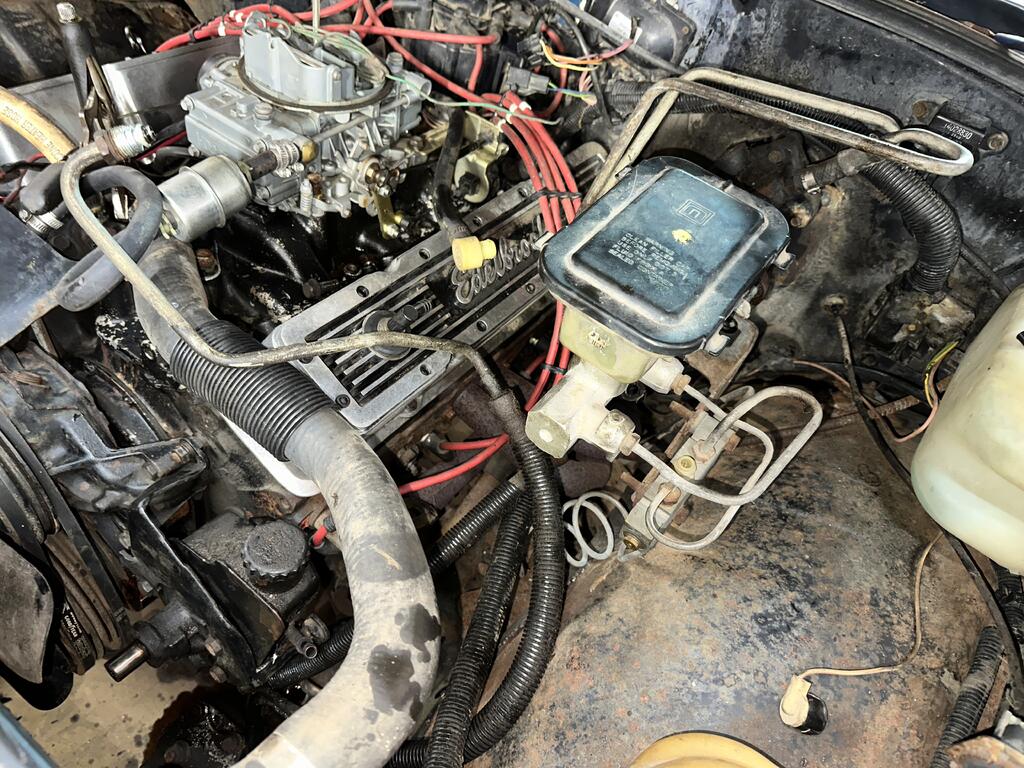

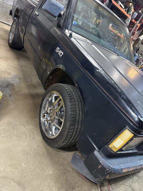

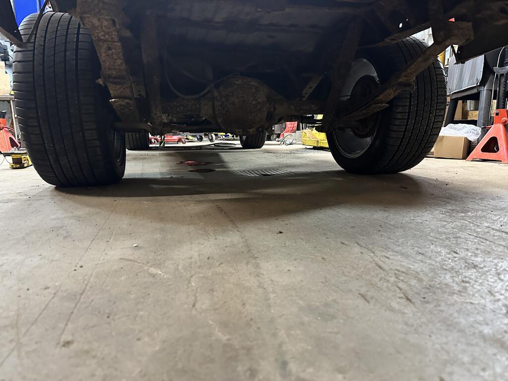

They say you can use a Safari or Astro van to convert an S10 to hydroboost.  I figured the one out of my 2000 K2500 parts truck would be just fine.  Not just fine, but doable.  I heavily modified the stock V8 v belt power steering bracket and also heated and manipulated one of the return tubes on the late model reservoir.  The stock brake master cylinder could not be used either, it did not fit the 3/4 ton booster.  We pulled an oil cooler off the wall in the shop, it was literally part of my shop deco.  It’s mounted to the core support and we need cooling hoses hooked up to it.  Otherwise, it’s nearing time to fire it up!

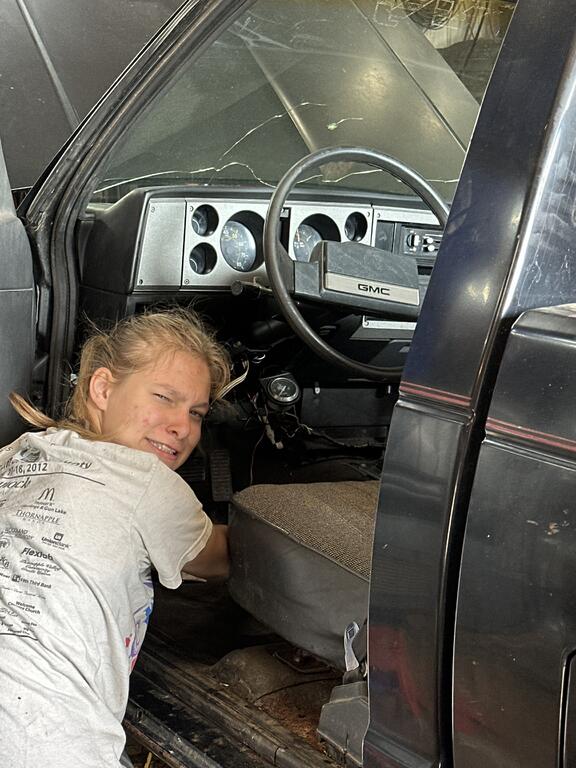

Rylee has been very involved in this project, can’t you see how much fun @Lil’ Pullstart is having?
