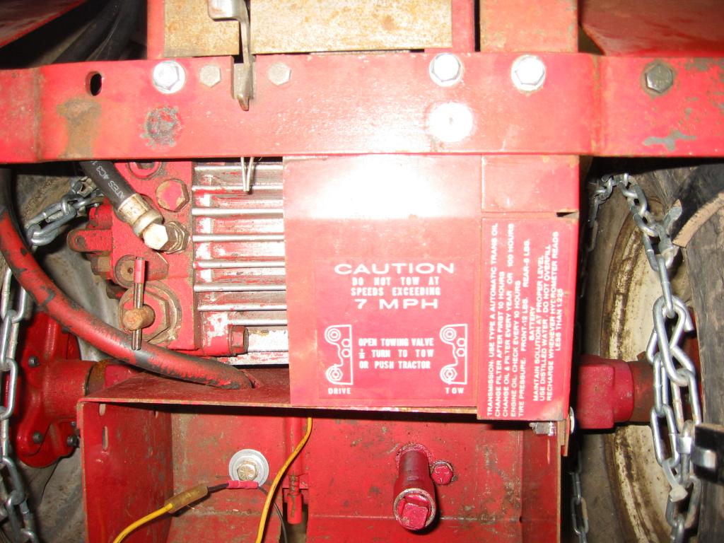

troutbum70 858 #1 Posted January 23, 2020 So Ed if we could not get it started it started and it will skid the tires is there a by pass valve to allow free rolling of the tractor to push load and move it around? Tnx Share this post Link to post Share on other sites
ebinmaine 81,149 #2 Posted January 23, 2020 1 minute ago, troutbum63 said: So Ed if we could not get it started it started and it will skid the tires is there a by pass valve to allow free rolling of the tractor to push load and move it around? Tnx if that's the same transmission that's in my 1970 Charger there will be a valve under the seat pan. Should be a label next to it that tells you what to do with it. I can post a picture later on this evening but I'm sure somebody will help you out by then. Share this post Link to post Share on other sites
troutbum70 858 #3 Posted January 23, 2020 Okay EB I probably won't get over there till maybe next week so no hurry, I felt there had to be a way to put it into free wheel same as the 417A with the eaton that I have as a parts tractor. Share this post Link to post Share on other sites
Cvans 1,009 #4 Posted January 23, 2020 You only need to turn the valve one quarter turn in either direction if I remember correctly. If you go a half turn you will be back in the drive setting. took me a while to figure that out. I'm kind of slow you know. It is still not going to roll easily. 1 Share this post Link to post Share on other sites
troutbum70 858 #5 Posted January 23, 2020 Okay Cvans I think I misunderstood Ed's post, if it were pulled and the wheels tires roll it is good sign. If the wheels/tires slide then there may be an issue with it being maybe set up maybe. And okay on turning the valve a quarter turn under the seat thank you. Share this post Link to post Share on other sites
ebinmaine 81,149 #6 Posted January 23, 2020 21 minutes ago, Cvans said: You only need to turn the valve one quarter turn in either direction if I remember correctly. If you go a half turn you will be back in the drive setting. took me a while to figure that out. I'm kind of slow you know. It is still not going to roll easily. 1 minute ago, troutbum63 said: Okay Cvans I think I misunderstood Ed's post, if it were pulled and the wheels tires roll it is good sign. If the wheels/tires slide then there may be an issue with it being maybe set up maybe. And okay on turning the valve a quarter turn under the seat thank you. Guys I only have the one hydro so next to no experience. This one turns a full half turn. Share this post Link to post Share on other sites
troutbum70 858 #7 Posted January 23, 2020 Eb is yours an eaton and not sundstrand? Share this post Link to post Share on other sites
ebinmaine 81,149 #8 Posted January 23, 2020 3 minutes ago, troutbum63 said: Eb is yours an eaton and not sundstrand? Sundstrand Eaton may very well be different. 1 Share this post Link to post Share on other sites
troutbum70 858 #9 Posted January 23, 2020 Okay looking at tractor data . com the electro 12's had sundstrands. 1 Share this post Link to post Share on other sites

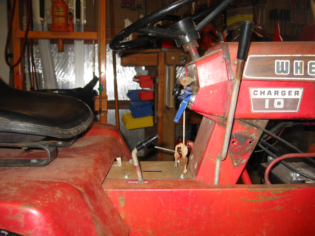

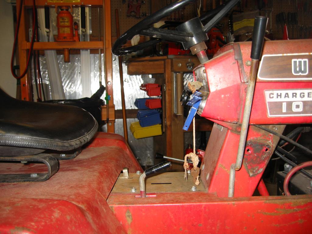

pfrederi 21,308 #10 Posted January 23, 2020 (edited) If the tow valve is in tow position then you should be able to push the tractor IF you push the hydro engagement lever down (engaged). I know it is counter intuitive you would think you want the hydro disengaged...but when you pull the lever up you are setting the parking brake(if it still works) It is one half turn. Long piece forward is drive mode. Back is tow. Note you want the hydro engagement lever down to push. Edited January 23, 2020 by pfrederi 2 2 2 Share this post Link to post Share on other sites

Cvans 1,009 #15 Posted January 24, 2020 I'm going to retract my statement about the freewheel valve. Eric has me wondering if I'm misleading you. Mine had no decals next to the valve. If I'm out there tomorrow I'm going to check mine. It's all stripped down so it's easy to push now. I never could find a spot where it felt like it wanted to roll freely. I will say the diesel engine put a lot of torque through that hydro and it never once gave an ounce of trouble. Impressive piece of engineering. 1 Share this post Link to post Share on other sites
troutbum70 858 #16 Posted January 24, 2020 Thats okay no problem I will not hold you to the accuracy of the bible Cvans. 2 Share this post Link to post Share on other sites
Cvans 1,009 #17 Posted January 25, 2020 Went out today and found out Eric was right. 1/2 turn to go from freewheel to drive positions. 1 Share this post Link to post Share on other sites
