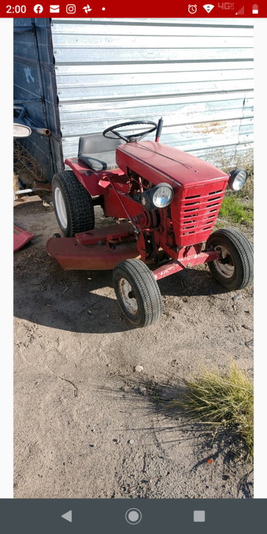

I inherited a wheel horse and have always loved them. It's a 1967 1257 with a 12 hp Kohler. Few questions. If I find a 10 or 14, will all my external parts fit ? I almost put a Chinese motor on but really dont want to modify stuff. I know I have the big oil pan. Anything else I should know? I'm trying to find a good used motor but it's being a little tough. I'm in Nampa Idaho so we don't have a lot of wheel horses over here. If I ever drive out to the east coast or Midwest I'm bringing me back lawn mowers!
:WRS:
Similar vintage engines from a horse should bolt up.
Others will be around to give you better information.
Too bad you're so far away.
I only have 2 spares....
You could look into having one shipped...
What's wrong with the current engine?
:WRS:
If the replacement engine (K-241, K-301, K-321, M10, M12, M14) has the same large oil pan configuration it will bolt right on to your present oil pan. You would be able to swap your flywheel, SG etc. to a later model engine or use the starting/charging system that comes with the engine.
When you locate and engine please post a question on here so we can let you know what will and won't work well. With enough money and determination anything can be made to work, but we want to save you some aggravation if we can.

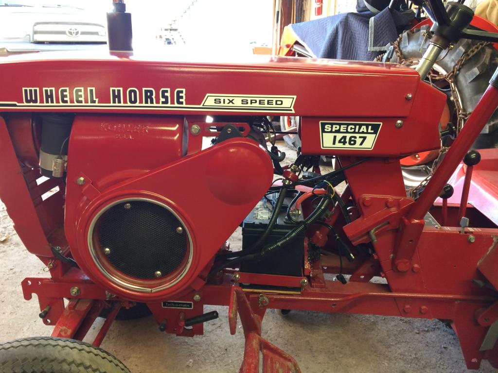

I put a K 321 from  the late 70's on a 1267. Removed the ring gear from the flywheel and used the original tractor engine shroud and kept the starter / genny configuration.
I was looking at yours last night before you commented. I like the decal change. I just want a reason to go a few States over and buy a couple. There was a patina rusty 1959 wheel horse 60 miles away for $900. I wouldnt have paid that but I'll probably rarely find a late 50s to early 60s. In my head, I just want 3-4 wheel horses all running and mowing at the same time. I have an acre. It's gonna be awhile before that picture is taken!
