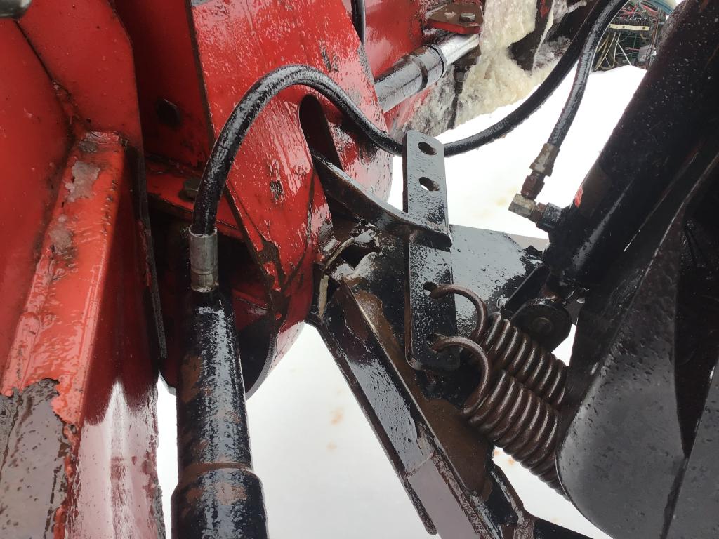

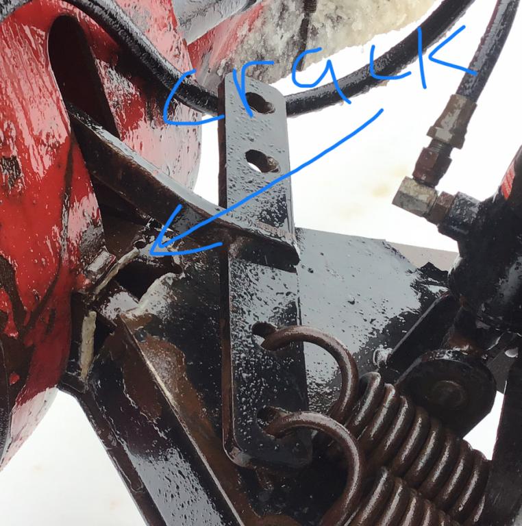

Pullstart 71,466 #1 Posted January 18, 2020 I grabbed a good bite of a cracked driveway this morning, traveling probably 15 mph. I snapped two trip springs and stretched two others. By the time I got home to fix the springs, my plow’s about to snap off and I broke a hydraulic fitting. Oh man. 5 Share this post Link to post Share on other sites
Pullstart 71,466 #2 Posted January 18, 2020 I was able to jack the plow in place... or close enough to bust out the welder. I’ll get the trip springs out of the way then start burning on the steel. 4 Share this post Link to post Share on other sites
adsm08 5,214 #3 Posted January 18, 2020 Looks like your mounting frame is torn good at the end. Time for some welding. Share this post Link to post Share on other sites

Pullstart 71,466 #8 Posted January 18, 2020 That should hold. 7 Share this post Link to post Share on other sites

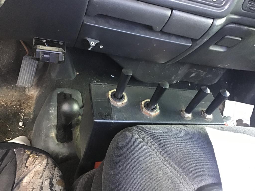

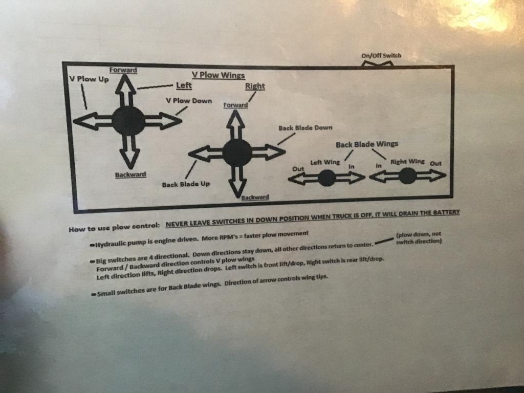

Tractor boy 239 #12 Posted January 18, 2020 @pullstart is that a normal controller for a boss v plow? On the fishers we use we just have a joy 5 button joy stick and you hit a certain button to change the 4 others. Share this post Link to post Share on other sites

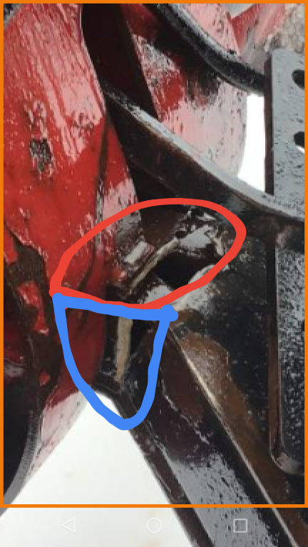

ebinmaine 81,003 #13 Posted January 18, 2020 Nice job on that repair Kevin. Upper part of the crack, circled in red, looks like it may be older than the lower part, circled in blue...? 3 Share this post Link to post Share on other sites
Pullstart 71,466 #14 Posted January 18, 2020 1 hour ago, ebinmaine said: Nice job on that repair Kevin. Upper part of the crack, circled in red, looks like it may be older than the lower part, circled in blue...? I do believe you’re right. It did look pretty rusty on the top. I feel like the trip springs were holding it all together. 1 Share this post Link to post Share on other sites
Darb1964 1,176 #15 Posted January 18, 2020 That's a heavy plow for that frame to hold, good job welding, looks like it has had a lot of use. I never had a v plow. I had one plow a western that tripped the blade like that and the springs to snap it back in place, I did not care for it, sometimes snow would fall on it and it wouldn't snap back all the way. Lots of weight and stress on the frame. I liked the Fisher plows that the bottom edge tripped. Had to keep a good eye on the ware blade though if it was way down the spring brackets would ware off and, well big problems. Plowing is a love/hate relation, I miss but then I don't. 3 Share this post Link to post Share on other sites

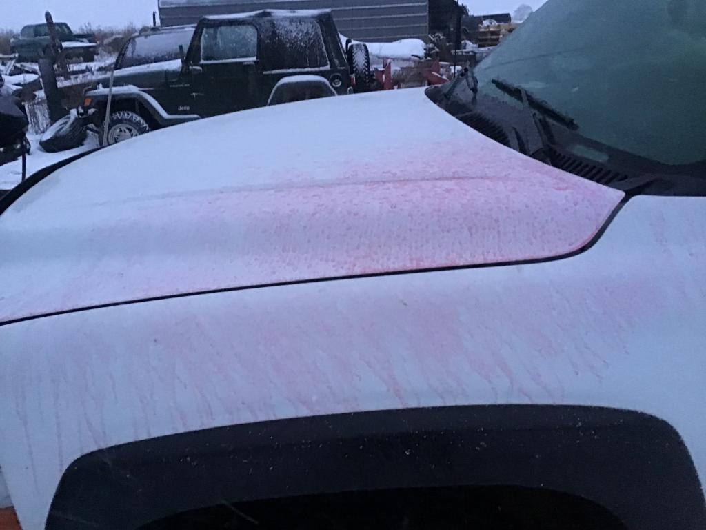

Pullstart 71,466 #16 Posted January 18, 2020 @Darb1964 I love my 16’ back blade. I wish my front plow was an 8’ straight edge, or even one of the Blizzard or Western Wide Outs that extend to 10’. I hear you about love/hate. Right now it’s a bit more on the hatred side... but it’s because I’m frustrated. I just covered my truck with hydraulic fluid and I’m not sure where it’s coming from. My residential customers and weekend needs commercial accounts are taken care of. Tomorrow’s another day. I’ll fix the blowout and clean up the rest of my commercial accounts before Monday rolls around. After the repairs, it’ll slide back to the love side of the business. 3 Share this post Link to post Share on other sites

Pullstart 71,466 #18 Posted January 18, 2020 3 hours ago, Tractor boy said: @pullstart is that a normal controller for a boss v plow? On the fishers we use we just have a joy 5 button joy stick and you hit a certain button to change the 4 others. This controller is all custom. One of the previous owners built the control package. It runs via an under the hood clutch pump. There’s a monster reservoir, of which I just emptied in the office parking of a commercial account. Oops. From the pump, it splits to the front and rear valve blocks. The Boss is essentially just a skeleton, of which the custom controls pushes around. 1 1 Share this post Link to post Share on other sites

ebinmaine 81,003 #20 Posted January 18, 2020 15 minutes ago, pullstart said: I just covered my truck with hydraulic fluid and I’m not sure where it’s coming from A leak in the hydraulic system. Sorry... I just had to. ..... 1 1 Share this post Link to post Share on other sites

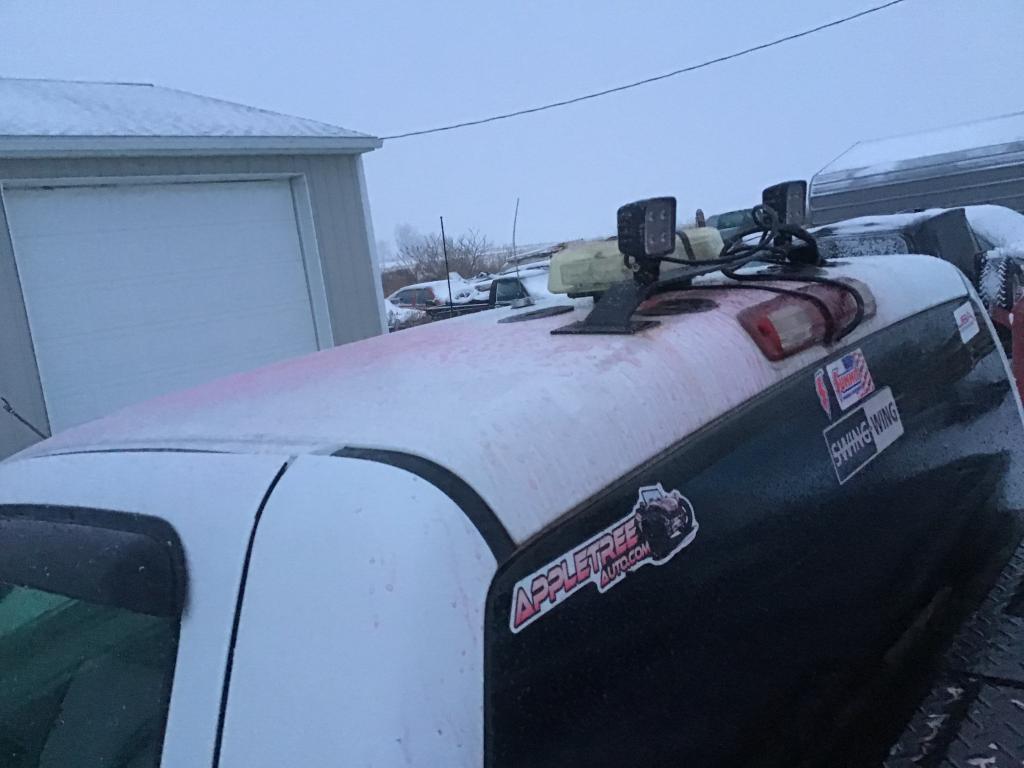

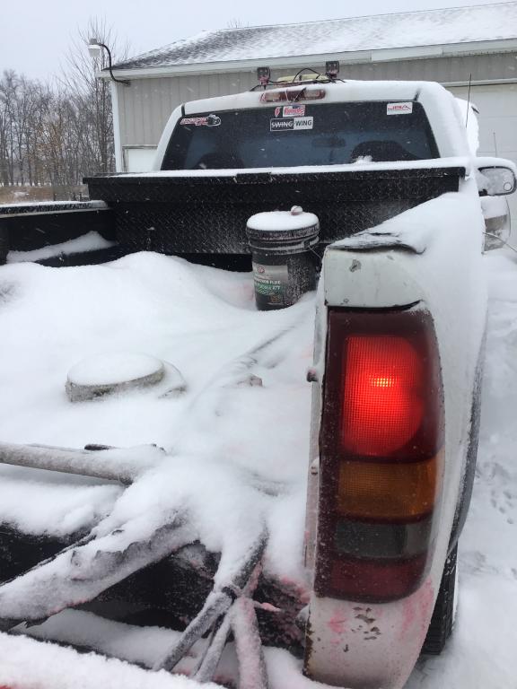

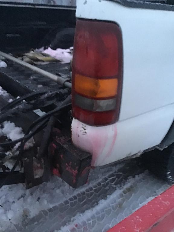

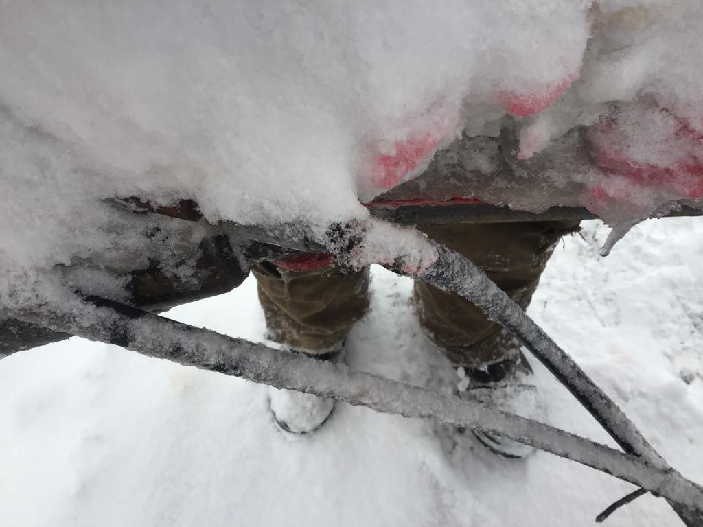

Pullstart 71,466 #24 Posted January 19, 2020 Sometimes a little rest will give new perspective on things. A wing cylinder line blew. It was able to shoot hydraulic fluid (auto trans fluid mixed in for color) completely over the truck. Easy peasey. 2 Share this post Link to post Share on other sites
Pullstart 71,466 #25 Posted January 19, 2020 @Tractor boy here’s some light on that controller. When I bought the truck, the guy got it out of the barn for me, then turned me loose. I drew this up so if anyone happens to need to take the truck for me, it has a little less learning curve. My muscle memory knows this control quite well now... most the time. I really don’t know if it was me or the truck that was slow to skip over the big crack. 1 Share this post Link to post Share on other sites
