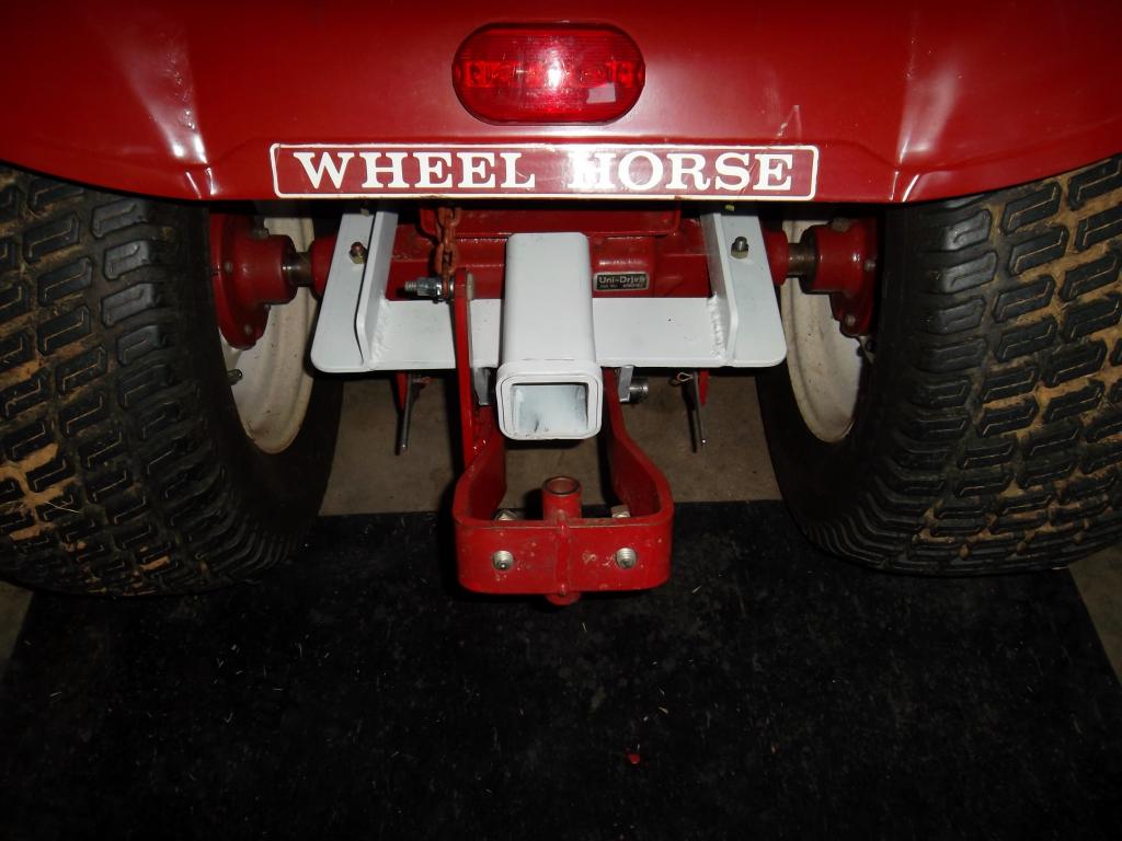

Lee1977 7,805 #3 Posted January 18, 2020 (edited) If your Ranger uses a standard rear axle plow hitch. Remove the top metal brackets and add some 1/4" thick by 2" angle to extend out past the rear. You can then attach a box for weight or a receiver hitch to install a weight bracket or a box that can easily be removed. If just attaching a box,I would turn the angles obsite from mine so the box could sit on the angles. Edited January 18, 2020 by Lee1977 Share this post Link to post Share on other sites

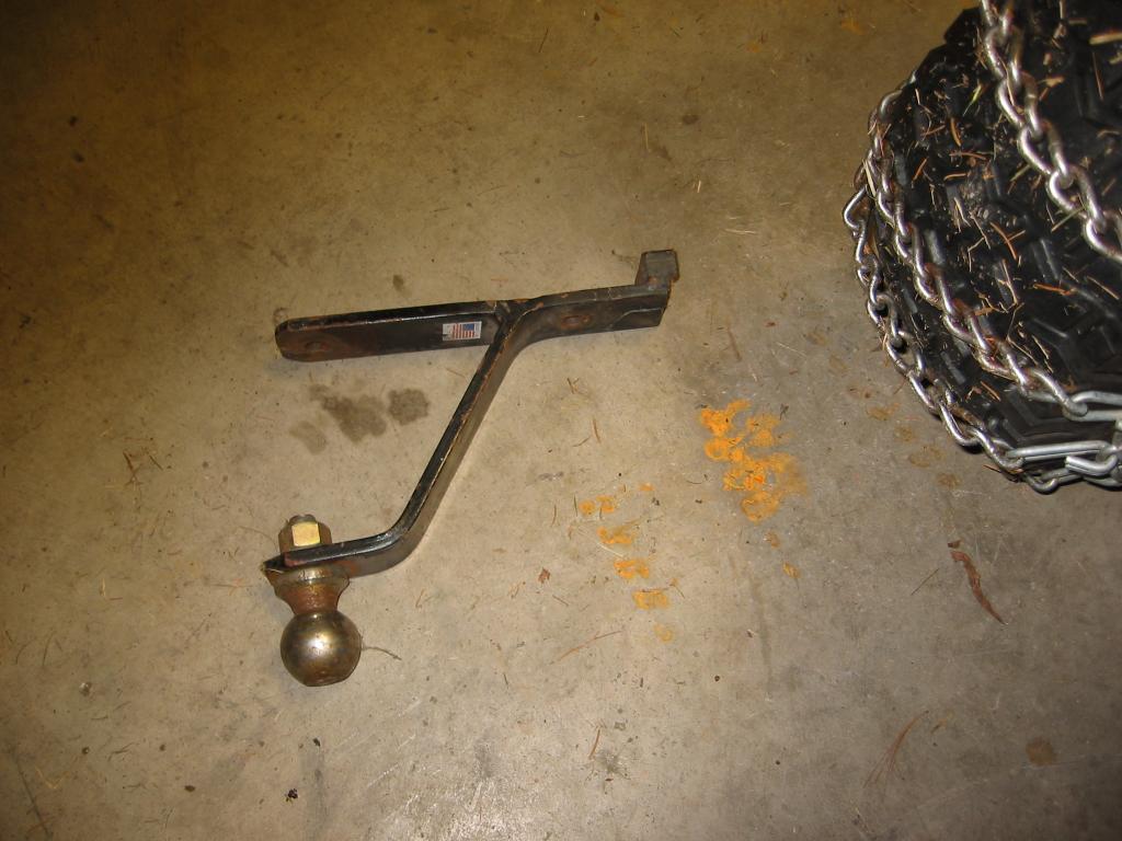

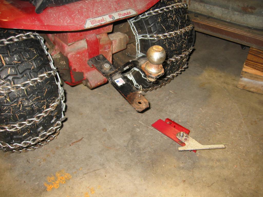

pfrederi 21,225 #8 Posted January 18, 2020 Here is a hitch extender I bought for my Ranger many years ago. You have to be very carefully with the amount of loading. i bent my draw bar while using it but 40-50 lbs shouldn't be a problem. 1 Share this post Link to post Share on other sites
CCW 1,519 #9 Posted January 18, 2020 Remove the ball and put a piece of round stock thru the hole and bolt to lower hole. Can the extender gain additional support from some bolts on the transmission. Maybe some here can help with that. 2 Share this post Link to post Share on other sites
Lee1977 7,805 #10 Posted January 18, 2020 (edited) You could still clamp the angle to the square axle housing . Four bolts and some 1/4" flat bar on the bottom. Edited January 18, 2020 by Lee1977 1 Share this post Link to post Share on other sites
