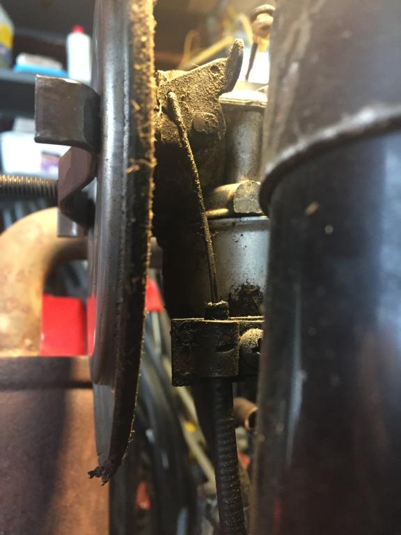

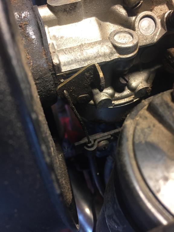

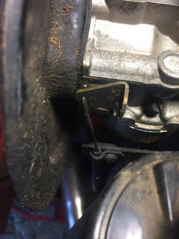

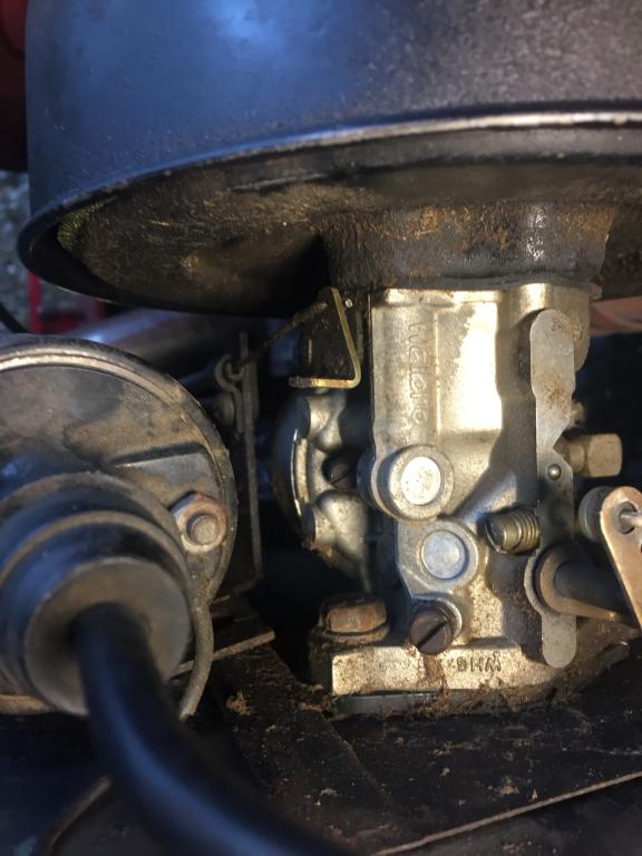

SylvanLakeWH 30,482 #3 Posted January 18, 2020 Here ya go!!! This is off a 10 hp Kohler but hopefully enough to get you squared away. Need another pic angle let me know! Thanks for the heads up @ebinmaine! 1 Share this post Link to post Share on other sites

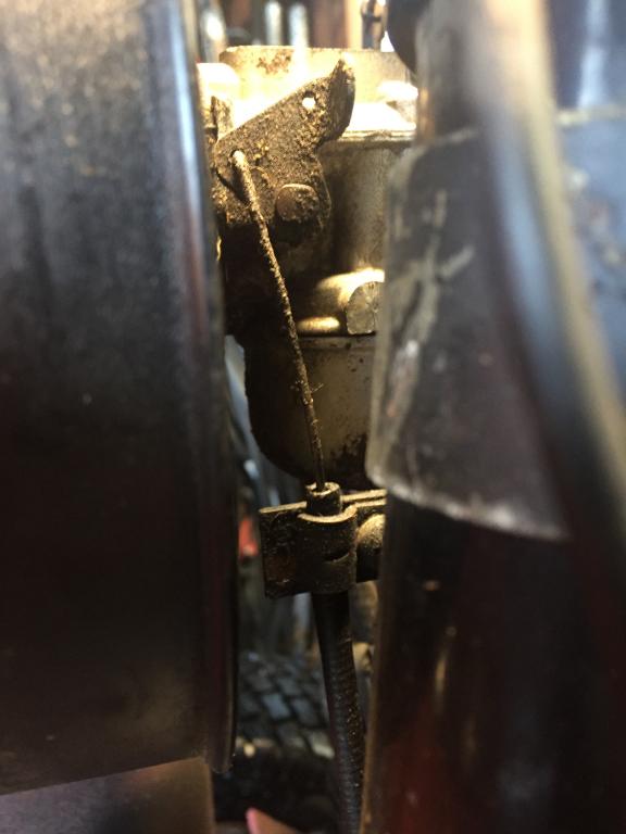

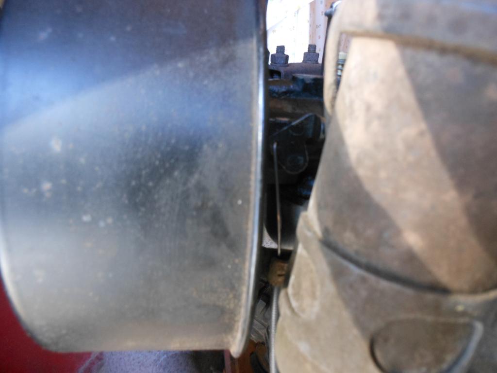

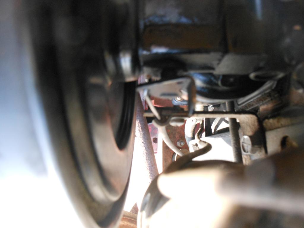

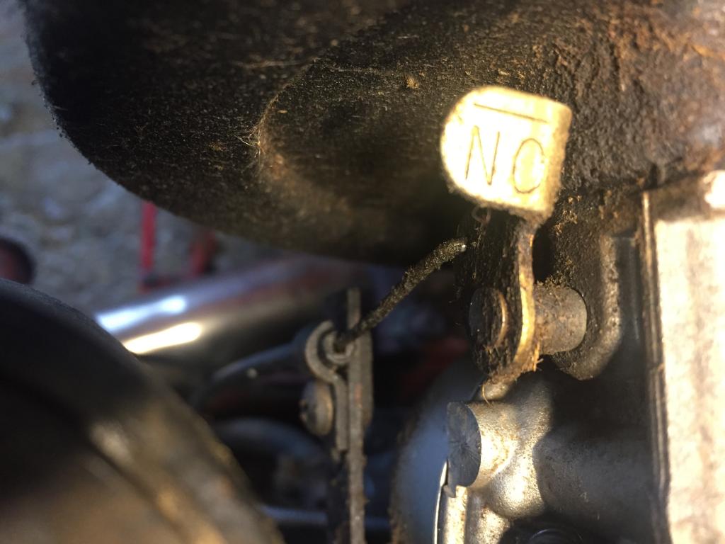

JCM 10,639 #4 Posted January 19, 2020 Not the best pic but from my 1984 C-165- 8 If you look hard at it I think it is the same as @SylvanLakeWH pic. 1 Share this post Link to post Share on other sites
