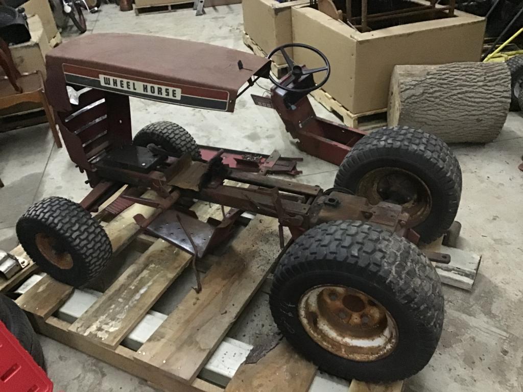

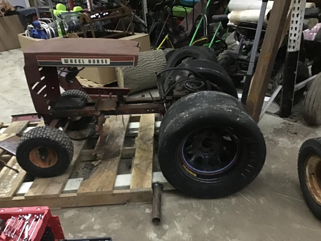

Pullstart 71,259 #64 Posted January 9, 2020 Well here is some progress. I dug some of the major components out of the rack! The transmission was in one of the 2’ deep totes. I forgot how heavy it was! 3 Share this post Link to post Share on other sites

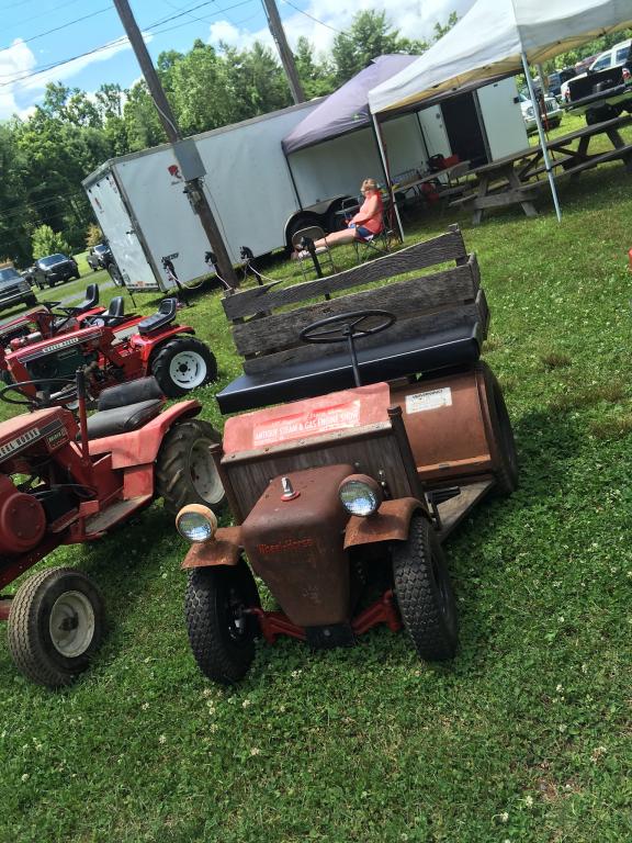

Pullstart 71,259 #65 Posted January 9, 2020 @wallfish I’m pretty sure you were a pioneer of the doodle bug style Horses. Do you have any archived pictures of your steering setups for offset steering shafts? I thought I took better pictures at the show, I guess not. Seems the fan gear on this one was on the “firewall” but I don’t recall the rest of it. 1 Share this post Link to post Share on other sites
Pullstart 71,259 #66 Posted January 9, 2020 I love finding potential parts! Share this post Link to post Share on other sites
Pullstart 71,259 #67 Posted January 9, 2020 I realize my explanation is a bit backwards from the DB setup. The inside pulley is the driven one. When the clutch locks up, the outside pulley begins to drive the transaxle forward. I’m sure either way would work, if I can fit it into the build! Share this post Link to post Share on other sites

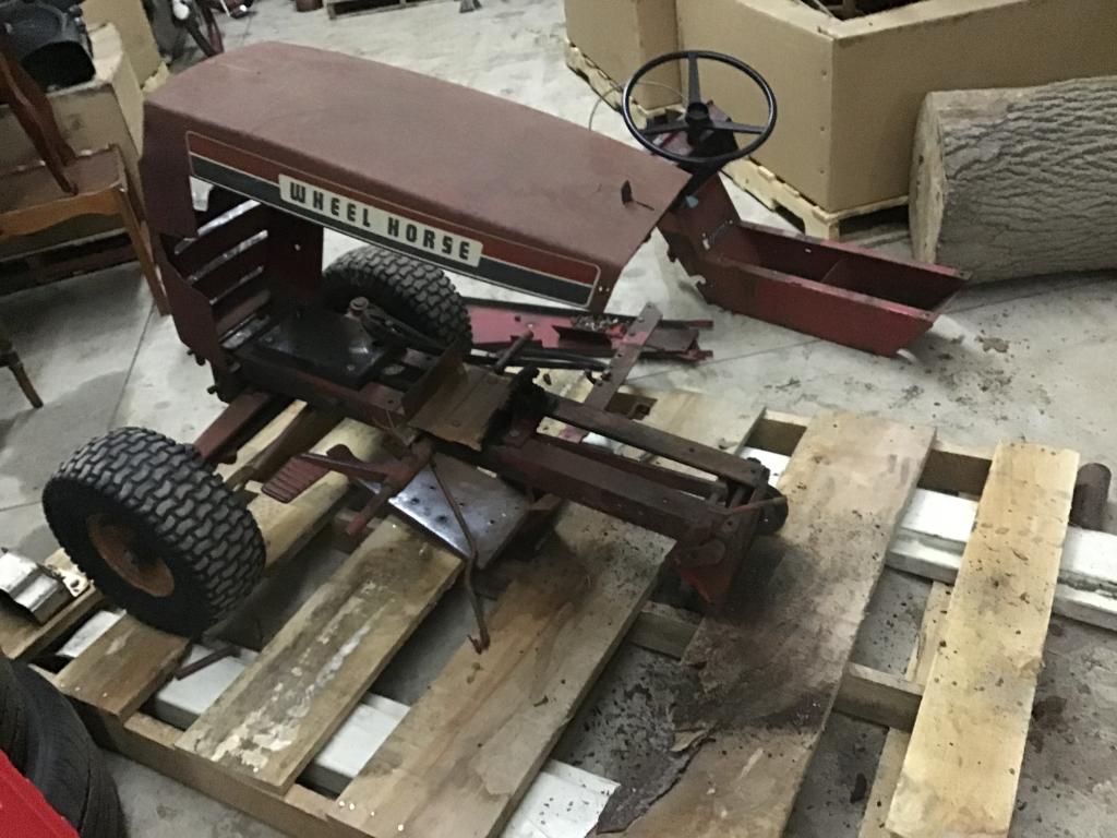

Pullstart 71,259 #68 Posted January 9, 2020 And just like that, we have a pile of parts! 3 Share this post Link to post Share on other sites

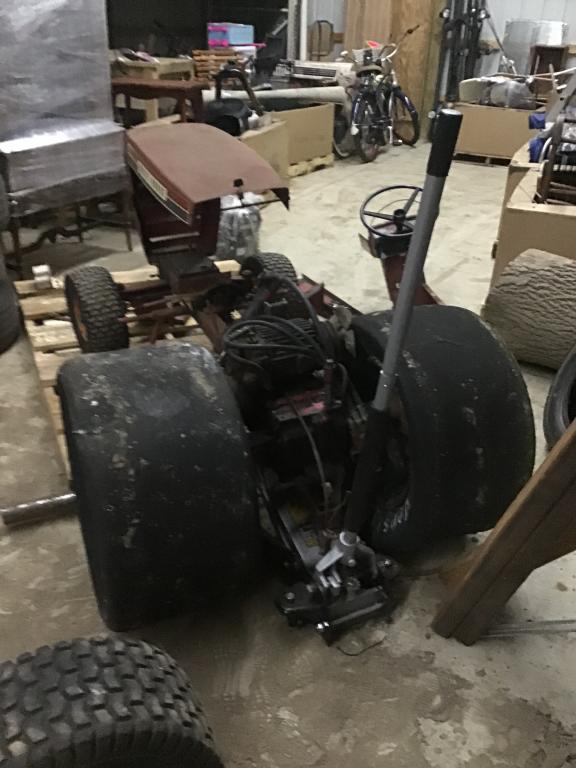

Pullstart 71,259 #69 Posted January 9, 2020 These are 27x10’s. Dare I say they are too big? I think I’ll find a set of 8” wide tires around here and go from there. No matter how I make it longer, one thing’s for sure. It needs to be longer! The hydro trans is bolted up for the time being. 3 Share this post Link to post Share on other sites
ebinmaine 80,743 #70 Posted January 9, 2020 4 hours ago, pullstart said: too big? No!! They're perfect..... IMHO of course.... 1 1 Share this post Link to post Share on other sites
19richie66 17,935 #71 Posted January 9, 2020 Actually a set of meats that big with some tread on them would look killer tucked up under the bed and would take up some length on the visual side of it, meaning you wouldn’t have as much frame showing down the side under the bed. Keep it going Kev........ 2 1 Share this post Link to post Share on other sites
wallfish 20,618 #72 Posted January 9, 2020 (edited) 7 hours ago, pullstart said: @wallfish I’m pretty sure you were a pioneer of the doodle bug style Horses. Do you have any archived pictures of your steering setups for offset steering shafts? I thought I took better pictures at the show, I guess not. Seems the fan gear on this one was on the “firewall” but I don’t recall the rest of it. I can probably find some but it was offset with a couple of sprockets and a chain. Just a quick thought for something more "heavy duty" is to use a couple of universal joints in the shaft and maybe in the steering wheel shaft too. A Ross type of steering mechanism would be easy to offset and give reliability. Or, if your ambitious enough, a plan I have for a build is use two frames welded side by side, cut one side off of two front axles after the axle pin and use coil over shocks from a frame to the front axles for front suspension. Now the frame will be wide enough to easily offset the steering with different length tie rods Edited January 9, 2020 by wallfish 1 4 Share this post Link to post Share on other sites
953 nut 69,369 #73 Posted January 9, 2020 20 minutes ago, wallfish said: Ross type of steering mechanism would be easy to offset and give reliability or a fan-gear from the 953/1054/GT-14 with a drag link going to the left spindle just like is on "Hot Wheels" 25 minutes ago, wallfish said: two frames welded side by side, cut one side off of two front axles after the axle pin John, do you think that a wider front axle would help with the steering problem a longer frame would create? 1 Share this post Link to post Share on other sites
