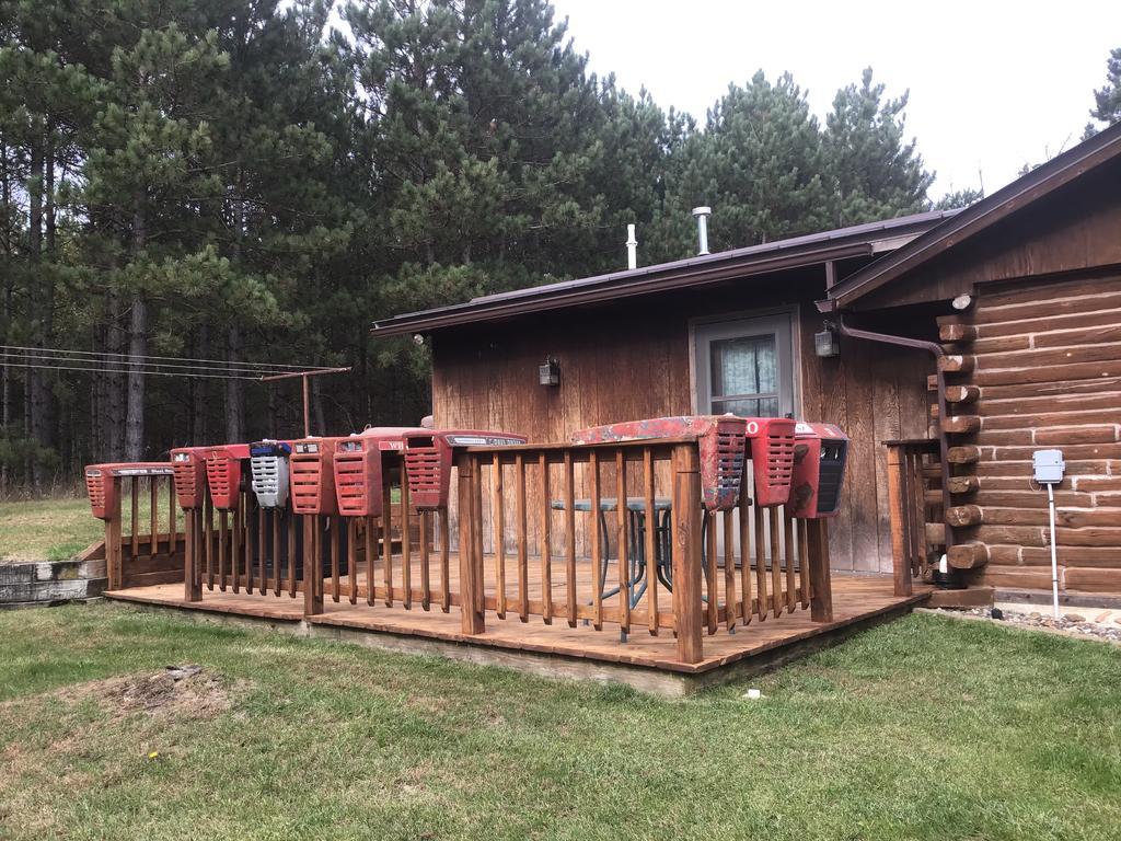

WHX?? 58,162 #45 Posted January 7, 2020 4 hours ago, 19richie66 said: 180,000 pages long before he starts on the tractor. The way you go at it. … I'll donate a hood.... 2 2 4 Share this post Link to post Share on other sites
The Tuul Crib 7,354 #46 Posted January 7, 2020 Ill take the red one Jim! 4 Share this post Link to post Share on other sites
