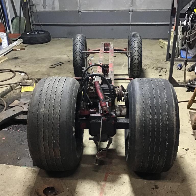

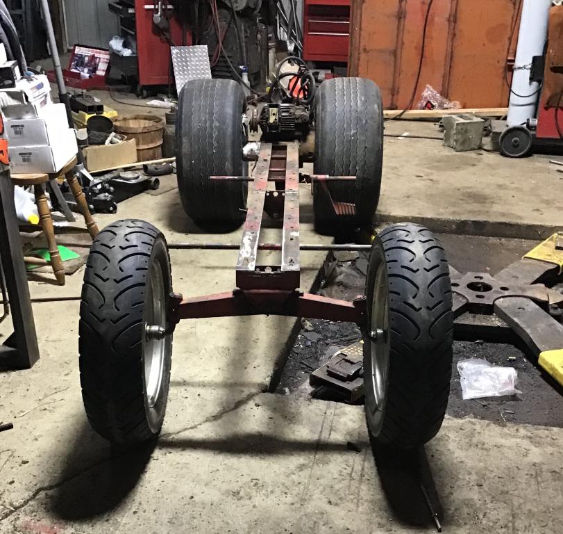

wallfish 17,949 #443 Posted July 1, 2023 LET"S ALL BUILD WH TRUCKS !!!!!! We'll have to get Eric @ebinmaine and Colossus involved here too! I've been trying to build a WH truck (Gator type of thing) with a bed since 2010. Seems every time it gets started it turns into something else. Little seater way back when started out as being a truck. I'm think'n big tires up front. (Trailer hubs with 1" bearings can be added to regular 3/4" WH spindles with DOM tube.) That's what is on that new can-am bike. That build actually started as another 2 seater, then a truck and ended up as "motorcycle" type of thing. It still needs plenty of work and tweaking but I'm ready to start putting some stuff together for a WH truck build again. Already have some 1" spindles, trailer hubs, bunch of frames, Couple different steering gear setups, engines, ideas and an old trailer to donate as the bed. My thoughts are to try and keep it short as possible so it's lawn limo with a bad steering radius. You guys might have more room where that's less of a concern. One thing I can tell you is splitting the axles and going front suspension can be time consuming. Sharing ideas, successes and failures as it goes helps everyone. 1 1 4 Share this post Link to post Share on other sites

wallfish 17,949 #446 Posted July 1, 2023 7 minutes ago, ineedanother said: Hey John, I like the way you think and wish I had the room to tinker with something like that. Regarding the hubs though even if a bit I'm sure that's been covered but I can't find a thread. Anyone know of one? I don't think the guys on here building stuff worry about "off topic" custom stuff questions. It's all relevant! Don't think I've posted anything before but have made suggestions about it before. The thing to consider is it doesn't necessarily "beef up" the spindles because it's still the stock 3/4 spindle bend. But you can add braces like the heavy duty 3/4 spindles as a way to do that in addition to this. 3/4 ID x 1" OD DOM tube. You'll need a short piece of 1" ID x 1 1/4 OD to cut for 1/4" slivers for the ID of the seals that are on the inside of the bearings. The ends of the spindles will need to be drilled and tapped for bolts to hold those bearings in place along with washers. Basically using bolts to serve as the castle nuts to tighten them and hold them. I might be pulling those hubs off the can-am bike to work on the front end of it and a pic is worth a 1000 words. The DOM tube can't be the exact size but it's sold with a couple/few thousandths over/under. IE: An Exact 3/4 ID will not fit on an exact 3/4 OD because they are the same exact measurement. A couple/few thousandths difference is needed for the tolerance to fit over each other. 2 3 Share this post Link to post Share on other sites
ineedanother 1,665 #447 Posted July 1, 2023 21 minutes ago, wallfish said: I don't think the guys on here building stuff worry about "off topic" custom stuff questions. It's all relevant! Don't think I've posted anything before but have made suggestions about it before. The thing to consider is it doesn't necessarily "beef up" the spindles because it's still the stock 3/4 spindle bend. But you can add braces like the heavy duty 3/4 spindles as a way to do that in addition to this. 3/4 ID x 1" OD DOM tube. You'll need a short piece of 1" ID x 1 1/4 OD to cut for 1/4" slivers for the ID of the seals that are on the inside of the bearings. The ends of the spindles will need to be drilled and tapped for bolts to hold those bearings in place along with washers. Basically using bolts to serve as the castle nuts to tighten them and hold them. I might be pulling those hubs off the can-am bike to work on the front end of it and a pic is worth a 1000 words. The DOM tube can't be the exact size but it's sold with a couple/few thousandths over/under. IE: An Exact 3/4 ID will not fit on an exact 3/4 OD because they are the same exact measurement. A couple/few thousandths difference is needed for the tolerance to fit over each other. I think I've got it, and it sounds like I'll be visiting the McMaster-Carr site again soon Bracing the spindles is definitely a consideration too and might be the best bang for the buck in the short-term. 3 Share this post Link to post Share on other sites
