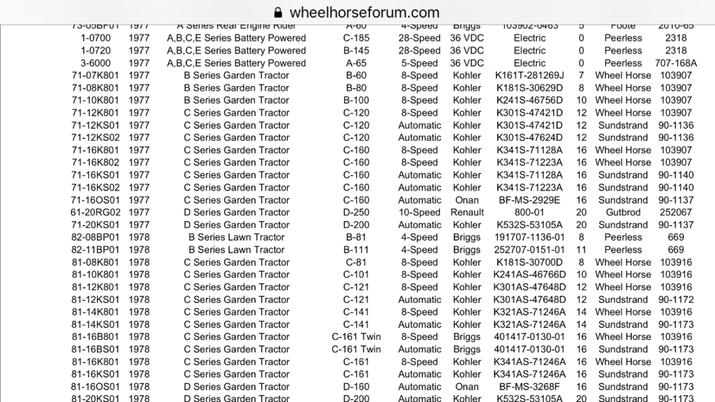

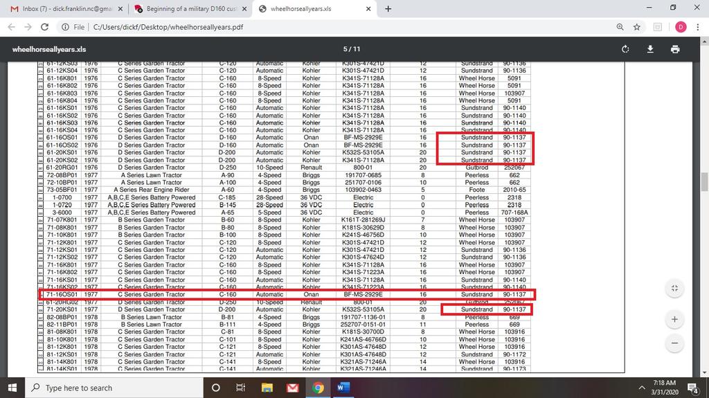

dells68 7,499 #76 Posted March 31, 2020 You know @953 nut, I just looked at that serial number/model list. Did you notice that there is no D160 listed. Right below the C160 is a D250 and a D200. I wonder if that is a misprint? I’ve never heard of a C160 with an Onan before. What do you think? 2 Share this post Link to post Share on other sites
ebinmaine 81,048 #77 Posted March 31, 2020 5 hours ago, dells68 said: misprint I'd say that's the deal... 2 Share this post Link to post Share on other sites

WVHillbilly520H 10,379 #79 Posted March 31, 2020 6 hours ago, dells68 said: I just looked at that serial number/model list. Did you notice that there is no D160 listed. What do you think? 6 hours ago, dells68 said: What's the second from bottom? 1 Share this post Link to post Share on other sites
953 nut 70,064 #80 Posted March 31, 2020 8 hours ago, dells68 said: I wonder if that is a misprint? If you go across to the transmission line you see that it should have been a "D-160" and someone replaced the Onan. 1 Share this post Link to post Share on other sites

dells68 7,499 #82 Posted March 31, 2020 4 hours ago, WVHillbilly520H said: What's the second from bottom? That’s a 78 D160. Only difference is mine starts with a 7. That’s why I’m thinking it’s a misprint. Share this post Link to post Share on other sites

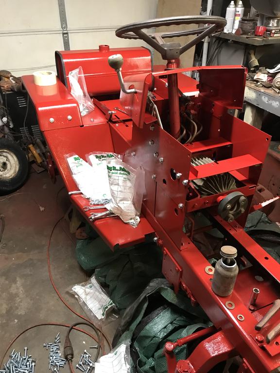

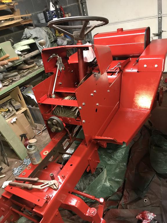

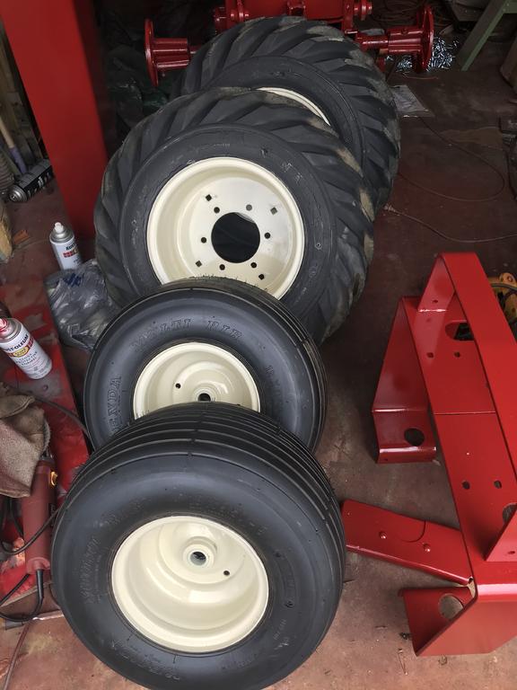

dells68 7,499 #85 Posted April 1, 2020 Finally got the chance to start reassembling Big Red. Here are a couple of pics as of just a little while ago. Gonna quit for the day now. The metal has a pretty good texture to it from its life outdoors. I thought about filling in the pits, but feel like that would be trying to make the tractor something it isn’t-better to let it be just honest! 5 7 1 Share this post Link to post Share on other sites
Pullstart 71,482 #86 Posted April 2, 2020 Looks good Dell! 1 Share this post Link to post Share on other sites

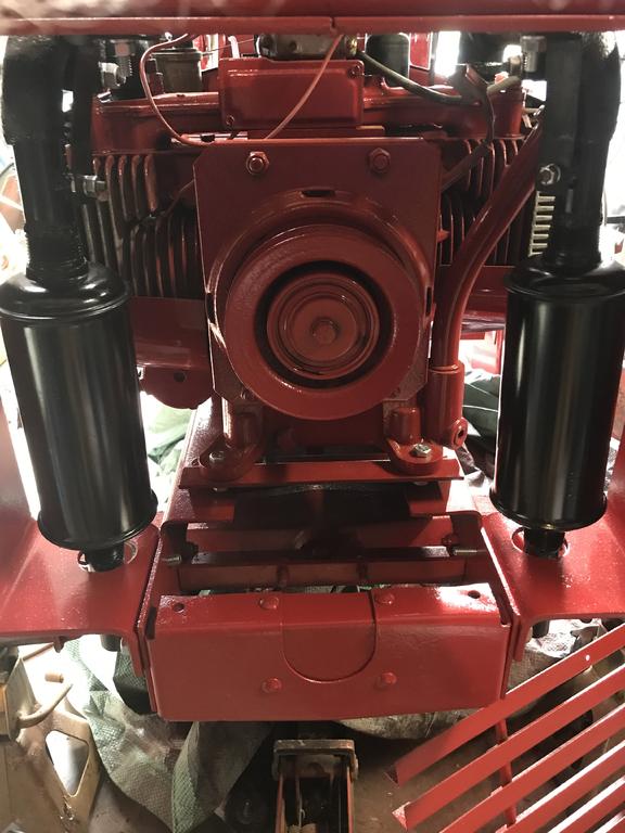

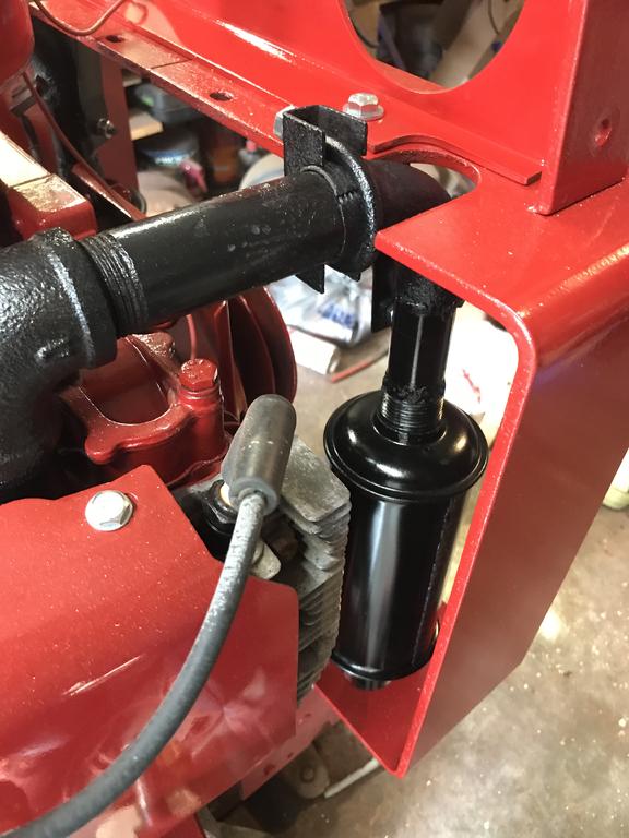

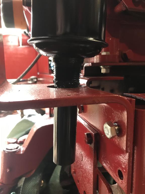

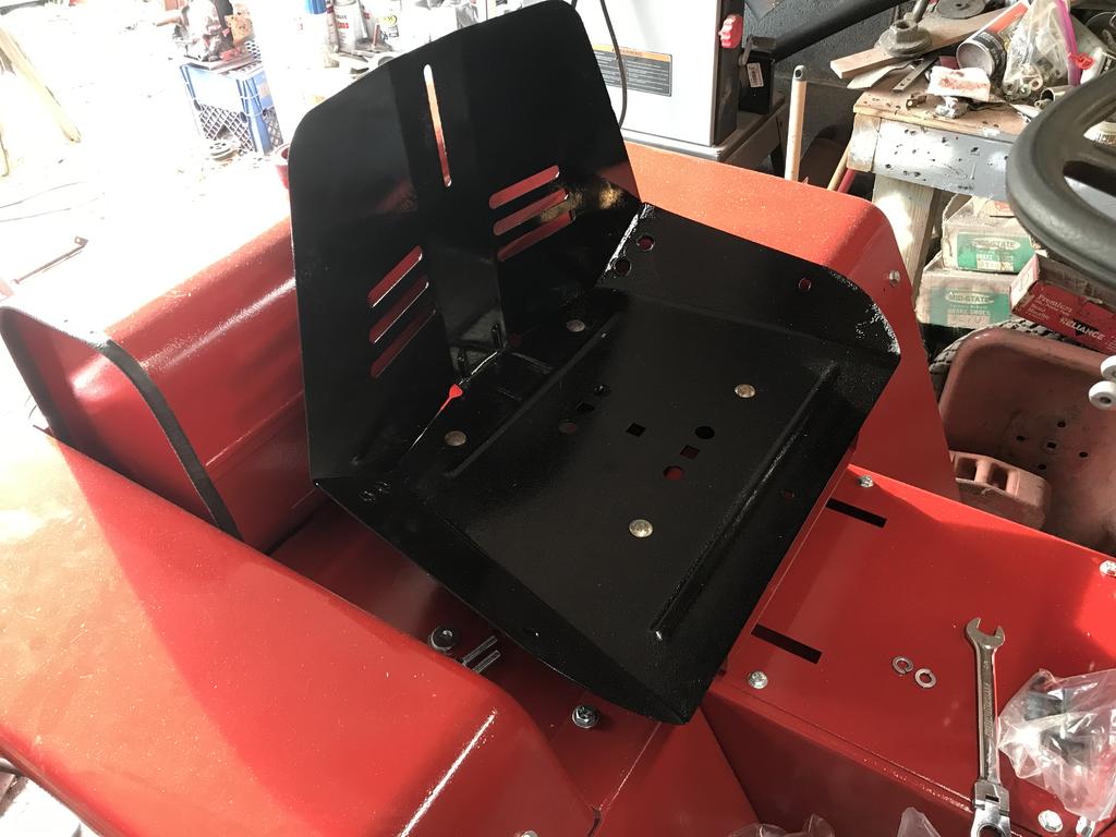

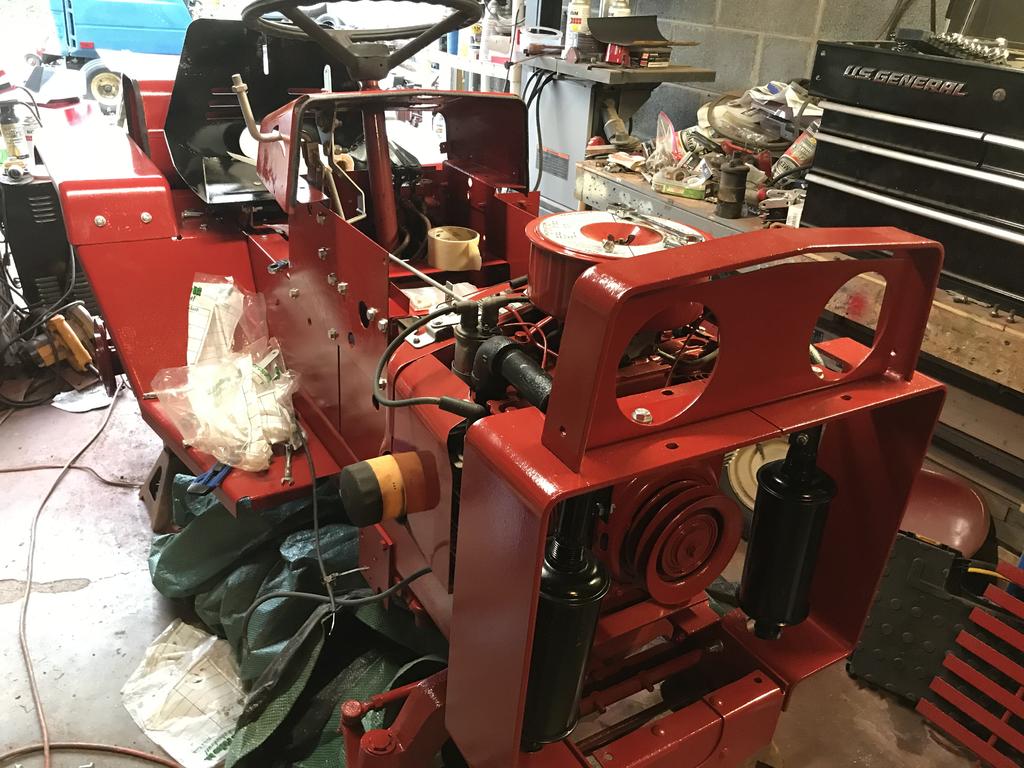

dells68 7,499 #88 Posted April 8, 2020 Been back at the ole D for a few days. I managed to get the new front tires mounted, rims painted, grille surround mounted, exhaust fabbed up (original 90 elbows, new Nelson mufflers, and electrical conduit - didn’t want to go to town with corona, so it got the weld it together as best I can treatment!), engine mounted, seat pan painted and mounted, control levers painted, and plastic dash repaired. I just hope it runs good once I get around to firing it up! 8 1 2 Share this post Link to post Share on other sites
19richie66 17,937 #89 Posted April 8, 2020 Looking good @dells68 1 Share this post Link to post Share on other sites
PeacemakerJack 11,080 #90 Posted April 8, 2020 You are making some great progress on Big Red! Keep at it—you’ll have it finished in no time👏🏻 1 Share this post Link to post Share on other sites

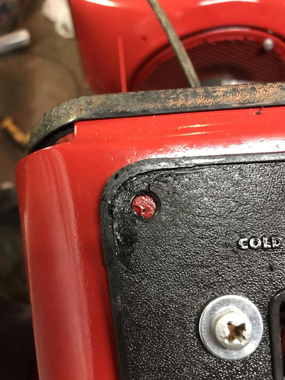

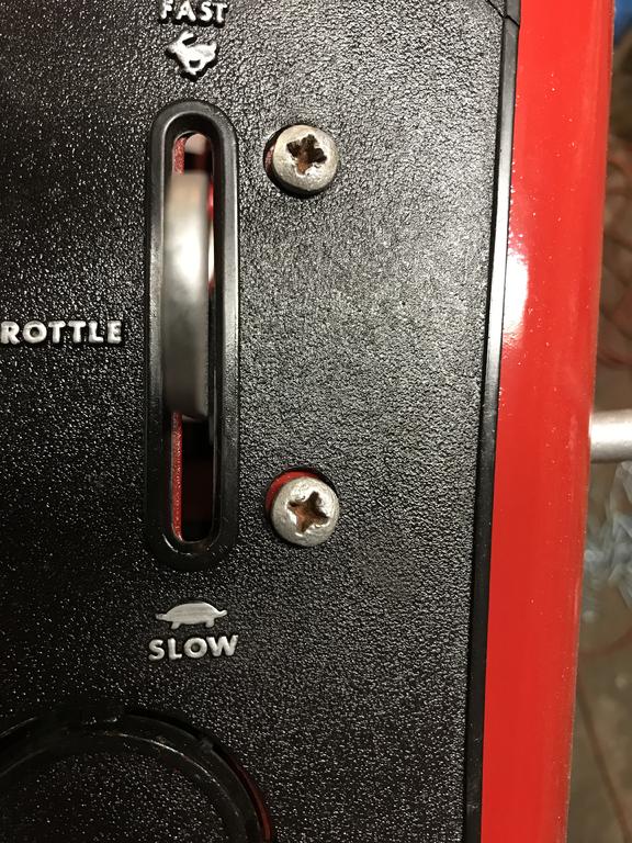

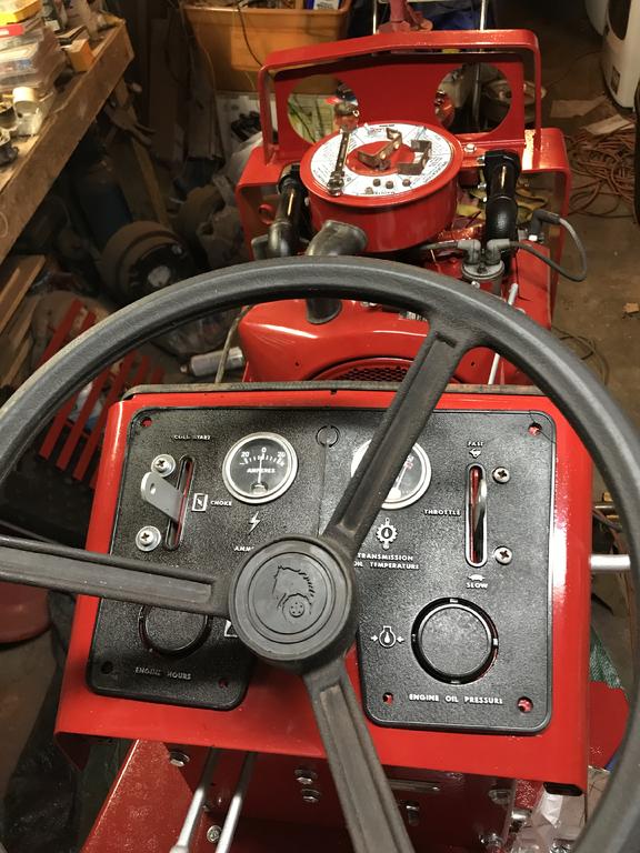

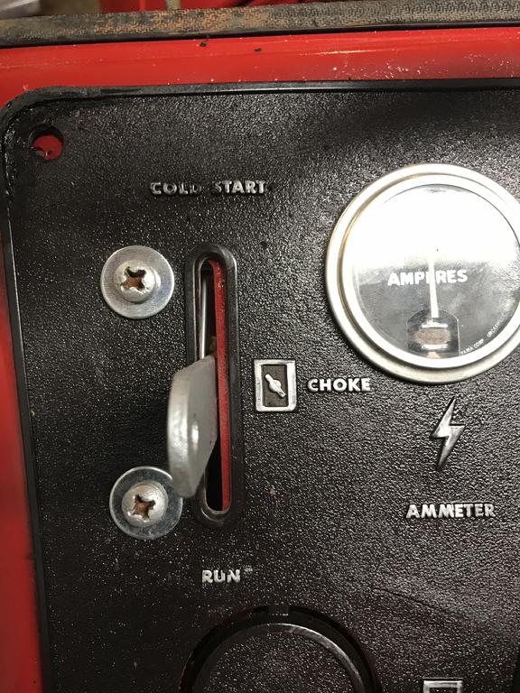

dells68 7,499 #91 Posted April 8, 2020 Been working on the dash today. I had to use zip ties to fix several cracks and even used them to make the top left corner that was completely missing. I used a wood burner tool with a flat tip to melt them. One thing I noticed was that non of the mounting holes lined back up once it was repaired. I had to open up the holes for it to fit. I then used washers on the mounting screws to cover where I had to open up the holes. My guess is that the plastic has shrunk since it was first put on causing the cracking and alignment problems. Looks pretty good for as well used it was in appearance! 2 7 Share this post Link to post Share on other sites
Pullstart 71,482 #92 Posted April 9, 2020 Great job Dell! Love those rear shoes! 1 Share this post Link to post Share on other sites
WHX?? 58,324 #93 Posted April 9, 2020 (edited) 10 minutes ago, pullstart said: Love those rear shoes! They are wicked looking. Don't know if would help you Dells but there is a thread in instructionals on restoing those dashes. Any thoughts on putting something in the oil pressure gauge or hour meter hole?? Edited April 9, 2020 by WHX24 1 Share this post Link to post Share on other sites
dells68 7,499 #94 Posted April 9, 2020 57 minutes ago, WHX24 said: They are wicked looking. Don't know if would help you Dells but there is a thread in instructionals on restoing those dashes. Any thoughts on putting something in the oil pressure gauge or hour meter hole?? Hey Jim. I had considered putting an hour meter in one of those, but don’t know what I would put in the other one. Also, I’m working on wiring right now and only have one wire that ran to the left side of the pressure gauge. There doesn’t appear to be anything coming from the transmission or hydro pump. It’s for the trans temp, so I assume there should be a sending unit somewhere. Anybody have any info where the sending unit should be on the hydro setup? Share this post Link to post Share on other sites

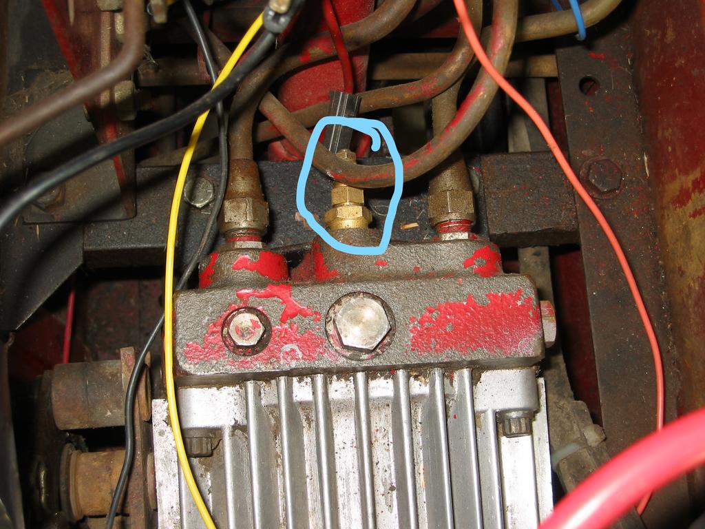

WHX?? 58,324 #95 Posted April 9, 2020 (edited) Check around the oil filter base and see if there is tap where the pressure gauge/sending unit would feed from. Usually a 1/8 npt and would have a plug in it. You would have to remove the plug and put in a 1/8 npt x 1/8 compression fitting to feed the gauge I have used 1/8 aluminum tubing to do this. Any automotive style oil press. gauge would work. Factory setup may have been an automotive style electrical sender type but I would just pipe one. You need an hr meter Dan @Achto or I may have some extras. Should see the tranny temp sensor mounted on the lower left side if this is an Eaton?? The D pros ….maybe @pfrederi will know for sure where it is. Edited April 9, 2020 by WHX24 1 Share this post Link to post Share on other sites
ohiofarmer 3,525 #96 Posted April 9, 2020 Like it all. Good to see Emory again! 1 Share this post Link to post Share on other sites
pfrederi 21,274 #97 Posted April 9, 2020 2 hours ago, dells68 said: Hey Jim. I had considered putting an hour meter in one of those, but don’t know what I would put in the other one. Also, I’m working on wiring right now and only have one wire that ran to the left side of the pressure gauge. There doesn’t appear to be anything coming from the transmission or hydro pump. It’s for the trans temp, so I assume there should be a sending unit somewhere. Anybody have any info where the sending unit should be on the hydro setup? Note i had to use an electric Unit. There is limited depth in that [port. The mechanical gauge I had the sending unit wouldn't fit. 1 Share this post Link to post Share on other sites
dells68 7,499 #98 Posted April 9, 2020 6 hours ago, pfrederi said: Note i had to use an electric Unit. There is limited depth in that [port. The mechanical gauge I had the sending unit wouldn't fit. Ok Paul, quick question. My wiring harness had a wire running to the gauge. Which side should a wire run from the sending unit to the gauge? Also, my gauge is pegged as high as it will go, so is it faulty or do they register like that when not powered? If faulty, what gauge could I get that would work with the sending unit? Share this post Link to post Share on other sites
pfrederi 21,274 #99 Posted April 10, 2020 If you have the original WH Gauge and sending unit. Power from I terminal of Ignition switch to the gauge Then to the sending unit which is actually a variable ground. Gauge should read zero when powered up not maxed out. You could have a Short some where causing it to peg or the sending unit could be toast. To test The sending unit Check for continuity to ground cold then heat it up see if resistance changes.. Sending units and guages have to be compatible. i just put in a sunpro gauge and sending unit. I had tried a couple used WH gauges but didn't get reliable reading. Can't remember now if I tested the sending unit or not. 1 Share this post Link to post Share on other sites
Pullstart 71,482 #100 Posted April 10, 2020 Dell I think the sending unit is a variable ground, if that makes sense. The other wire should be powered. 1 Share this post Link to post Share on other sites
