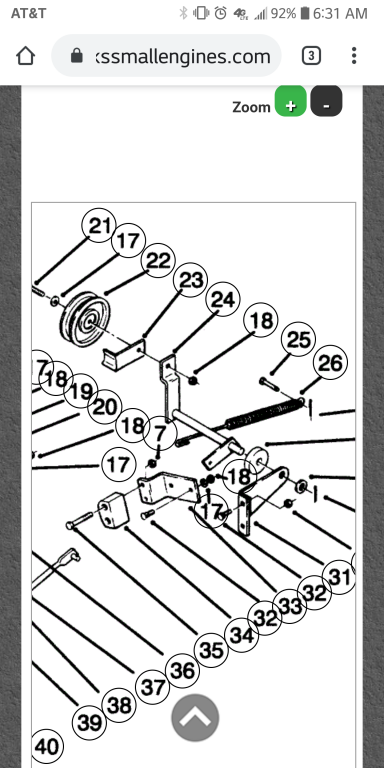

wallfish 20,510 #7 Posted January 8, 2020 6 hours ago, Denis L Goulet said: hi, thanks for replying, is there a video of this somewhere,i m looking down the location, should I see some sort of bracket holding the block in place should it be underneath the little sprocket or closer to the big sprocket The bracket which the tensioner bolts to is #33 in the illustration above. You need to remove the top cover and it should be visible It should be located under the sprockets. closer to the smaller one but really there isn't much space between the two sprockets. Post a picture of your blower looking down at the sprockets and maybe we can point it out or notice if it's missing Share this post Link to post Share on other sites

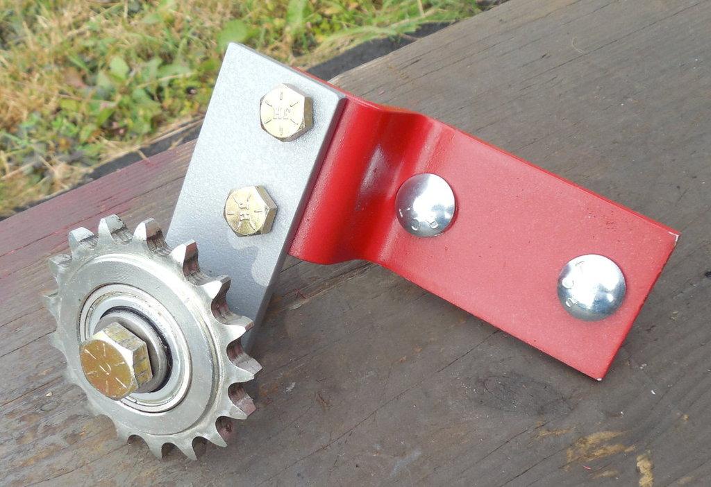

Kurt-NEPA 756 #14 Posted January 10, 2020 (edited) On 1/7/2020 at 7:57 PM, WVHillbilly520H said: @Kurt-NEPA @lynnmor do you have any pictures of the chain/sprockets and tension block? Sorry to be so late. Here is a picture of the sprocket I added to the tensioning bracket. Silver extension needed for the sprocket to clear the frame. I had to alter the chain lenth. Edited January 10, 2020 by Kurt-NEPA 2 Share this post Link to post Share on other sites
cleat 9,223 #15 Posted January 10, 2020 That looks awesome. Did you happen to document the dimensions of the silver bracket and also the sprocket. I will be doing that to mine some day. 1 Share this post Link to post Share on other sites
Kurt-NEPA 756 #16 Posted January 10, 2020 20 minutes ago, cleat said: That looks awesome. Did you happen to document the dimensions of the silver bracket and also the sprocket. I will be doing that to mine some day. I know I took some dimensions, but I can't find them. I don't remember them being critical. Perhaps another picture will help. I did make a shoulder bolt and spacer, but I don't think that is necessary. A bolt and some washers would work. 2 Share this post Link to post Share on other sites

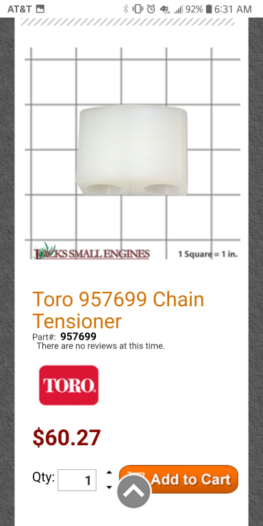

mechanic28 5 #17 Posted February 17, 2021 Denis, Resurrecting this thread as my chain just blew off when the wooden tensioner block split. I will be ordering both parts but I was wondering if you (or any other reader of this thread) had a top down picture of the final installation which shows the location of the tensioner as against the chain and sprockets on the Model 79361 Snowblower. Also any tips on spacing for the tensioner would be helpful. Any help appreciated as I almost finished cleaning up the latest big snow dump in Kettleby, Ontario before the chain snapped and now I have to get ready for the next one. Thanks. Share this post Link to post Share on other sites
mechanic28 5 #18 Posted February 17, 2021 Follow-up to my last post a little whole ago. The chain part #117447 appears to be discontinued - at least at Parts Tree and Jacks. Any suggestions on where to find a replacement? What is the length of the chain? Is there a chain size / type which I can use to try and source? Share this post Link to post Share on other sites
wallfish 20,510 #19 Posted February 18, 2021 #40 roller chain Count the links of the old chain to match that # with the new chain. They come in 10 ft lengths so you will need to shorten it https://www.surpluscenter.com/Power-Transmission/Roller-Chain-Links/Roller-Chain/?page_no=1&fq=ATR_PowerTransPitch:40&fq=ATR_Chain_Type:Standard The tensioner goes on the bottom of the chain loop just to take up slack. Once you remove the bracket to install the new one, you will see where it goes Share this post Link to post Share on other sites
peter lena 10,014 #20 Posted February 18, 2021 mechanic28, chain is probably #40 size , you can pick one up at tractor supply , also use a specific open chain / gear lubricant spray , to make it last . pete Share this post Link to post Share on other sites
mechanic28 5 #21 Posted February 18, 2021 Thank Wallfish and Peter for the chain size info. I placed an order for 10 ft and will place the order for the new plastic block itself tomorrow. However in the never ending saga of aging Toros, the bracket that holds the tension block (Part 117517) is also now discontinued and from my look inside the snowblower it would appear that the bracket holding the block fell out which led to the the chain tearing itself apart. I'll be going out in the morning to scour the snow drifts for the bracket but in the event it can't be found does anyone have the dimensions of the bracket so I can try and get one fabricated? Kurt-NEPA supplied some great photos of the red bracket in this thread but nothing indicating a scale so I can't quite reverse engineer from the photos. So close but yet so far. Any help would be most appreciated. Share this post Link to post Share on other sites

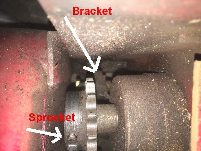

mechanic28 5 #22 Posted February 18, 2021 There is joy in Mudville. I located the missing bracket - it was buried underneath mud, snow and manure still attached to the frame. Now on to the repair. One last question. To access the bracket from above it looks like I need to remove the upper sprocket and I was wondering if there was any advice on re-attachment of the sprocket for alignment purposes (see photo). Thanks to all again. 1 Share this post Link to post Share on other sites
Kurt-NEPA 756 #23 Posted February 18, 2021 9 minutes ago, mechanic28 said: There is joy in Mudville. I located the missing bracket - it was buried underneath mud, snow and manure still attached to the frame. Now on to the repair. One last question. To access the bracket from above it looks like I need to remove the upper sprocket and I was wondering if there was any advice on re-attachment of the sprocket for alignment purposes (see photo). Thanks to all again. I'm trusting my 70 year old memory about the work I did about 7 years ago. To get the sprocket out of the way, I think you have to pull the gear box. The Sprocket will come out with it. But I seem to remember I could get at the bracket to get the carriage bolts in and to adjust the tension. It was a tight fit. You need that sprocket back in place to adjust the tension anyway. Good luck getting the bracket back on and getting it adjusted Share this post Link to post Share on other sites
