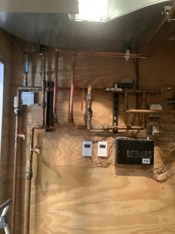

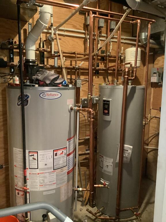

Pullstart 71,121 #55 Posted February 12, 2022 Not a plunge job, but lots going on in here. I wish I took a before picture. Their 50 gallon power vent wasn’t enough for a family of 6, even with wood boiler heat. The flat plate heat exchanger that was assisting the water heater was in a T loop from the main boiler loop, but no circ. pump sending hot water that way. In turn, it seemed to run constantly and never gain anything from being in the loop. Or, outside of the loop. The 3/4” piping in my system and others has done a great job. I used 3/4” and it’ll work out just fine. The side arms I built myself and all is well. No leaks there! I accidentally melted the mixing valve guts taking it apart so I’ll finish the job tomorrow before the big toilet bowl. 2 Share this post Link to post Share on other sites
Pullstart 71,121 #56 Posted February 12, 2022 I forgot to add, the 80 gallon electric is simply designed as a storage tank in the system. It just happened to be available. The 80 gallon power vent will be the main source of hot water in the summer. Winter boiler usage will warm both tanks and the storage will d7mp into the primary. The mixing valve is spanned between the storage tank’s inlet and the primary tank’s outlet. Share this post Link to post Share on other sites
squonk 47,901 #57 Posted February 12, 2022 (edited) Just curious Kevin, Why not a tankless for hot water with a small electric wh and recirc pump for the baths and let the wood boiler handle the heat? Edited February 12, 2022 by squonk Share this post Link to post Share on other sites
Pullstart 71,121 #58 Posted February 12, 2022 6 minutes ago, squonk said: Just curious Kevin, Why not a tankless for hot water with a small electric wh and recirc pump for the baths and let the wood boiler handle the heat? They have a pretty huge supply of wood. Lots of dead forest in their name. I’m not a huge tankless advocate, maybe being affiliated with one of the largest tank type water heater manufacturers (wife works there, I used to). You can get a Bradford White tankless, but I don’t know where they are made. These ones? Right down the street. Share this post Link to post Share on other sites
Pullstart 71,121 #59 Posted February 16, 2022 A job well done, is always customer’s final say. Water always takes the path of least resistance. I gave it one option. The in-floor loop has a selector valve to bypass when there is no call for heat. “I think this system is more efficient with how you did it. My house is 3 -5 degrees higher than all winter. If it holds it will be great. The floor is actually hot to the touch now.” Share this post Link to post Share on other sites

Pullstart 71,121 #62 Posted February 16, 2022 14 minutes ago, WHX?? said: Just happened to fall off the truck you mean and she got it out in her lunch bucket.... So funny Uncle Jim! We do pay for them, just less than wholesale is all. 14 minutes ago, WHX?? said: Sure glad I don't have to feed that 80 with propane & bet you don't either! 80 now, or 50 + a 30 fill up later I think his old setup was burning energy all over. His floors weren’t hot, barely warm, his water heater practically never shut off, and they have plenty of wood and manpower to haul it. For the sake of gas savings all winter, he will easily be able to afford it in the summer alone. He’s well over 1/4 mile off the road, likely won’t ever convert to natural gas. 14 minutes ago, WHX?? said: Way back when a buddy just had a 40 gallon trying to fill a mega gallon garden tub. I piped in another forty gas with just the pilot running to temper the water and that did the trick. Manufacturers really sell first hour delivery. A 40 gallon should be able to deliver we’ll say 75-80 gallons of hot water in an hour. That’s from satisfied t-stat, to a draw until the t-stat turns on, to another draw when it satisfies, repeat until about 50-55 minutes goes, then draw full until 60 minutes is up or it runs out of temp I think. That doesn’t mean a 40 gallon tank can fill up a 90 gallon tub in one happy draw while the Mrs. is grabbing her wine. When room allows, having that buffer pre-tank really helps. same thing we have going here… The one on the right.. I built that one myself in 2006 or so. 1 Share this post Link to post Share on other sites

WHX?? 57,821 #65 Posted February 16, 2022 3 hours ago, Pullstart said: That’s from satisfied t-stat, to a draw until the t-stat turns on, t That's what I like about mine. I barely get gallon maybe 1 1/2 and the stat is turning her on. That why the old one was a POS ... it let too much cold in before kicking on cooling the tank down too much and then condensation then rust. It did it no matter the satisfied setting. Whatever gas valve BW is using don't let them change! 1 Share this post Link to post Share on other sites

Pullstart 71,121 #67 Posted February 16, 2022 4 hours ago, squonk said: Hang a tankless on the wall and you got room to store a couple of tractors! Just sayin! And lose the ability for alternative heat, like the wood boiler, solar if ever I chose, etc. plus in a residential application, upgrade gas pipe sizing or pressures, require proprietary venting in many applications… etc. Share this post Link to post Share on other sites
squonk 47,901 #68 Posted February 16, 2022 Keep the wood boiler for heat. Tankless for endless hot water for bathing/laundry. And they aren't any more complicated than a hot water condensing boiler. Just a small package. I've worked on Lochinvar, Fulton and Aerco condensing boilers and Rinnai, A.O.Smith, and Navien tankless. Not much difference. Share this post Link to post Share on other sites

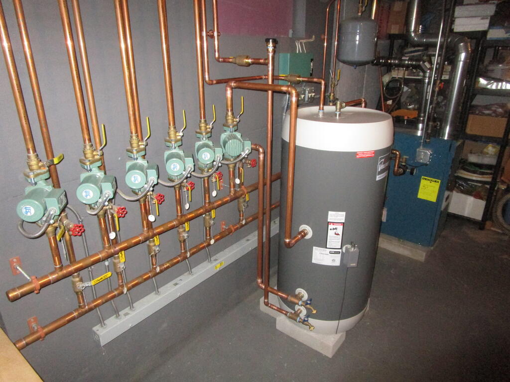

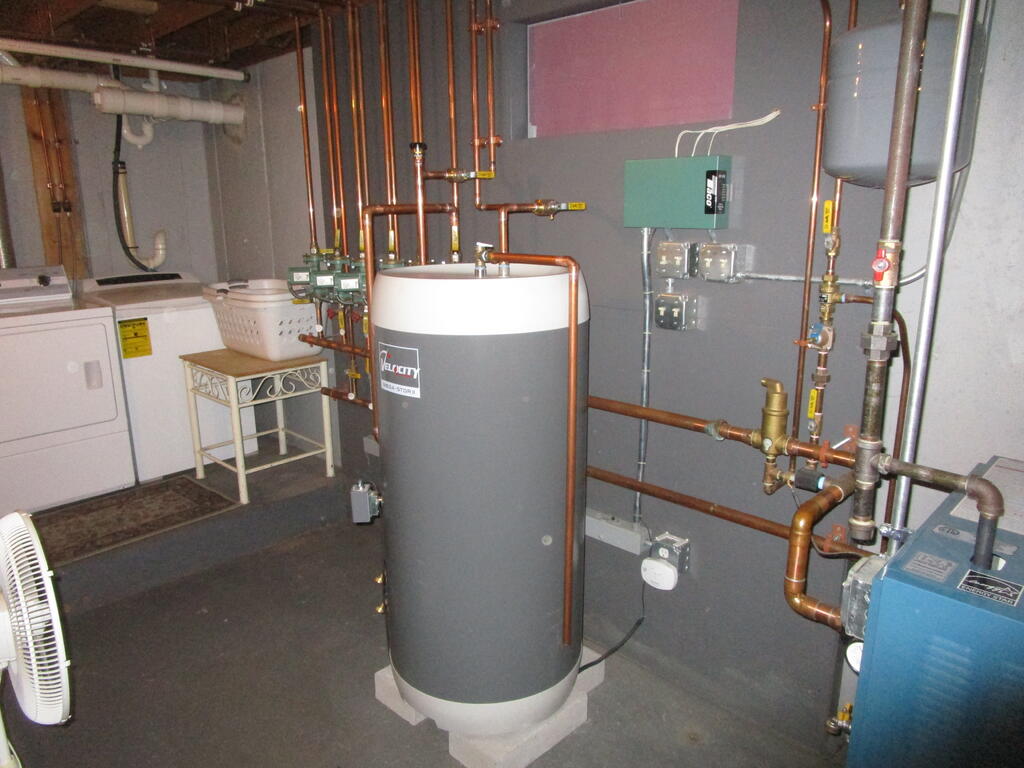

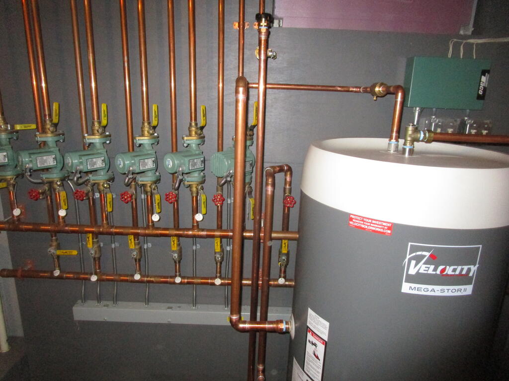

JCM 11,400 #69 Posted March 12, 2022 This is a follow up of page # 1 post #19 on installing the indirect water heater and taking the electric water heater off line.This past January the electric rates went up and added 40 to 50 dollars to the monthly bill. We have been using the electric heater since 2010 and it was time to replace before an issue with that. Enjoying a lot more hot water now than we ever had and not have to wait for recovery at times. This replacement was long overdue and I am sure some of you tradesmen will agree, our homes are the last to do. I find after all your customers are satisfied I just don't feel like doing this on a weekend. It's tractor time. 2 Share this post Link to post Share on other sites
