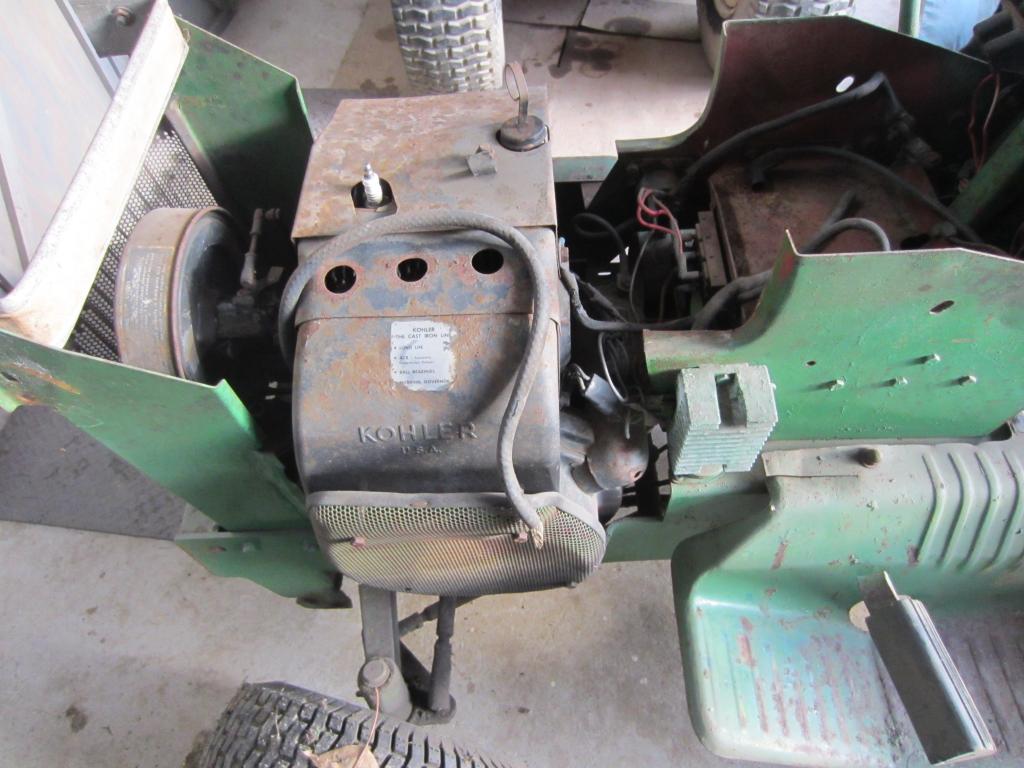

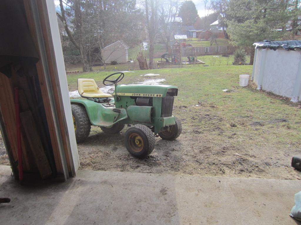

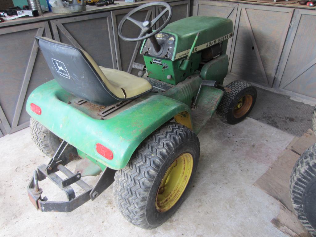

Herder 2,356 #1 Posted January 1, 2020 So in the process of building one of these transmission dollies this old girl showed up and snuck her way into the shop. Well that's not really how it happened. Don't worry it's not mine, a friend picked this up and it's sat for years. Cant turn my nose up at chance to make a buck or two. Boy it is GREEN!! Started with the top end. Removed the head and de-carboned everything, oiled the valves and cylinder. No slack in the piston and one of the cleanest engines I see. The carburetor is tomorrows project. 5 1 Share this post Link to post Share on other sites

T-Mo-(Moderator) 4,905 #12 Posted January 2, 2020 Deere never put in a Briggs in a 110, so either it was a 111 or a LA110. All of the 110s had in them were either a 8 hp Kohler or a 10 hp Kohler. The 112 is basically a 110 with a larger engine in it. It originally came with a 10 hp Tecumseh, but later Deere offered them with a Kohler starting in 1969 with the 10 hp Kohler K-241, and then in 1972 all 112s came with a 12 hp K-301 in them. The square fender 110/112 were built from 1968 to 1974. That one has the integral hitch, which is Deere's term for a sleeve hitch. I don't see the manual lift lever, so that one may be an electric lift. I don't think it's an hydraulic lift tractor as I don't see the pump. 1 Share this post Link to post Share on other sites

Herder 2,356 #21 Posted January 4, 2020 5 hours ago, T-Mo said: There should be a pto safety switch also. Here is a diagram from the service manual that might help: late sf electrical.tiffUnavailable Thank you T. Dam Deere's owner dropped off the service manual for it today. It's what I needed for sure. A lot of the electrical components are in poor condition form sitting outside. I found that the rectifier has a burnt connection and was thinking that could be contributing to the problem. The electrical is a pain to get too. Everything is under the fuel tank and battery tray or hidden behind a shield. I will NOT be buying a Deere anytime soon!!! They are not built like a Wheel Horse. 2 Share this post Link to post Share on other sites
