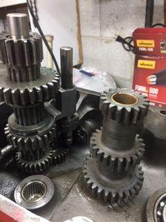

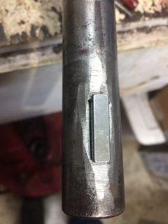

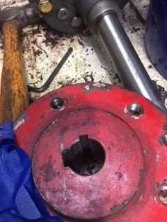

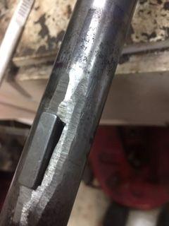

Lagersolut 802 #76 Posted January 13, 2020 Made a little headway today . Thanks to @The Tool Crib he had the 2nd and cluster gear for this project @WHX24 cut nice new key ways in the hubs and A to Z tractors in the vendor section had a nice fresh used axle . I'm gonna run with the one axle as you can see in the pics it's only slightly damaged on one side. Was going to grind a 5/16 key down and custom fit it, instead it's going on the right side of the tractor so the good side is in the forward gears . key doesn't wobble and there's no play thinking it will be fine . If it acts up I'll try the 5/16 key route . Watched @stevasaurus video on these 4 pinions and realized thrust washer on bull gear was missing when I tore it down . Not a major problem just a delay order it tomorrow ... 3 Share this post Link to post Share on other sites

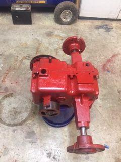

Lagersolut 802 #78 Posted January 26, 2020 All wrapped up on the trans - missing thrust washer was on back order took awhile to get here . Another one saved thank you everyone for the parts and help to get this done . 1 Share this post Link to post Share on other sites
