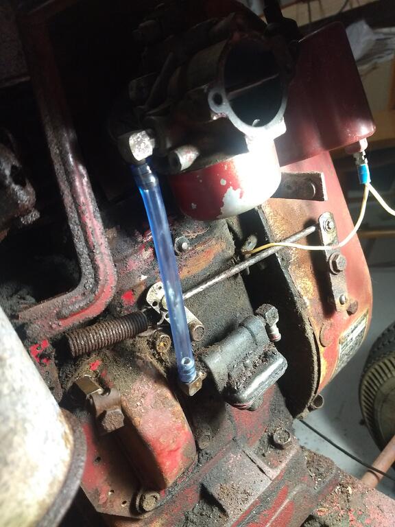

71_Bronco 1,072 #126 Posted June 23, 2020 9 hours ago, ebinmaine said: Got that all put back on along with the fuel line from pump to carb. What are you using for fuel line? Is that the blue-colored tubing from Tractor Supply? Or the Stens True-Blue fuel tubing? Thanks Share this post Link to post Share on other sites
ebinmaine 80,166 #127 Posted June 23, 2020 (edited) On 6/23/2020 at 6:54 AM, 71_Bronco said: Stens True-Blue I bought this particular roll from Lincoln at A to Z tractor but I'm sure there's multiple places where you can get it. We don't use ethanol in any of our machines but I've repaired a tractor or two for people that still do. This stuff is more ethanol resistant than rubber. Also, I like the fact that I can see through it for diagnostic reasons. Or, if I'm just being a dingbat and did not put fuel in the tractor. Not that that has ever happened before. Edited June 28, 2020 by ebinmaine Correct autocorrect 2 1 Share this post Link to post Share on other sites

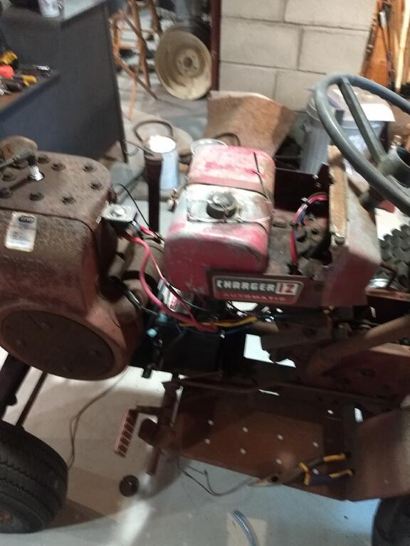

ebinmaine 80,166 #128 Posted July 4, 2020 Electrical finished. Battery installed. 4 Share this post Link to post Share on other sites
ebinmaine 80,166 #129 Posted July 5, 2020 IT'S ALIVE !!!!! 8 2 1 Share this post Link to post Share on other sites

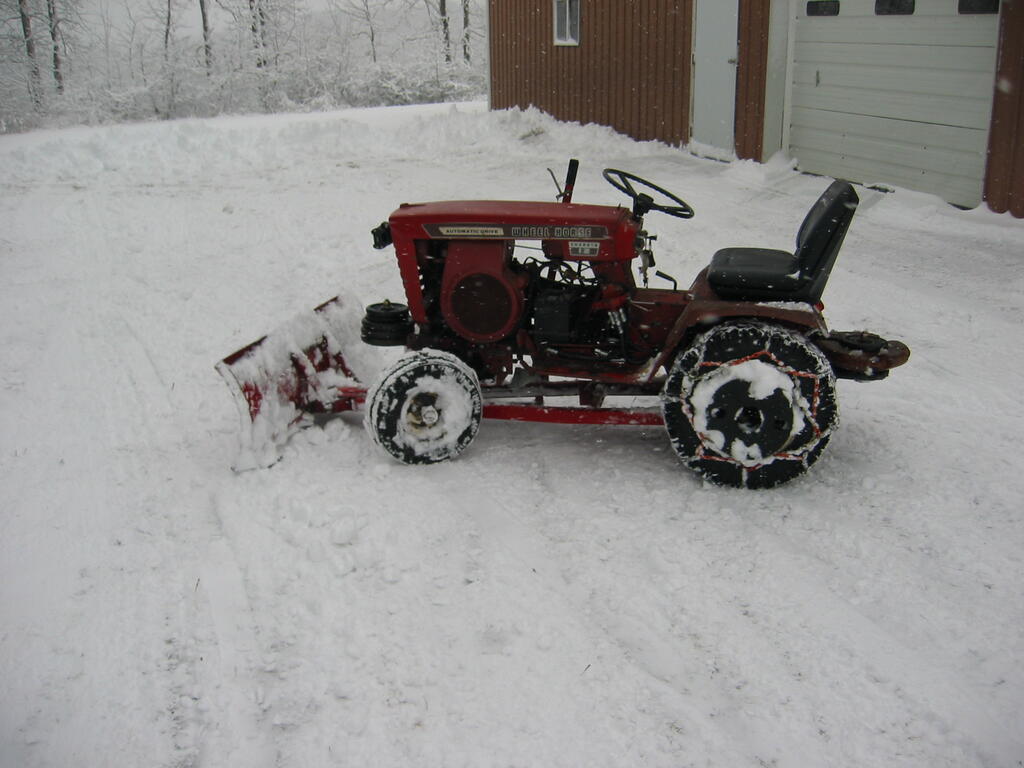

pfrederi 21,008 #136 Posted July 26, 2020 Get her some serious weights and chains on narrow tires and you will be amazed how much and how fast she will move snow. 1 Share this post Link to post Share on other sites
ebinmaine 80,166 #137 Posted July 26, 2020 2 minutes ago, pfrederi said: Get her some serious weights and chains on narrow tires and you will be amazed how much and how fast she will move snow. Which reminds me... What do you use for front tires? Share this post Link to post Share on other sites
pfrederi 21,008 #138 Posted July 26, 2020 Just now, ebinmaine said: Which reminds me... What do you use for front tires? Just what you have on there now with roller chain. Also some front weight. 1 Share this post Link to post Share on other sites

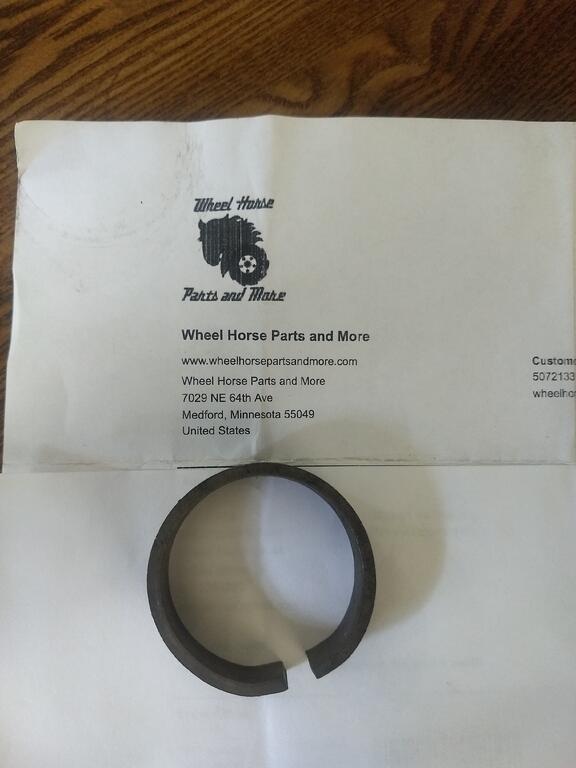

ebinmaine 80,166 #146 Posted August 28, 2020 Hoping to get a little workshop time this coming weekend. Supposed to rain all day Saturday. I've got most of the parts I need for the transmission. Got this from our friends Lowell and Joette. 1 Share this post Link to post Share on other sites
71_Bronco 1,072 #147 Posted August 28, 2020 1 hour ago, ebinmaine said: Hoping to get a little workshop time this coming weekend. Supposed to rain all day Saturday. I've got most of the parts I need for the transmission. Got this from our friends Lowell and Joette. I've got one of those in my 5060 transmission that I swapped into my Commando. Looks good so far, though that steel pan doesnt look very comfy 1 Share this post Link to post Share on other sites

Pullstart 71,029 #150 Posted August 31, 2020 On 8/28/2020 at 1:52 PM, ebinmaine said: Hoping to get a little workshop time this coming weekend. Supposed to rain all day Saturday. I've got most of the parts I need for the transmission. Got this from our friends Lowell and Joette. That LSD ring looks heavier than the one in @stevasaurus’ video. Is it my imagination or did they make it heavier? Share this post Link to post Share on other sites
