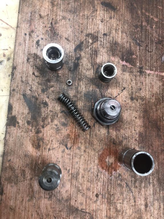

The Tuul Crib 7,354 #107 Posted January 25, 2020 Damn that breakfast looks good ! Something about free range chicken eggs mmmmm!! But hey about the charger trans today l took out the Excelerator valves and got a surprise on the forward motion valve. Needs to be replaced! 2 Share this post Link to post Share on other sites

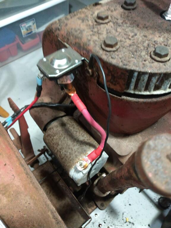

ebinmaine 80,166 #112 Posted February 16, 2020 On 1/20/2020 at 10:08 AM, formariz said: While you have the tractor apart, pay special attention to the connections at the voltage regulator. It is in a difficult spot to work on, and if those connections come loose and create a short, you will fry the stator on it. That is really hard to find and expensive. I would go as far as placing it in a more accessible location so it could be regularly inspected. I did as above today and some other things. The regulator on the tractor was badly corroded so I hucked it in the trash. I have a regulator from a 77 C-160 on there now and I moved it... To the exact outside of where it was. I added a ground wire for the VR. I found that the 2 AC wires were corroded and the insulation was completely off in one spot. Cut that all apart and rewired them. The ends of the VR/ignition switch wire were no better so that got the same treatment. Checked the kill/ground wire. It has a small spot near the ignition switch end that will be heat shrink wrapped. Trina took the plastic cover off of a C series dash and polished up the bare metal. I installed the key switch and throttle cable. Not happy with the throttle cable so I'll either rebendify it or swap out for a new one. Next will be to find a spot for the starter solenoid then finish wiring. 3 2 Share this post Link to post Share on other sites

ebinmaine 80,166 #115 Posted February 17, 2020 3 hours ago, AHS said: Does that not have a starter solenoid? My 70 Raider 12 didn’t, and I had to make one work! @ebinmaine Nope. Same basic tractor. The original ignition switch was a (70?) Amp rated one that put ALL the battery current through it. I'm not a huge fan of that unless it's an S/G tractor because they sound so unique. I've installed a universal 3 terminal solenoid to the side of the engine. Also changing to the newer style ignition switch. 1 Share this post Link to post Share on other sites
ebinmaine 80,166 #116 Posted February 17, 2020 Popped a couple more wires in place. Ran an auxiliary ground wire from solenoid base. I decided to use the dash plate Trina cleaned up in Colossus so she cleaned up a different one. The "new" one has the proper push/pull cable setup. 3 Share this post Link to post Share on other sites

ebinmaine 80,166 #122 Posted June 21, 2020 Made up the other 2 battery cables and put them in. Next will be to get a fuel tank and lines in. Then drag it out and fire it. We hope. Share this post Link to post Share on other sites

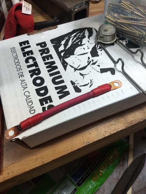

ebinmaine 80,166 #125 Posted June 23, 2020 Little bit more done tonight. Having set for so long the throttle linkage was frozen right up tight. Wouldn't move at all. I removed all of the throttle linkage and wire brushed it. Put it back on. Works like a charm. Note in the picture that the PO used washers and braised them onto the steel linkage to tighten up the slop in the holes. @JCM .... More plumbing technique? Got that all put back on along with the fuel line from pump to carb. Here's a pic of the battery cables I made up. I have a universal throttle cable that I had ordered for something else and it's way too long. Can anybody give me a rough length? I did find that the muffler is going to have to be relocated just slightly. The old throttle cable was metal. This one has a rubber casing. In its current position the throttle cable contacts the muffler. There is no 45 degree elbow in the exhaust like there should be. Maybe I'll put one in there and flip the muffler up. 1 Share this post Link to post Share on other sites
