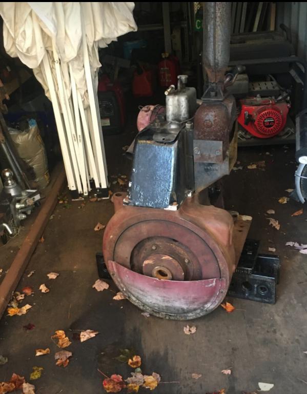

Sean 6 #1 Posted December 14, 2019 I am thinking about putting a large marine Saab Diesel engine into my wheel horse 314-8. Will the frame be able to handle around 450 pounds of engine? I am asking as I have never seen it done due to the scarcity of the engine. 2 Share this post Link to post Share on other sites

Sean 6 #4 Posted December 14, 2019 (edited) It’s a big motor the flywheel alone weighs 200 and it’s running 83 foot pounds of torque Edited December 14, 2019 by Sean Share this post Link to post Share on other sites

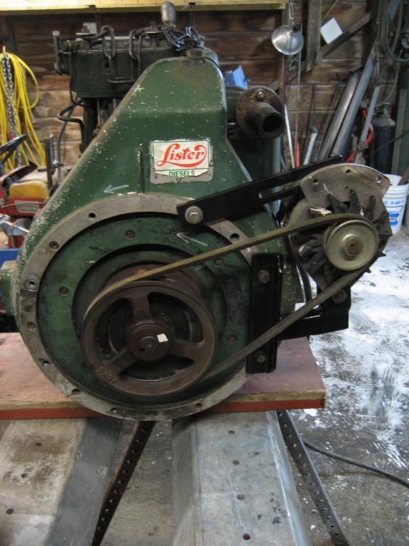

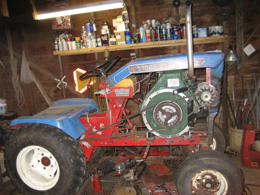

Cvans 1,009 #18 Posted December 22, 2019 (edited) Having installed a Lister-Petter LT1A in several WH tractors without any frame reinforcement I'd say your going to be fine. The LT1A is a heavy single cylinder air cooled and with the electric starter should be right in the 200 lb range. The last install was in a 12hp Charger Auto. Ran this combination for a number of years and am now in the middle of installing it in a C-160 8spd. Here is a photo of it in the Charger along with a photo of the engine. Edited December 22, 2019 by Cvans 1 2 1 Share this post Link to post Share on other sites
Sean 6 #19 Posted December 22, 2019 That’s pretty awesome what kind of torque is that old lister running? Share this post Link to post Share on other sites
Cvans 1,009 #20 Posted December 22, 2019 The first WH I had it in was a ranger 10hp 8 spd. if I remember correctly. You couldn't stop it. In high range second gear it would dig a hole. It literally gutted the transmission. Then after installing it in a hydro it wouldn't do that but the hydro did an excellent job of absorbing the power impulses and the hydraulic lift was wonderful for raising implements. The problem came when it was cold outside the thick oil (ATF) sucked up a lot of power. I use this for yard and garden work and the manual transmission is a better combination so that's where I'm headed again. This time hopefully with a heavier gearbox and a little more common sense as to what I hook it up to. Share this post Link to post Share on other sites

Sean 6 #24 Posted December 22, 2019 I am working on re timing it as one of the valves was opening at the wrong time. Once that is done the reinforcement of the frame will be started and then it’s down to mounting on the frame. 2 1 Share this post Link to post Share on other sites
