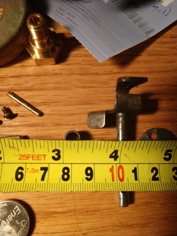

seven 202 #1 Posted December 14, 2019 Where can I purchase a new bushing for a k181 hardware store I'm pretty sure but not sure what size ? Share this post Link to post Share on other sites

The Tuul Crib 7,340 #3 Posted December 14, 2019 Do you have a part number or possibly a picture of the old one I have lots of bushings in my parts bin . Share this post Link to post Share on other sites
JCM 10,415 #4 Posted December 14, 2019 I can tell you a OEM Kohler for a K-341 Part # 2515802-5 bushing is NLA , not sure about the K181. 1 Share this post Link to post Share on other sites
oliver2-44 11,076 #5 Posted December 14, 2019 (edited) The kohler 12,14,16HP carbs use Hillman #58087 1/4" id x 7/16" od x 1/16" thick.I stack 2 of them to get the 1/8" thickness. I get them at the Ace Hardware store that has all the grey or yellow specialty parts I'. not sure about the K181 carb. take your carb and shaft to the hardware store and see what fits. PS if you have one take a dial or electronic caliper with you. As JCM noted the Kohler bushing is NLA, but can sometimes be found on ebay. Edited December 14, 2019 by oliver2-44 4 Share this post Link to post Share on other sites
seven 202 #6 Posted December 14, 2019 Ok.thxs it's roughly 5/16 od and 1/4 Id I will look at hardware store and see if they have em Share this post Link to post Share on other sites
seven 202 #9 Posted December 14, 2019 It's actually 3/16 id Share this post Link to post Share on other sites
