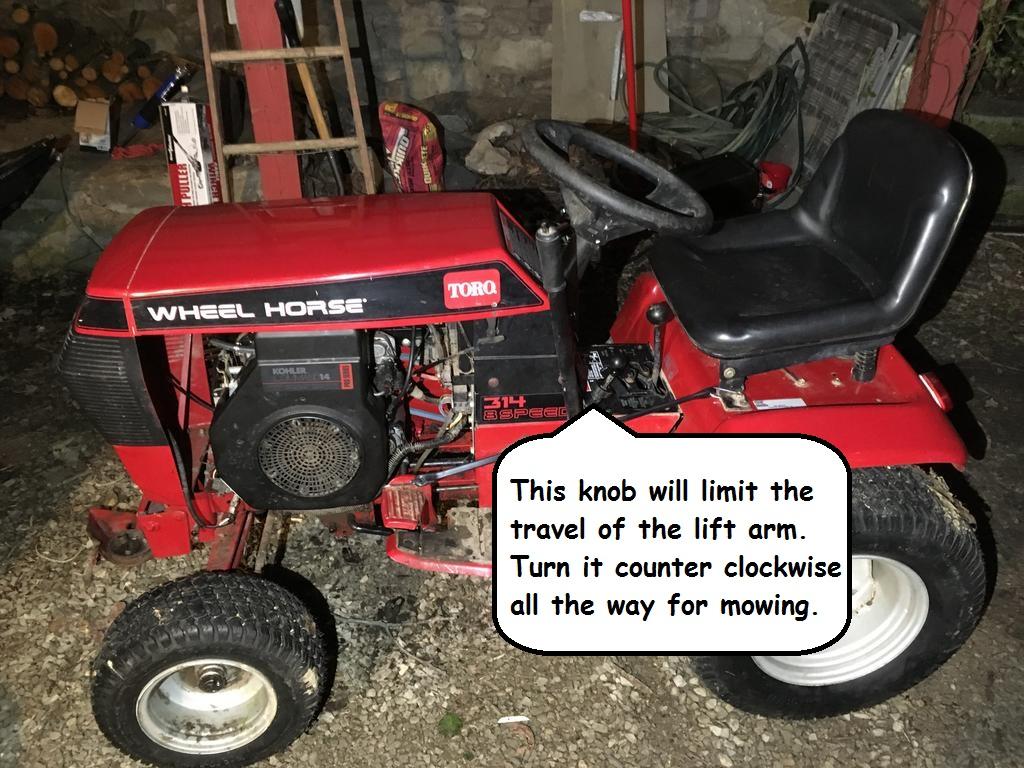

Lee1977 7,750 #9 Posted December 8, 2019 2 hours ago, rjg854 said: on the left side of the tractor is the implement lift handle, I use the adjusting knob to keep my blade an inch or so above the stone on my driveway, so I don't dig into the stone itself. I try to leave the stone in the driveway. I'm not sure if there are other ways to keep the blade from dragging on the ground, it's just the way I do it, and it seems to work well enough. The height adjustment on 310s and 312s was an option most don't have them. You may post in the wanted section as some one may have one to sale off a parts tractor. Share this post Link to post Share on other sites
953 nut 68,520 #10 Posted December 8, 2019 Here is a picture of the height adjustment knob. In my opinion $ 700 without a mowing deck is a bit high unless it is in exceptional condition. The mid mount grader blade is much better for leveling gravel if you can find one. Share this post Link to post Share on other sites
