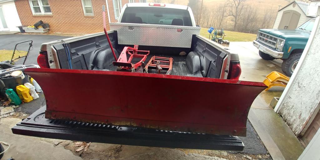

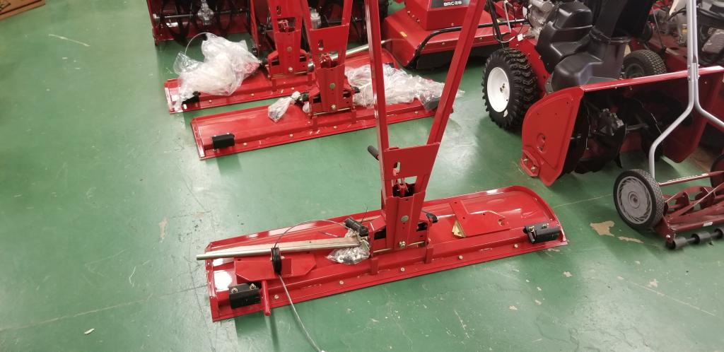

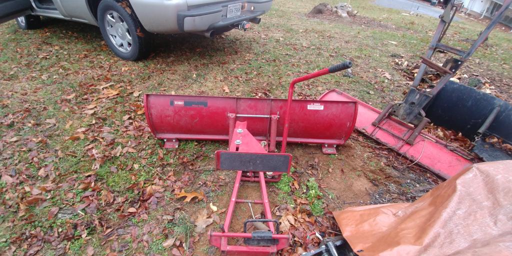

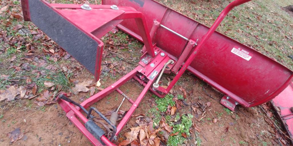

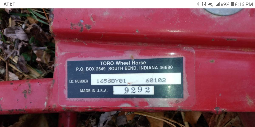

WVHillbilly520H 10,378 #1 Posted December 8, 2019 @gwest_ca Gary could you help me I.D. this blade and what it may have fit? Thanks in advance, Jeff. 1 Share this post Link to post Share on other sites

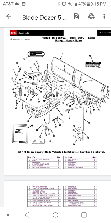

gwest_ca-(File Mod) 12,321 #2 Posted December 8, 2019 1990 dozer blade that fits the 600-Series of zero-turn mowers. Models 612-Z, 616-Z and 620-Z. Found an operator manual. Will get it posted. Garry 1 Share this post Link to post Share on other sites
WVHillbilly520H 10,378 #3 Posted December 8, 2019 21 minutes ago, gwest_ca said: 1990 dozer blade that fits the 600-Series of zero-turn mowers. Models 612-Z, 616-Z and 620-Z. Found an operator manual. Will get it posted. Garry Thank you sir... I may get it and use the moldboard for my 520 . Share this post Link to post Share on other sites
gwest_ca-(File Mod) 12,321 #4 Posted December 8, 2019 Garry 1 1 Share this post Link to post Share on other sites
c-series don 12,045 #5 Posted December 8, 2019 That moldboard looks like it will fit any standard a frame. Knock out the trip pin and the top spring pin and you could swap it right out. 2 Share this post Link to post Share on other sites

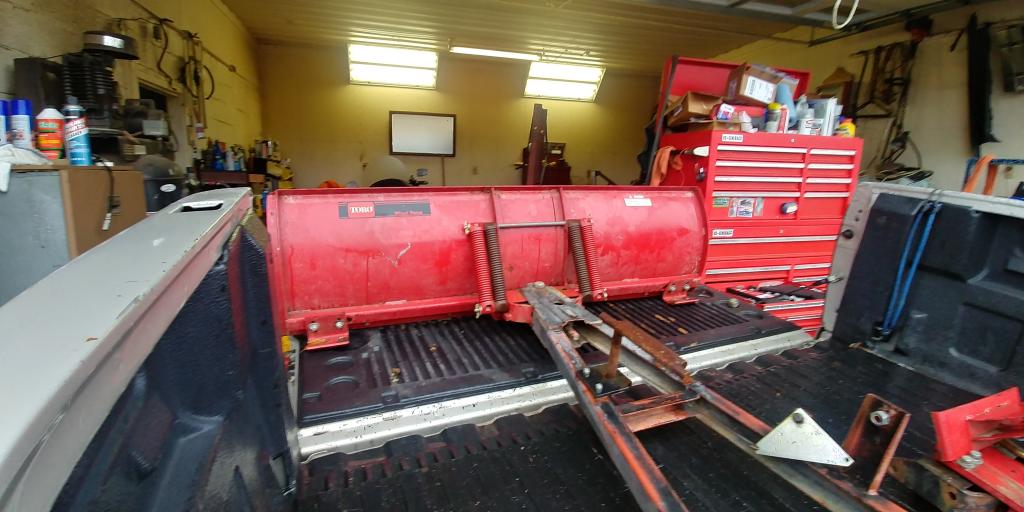

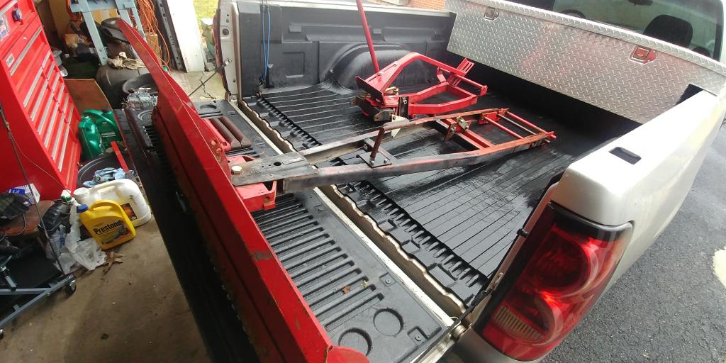

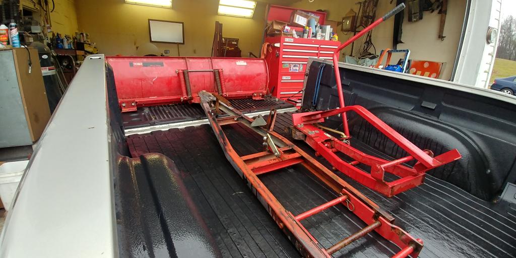

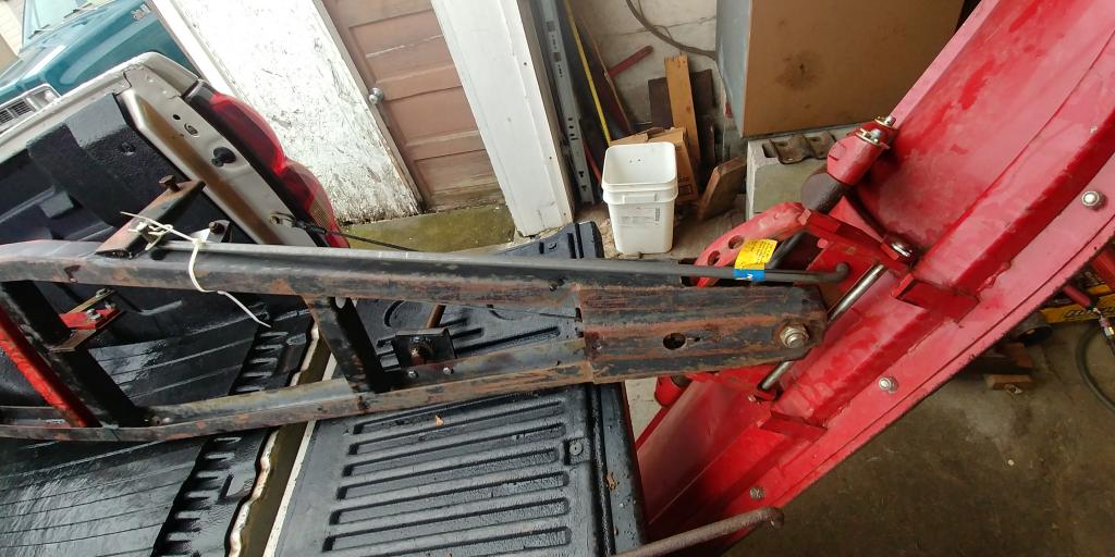

WVHillbilly520H 10,378 #6 Posted December 10, 2019 I just got back from purchasing this snow/dozer blade, basically in like new condition, I will be removing moldboard and putting it on my 520s blade frame, tossing the idea around of using this frame to convert into a mid grader. I'll post pics tomorrow. 2 1 Share this post Link to post Share on other sites
ebinmaine 79,503 #7 Posted December 10, 2019 1 hour ago, WVHillbilly520H said: tossing the idea around of using this frame to convert into a mid grader Nice idea 1 1 Share this post Link to post Share on other sites
WVHillbilly520H 10,378 #8 Posted December 10, 2019 52 minutes ago, ebinmaine said: Nice idea Check out this ipl... I think it's very doable 2 Share this post Link to post Share on other sites
Lee1977 7,685 #9 Posted December 10, 2019 (edited) 14 hours ago, WVHillbilly520H said: I just got back from purchasing this snow/dozer blade, basically in like new condition, I will be removing moldboard and putting it on my 520s blade frame, tossing the idea around of using this frame to convert into a mid grader. I'll post pics tomorrow. Shorten up the back to the right length and intall a good grader blade. You might want to try a 60" grader blade. You could always cut it down later If needed. Take a side grinder and grind off the surface all the way around then they can by sawn off. Mine is the other style but I made it 48" wide. The weight of a 1/2" thick grader blade don't hirt either. Edited December 10, 2019 by Lee1977 1 1 Share this post Link to post Share on other sites

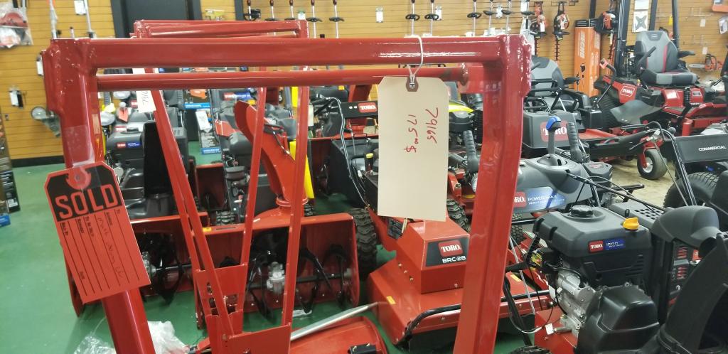

gt14rider 1,223 #10 Posted December 10, 2019 This was at a Toro dealer last about a month ago, one was sold, to others available. Fits a zero turn, 1 Share this post Link to post Share on other sites

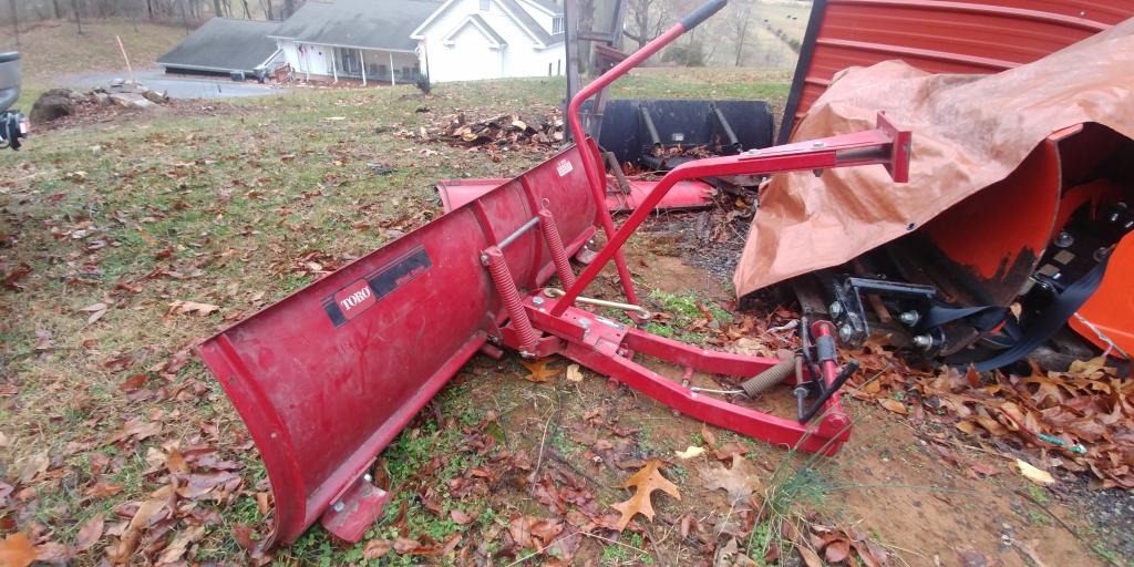

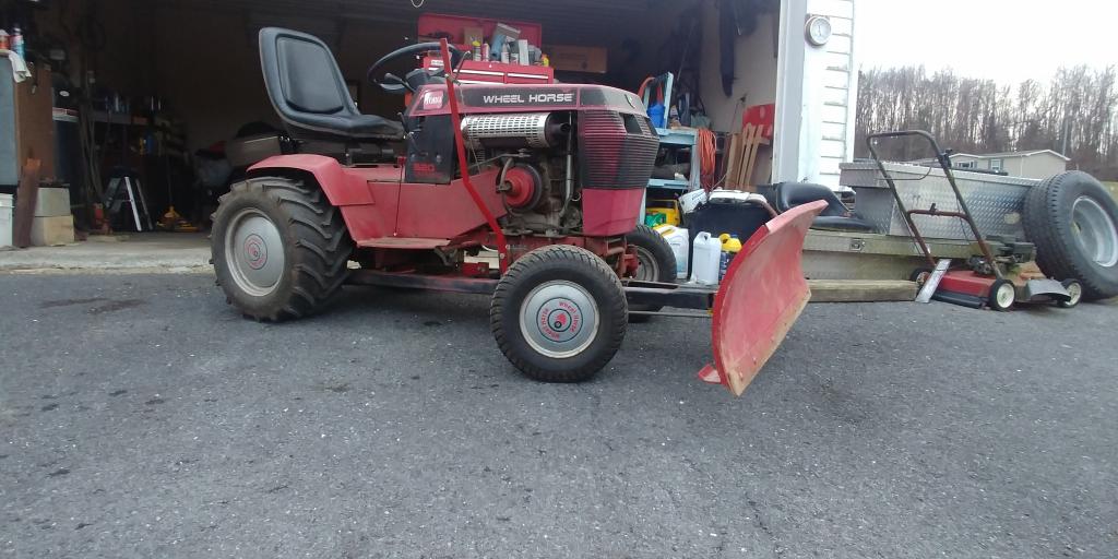

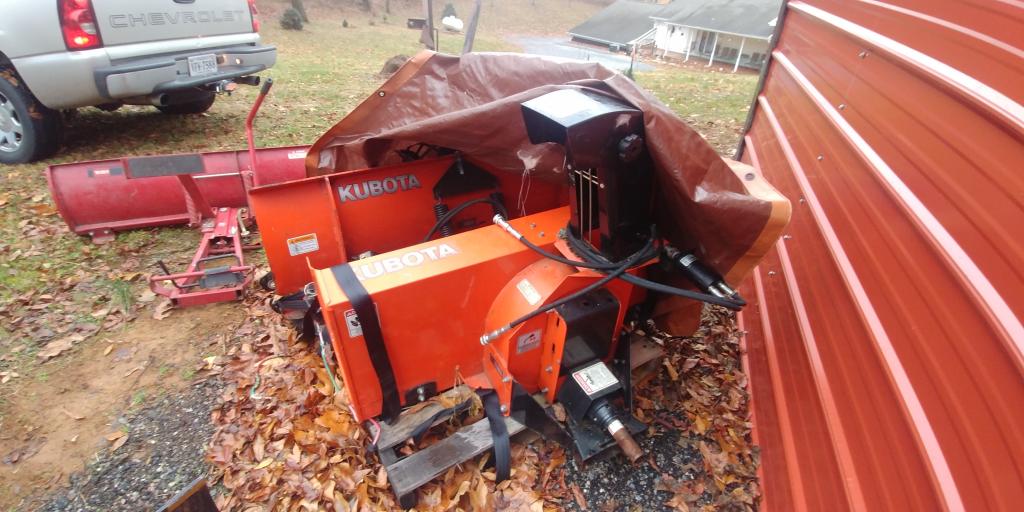

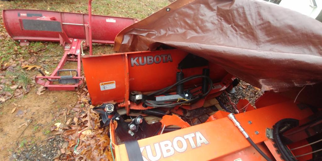

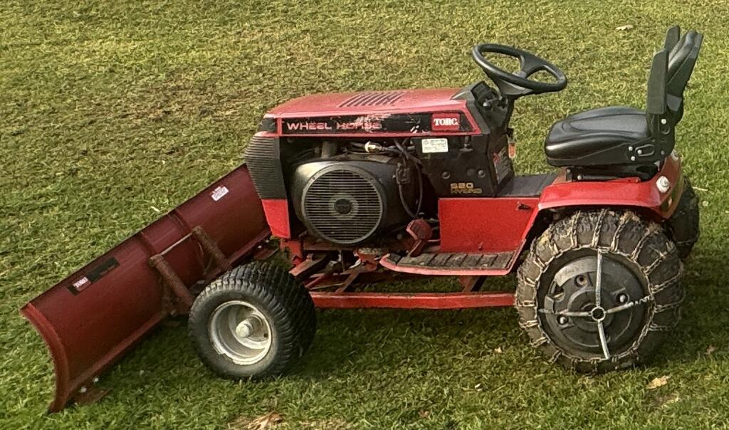

WVHillbilly520H 10,378 #12 Posted December 11, 2019 As promised for your viewing pleasure...1st pic you can see my 54" WH plow the Power King blade and my rear 3pt for the eMax... I know I'm snow plow poor... Then the orange implements for the eMax when I get around to fitting them Share this post Link to post Share on other sites
ebinmaine 79,503 #13 Posted December 11, 2019 1 hour ago, WVHillbilly520H said: snow plow poor Really?????? Run upta Maine. I've got a exxtrey one I'll give ya so's you can get by. It's ugly as a stump fence but it'll be fine. 1 Share this post Link to post Share on other sites

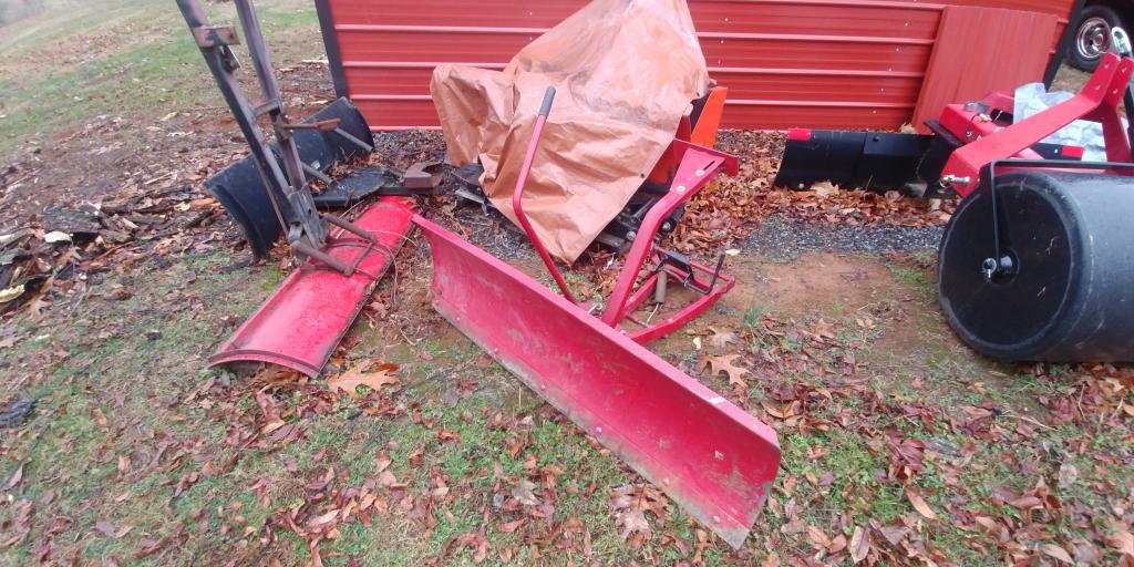

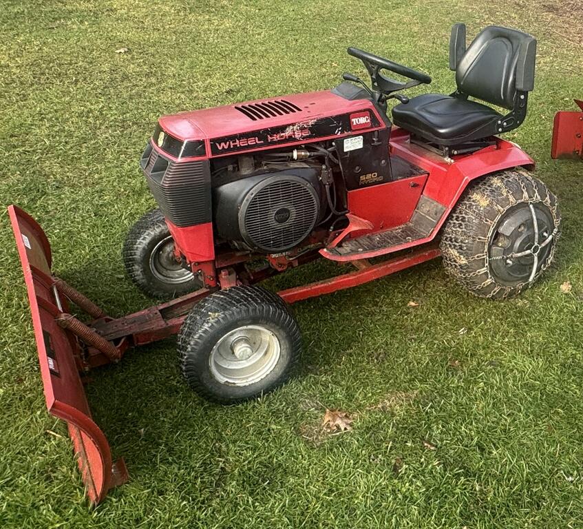

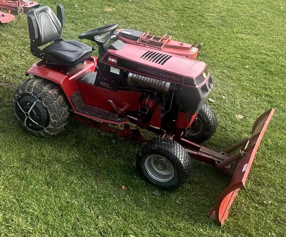

WVHillbilly520H 10,378 #14 Posted December 29, 2019 I got at it this weekend and pulled the 56" moldboard off this frame and transplanted it on my very first snow plow frame that I use on the 520s (that I just noticed today is bent/twisted had a 42" modded to 50" then a worn 54" and now nearly new 56" moldboard) also used the 5 position angle head as well , mounted the new pull angle pull rod @ebinmaine and added new longer spring rods for double trip springs just need to finish my newly made angle lever before winter weather sets in. Now that leaves the ZTR plow frame to see if I can convert into a mid mount grader don't send me hate mail but I'm thinking of cutting the worn 54" down to use as the grader moldboard (unless some one local might want to trade a 48" for 54") 1 Share this post Link to post Share on other sites

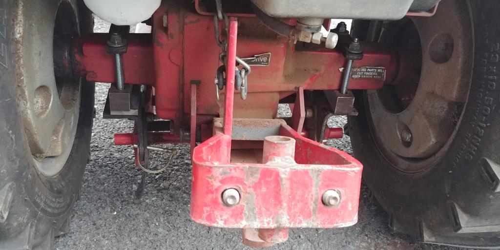

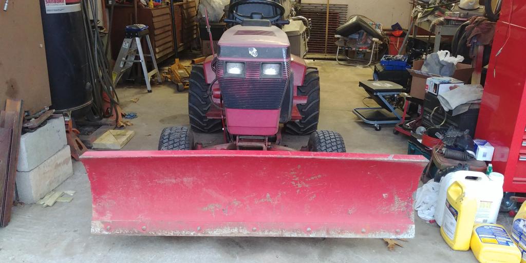

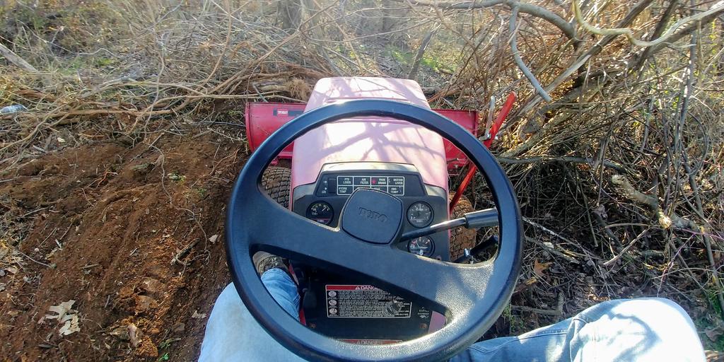

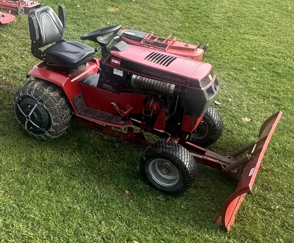

WVHillbilly520H 10,378 #15 Posted February 4, 2020 A little update... It's all mounted up on the "Good Friday" 520 and added riser blocks to the rear axle hitch plus a little extra on the left side to correct the twist in the frame. 1 1 Share this post Link to post Share on other sites

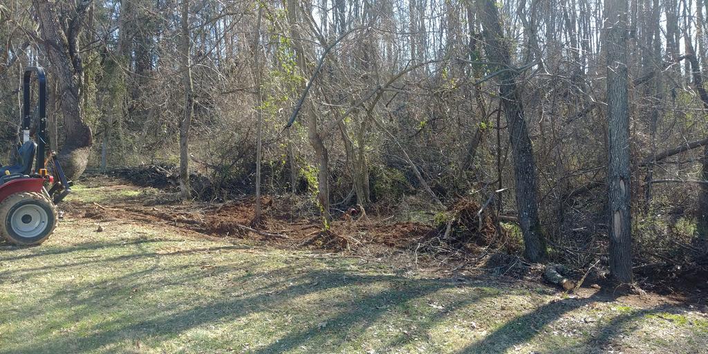

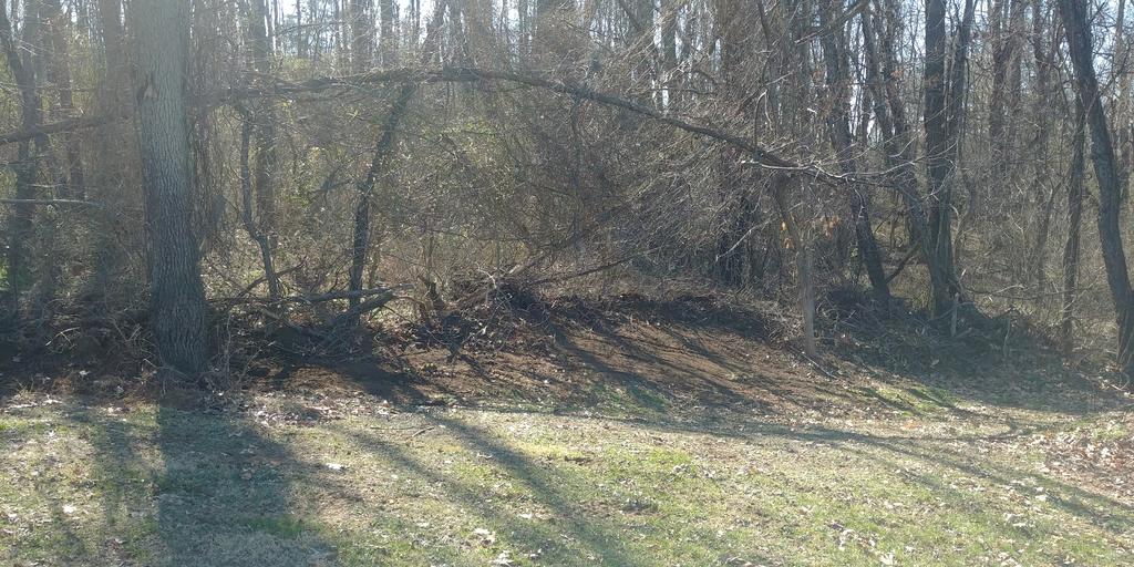

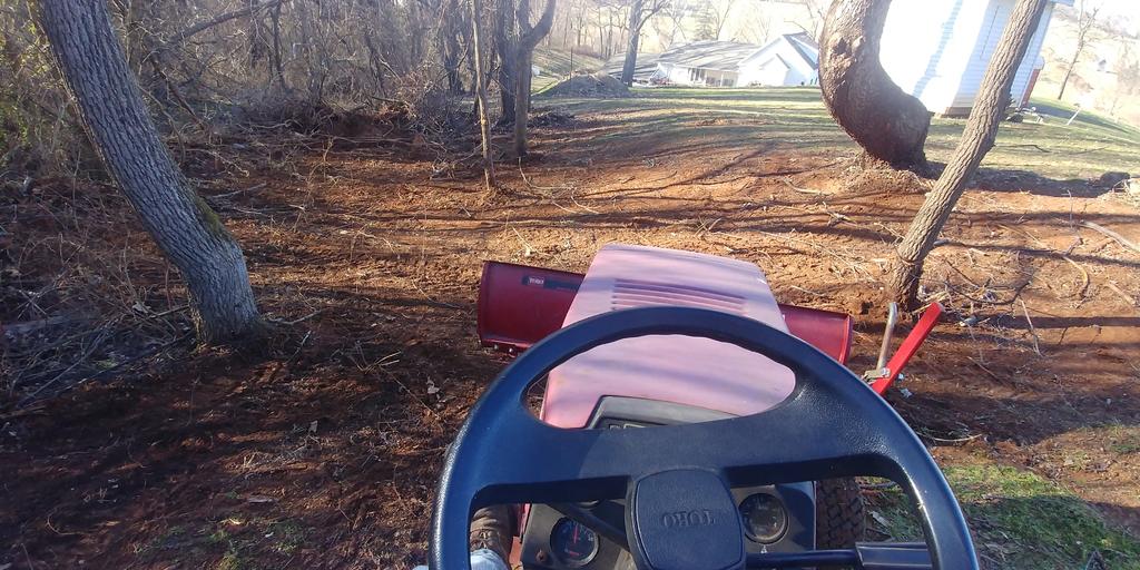

WVHillbilly520H 10,378 #16 Posted March 23, 2020 It held up well to brush clearing. 3 Share this post Link to post Share on other sites
