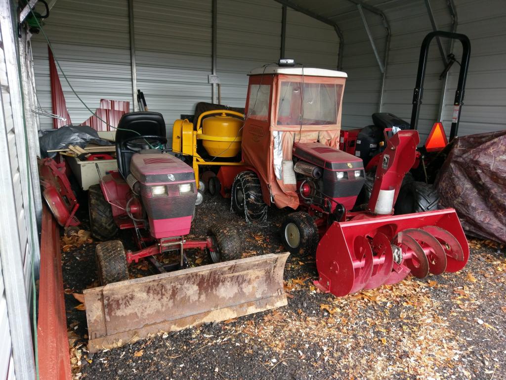

AHS 1,698 #1 Posted December 6, 2019 Duh! I need a Wheelhorse; one for snowblower, one for plow, one for lawnmower, and one for grader... I wish! I need to switch the plow to my kinda refurbished snowblower. New paint in the blower box, new paint on the chute, all new bearings, new blower sprocket, 2 new idler idler gears, a new chain. Auger is not painted ( that will happen this July!) too late in the season, snow can come at any moment now! Oh does anyone have a chain guard in the front they wanna sell me? 6 Share this post Link to post Share on other sites

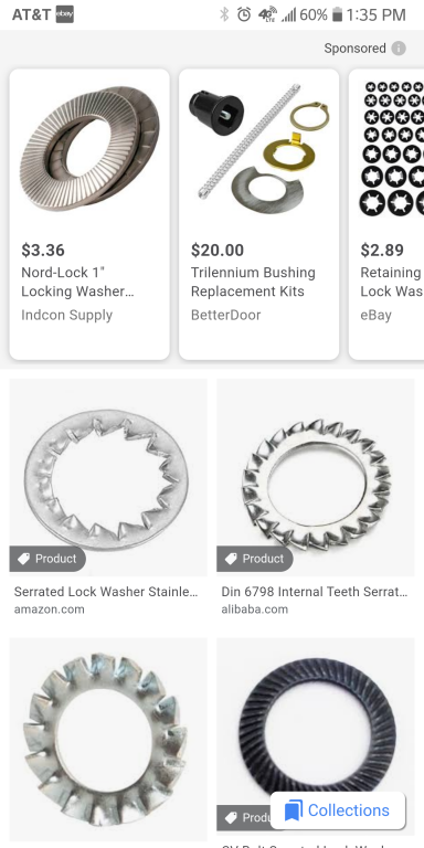

peter lena 10,016 #5 Posted December 6, 2019 AHS, nice work on the blower refit, i use LUBRIPLATE CHAIN AND CABLE SPRAY LUBE ON MY BLOWER WITH great results, i spray it down before and after use, ensuring its never lacking for lubrication. also fitted a SERATED WASHER on the side chain adjustnent point , ensuring no adjustment creep , pete 1 Share this post Link to post Share on other sites

AHS 1,698 #9 Posted December 6, 2019 24 minutes ago, peter lena said: AHS, nice work on the blower refit, i use LUBRIPLATE CHAIN AND CABLE SPRAY LUBE ON MY BLOWER WITH great results, i spray it down before and after use, ensuring its never lacking for lubrication. also fitted a SERATED WASHER on the side chain adjustnent point , ensuring no adjustment creep , pete Show me the serrated washer... I’m entrigued.. @peter lena Share this post Link to post Share on other sites

WVHillbilly520H 10,379 #11 Posted December 6, 2019 2 hours ago, AHS said: Show me the serrated washer... I’m entrigued.. @peter lena Many different styles... Share this post Link to post Share on other sites
AHS 1,698 #12 Posted December 6, 2019 Plow off, snowblower on, and it works! New seat on and old seat linkage on, instead of that new garbage that they call seat linkage! The seat was moved to far forwards and the seat bolts were odd, ( not 7” x7 1/2) and the key switch for not mowing backwards, I connected those wires together a long time ago!👍😄 I’m ready to go snow blowing! 1 Share this post Link to post Share on other sites
AHS 1,698 #13 Posted December 6, 2019 Ok the serrated washer must be for the bottom idler gear! Duh! Ok!😄 Share this post Link to post Share on other sites
roadapples 6,987 #14 Posted December 6, 2019 Your side wings are backwards... 3 Share this post Link to post Share on other sites
peter lena 10,016 #15 Posted December 6, 2019 AHS , as hillbilly above showed the serated washer , https://www.google.com/search?sxsrf=ACYBGNQGyWfRJiE69Q8IId4C3k0_nV8kiw:1575660673640&q=serrated+washer+fastenal&tbm=isch&source=univ&sa=X&ved=2ahUKEwiegfS14aHmAhUnVt8KHTyFDA4QsAR6BAgHEAE&biw=1024&bih=625 is meant to hold solid a sliding mount point . the bottom foward idler gear is also the sliding chain adjustment point , those serated teeth will lock into the related metal work and hod your adjustment . i also see that you have the same seat that i have 3 of for my horses. i am using those two empty bolt holes on mine to make up a bracket for led light flash mount for nighttime plowing. pete Share this post Link to post Share on other sites
AHS 1,698 #16 Posted December 6, 2019 33 minutes ago, roadapples said: Your side wings are backwards... Oops! I was in a hurry! I will switch them!😁 Share this post Link to post Share on other sites
AHS 1,698 #17 Posted December 7, 2019 4 hours ago, peter lena said: AHS , as hillbilly above showed the serated washer , https://www.google.com/search?sxsrf=ACYBGNQGyWfRJiE69Q8IId4C3k0_nV8kiw:1575660673640&q=serrated+washer+fastenal&tbm=isch&source=univ&sa=X&ved=2ahUKEwiegfS14aHmAhUnVt8KHTyFDA4QsAR6BAgHEAE&biw=1024&bih=625 is meant to hold solid a sliding mount point . the bottom foward idler gear is also the sliding chain adjustment point , those serated teeth will lock into the related metal work and hod your adjustment . i also see that you have the same seat that i have 3 of for my horses. i am using those two empty bolt holes on mine to make up a bracket for led light flash mount for nighttime plowing. pete That seat is comfortable! The 3 seconds I got to sit it! I can see the use for the serrated washers...I made the chain to tight and then loosening it is a nightmare...it’s either too loose or too tight! Until Arthur got on there! 1 2 Share this post Link to post Share on other sites
