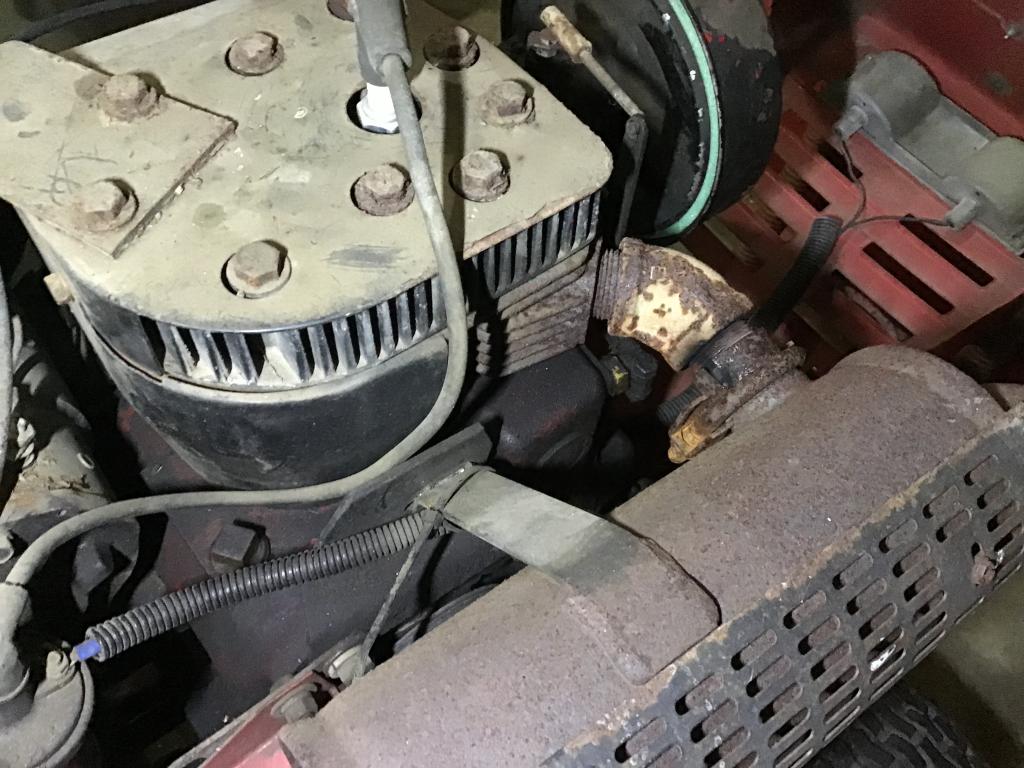

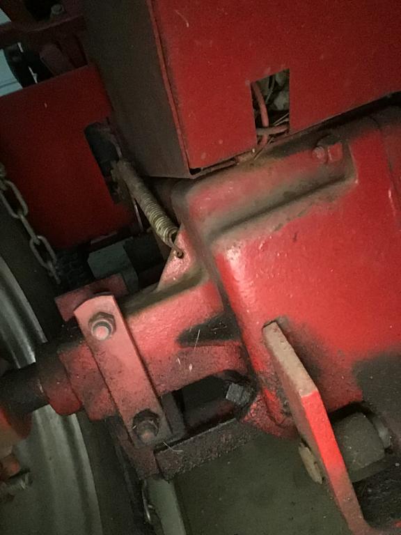

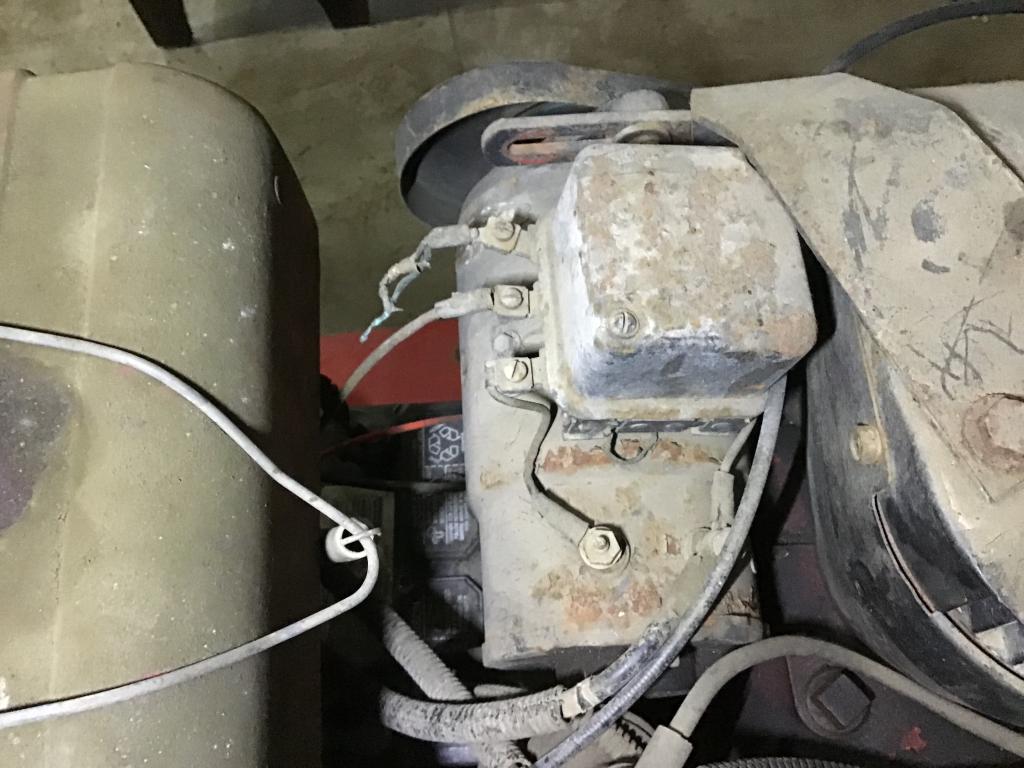

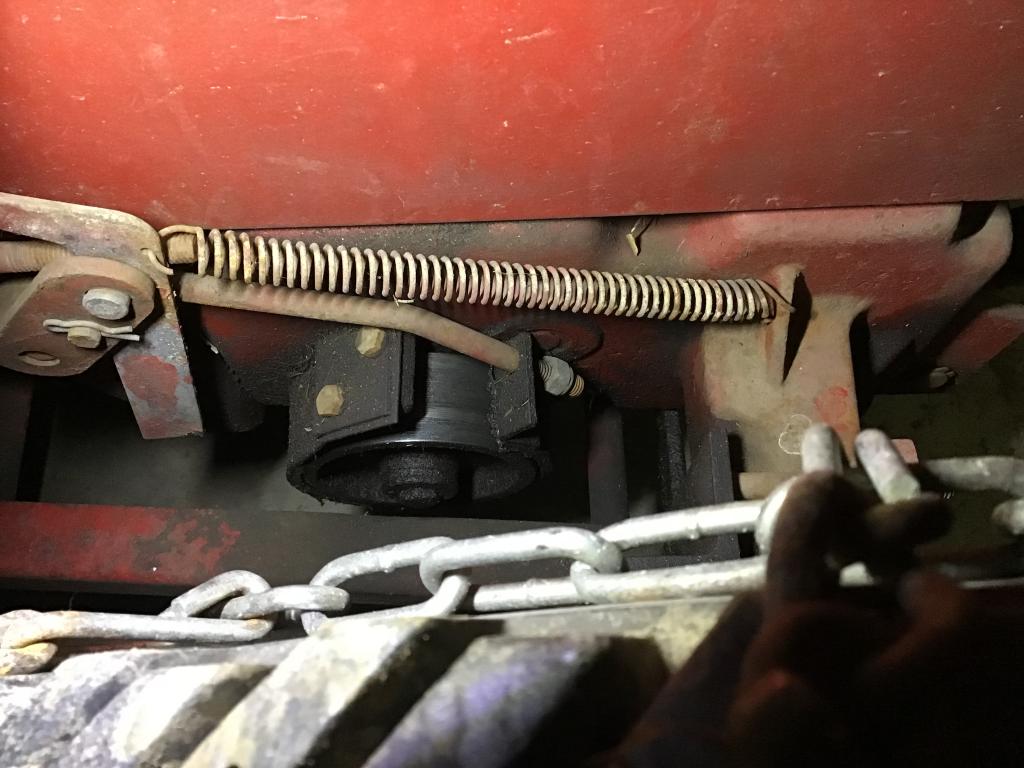

Pullstart 71,563 #30 Posted December 12, 2019 Hey @stevasaurus do these pics help? I noticed the melted / missing wires on the starter/generator. He said it always kept the battery charged... I’ll look into what those should be doing! Share this post Link to post Share on other sites

WHX?? 58,388 #33 Posted December 12, 2019 10 hours ago, pullstart said: melted / missing wires on the starter/generator. That is the L terminal which is for lighting ...goes to the head light switch. Will charge without it. 1 Share this post Link to post Share on other sites
Pullstart 71,563 #34 Posted December 12, 2019 Explains why the lights didn’t work... or one of the reasons! 1 Share this post Link to post Share on other sites
WHX?? 58,388 #35 Posted December 12, 2019 (edited) It's got something to do with the how the regulator/SG can supply a lighting load without taking away from the charge circuit or something like that. You wire it Kev throw an inline fuse in there. Edited December 12, 2019 by WHX24 1 1 Share this post Link to post Share on other sites

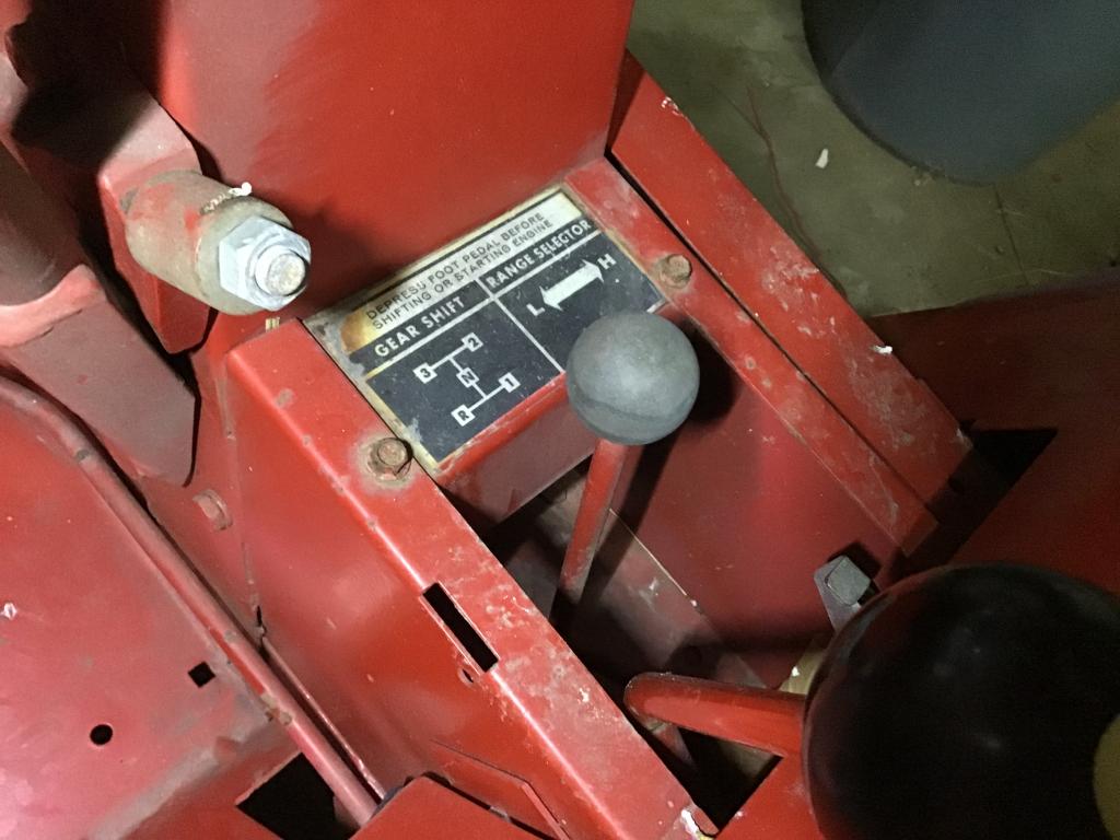

WHX?? 58,388 #37 Posted December 12, 2019 (edited) Later model six speed Steve? Note the absence of the filler extension. Somebody did somewhat of a nice job on it anyway. Made a working tractor out of a few years. What did you end up giving for it Kev? If's it in the neighborhood of what I think you did you might have got a deal. Plow, weights, motor is worth the price of admission. Does it run & drive? Edited December 12, 2019 by WHX24 2 Share this post Link to post Share on other sites
Pullstart 71,563 #38 Posted December 12, 2019 28 minutes ago, WHX24 said: That is the L terminal which is for lighting ...goes to the head light switch. Will charge without it. Is the lighter and lighting on the same circuit? Maybe he was powering a big flood and smoking a @stevebo hoobie doobie at the same time to melt that wire... So when running, I should have 12V+ From the stud to ground? Share this post Link to post Share on other sites

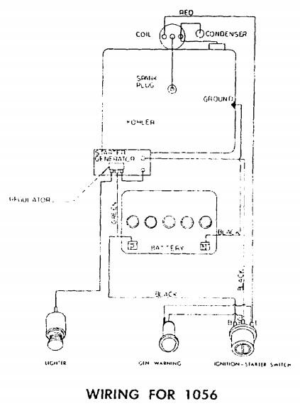

WHX?? 58,388 #40 Posted December 12, 2019 12 minutes ago, pullstart said: should have 12V+ From the stud to ground? Yes you should. Not sure but think 12v is there all the time....even when motor isn't running. My 1067 is like that but I have all custom wiring. The lights would run off the lighter. The diagram is correct as a '56 would not have had lights. Yah fuse is case you have to light up a stogie... Does it have the 70 amp key switch? Share this post Link to post Share on other sites

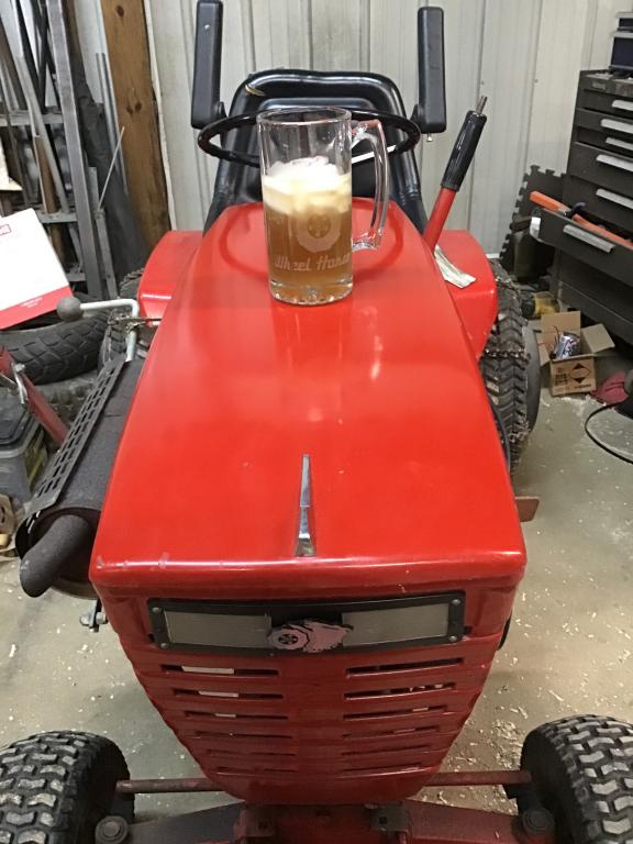

Pullstart 71,563 #50 Posted December 13, 2019 You know @stevasaurus you should really think about naming a few of your horses, you’re pretty good at it! Mrs. Pullstart fixed me a “dark and stormy” and sent me to the shop to play for a few hours while she has a few girlfriends over. Sometimes a name just happens. Like tonight. Here’s “Stormy”! 1 1 Share this post Link to post Share on other sites
