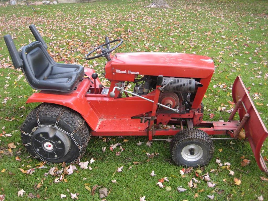

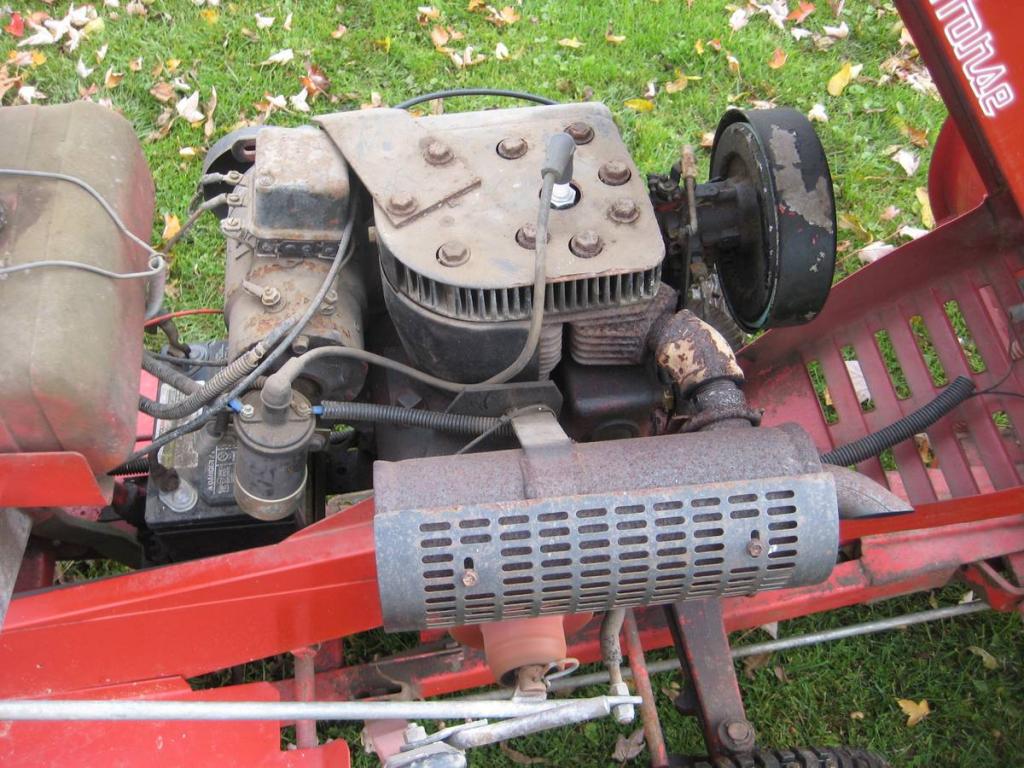

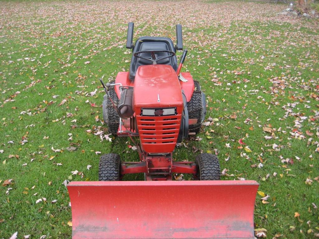

Pullstart 71,259 #1 Posted December 5, 2019 (edited) This is listed as a 1965. I see many clues telling me it’s not... such as a 300+ series muffler, front and mid mount tach-a-matics, 8 speed transmission, (did the 65 model have that headlight lens?), larger PTO bell and belt guard, etc. what would you attempt to label it as? B and C-80 is gear starter, correct? Did the Charger/Bronco come with any of these features? Edited March 26, 2020 by T-Mo Revise Title per the OP 4 Share this post Link to post Share on other sites

Shynon 7,705 #3 Posted December 5, 2019 Looks like a Raider 12 1 1 1 Share this post Link to post Share on other sites
Pullstart 71,259 #4 Posted December 5, 2019 13 minutes ago, Shynon said: Looks like a Raider 12 Ok, I can see that. So ‘68-‘69, with the addition of a later model muffler and a starter/generator? 1 Share this post Link to post Share on other sites

WHX?? 58,154 #6 Posted December 5, 2019 Looks like there is a tag under the dash for a PI. I'm thinkin modded Raider too would have to be a very early Raider with the SG but then should have a metal tank. 6" fronts?? they look small something off on the headlight lens cigar lighter there 1 hour ago, The Tool Crib said: 65 they didn't have foot boards and front headlights in the hood. possible mods?? Franken horse any year but a $300 tractor all day + 150 for the plow Pull the trigger and go get it ! We'll check for antlers later! 2 4 Share this post Link to post Share on other sites

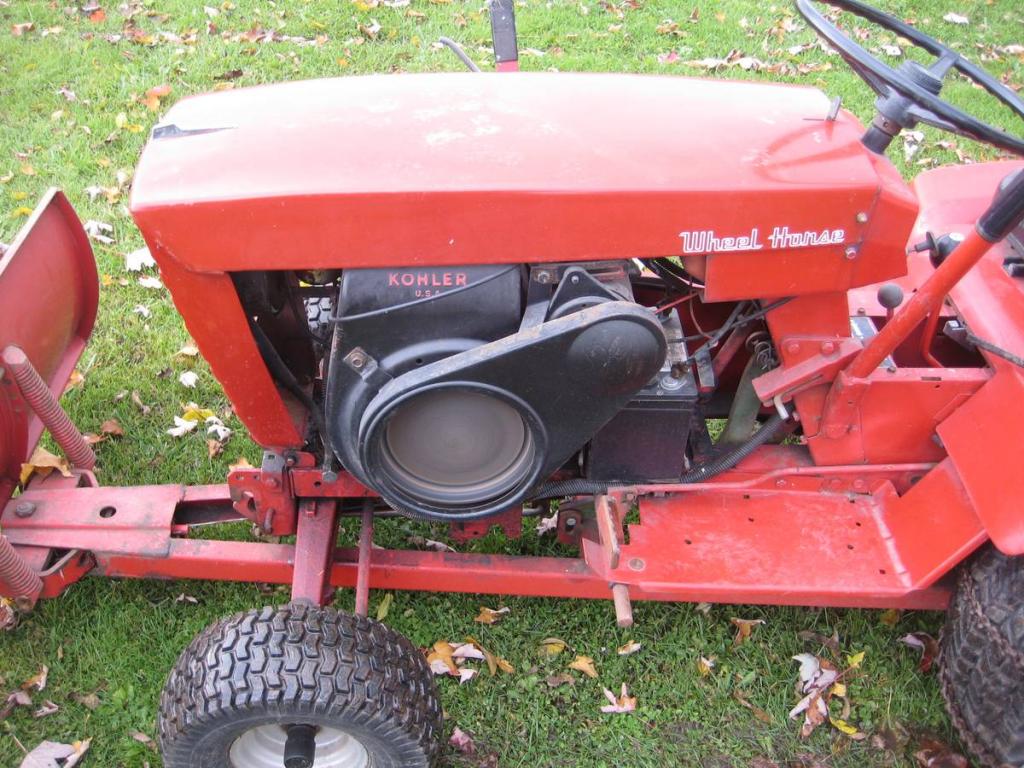

Stepney 2,356 #12 Posted December 5, 2019 (edited) I'm going with a very early model Raider 12. I've seen then with a gen-start engine before. (Thought this technically ended with the 1967 models). I can see the unused hood stand and 3 bolts holding the front hitch on. Nicely upgraded but clearly not correct. Plastic tank is interesting.. I'd go with a Raider 12 for sure. If the motor isn't original, it'd still be a Raider regardless. Edited December 5, 2019 by Stepney Share this post Link to post Share on other sites
WHX?? 58,154 #13 Posted December 5, 2019 Yes technically SG's were gone in 68. Keeping true to form tho WH may have had some motors they needed to use up on the early Raiders. Waste not want not I guess. Let us know when you get back with it Kev right up yer alley. . Lots of parts there to make an orginal ...Yeah Richard...Pullstart owning an orginal!?!?? 1 3 Share this post Link to post Share on other sites

stevasaurus 23,856 #23 Posted December 11, 2019 You found it Kevin...it is a customized 1056. I was going to ask you what the diameter of the rear axles is?? The transmission is obviously not a #5053...and what shaft is the brake drum on??? Share this post Link to post Share on other sites
