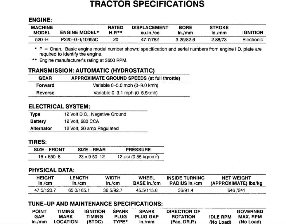

pfrederi 21,308 #1 Posted December 2, 2019 (edited) Had about 6 inches of snow today so it was plow day no blowing required. fired up the Charger 12 and went to work. Didn't get much seat time only took a bout 35 minutes (see pics in the show me your snow machine thread). Running up and down the drive way I have to plow to one side after the first pass at full throttle full speed...she rolled the snow off beautifully. Now I know there are a lot of opinions about "best" plow tractors. Gear drives 400 series 520's but to paraphrase Gordon Gekko (Wall street) SPEED is good. I know most like Etons over Sunstrands but look at the top speed difference between a Charger and a 520. Now seat time is good but sometimes getting the job done and going inside for a hot toddy is better. Besides it rolls the snow over better . Gear drives with their low top speed and slooow reverse are not in consideration. Also note the similarity in weight (I always thought 520 were heavy... ) When it comes to plowing horse power is not terribly relevant unless it can drive more speed traction is the limiting issue. First pic is 520 second is Charger.12 Let the disagreements begin.... Edited December 2, 2019 by pfrederi 6 Share this post Link to post Share on other sites

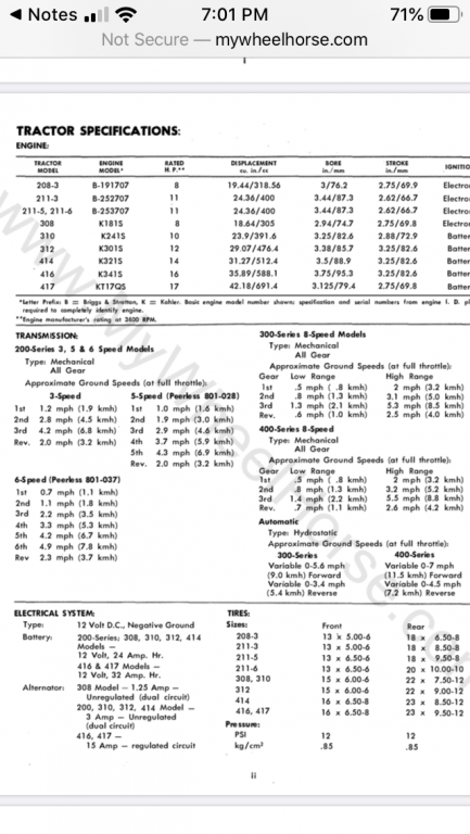

JCM 11,451 #5 Posted December 3, 2019 @Wishin4a416 Speeds for a 1989 312-8 are as follows Low Range 1st .4 2nd .6 3rd 1.1 rev .5 High Range 1st 1.6 2nd 2.5 3rd 4.3 rev 2.1 MPH According to the original owners manual. 1 1 Share this post Link to post Share on other sites

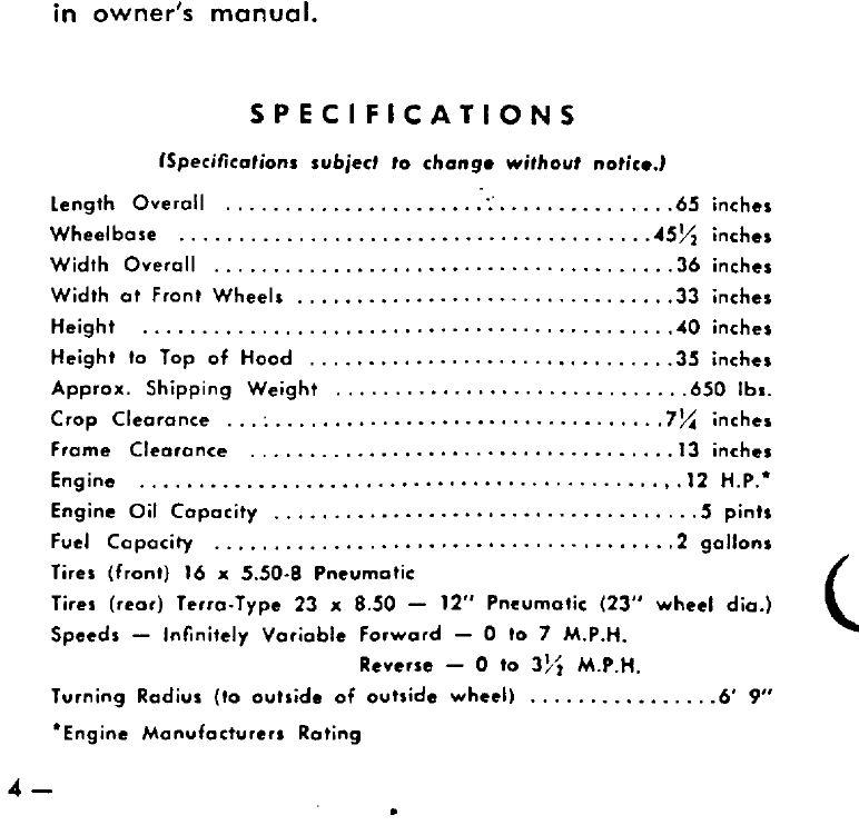

tom2p 2,396 #7 Posted December 3, 2019 (edited) note the pic above manual trans speed 3rd gear / high range: 5.5 mph 400 series hydro: 7 mph so I don't how / why a 520-H top speed is 5 mph - when a 400 hydro is 7 mph Edited December 3, 2019 by tom2p Share this post Link to post Share on other sites
ebinmaine 81,149 #8 Posted December 3, 2019 I normally plow in second gear at about 3/4 throttle. I'd go faster but our gravel drive is too rough and I'm not fond of forcefully removing the plow from tractor by that method. Later in the season but before Mudd I can speed up a bit. 1 Share this post Link to post Share on other sites
JCM 11,451 #9 Posted December 3, 2019 @tom2p I see the speeds are different than my 312, do you know what year that chart pertains to. Share this post Link to post Share on other sites
tom2p 2,396 #10 Posted December 3, 2019 18 minutes ago, JCM said: @tom2p I see the speeds are different than my 312, do you know what year that chart pertains to. hmmm ... what years did they use the Kohler in the 400 series ... ? Share this post Link to post Share on other sites

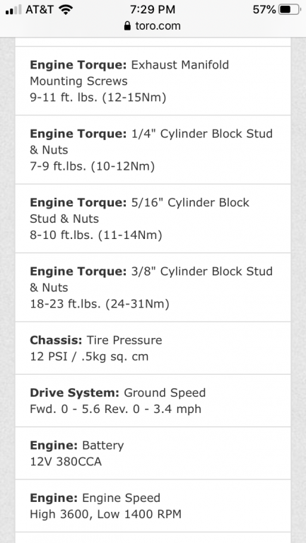

tom2p 2,396 #12 Posted December 3, 2019 (edited) pic above is from the toro site manual for 94 416-H top speed 5.6 mph Edited December 3, 2019 by tom2p Share this post Link to post Share on other sites

tom2p 2,396 #14 Posted December 3, 2019 (edited) so Kohler/Sundstrand powered/motivated is the way to go ... ??? Edited December 3, 2019 by tom2p Share this post Link to post Share on other sites

JCM 11,451 #16 Posted December 3, 2019 My 1991 Operators Manual Quotes approximate Forward variable 0- to 5.6 and reverse 0-3.4 MPH This is for a 520 - H. Don't quote me on this but I believe Kohlers were used on the 400 series in 1985 6 7 and newer were 16 h.p Onans but Someone with more knowledge on that question will chime in. This is off the top of my head and seems to diminish the older I get. 2 Share this post Link to post Share on other sites
