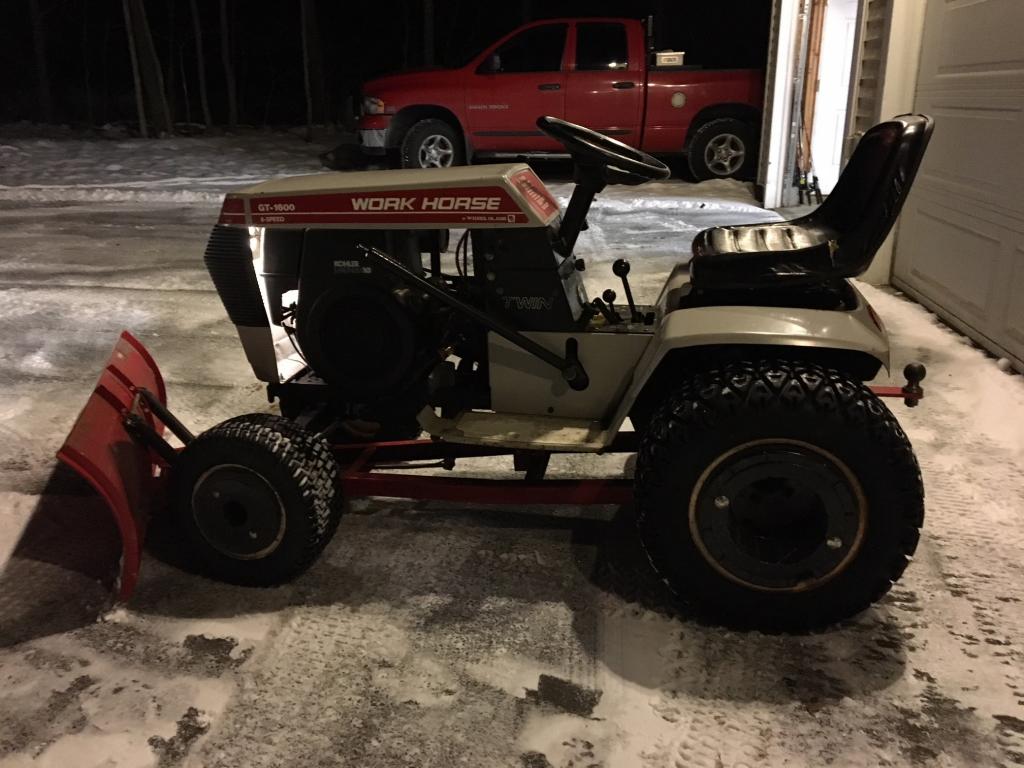

Lagersolut 806 #101 Posted December 17, 2019 (edited) 44 minutes ago, AHS said: @Lagersolut I like the C-101. My Dad still has one.. hold on.. there’s me on it in ‘85!💪👍😄 The C-101 in my picture was my fathers . He used it mowing 2 acres until I built my place in '94 , that same year he bought a simplicity told me I could have it if not he was selling it . Long story short I used it until it was springing leaks and smoking the wife wanted me to junk it ...wasn't having any of that ....bought the 2005 315-8 classic GT and fully restored the C-101 . ....fast forward to 2019 the herd is up 2 more with a 310-8 and a 416-8 ....and soon to be introduced a freebie a guy was having trouble with ran out and bought a green one ......lol Edited December 17, 2019 by Lagersolut 3 1 Share this post Link to post Share on other sites

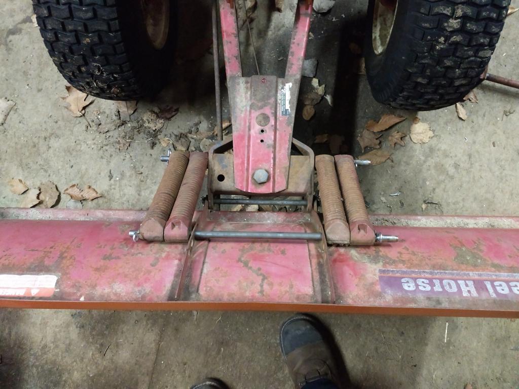

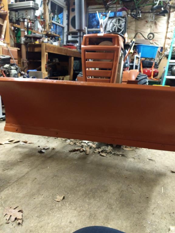

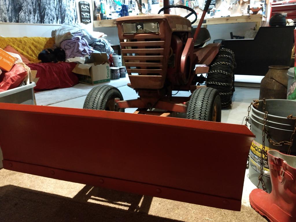

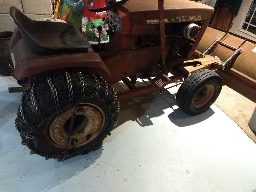

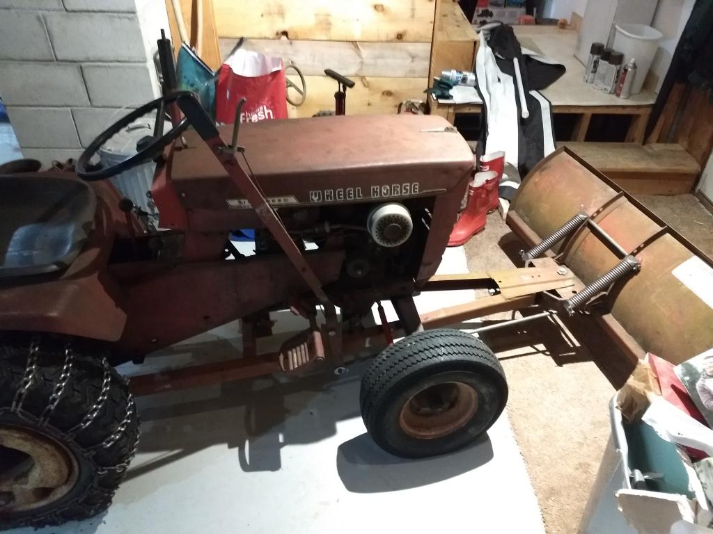

ebinmaine 81,156 #102 Posted December 17, 2019 Got the plow back on Cinnamon after Trina painted the face of it the other day. This plow has weak springs so I pulled a couple extra off the pile and made up some longer pins. Then mounted the bracket and plow to Trina's 867. I installed the bolens weights on her tractor as well. We now have 2 plow tractors!! 7 4 Share this post Link to post Share on other sites
WVHillbilly520H 10,379 #103 Posted December 17, 2019 1 minute ago, ebinmaine said: Then mounted the bracket and plow to Trina's 867. I spy something laying on the bubble wrap... Wonder where they ended up ... 1 Share this post Link to post Share on other sites
ebinmaine 81,156 #104 Posted December 17, 2019 @WVHillbilly520H those awesome brackets will be on the Cinnamon Horse at some point. I didn't get a pic of it but I had to make up a short link extension to put on the 867. Being a short frame there's 2 positions you can put the long frame plow. Trina liked the position of the plow controls with the frame in the most forward mount holes. The existing center link was bent at the right angle but was about 1" too short. I used a short piece of flat stock and drilled 2 holes. Bolted it to the plow frame and pinned it to the tractor link. 1 Share this post Link to post Share on other sites
MikMacMike 494 #105 Posted December 17, 2019 28 minutes ago, ebinmaine said: Got the plow back on Cinnamon after Trina painted the face of it the other day. This plow has weak springs so I pulled a couple extra off the pile and made up some longer pins. Then mounted the bracket and plow to Trina's 867. I installed the bolens weights on her tractor as well. We now have 2 plow tractors!! Ahhh now I understand what you meant by second spring. Looks like thats the way it came from the factory too ebinmaine. Are those springs hard to stretch? Share this post Link to post Share on other sites
ebinmaine 81,156 #106 Posted December 17, 2019 7 hours ago, MikMacMike said: Ahhh now I understand what you meant by second spring. Looks like thats the way it came from the factory too ebinmaine. Are those springs hard to stretch? Normally yes. Not mine. That's why I added 2.... Keeps the plow from tripping forward as easily. 1 Share this post Link to post Share on other sites

Sparky-(Admin) 26,694 #109 Posted December 17, 2019 10 hours ago, ebinmaine said: Is that how you run your plow? With the plow blade leaning forward? Just curious as i have messed around with mine and have settled on the next holes "up" for the springs to mount in. Wonder if having it lean that far forward made the springs less effective 1 Share this post Link to post Share on other sites
ebinmaine 81,156 #110 Posted December 17, 2019 11 minutes ago, Sparky said: Is that how you run your plow? With the plow blade leaning forward? Just curious as i have messed around with mine and have settled on the next holes "up" for the springs to mount in. Wonder if having it lean that far forward made the springs less effective I run mine in the third hold down so that I keep most of the plow in a more forward lean. It's tough to see but the bottom two or three in still has a back tilt to it. I've found that if I put it in the second hole it digs into my dirt driveway too much. Plows snow great but also plows more dirt. 2 Share this post Link to post Share on other sites
ebinmaine 81,156 #111 Posted December 17, 2019 12 minutes ago, Sparky said: Wonder if having it lean that far forward made the springs less effective To some extent, yes that's definitely true. but the two springs that were on their were both twisted and bent. I didn't have another new good set so I doubled up instead. 1 Share this post Link to post Share on other sites

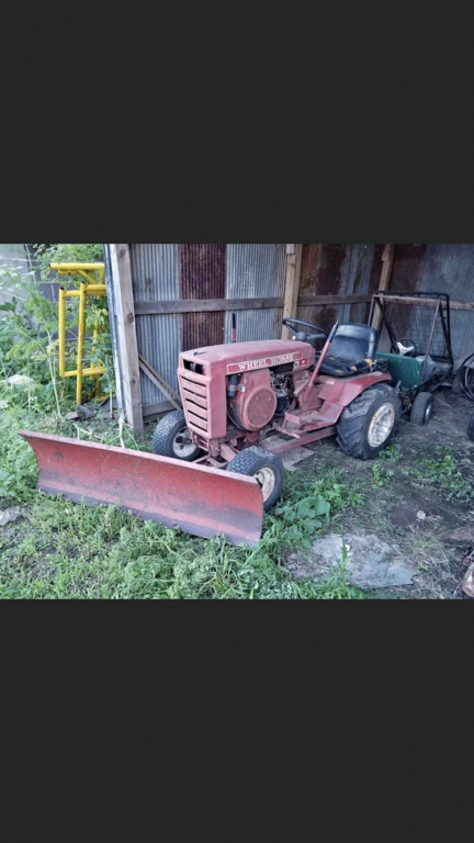

Dirtpoor 131 #123 Posted December 18, 2019 I just got this I used it once very surprised at how well it did for the condition of this tractor. 5 1 Share this post Link to post Share on other sites
