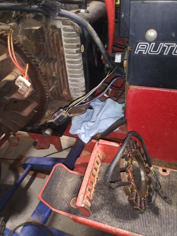

Cee245 853 #1 Posted November 16, 2019 (edited) Hi, I'm working on putting a stator on my 417. I'm having trouble finding the plug that the stator plugs into. I've looked through the files without success. Can anyone help? Edited November 17, 2019 by Cee245 Share this post Link to post Share on other sites
Cee245 853 #2 Posted November 16, 2019 Well, I see that it plugs into the "alternator" . Another question is what oil filter do I use for this motor? And which transmission filter? I have a Napa near by... Thanks, Cory Share this post Link to post Share on other sites
pfrederi 20,540 #3 Posted November 16, 2019 If you have an oil filter on the engine it is not an original WH installed Kohler. WH didn't use filter. Maybe some one added one in which case i would use what ever they used. Tranny Wix 51410 Share this post Link to post Share on other sites

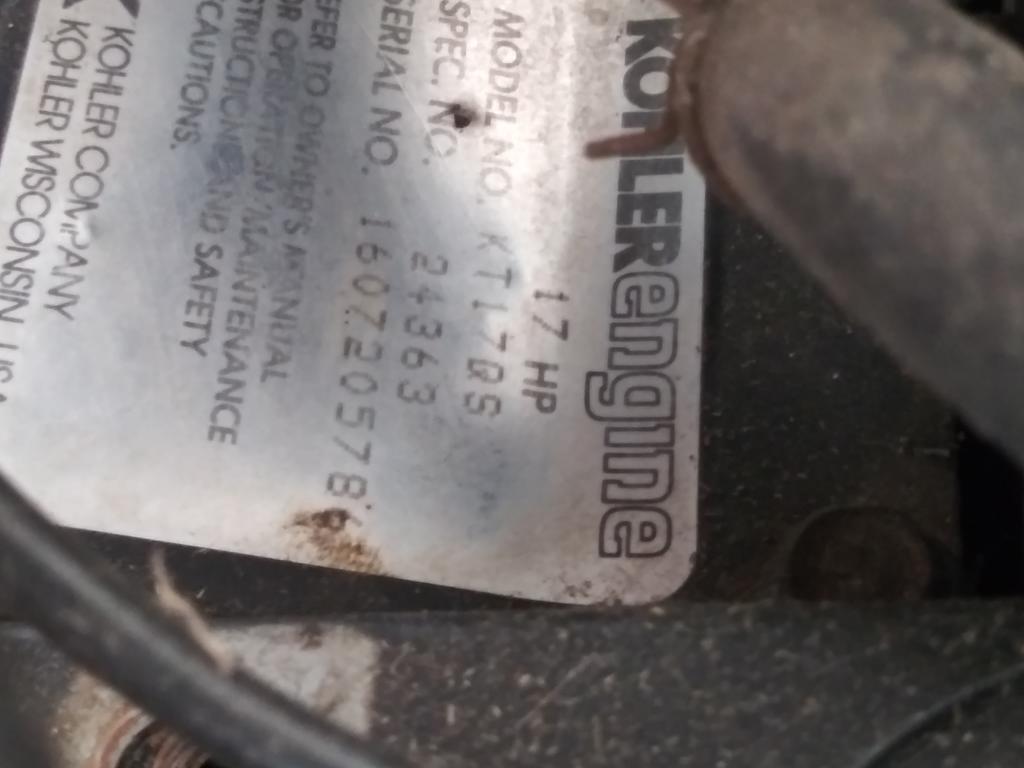

Cee245 853 #7 Posted November 16, 2019 This is my engine model plate. I keep seeing on the internet, "k Points & Condenser Set for Kohler K-Series Engines K91 K141 K161 K181 K241 K301 Which K do I have? Share this post Link to post Share on other sites
gwest_ca-(File Mod) 12,234 #8 Posted November 16, 2019 When you enter KT17-24363 in here this is what comes up https://www.partstree.com/models/kt17-24323-kohler-k-series-engine-made-for-wheel-horse-17hp/ Take the Kohler part numbers to Napa - they will fix you up. Garry Share this post Link to post Share on other sites
gwest_ca-(File Mod) 12,234 #9 Posted November 17, 2019 8 hours ago, Cee245 said: Well, I see that it plugs into the "alternator" . Thanks, Cory Did you mean voltage regulator? Then there should be a 3rd wire added to take the regulated charge current to the battery or ignition switch. Garry Share this post Link to post Share on other sites
Cee245 853 #10 Posted November 17, 2019 I'm looking into that tonight @gwest_ca. I'm not good with electrical. I'm hoping I'll learn some things along the way. Share this post Link to post Share on other sites
Cee245 853 #11 Posted November 19, 2019 All I can say for the last couple days, this tractor has gotten a good cleaning. Dealing with "normal" issues on it after 5 years of sitting. Share this post Link to post Share on other sites
Cee245 853 #12 Posted November 19, 2019 Yes @gwest_ca. Voltage regulator. Share this post Link to post Share on other sites
