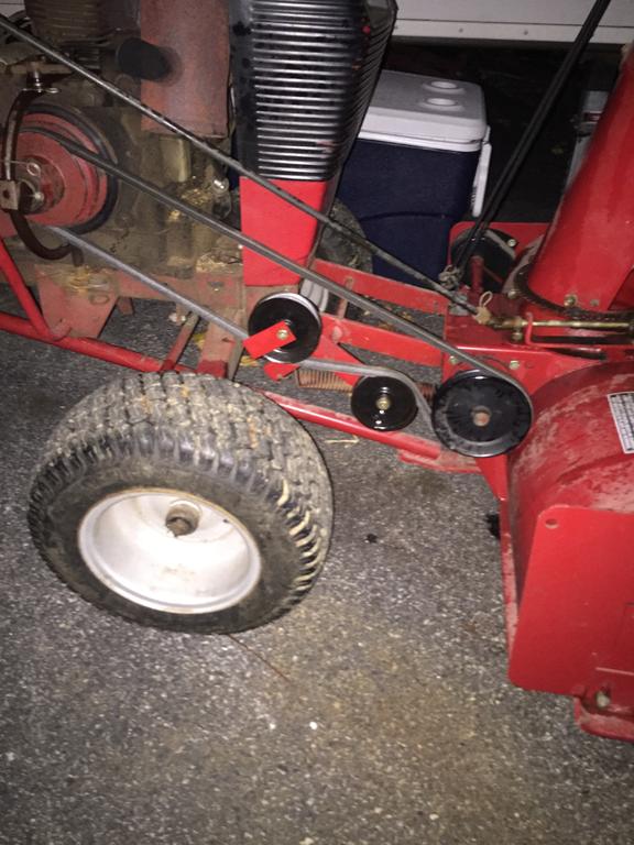

Cee245 846 #1 Posted November 11, 2019 (edited) Hey all, Can someone send a close pic of the pullies and belt set up on a 42" tall chute blower? I think I reversed the pullies or something... I also think I'm missing the part that holds the handle that turns the chute. Thanks Edited November 11, 2019 by Cee245 Share this post Link to post Share on other sites

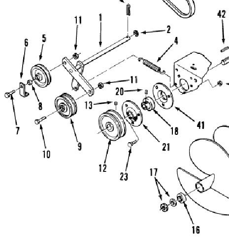

gwest_ca-(File Mod) 11,888 #2 Posted November 11, 2019 Click on the picture Garry 2 Share this post Link to post Share on other sites

Cee245 846 #4 Posted November 11, 2019 (edited) It seems that I need actual pictures, because sometimes I am dumb! (I don't have a good memory) And yes, I have a wife and 3 kids, 😆 I have the part that holds the 2 pullies in between the actual snowblower and the pto messed up some how. It's the part that attaches to the blower with the big spring. Edited November 11, 2019 by Cee245 Share this post Link to post Share on other sites

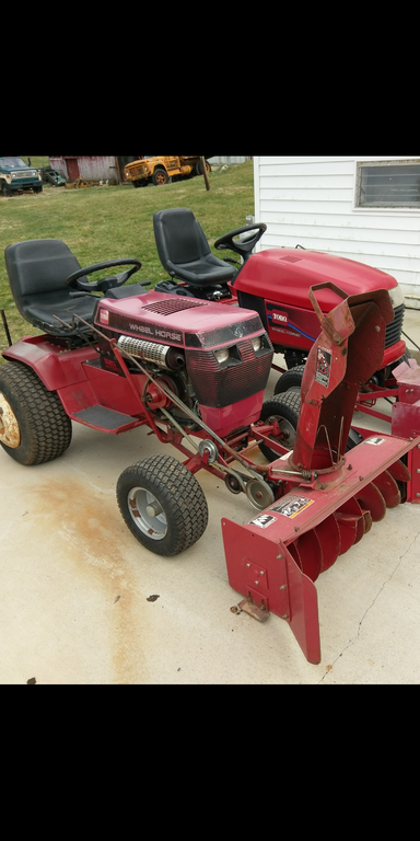

WVHillbilly520H 10,377 #5 Posted November 11, 2019 10 minutes ago, Cee245 said: I was hoping for a picture of the set-up with real pictures, if I may. Hope this helps 1 1 Share this post Link to post Share on other sites

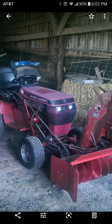

nylyon-(Admin) 8,608 #6 Posted November 11, 2019 2 1 Share this post Link to post Share on other sites
Cee245 846 #7 Posted November 11, 2019 Thank you @WVHillbilly520H! I think I can see what I did wrong, Does anyone have a pic of how the spring attaches? 1 Share this post Link to post Share on other sites

gwest_ca-(File Mod) 11,888 #9 Posted November 12, 2019 Where the spring attaches Garry 2 Share this post Link to post Share on other sites
Cee245 846 #10 Posted November 12, 2019 Thank you! I see it now! Appreciate this site! Share this post Link to post Share on other sites
AHS 1,566 #11 Posted November 16, 2019 On 11/11/2019 at 6:08 PM, nylyon said: You run your snowblower on the lower groove on the PTO? I have the short shute on the high speed pulley on the pto...granted that is on a 10 hp . @nylyon Share this post Link to post Share on other sites
nylyon-(Admin) 8,608 #12 Posted November 16, 2019 Yes, the blower is designed for the outside pulley, this is currently mounted on a 310-8 as well. 1 Share this post Link to post Share on other sites
