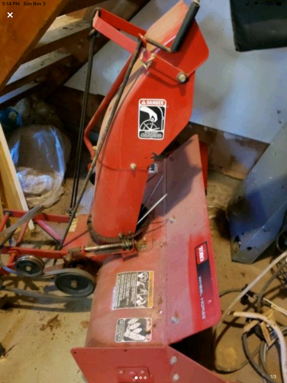

nylyon-(Admin) 9,040 #1 Posted November 3, 2019 Picked up a clean 1995 Single Stage, auger has the usual bends, scraper needs to be reversed but did not wear down to the frame. They couldn’t find the flag, so visited @wheelhorseman’s site https://wheelhorsepartsandmore.com to get a new one sent out. Turns really freely, and looks amazing. More pictures when cleaned up and lighter outside. I think this will go on the 310. 9 4 1 Share this post Link to post Share on other sites

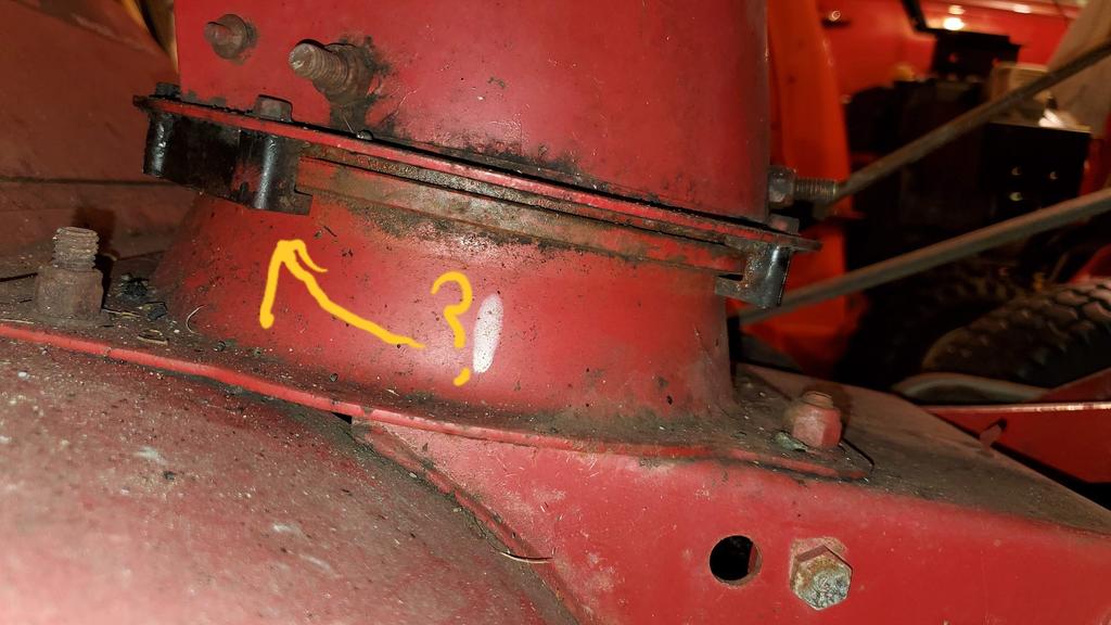

berriesandnuts 1 #13 Posted November 12, 2019 On 11/7/2019 at 9:48 AM, wallfish said: Remove, inspect and clean all of the parts associated with the chute, especially the plastic pieces under the chute which hold it on the base. Replace them if necessary, there should be 3 pieces I believe. Check for any binding of any of the parts and adjust as necessary. Those tall chutes should swivel fairly easy. A bit of grease on the moving parts helps reduce friction as well Plastic pieces? It looks like the chute just sits metal on metal. Just kinda loosely held in place by 3 "retainers"? Not sure if that's what you're referring to. Share this post Link to post Share on other sites
nylyon-(Admin) 9,040 #14 Posted November 12, 2019 I see where the plastic pieces are, when I take mine apart I’ll take some pictures Share this post Link to post Share on other sites
wallfish 20,510 #15 Posted November 12, 2019 2 minutes ago, berriesandnuts said: Plastic pieces? It looks like the chute just sits metal on metal. Look under the gear teeth on the chute. Are there 6 bolts on top of the circle with the gear teeth? Share this post Link to post Share on other sites
berriesandnuts 1 #16 Posted November 12, 2019 4 minutes ago, wallfish said: Look under the gear teeth on the chute. Are there 6 bolts on top of the circle with the gear teeth? Do you mean the bolts holding these I pointed to with the yellow arrow? 1 Share this post Link to post Share on other sites
wallfish 20,510 #17 Posted November 12, 2019 (edited) Yes, those 3 pieces hold the entire chute on. Edited November 12, 2019 by wallfish Share this post Link to post Share on other sites
berriesandnuts 1 #18 Posted November 12, 2019 I see. It seems that on mine, the chute, when it rotates, shifts around quite a bit. Starts shifting away from the worm gear. The worm gear itself swivels around when I'm trying to turn it. Then there is very little contact and then the chute doesn't turn at all. It seems like the chute should hug a little more snuggly. I was thinking that maybe the worm gear should be closer to the chute, but I don't see how to adjust it really. Is it possible it's because the 3 pieces are worn maybe? Share this post Link to post Share on other sites
wallfish 20,510 #19 Posted November 12, 2019 Combination of worn parts adding up. The plastic pieces get worn, the holes which the worm gear rides get worn. You can drill out the worm gear holes and insert bronze flange bushing to tighten that up. Look under the worm gear for the bolt holding it on, you can get some adjustment out of that. Think someone 3 D printed new plastic pieces but can't remember who Share this post Link to post Share on other sites

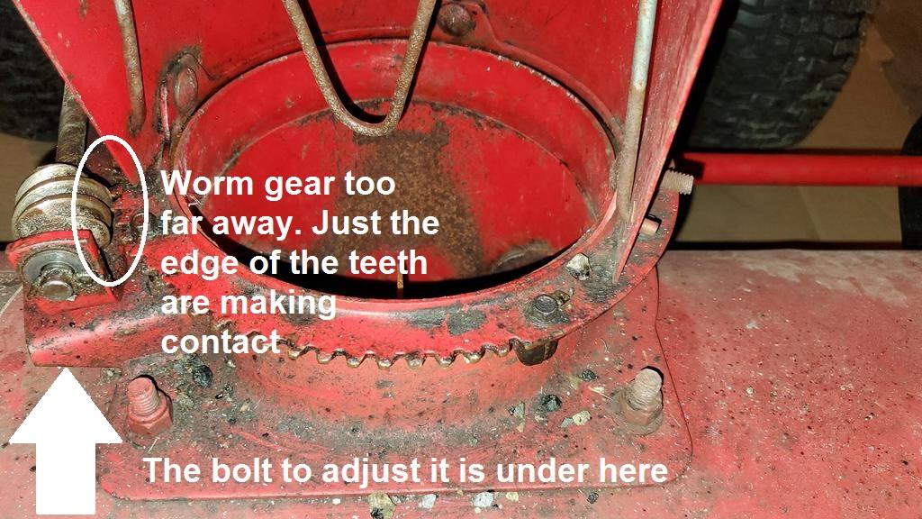

WVHillbilly520H 10,379 #21 Posted November 12, 2019 (edited) 36 minutes ago, berriesandnuts said: Do you mean the bolts holding these I pointed to with the yellow arrow? 22 minutes ago, berriesandnuts said: I see. It seems that on mine, the chute, when it rotates, shifts around quite a bit. Starts shifting away from the worm gear. The worm gear itself swivels around when I'm trying to turn it. Then there is very little contact and then the chute doesn't turn at all. It seems like the chute should hug a little more snuggly. I was thinking that maybe the worm gear should be closer to the chute, but I don't see how to adjust it really. Is it possible it's because the 3 pieces are worn maybe? Dude those plastic retainers are basically shot... there is one carriage bolt holding the the worm gear to the case the nut is under/behind the worm you'll loosen it move the worm into the rack of the chute and tighten but you probably need 3 new retainers...like the black pieces you can see in these pics. Toro wants like $50+ each. Edited November 12, 2019 by WVHillbilly520H Share this post Link to post Share on other sites

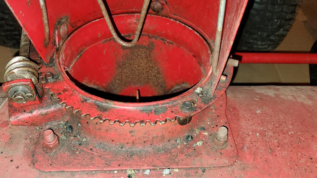

wallfish 20,510 #22 Posted November 12, 2019 3 minutes ago, WVHillbilly520H said: Dude you don't have the plastic retainers they are completely MIA. You can see 2 of them in his pic with the squiggly yellow arrow pointing to one. Share this post Link to post Share on other sites
nylyon-(Admin) 9,040 #23 Posted November 12, 2019 14 minutes ago, wallfish said: Think someone 3 D printed new plastic pieces but can't remember who 1 Share this post Link to post Share on other sites
WVHillbilly520H 10,379 #24 Posted November 12, 2019 10 minutes ago, wallfish said: You can see 2 of them in his pic with the squiggly yellow arrow pointing to one. I seen them after I wrote that but the one is mostly gone... I have toyed with the idea of making them out of billet aluminium. Share this post Link to post Share on other sites
nylyon-(Admin) 9,040 #25 Posted November 12, 2019 27 minutes ago, WVHillbilly520H said: did you make that inner deflector does that help? 1 1 Share this post Link to post Share on other sites
