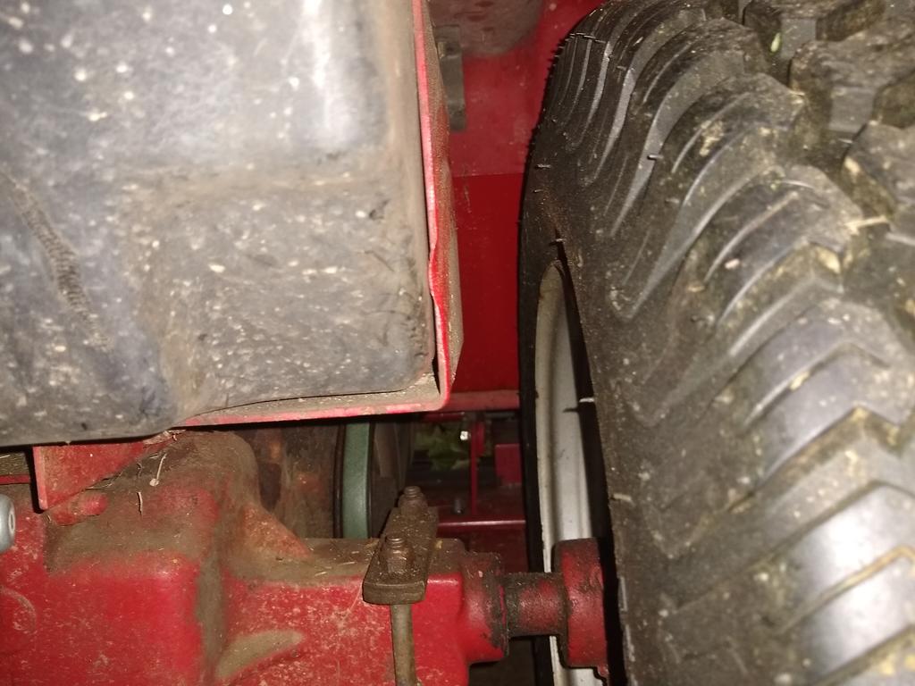

HamptonT 33 #9 Posted November 17, 2019 So. I made another attempt to mount the chains. It wasn’t the fenders that were rubbing. It’s the inside fender support. The rims on it must not be stock. I compared them to the other set of rims and the other set sit outward further from the hub. Now....my least favorite job. Swapping tires! I can usually do it but I always get hung up on breaking the beads.... Share this post Link to post Share on other sites

andyk 83 #14 Posted November 17, 2019 I went with 8.50 wide tires when it was time for replacement. There were signs of chain wear on the fender supports when i bought it,and I wanted plenty of room for installation and removal. I didn't notice any change while mowing. 1 Share this post Link to post Share on other sites

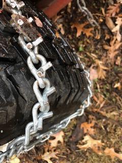

HamptonT 33 #16 Posted November 17, 2019 Well. I got the tires mounted on the other rims. The rims that were on it were can-ams. Got the chains on and they clear just fine. The chains I had were off an old Honda ATC. They have the cleats on them. Might be a little too aggressive.... it rides pretty rough. It’ll probably climb a tree. Anyone got a source for some more appropriate chains? Maybe more cross links per revolution to smooth out the ride. I have a flat driveway so I don’t need anything real aggressive. Share this post Link to post Share on other sites
wallfish 20,733 #17 Posted November 17, 2019 (edited) 1 hour ago, HamptonT said: Anyone got a source for some more appropriate chains? Maybe more cross links per revolution to smooth out the ride. I have a flat driveway so I don’t need anything real aggressive. Those are 4 link spaced chains which give a rough ride. Buy some 2 link chains you'll notice the difference right away. Shop around and you might find the less expensive https://www.amazon.com/SUNBELT-Tire-Chain-Link-Spacing/dp/B00EIL4UZI/ref=pd_sbs_86_t_2/134-5562520-8220452?_encoding=UTF8&pd_rd_i=B00EIL4UZI&pd_rd_r=489170da-8b26-4469-a25c-7a8b75d3fb0d&pd_rd_w=pVBEr&pd_rd_wg=st3tN&pf_rd_p=5cfcfe89-300f-47d2-b1ad-a4e27203a02a&pf_rd_r=908GVDANRAGBEPBGRYN4&psc=1&refRID=908GVDANRAGBEPBGRYN4 Edited November 17, 2019 by wallfish Share this post Link to post Share on other sites
