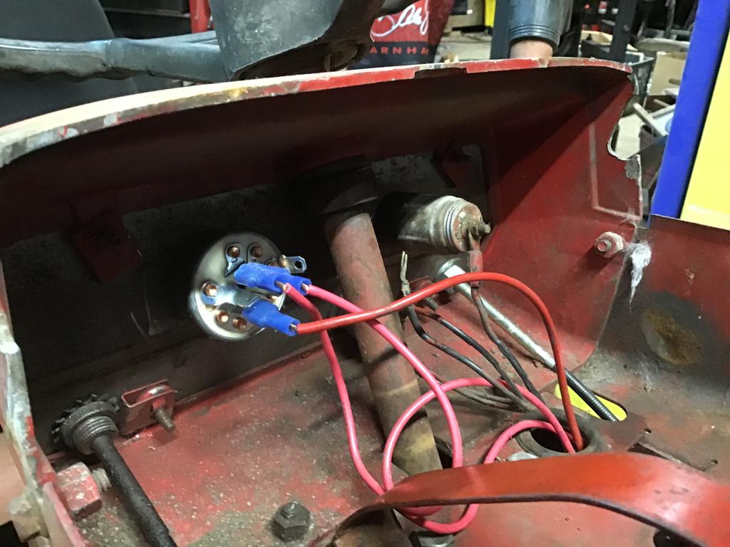

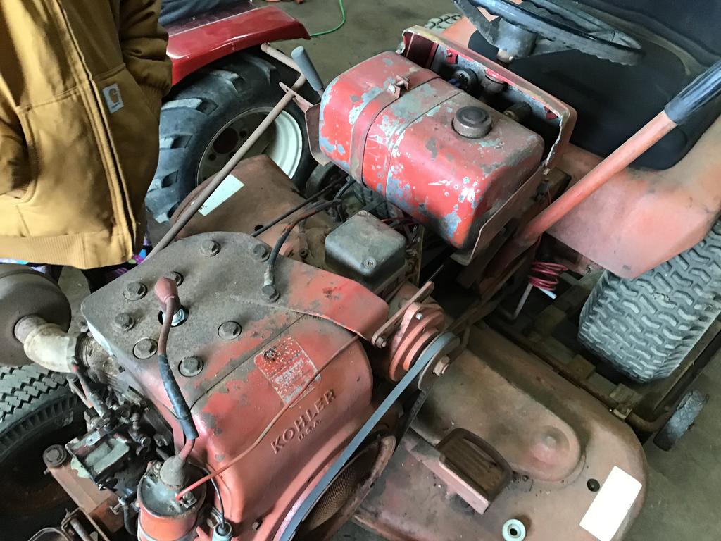

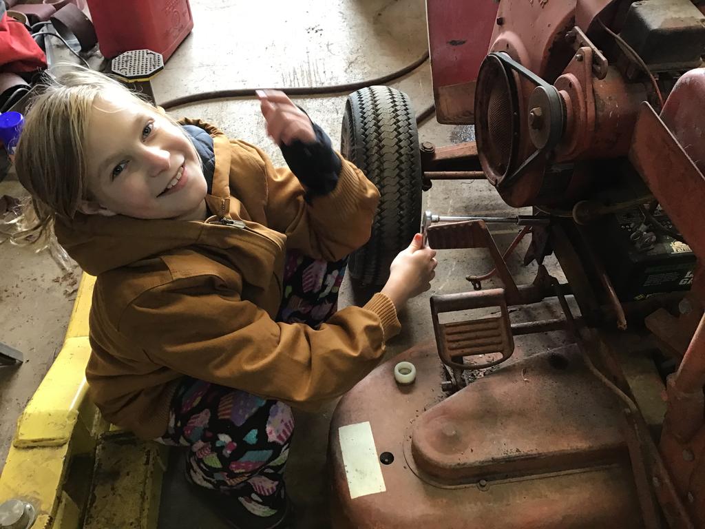

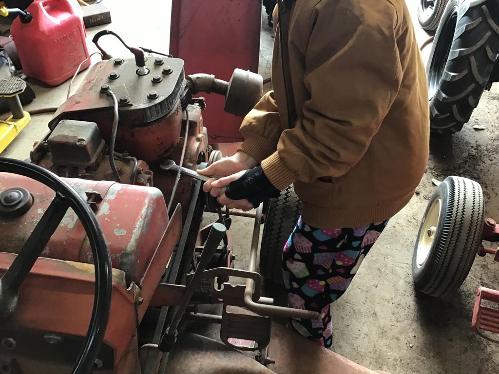

Pullstart 71,527 #1 Posted October 29, 2019 So earlier this year Rylee bought this 1076 with her own money. $65! I told her that when she’s ready to work on it, I’ll show her how to work on it. Some smart kid decided it’s too cold and wet on her birthday to ride the quad in the field. She’d rather wrench instead! ❤️ We started by checking the oil. Now I can see there is a wiring mess, so we’re checking over the wiring before we try to touch the key off.. 8 11 10 Share this post Link to post Share on other sites

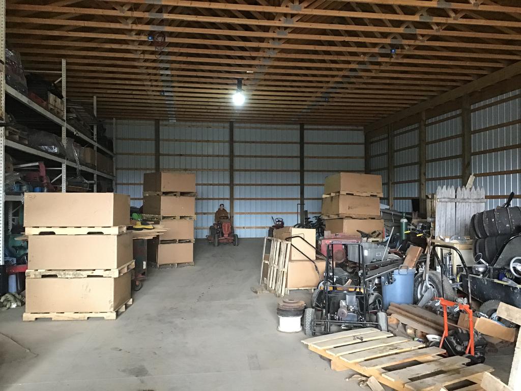

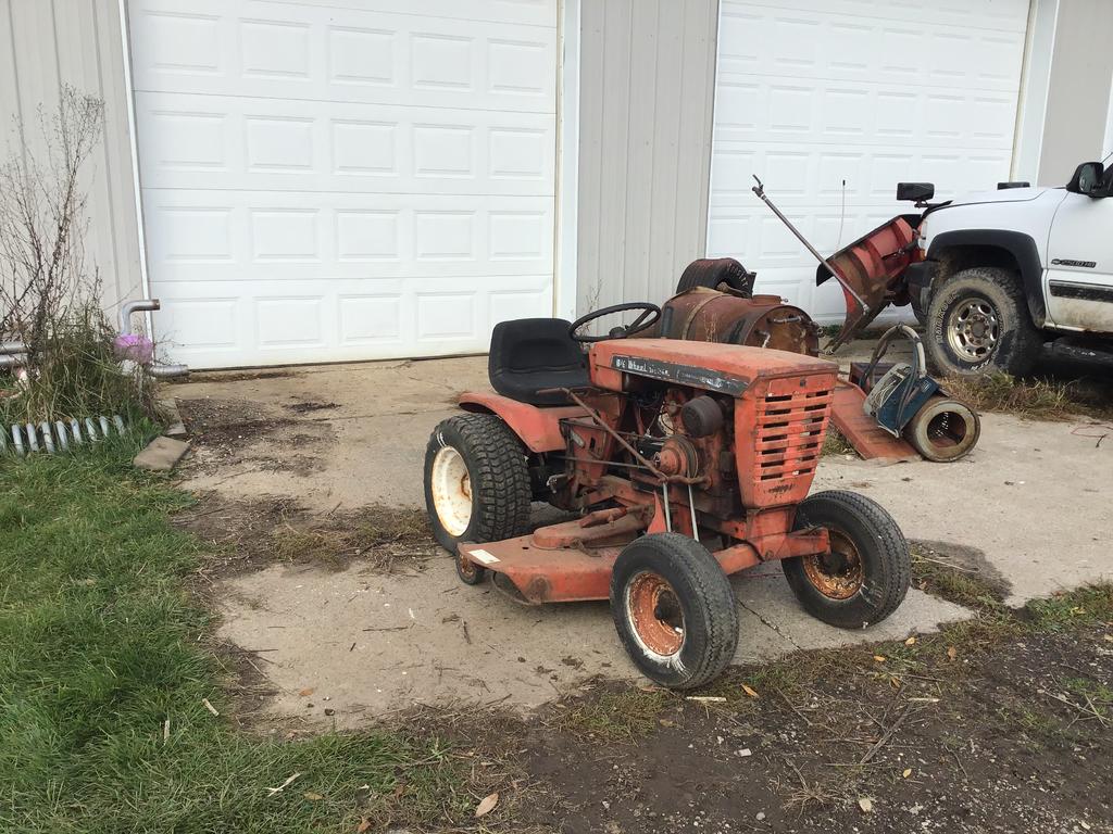

Pullstart 71,527 #4 Posted October 29, 2019 We have a runner! With spray that is... we have a fuel issue. 3 Share this post Link to post Share on other sites

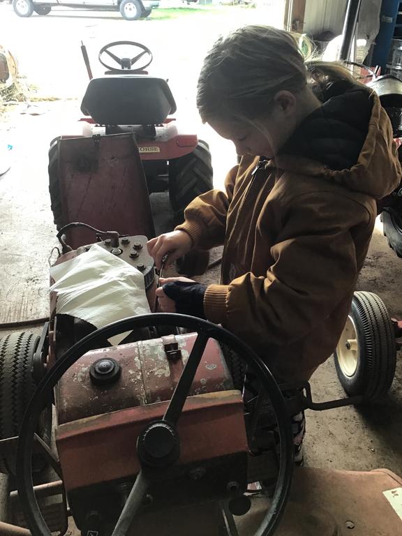

Pullstart 71,527 #5 Posted October 29, 2019 There is a ton of varnish in the carb and about 1/8” slop in the throttle shaft, so we’re going to look for some donor parts and run some new fuel line. The clear stuff is leaking all over. But first, LUNCH! Rylee took a break to take a birthday call.. 10 6 Share this post Link to post Share on other sites

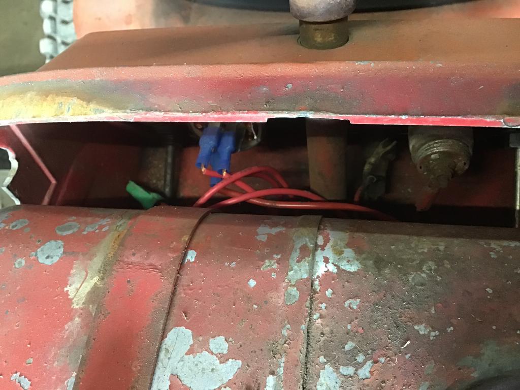

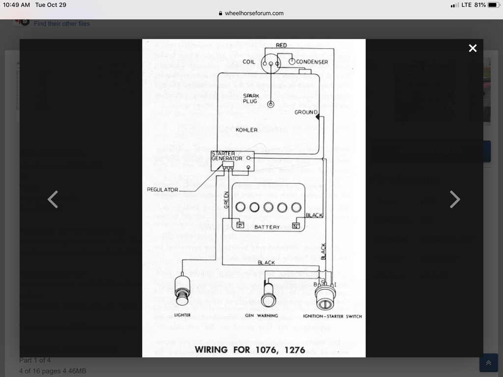

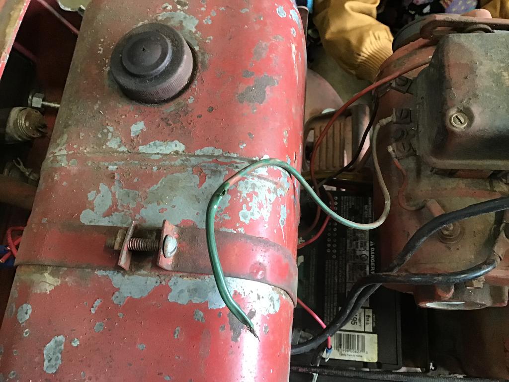

Pullstart 71,527 #13 Posted October 29, 2019 The P.O. was deceased and Rylee bought this from his nephew at the estate sale. He only knew it had a new battery, nothing else. Probably the reason it was not in running condition for the P.O. is because I found the coil was only getting power when cranking. The switch is not correct for the machine, but it was wired for a starter solenoid. Next will be getting it to run on it’s own power, now the coil has power whenever the switch is on or in start! After that, sorting the generator charging circuit out... 7 1 Share this post Link to post Share on other sites

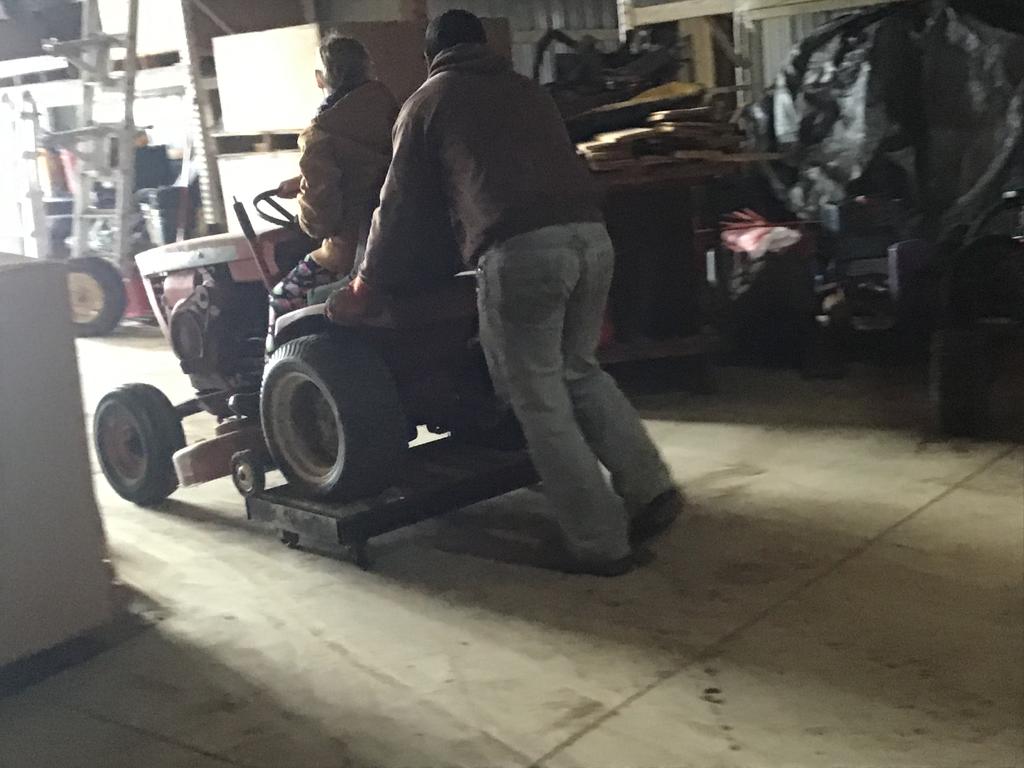

Pullstart 71,527 #14 Posted October 29, 2019 This is how far we’ve been able to drive it so far! 6 Share this post Link to post Share on other sites

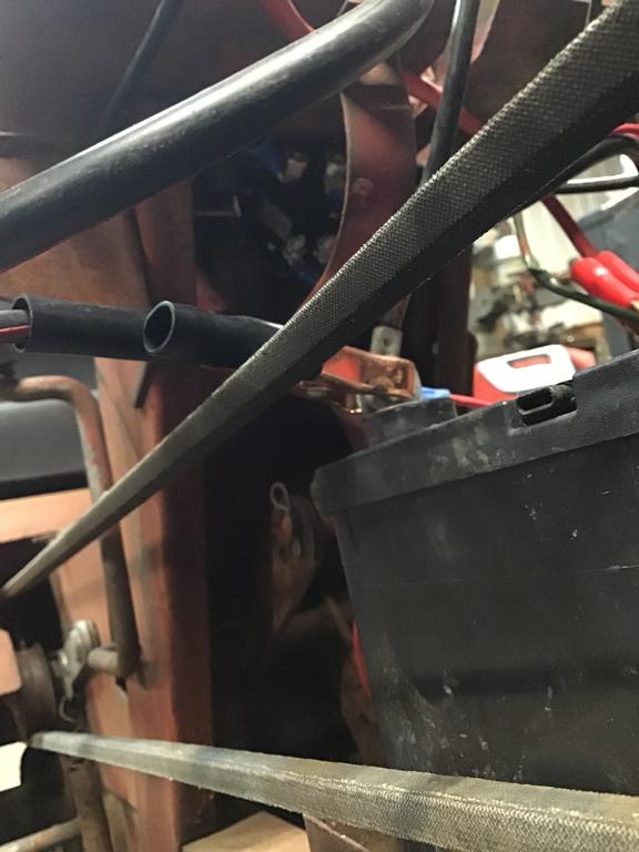

Pullstart 71,527 #23 Posted October 30, 2019 A little update while my 10 year old is sleeping... Daddy checked the gap on the points and we were at a loose .020”. I brought it in to .018” and this Filly came alive! On the clean cement, it spins the tires a bit from forward to reverse! I need to come up with a belt guard and get her on a test drive soon! 2 2 2 Share this post Link to post Share on other sites
