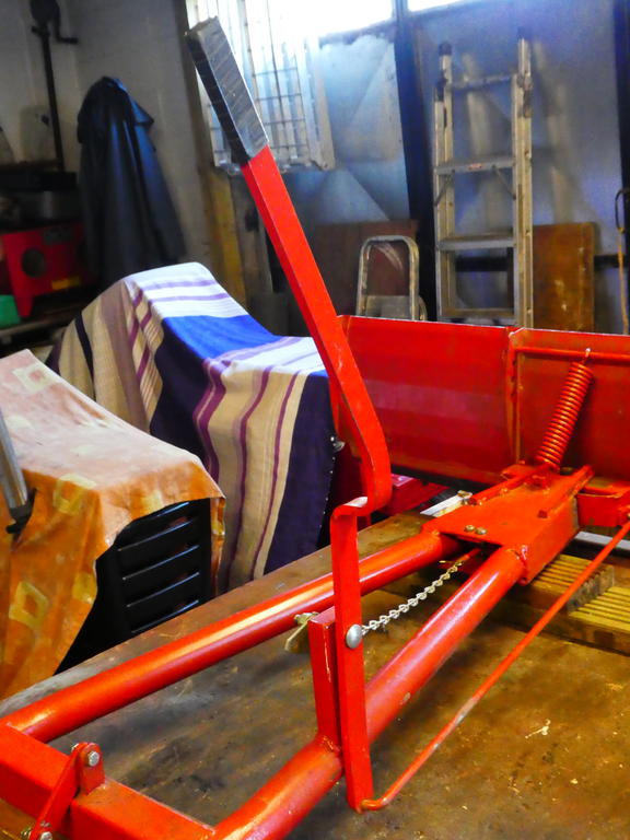

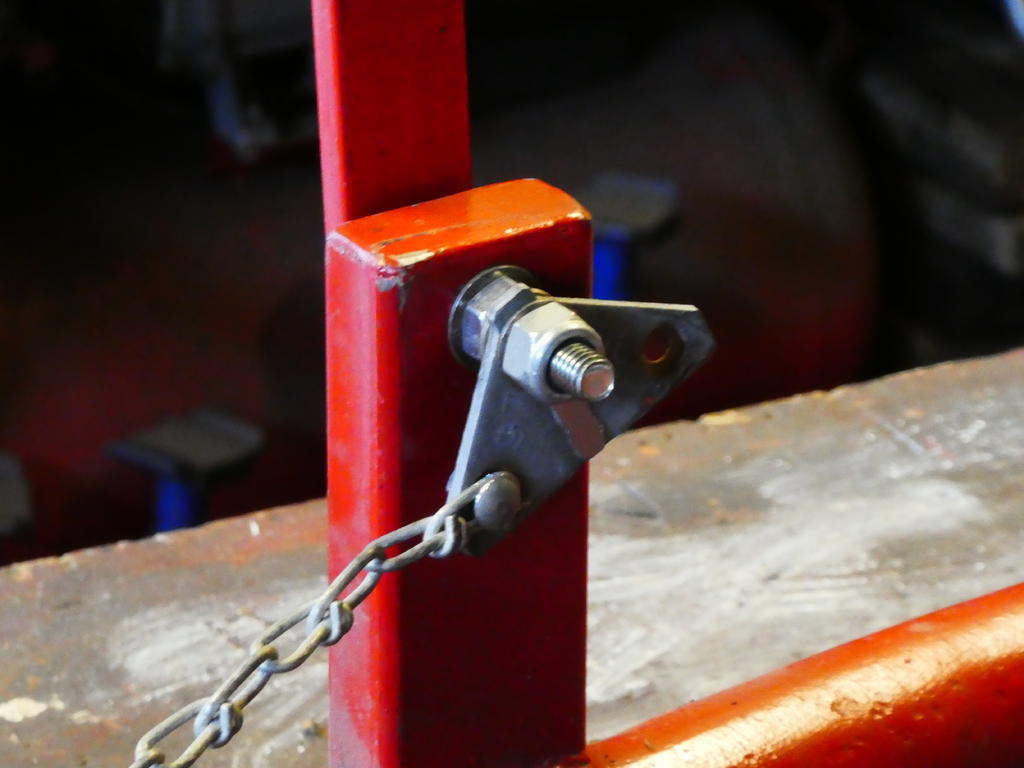

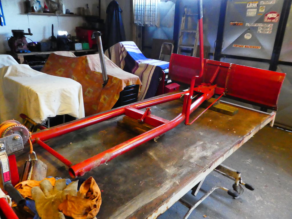

Stormin 9,987 #1 Posted October 27, 2019 Once upon a time, in the dim and distant past, I made myself a snowplough/dozer blade. The build is to be found here :- Unfortunately due to Photo****it the photo's are not very good, if viewable at all. Yesterday I thought it was about time I sorted out the non existent index mechanism. The lever I had already made. So I rescued it from it's hiding place. Also had a scrat about for things to make the other parts I needed. Some chain. A gash gate/door hook retaining eye and other bits. Not photo's taken during the process, but the following one's should be self explanatory. That much does work. Now all I have to do is find/make a lever to operate the location pin. 7 4 Share this post Link to post Share on other sites

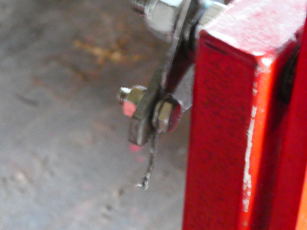

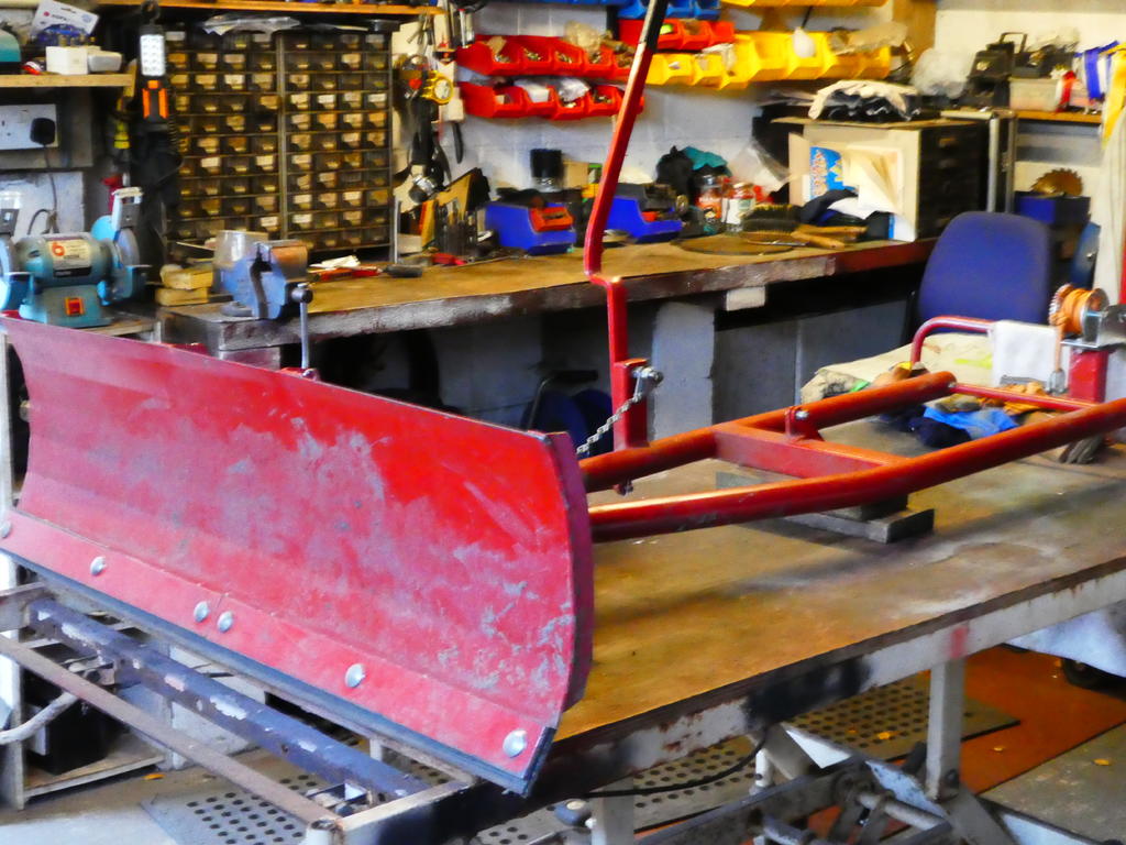

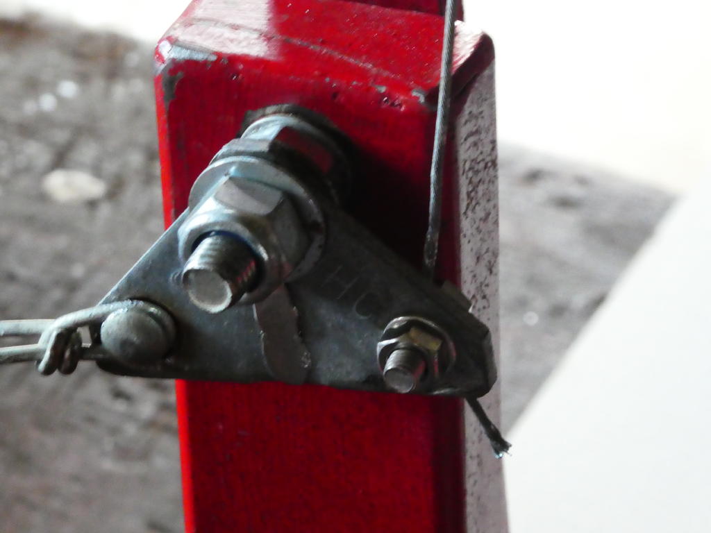

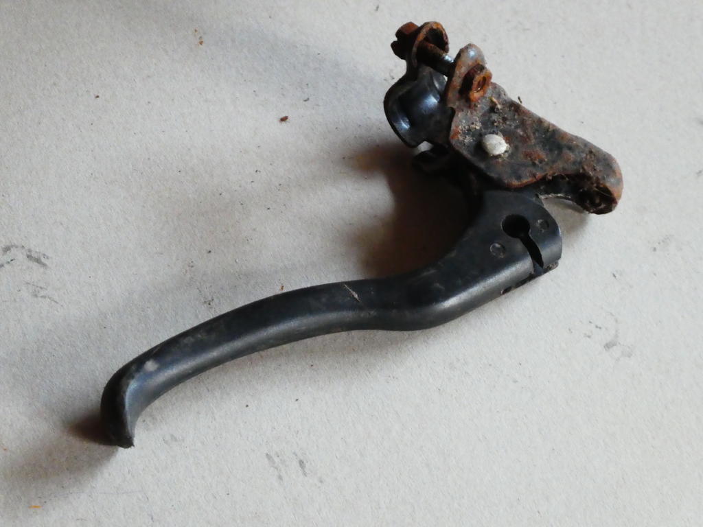

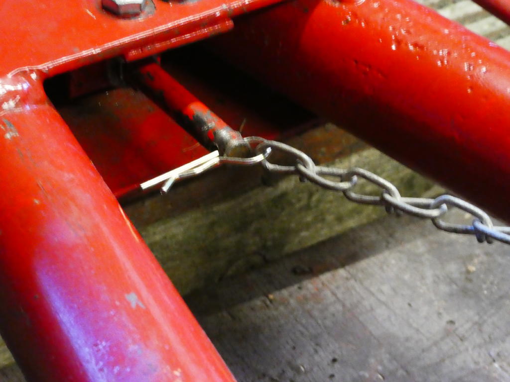

Stormin 9,987 #4 Posted November 4, 2019 Got a couple of bicycle brake levers from a scrap farm bike. Bit of a mod to were it fitted to the handle bar and connected it up. After drilling a hole through a 6mm set screw to thread the bicycle cable through. Hit a snag here. The lever not being straight fouled the handle when pulled right back. So I shortened the lever. Finally I did away with the R clip that held the chain to the location pin. Threaded the hole 6mm and secured the chain. Might throw some paint at it sometime. Also see if I can find a straight steel lever to fit. Maybe not pretty but it works and it cost me nowt. PS. Sorry about the poor quality of a couple of photo's. I need a Trina. 3 2 2 Share this post Link to post Share on other sites
