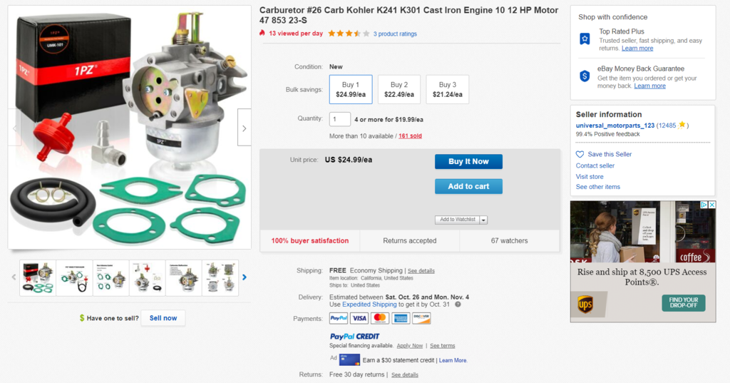

WildmanC120 615 #21 Posted October 23, 2019 7 hours ago, pullstart said: I am on board with most the suggestions here... mainly float level, needle and seat being completely sealed and fuel pump possibly leaking. The 22 hp Predator I have on my wood splitter ran less than a year with it’s stock fuel pump. I heard about @WildmanC120‘s fuel pump issues and then read about many more on the net. While running, my engine did the same type of symptoms loading up and bogging down. The crankcase was so full, there was no place for the crank to move around because it was completely fluid filled. After an oil change, the same thing happened after a couple day!s run time. I figured carb issues, until the fuel pump diaphragm issue came up. IF YOU FIND THAT IT’S A FUEL PUMP ISSUE... Either replace the pump internals with quality Kohler replacement parts (ask @prondzy how the cheap Amazon ones worked for him) or bypass it completely and install an electric fuel pump along with a fuel pump block off plate. Great advice here. My predator only had a few hours on it before the vacuum fuel pump stopped working. I ended up going the route of replacing it with an electric unit and have not looked back. I used the engine all winter to snowblow and all this summer to mow 3 acres attached to a 60" deck. As for your issue here, I have used this carb from ebay on a K301 with great success. I would buy one of these. 1 Share this post Link to post Share on other sites
WHX?? 58,241 #22 Posted October 23, 2019 1 hour ago, WildmanC120 said: used this carb from ebay on a K301 with great success. Nice that they include gaskets. Was the choke configuration right? Share this post Link to post Share on other sites

WildmanC120 615 #24 Posted October 24, 2019 4 hours ago, WHX24 said: Nice that they include gaskets. Was the choke configuration right? Yes the choke was correct. 1 Share this post Link to post Share on other sites
